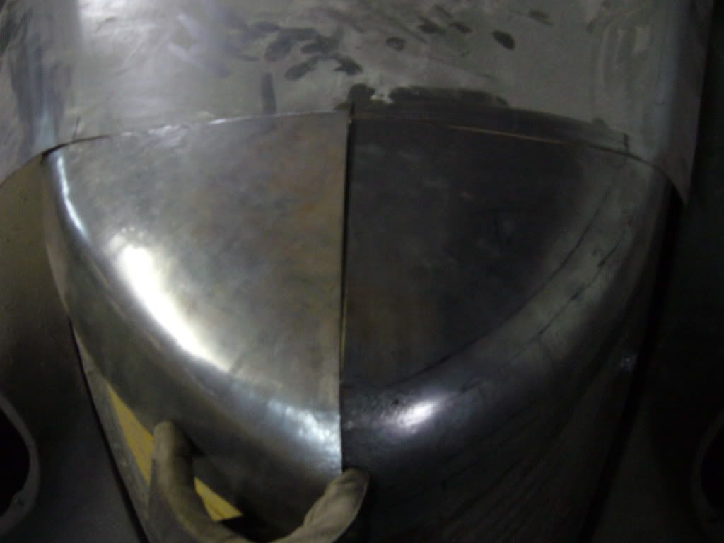

    Start by hammering from the inner end of the puck and work your way out ,the first row were 3inches long then 2 then 1 inch

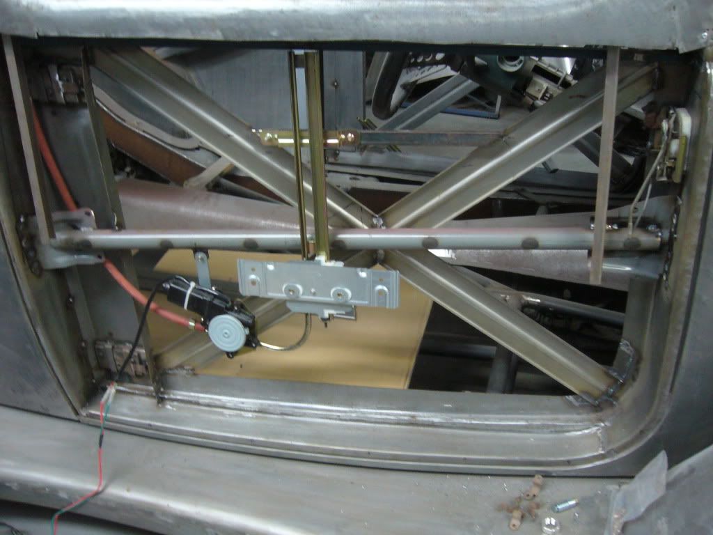

    Next was to fit electric windows ,this was made fairly easy because i dont have door skins fitted.I used chip board as a temporary mount to work out how thick the bracket had to be

    Hi Mitch, those mechanisms seem to fit pretty neatly. What are they out of?

    They are Dolphin ,most companies have the same set up.The only thing i would change is the attachment points for the glass by glueing a long channel to the bottom if useing triplex glass

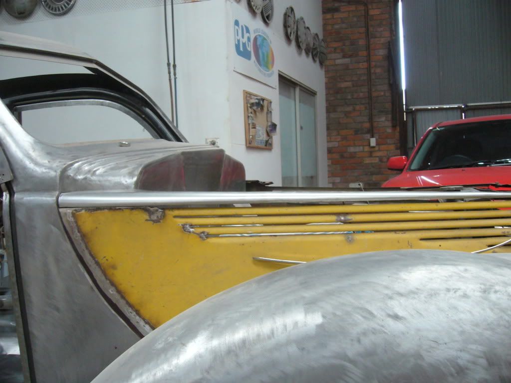

    I pulled 4 doors apart and removed the antiburst bars ,then fitted them into the side of my car.

    The original piece of the car is the section around the trunk lid and the body number

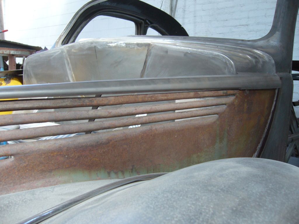

    I have been doing a lot of finishing of welds so not much to look at.Saturday i made a top bar for the bonnet side ,it tapers to the front so the bonnet will be more like a 37.

    I also wanted a strip to cover the join between the two halves of the grill and found a trim off an Austin A40 bonnet and bent it to suit

    Made the other side for the bonnet sides

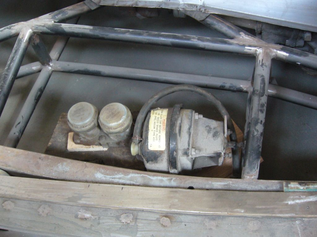

    The next 2 bars are damaged and need to be repaired before welding the new top on
    also setting the brake booster up and pedal assembly
