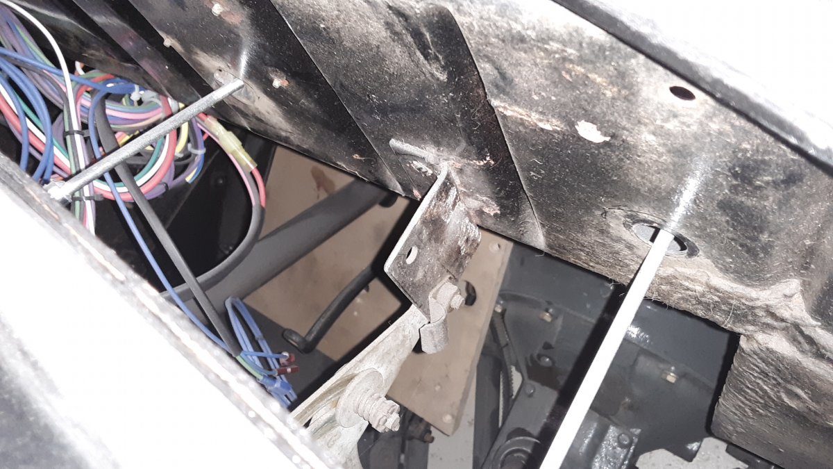

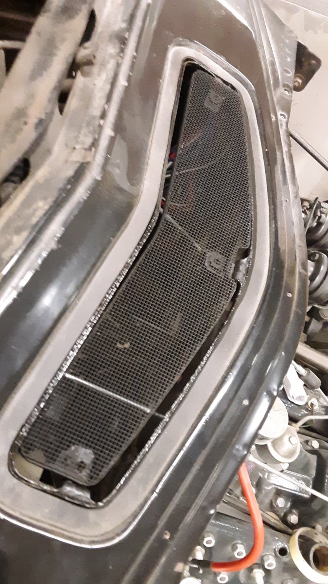

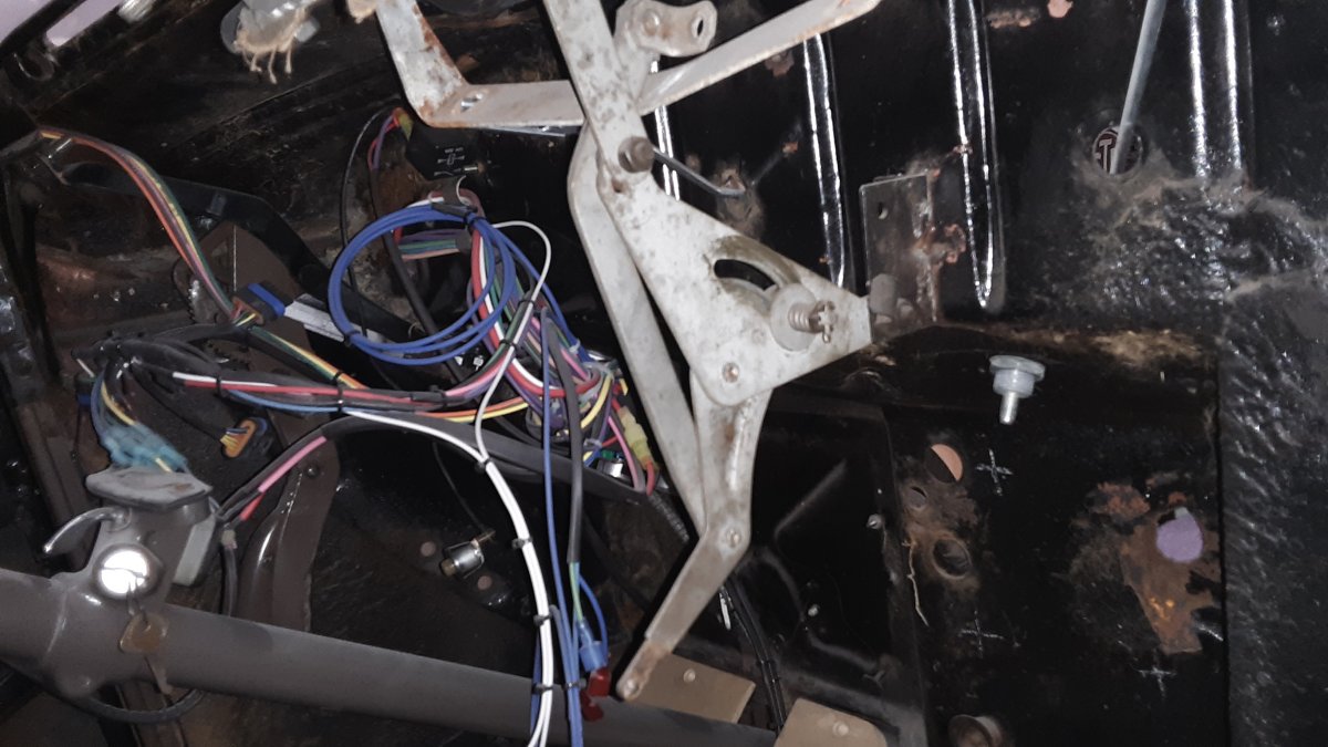

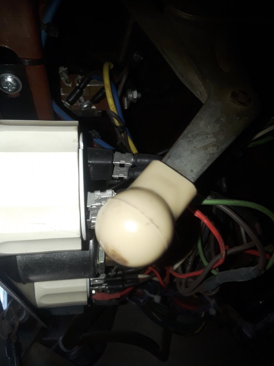

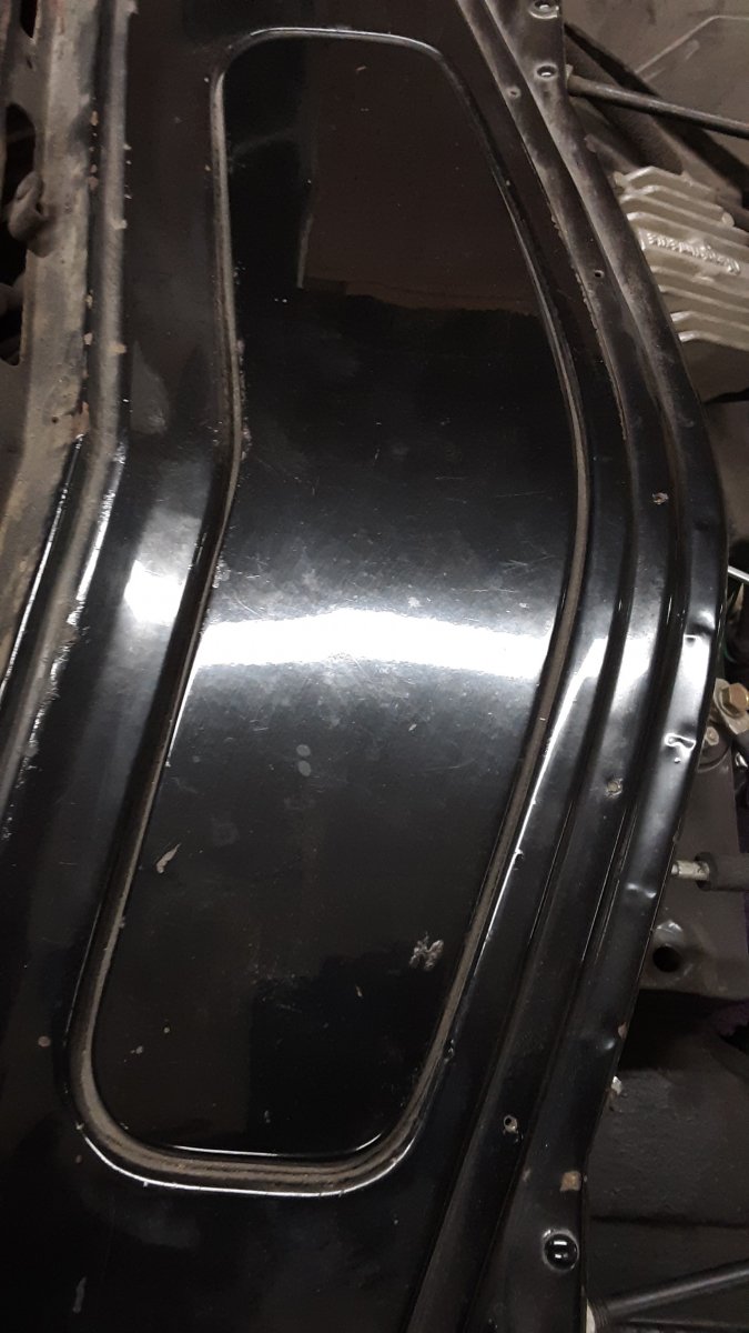

    These are from my'39 p/u but I'm guessing they are the same. Not the greatest photos but best I could do. vent 1.jpg vent 2.jpg vent 4.jpg vent 5.jpg vent 6.jpg vent y.jpg
    kidcampbell71 and 38nailhead like this.

  7. The pictures of the vent mechanism from the '39 posted above is the same thing as what is on my '38. I have an extra vent door if you need it.
    38nailhead likes this.
