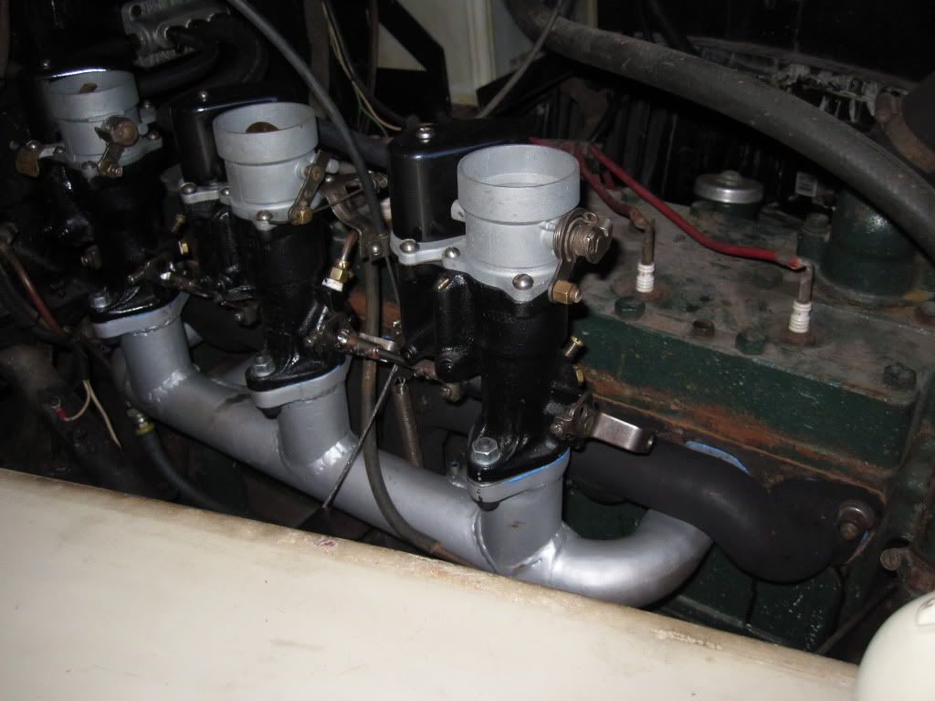

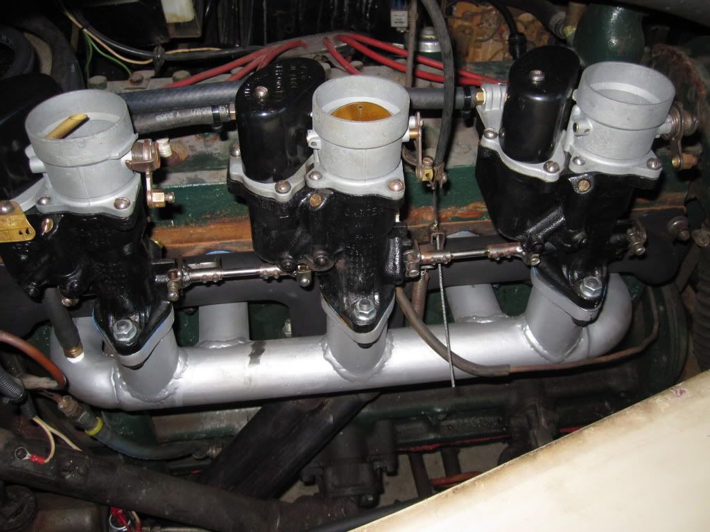

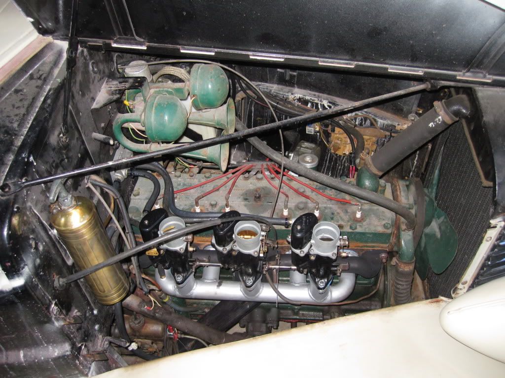

    Well its been a couple of weeks, but ive got the manifolds on and running, just finished up the exhaust today, The car sounds sweet with the split dual exhaust front to back and drives smoother also. I guess this brings an end to this exercise, im going to give the old girl a tidy up over the rest of the winter, re-wire, rust repair, re-paint and a general tidy up. Ill post pics as i go. Thanks for all the positive comments, enjoy these final pics and please excuse the old tired looking engine bay. Chris.

    well done job there! did you see a significant power gain?
  11. Ogbomb
    Joined: Mar 15, 2011
    Posts: 64
    Ogbomb
    No significant power gain, as the motor is still stock. One day ill build up another motor, do some head/port and cam work and see what happens.

    Hey rene53catalina, thanks for the compliments, the car runs well, more so on the open road, there isn't anything fancy in the motor so I didn't want the carbs dumping a butt load of gas in there, its no rocket ship, I wanted it to look good but still be driveable/reliable also.

    that`s all i wanted to know , i got an offer from a friend of mine who is a welder , he offered me to weld one for my engine , gonna do a dual carb i think .
    i noticed the middle part of the intake is thicker , did you do that to get a better flow ?

    by the way , great looking set of horns you got there :)
