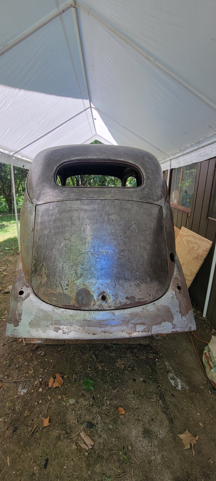

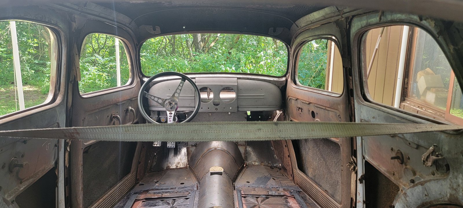

    I found indoor storage for my roadrace car so garage space was available to start on my Willys. First order of business was pressure washing everything out that might want to kill me.
    20220604_145246.jpg After I got the front end sheet metal removed I cut the firewall until the motor fit and the headers cleared the steering box. 20220618_132853.jpg
    Once I figured that out I fabbed some motor mounts and a trans mount/x-brace. 20220625_163323.jpg 20220627_211056.jpg 20220627_211157.jpg
    Now that its all fabbed and tacked I'll remove everything to finish weld.

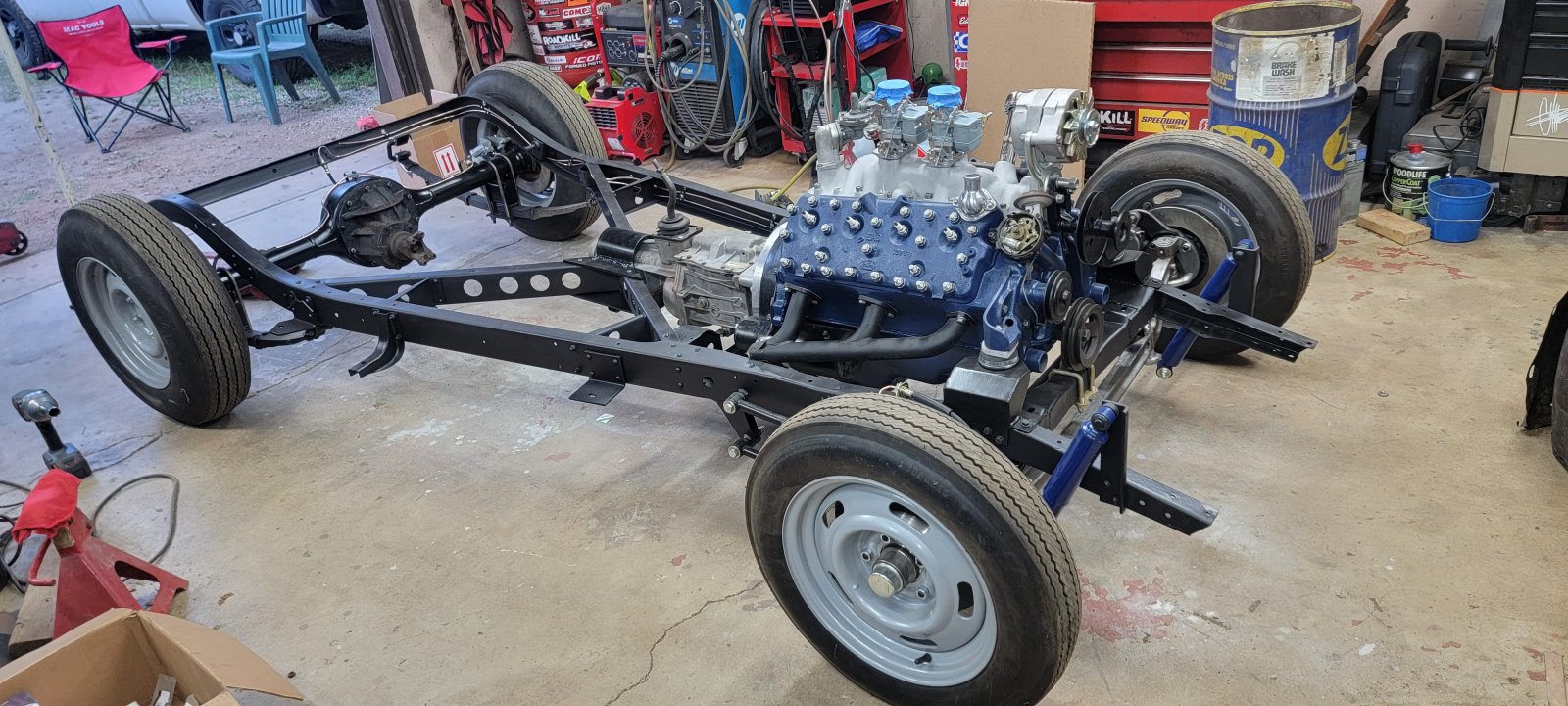

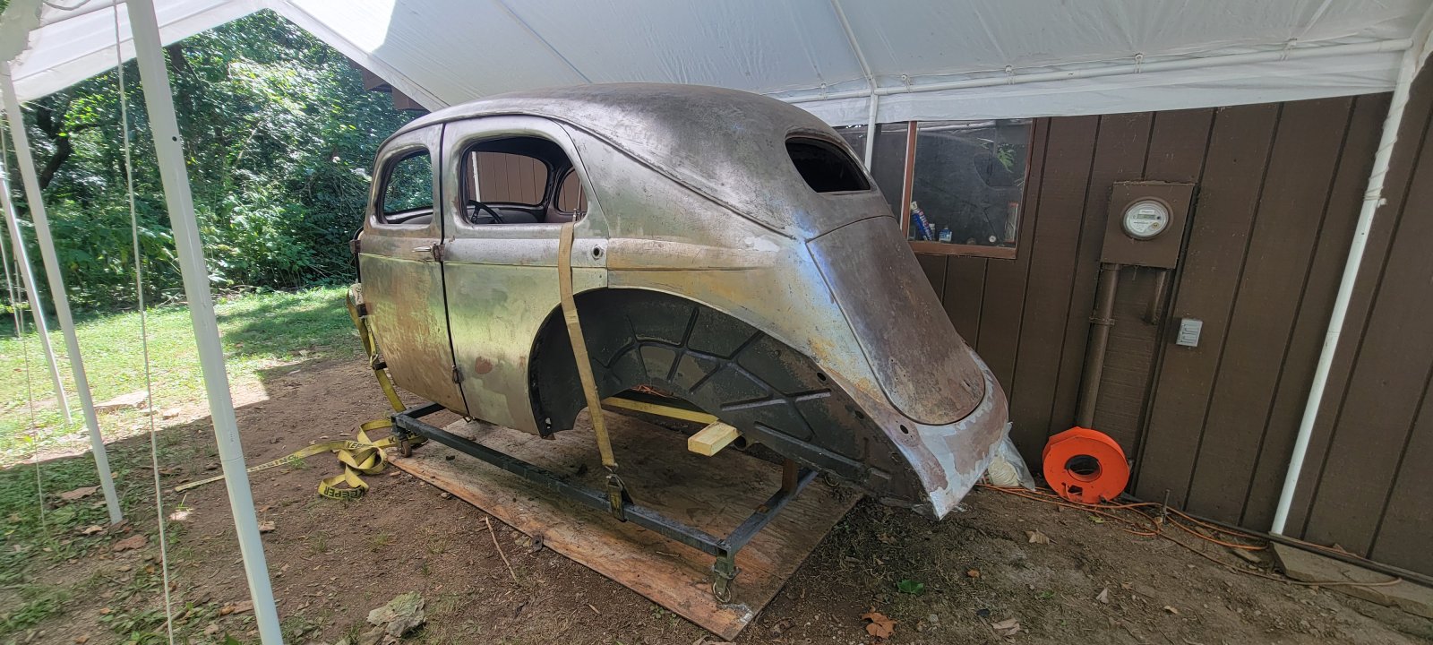

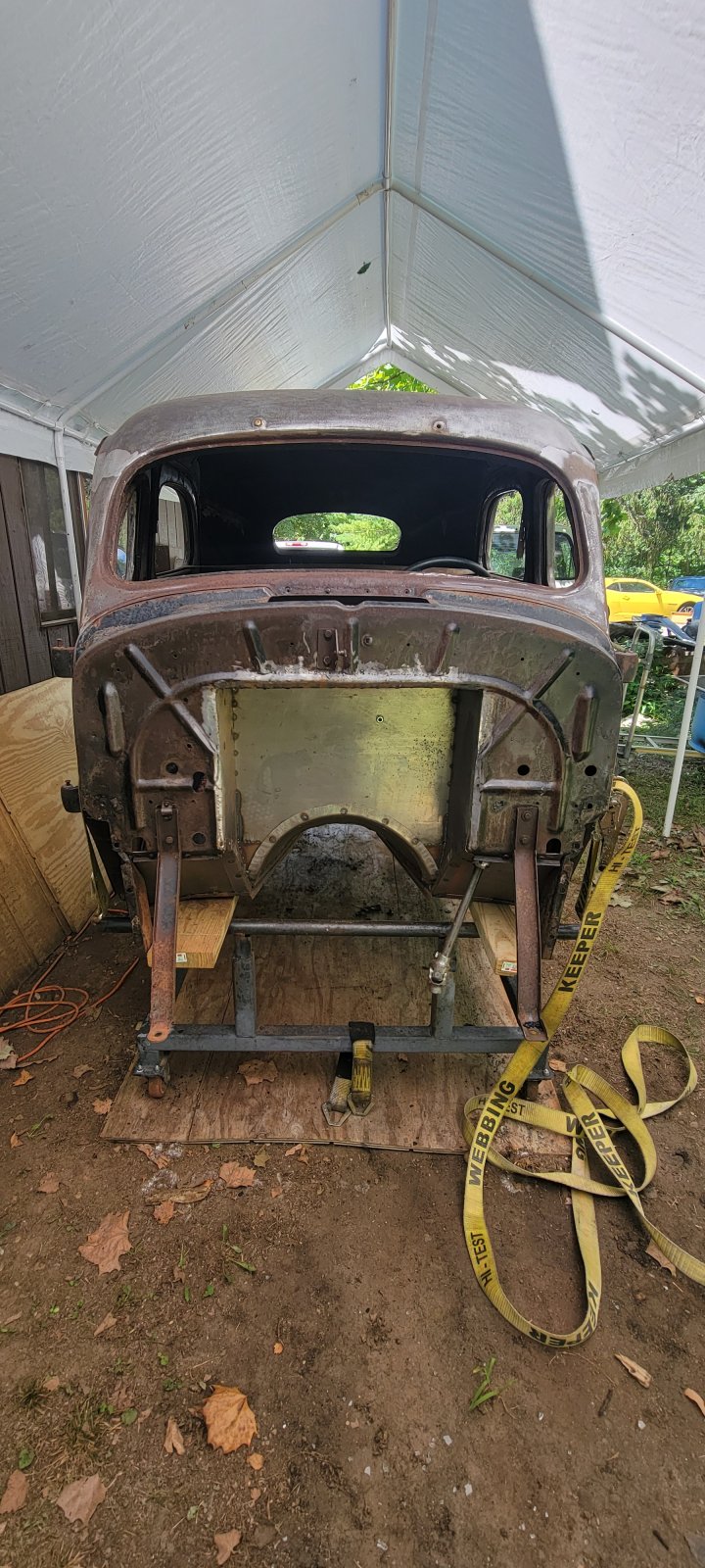

    Finally working on this again. Goal is run, stop and steer and take it to the Bellefontaine Hillclimb instead of my Camaro.
    Ch***is is a complete, plumbed roller
    Firewall is ready for finish welding, body is stripped and floor is Ospho coated top and bottom, it's getting sprayed with Raptor Liner
    20240810_145510.jpg 20240810_145441.jpg 20240810_145532.jpg 20240810_145522.jpg
    The hillclimb is in 2 weeks so it's a tall order. I'm on day 9 of 11 days off work, I probably should rest at least one of them. Once this is together the coupe is coming back over.

    hanging from the hoist so I could lay under it and spray epoxy primer and Raptor Liner
    I mixed up some red oxide and hot rod black primers to get something close to Kondar.
    Putting the body back on the frame alone was a real day at the beach
    More Progress. 20240929_161809.jpg 20240929_161939.jpg 20240929_162314.jpg 20240929_162435.jpg 20240929_165105.jpg
    Next project is cleaning up the hood and front fenders so they can be fitted and bolted on. Right now the goal is move under it's own power, bodywork will come later. Once this will move without me pushing it, the coupe will get the same treatment.
