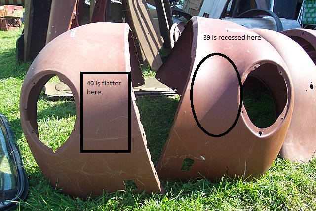

    Hi Its been awhile since I posted a question. I have a 39 Ford Deluxe Coupe. Just finishing a ch***is restoration and 327. I notice my front fenders are slightly different. Between the headlight and grill one is a little more curved in. Also the bumper hole is slightly out of place. Aside from hat they fit perfict. They have been on the car since the 60's at least. Anyone know which fender is correct?

    Here you go Mike.This picture has just the right lighting to show difference.

    Mike, had the same situation with my '40 coupe, was told mine were '39 & '40 fenders. Looked in a Ford Parts manual, and found that '39 & '40 P***enger car models were the same part number... '39 & '40 Commercial models shown with the another part number. The higher ride height of the Commercials (this may include Station Wagons) explains the lower headlight mounting, the different fender curvature and change in the bumper mounting. Ya just got to match 'em up! Think trading with another '39/'40 owner who the same problem... Hope that will work for you, Dyno Dave

    The basic shape is the same in a p***enger and commercial 40 fender, the difference being in the rear mounting flange that bolts to the body (not a lower headlight). After they are bolted on the car/truck they look exactly the same. The two part numbers is because of that flange.
    The reason a 39 Deluxe fender has the same part number as a 40 fender is because Ford used a 40 part to replace bent up 39 fenders. A 40 fender is functionally accurate. And Ford is well known to phase out old parts and replace them with other functionally accurate parts that work. The big "32 heavy axle" controversy is one for instance. They were replaced by a skinnier axle in 33, but the new version fits the same place.

    Let me ask for a clarification of "Commercial". If by Commercial you mean a Sedan Delivery, I would expect it is the same as other p***enger body styles. If Commercial also includes the '40-'41 pickups and panels. there is more difference than the cowl flange. The fender aft of the wheel opening curves differently on p***enger models compared to trucks. The cowl flange can be dealt with by a bending of the flange, but the fender curvature requires reworking the front of the running board mating curve and, while certainly doable, requires a bit more work.
    I do concur with your explanation of '39 fender design being superceded by '40 part and number.

    Ford made the change in the fender contour in the Spring of 1939.

    I found that the bumper holes are in the same location but the 40 fender is arched at the bottom making the distance shorter to bottom of the fender. Easy yo see on the hoist not so easy on the ground.

    According to the Early Ford V8 Club "The 1938-39 Ford Book" - "There were two slightly different design '39 Deluxe front fenders used, being changed around March, 1939. The early fender is more concave between the grille and the headlight; the late fender flatter. Factories were told to use up the early design and that it was all right to mix early and later design on the same car."
