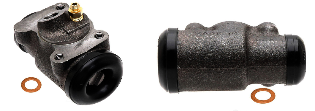

    Ford front Cylinders, I'm finding that they fit 42 thru 52, and have 3 mounting holes (See Below)
    Raybestos WC8264 (L) & WC8265 (R)
    The Wheel Cylinders for the trucks have a larger bore 1 & 1 3/8, or strait thru 1 3/8 bore
    Casting Numbers can be tricky in the Automotive Catalog world, the manufacturers are not including many any longer. Also, if you are still having no luck, and your castings aren't trashed wheel cylinders are pretty easy to rebuild, and the kits just go by size
