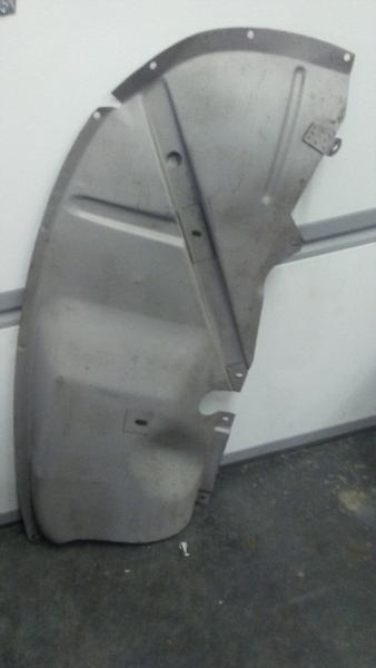

  15. Early 39 inner fender panels mounted with spot welded brackets, and no reinforcement, later changed to like 40.
    Thanks to Kube on the Fordbarn! I have one LS 39 if anybody needs it.
