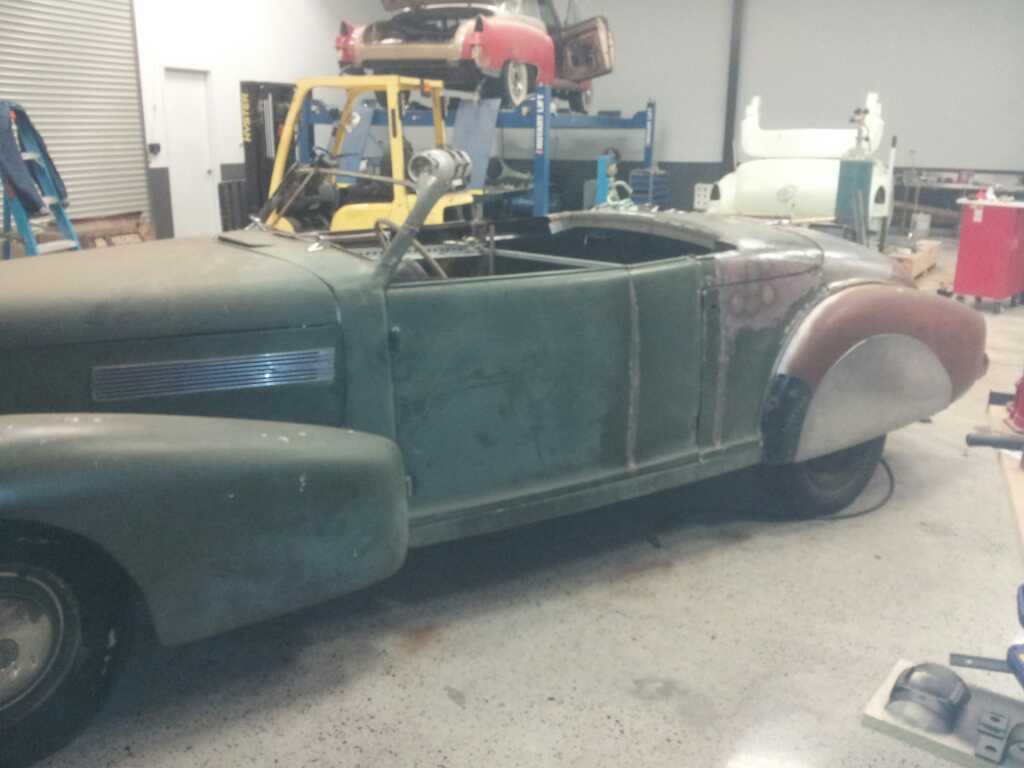

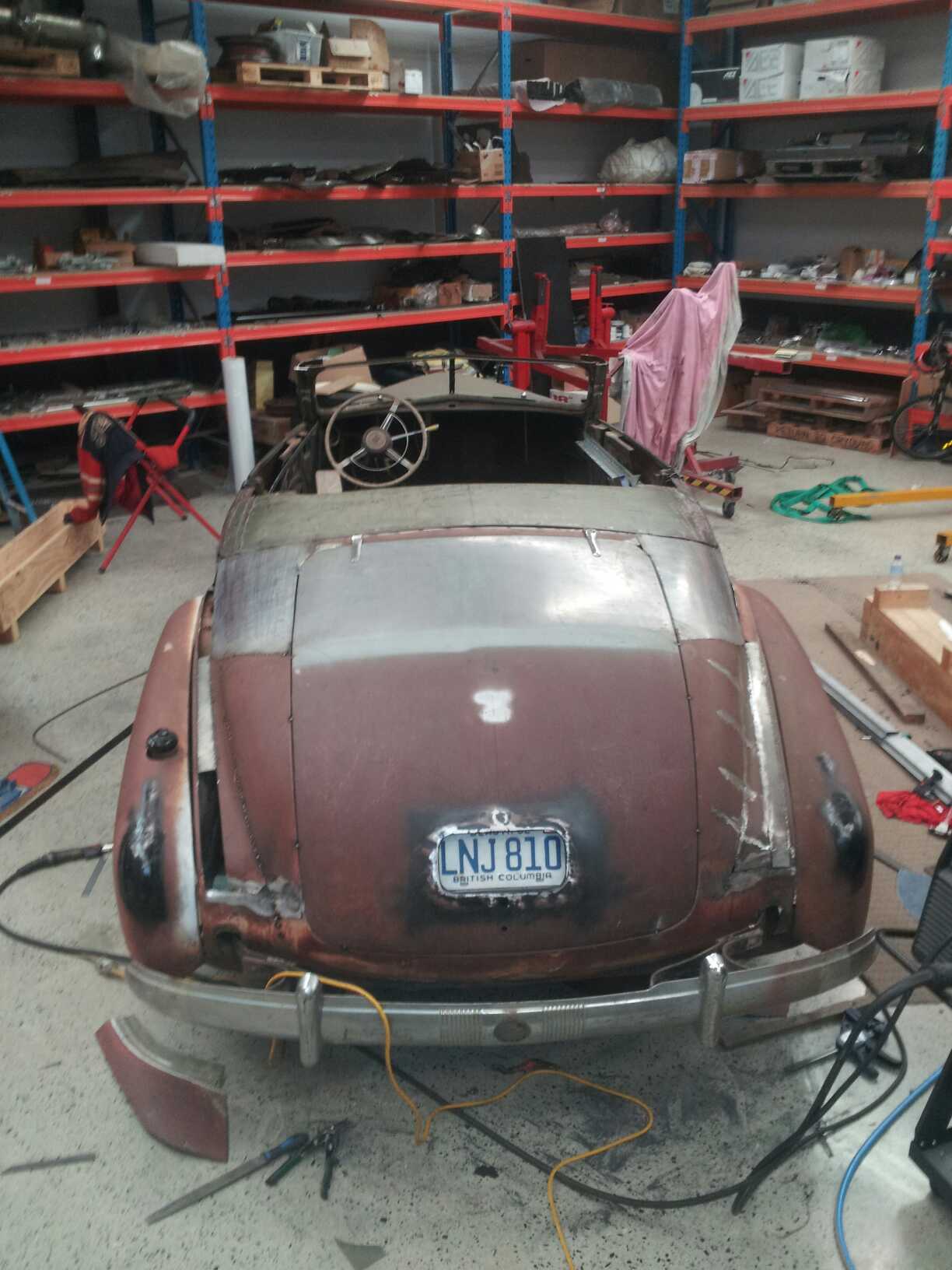

    second cut is painless.... rps20140718_150056.jpg [ rps20140720_112556.jpg rps20140722_225030.jpg rps20140723_103702.jpg rps20140731_085112.jpg rps20140718_150056.jpg [ [[/ATTACH] [[/ATTACH] rps20140731_085112.jpg rps20140724_175224.jpg

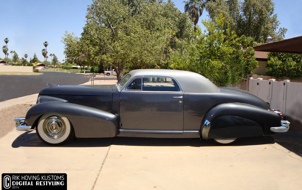

    Man that thing is really cool!!! Love the third pic by Rik!. Hang in there you have something special going on. Tim

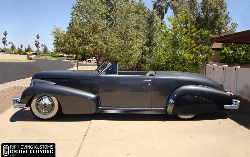

    Yes I am looking for advice on getting the bum down. Got to be careful how I do this if I want to avoid registration dramas here in OZ. Car will be either regoed in WA or Qld. Depending on my address when I get closer to completion. I work in Perth but live in Brisbane. Car is in Perth.
    I can't really C notch over the diff without going for engineer reports. Hoping to avoid that stuff so I am trying to keep the drivetrain relatively stock.. I don't want it lying on the ground. Just 4 or 5 inches lower in the rear would be great. Front can stay where it is. Should I reset the springs , use different shackles and does anyone know the regs on acceptable use of lowering blocks ?.
    This is being built as a period/ factory/ coachbuilt custom. I'm trying not to go past 46 47 ( I have a tonne of 46 47 bits spare) in my use of parts and trying to stay loyal to Cadillac/GM parts usage (within reason).
    Bumpers are sectioned 46 Cad fronts which you can see presently on the front. Rear presently has an earlier 30s bar that is going. Really gives it a more streamlined appearance just the bumper update alone. Can't wait to put on the rear bar. Also using 47 Sombreros.
    I will be improving safety issues like the original door locks which are hopelessly inadequate. I'm looking at Eberhard rotary bearclaws. More advice needed?? . . . and thinking Lincoln push****ons. (1938 Buick Y job used very similar, if not identical.)
    Cad will have removable hardtop roof as well as a modified and shortened 46 Cad conv soft top mechanism that will hide beneath the steel hinged parade boot. Boot will stay in place when hardtop is used.
    Taillights were missing so I filled the original taillight holes and will probably go for simple round red lenses in the 46 dagmars. That said I have found some original 39 Taillights in great condition. They are gorgeous art deco masterpieces but I am not sure if they suit the smooth, flowing, streamlined look I am trying to achieve. Will have to progress a little further for me to decide .
    Color will probably stay green but I am more concerned with having good metalwork than fancy paint. I can see the interior in two tone green. Simple. Clean. Streamlined.
    I want to say again how much I appreciate Rik's ***istance . His site is down till Aug 13 getting maintenance but I have a link there that I will post later that shows how the ideas flowed back and forth between Australia and the Netherlands. I go back to Perth on Tues so will start plodding away on the small stuff soon.
