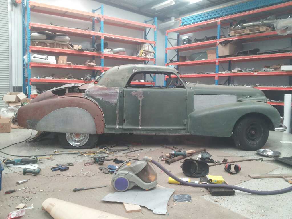

    I started looking at the void behind the seat. I was originally thinking no back seat. The space was just a bit big for nothing so I started to play around with a folding bus seat I had . A bit of acut and shut and it suddenly seems like it could work. rps20150510_195019.jpg rps20150510_195051.jpg rps20150510_195156.jpg rps20150510_195227.jpg

    I widened the seat so needed something to fill the void so an armrest from a 53 coupe donated its folding mech. rps20150511_205059.jpg rps20150511_205021.jpg

  13. i love your project! beautiful in every way. could you please give more detail on the steering wheel? did you brush on the resin or....
  14. CadMad
    Joined: Oct 20, 2012
    Posts: 886
    CadMad
    It was very simple. polyester rope from hardware store ,cheap. i just wound the rope round and round and then soaked the resin in with brush. I did weld another 6mm rod to the back edge og the bare 10mm rim to give the grip an oval shape. it took about 4 coats and sanding in between with 40 grit to smootb it out.

    Hi Quentin..have been interested in the pics of the top of the windscreen frame where the top fits..cut roof off the 41 coupe getting it ready for a Carson top

    Flat out packing everything intoa container to send home to Brisbane. Many more pics on Custom car chronicle forum. rps20150518_135254.jpg 11270456_10200516791159032_2264403352009279285_o.jpeg
