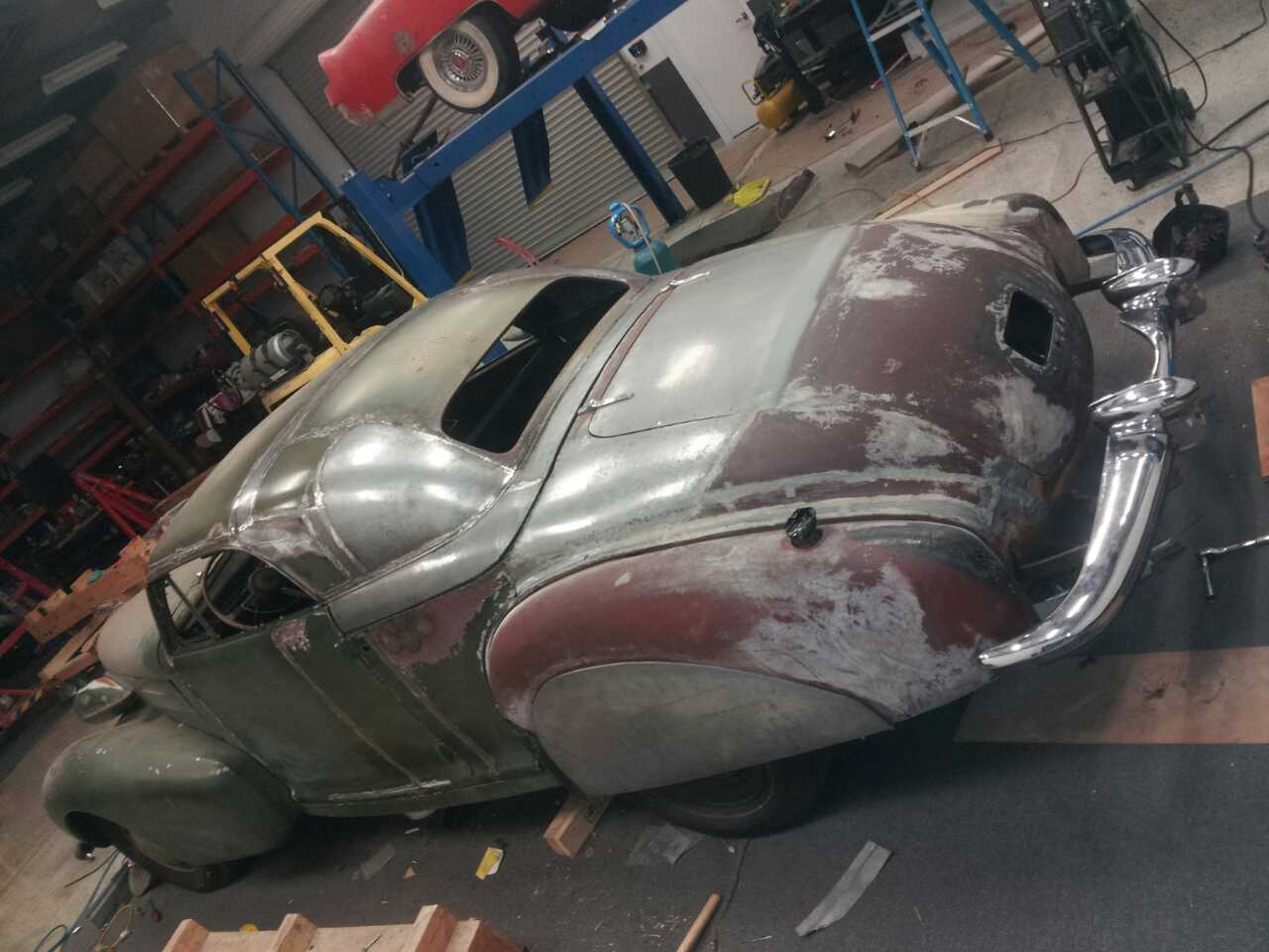

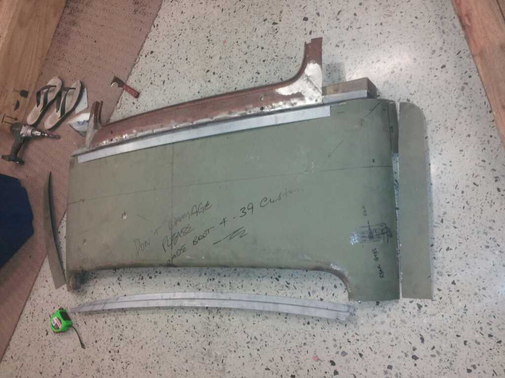

    O rps20140926_204431.jpg rps20140926_204510.jpg Gday Castirondude, I think you meant . Only real (stoopid) men do bodywork in flip flops. . . haha
    I hope you guys are all having alook over at Rik Hoving's Custom Car Chronicle. No one on the planet has the detailed knowledge that Rik has amm***ed and collated . Before I started tbis build I spent hours studying on his site. It really helped me get a solid direction for how I wanted the build to progress. I cant work on the car for the next few weeks but next job is to find some door handles. I bought some Lincoln ****ons but I am not sure they are the look I want now.

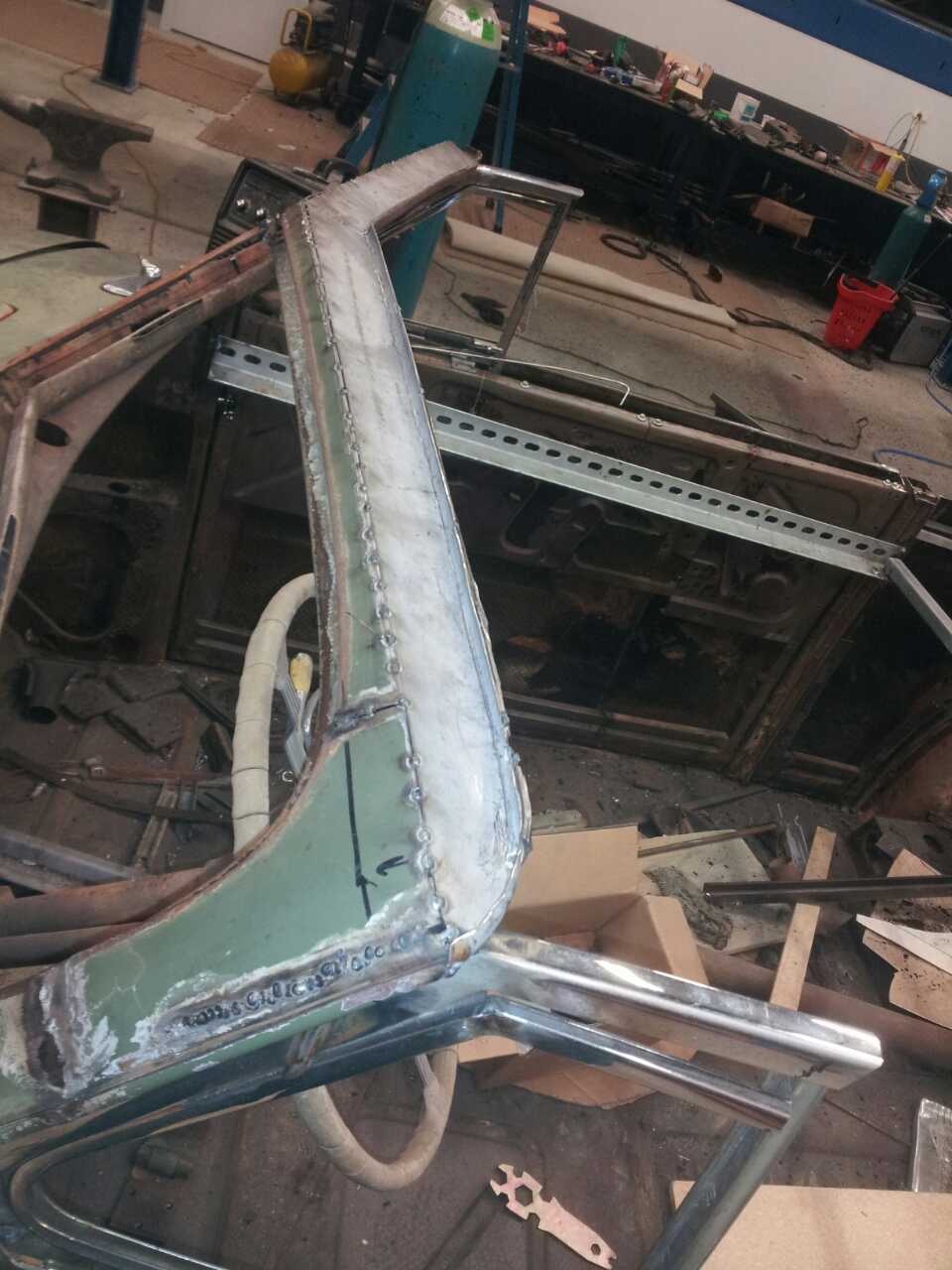

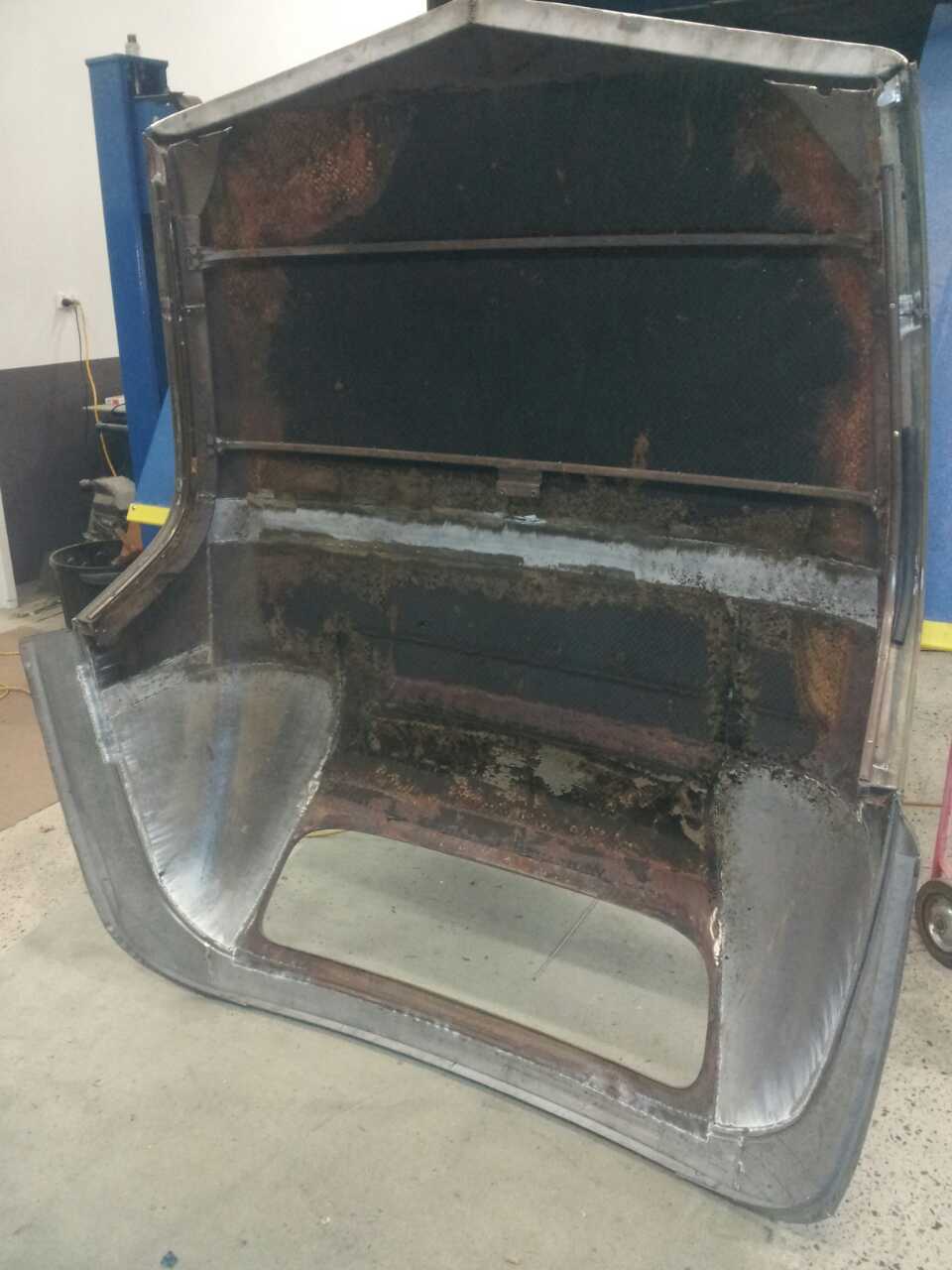

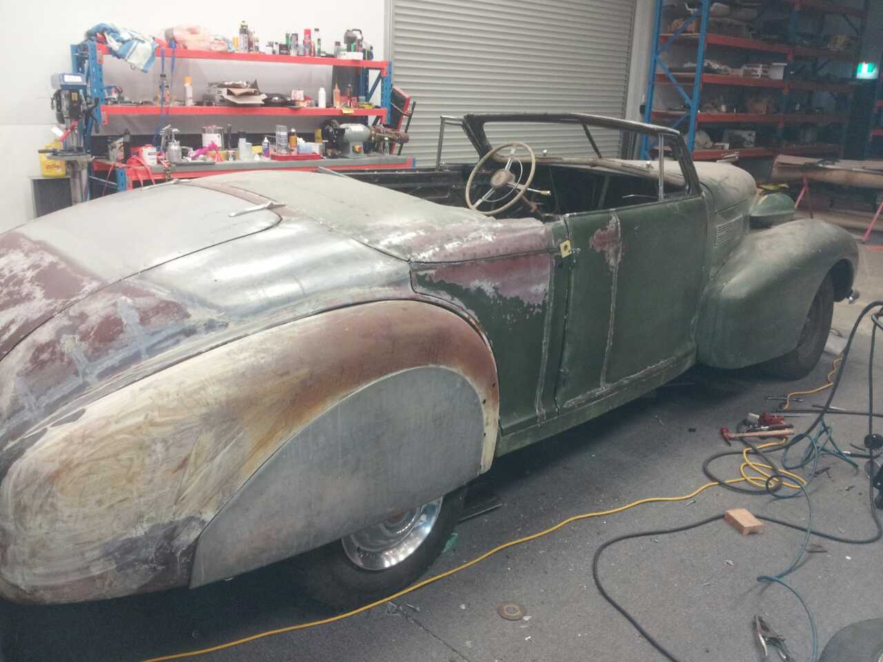

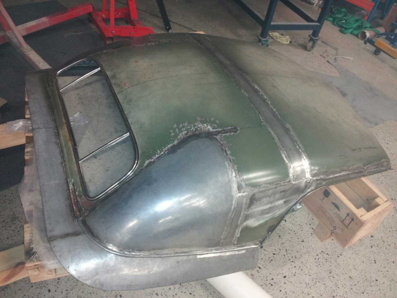

    Had a play tonight and removed the hardtop so I could fabricate the windshield top. Good to see it as a conv again. I also installed bear claw latches earlier in the week. Tomorrow Ihope to weld the header into the hardtop and next will be to get it latching down. rps20141031_214235.jpg rps20141031_214103.jpg rps20141027_204548.jpg rps20141031_213951.jpg

    That first pic in your last post....car looks great!!!!

    I really dig the car without ( and with!) the top. Beautiful job on the w/s frame too, I'm really pleased to see you take the time to make it look "right". How are you latching the top at the tulip panel? On my (now *******, removable steel top) '59 T'Bird I used hood latches , after seeing aCorvette remove able top that used that style latch. I had a Lebron convert front bow and used those latches at the w /s header. ImageUploadedByH.A.M.B.1414795879.979500.jpg

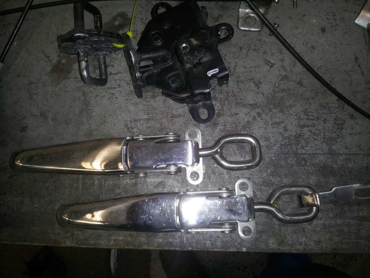

    working out top lockdown is work in progress. But I looked at a68 Vet and will use a similar technique for the parade boot. for the winshield header i found some stylish ss latches. They don't look too modern which is good. rps20141101_071022.jpg rps20141031_215906.jpg

    Hardtop is just *****in'; nice work incorporating the stock rear window from the sedan.

    I found some marine cabinet latches, over- center style same as the w/s latches on my '48 Pontiac convert. These I used on a phantom '41 Chev convertible sedan.
    Try marine supply sites.

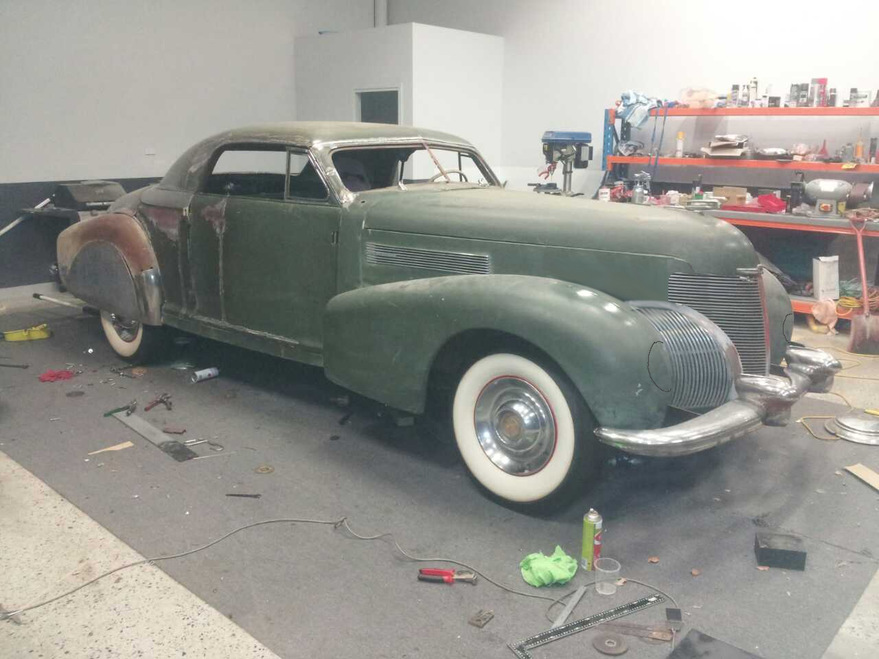

    Today is a big day on this build for me. 4months of cutting grinding and banging and rps20141117_194906.jpg rps20141117_194837.jpg rps20141114_211957.jpg rps20141114_060436.jpg finally the major mods are done. This is what the car will look like ,it's shape defined.

    Absolutely beautiful, you totally nailed it!!
