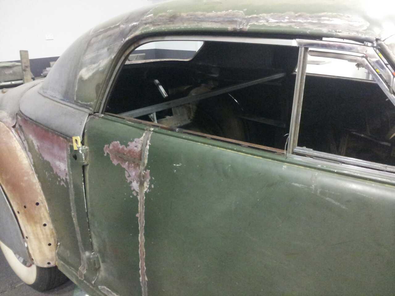

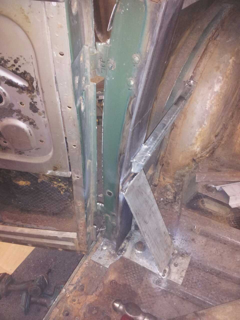

    Last night I decided to bend the window channel. rps20141125_215128.jpg rps20141125_215128.jpg rps20141125_214953.jpg rps20141125_214901.jpg rps20141125_214833.jpg

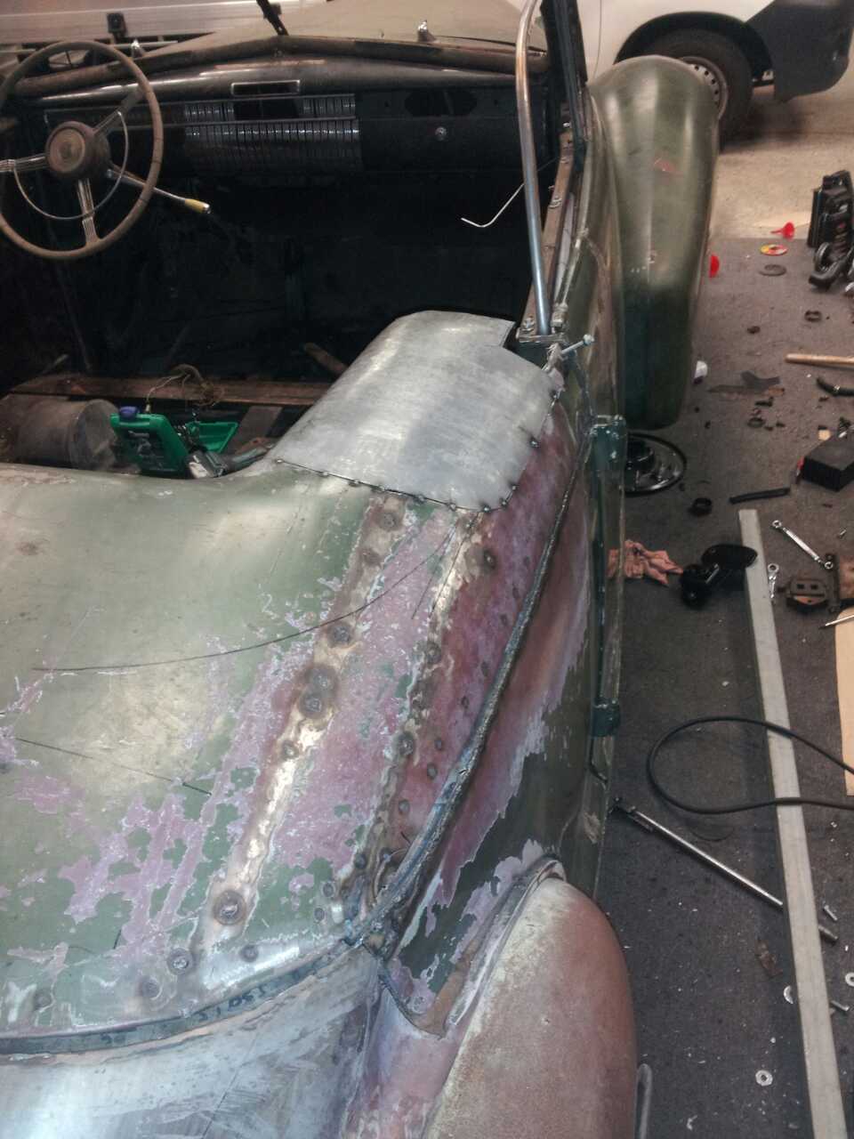

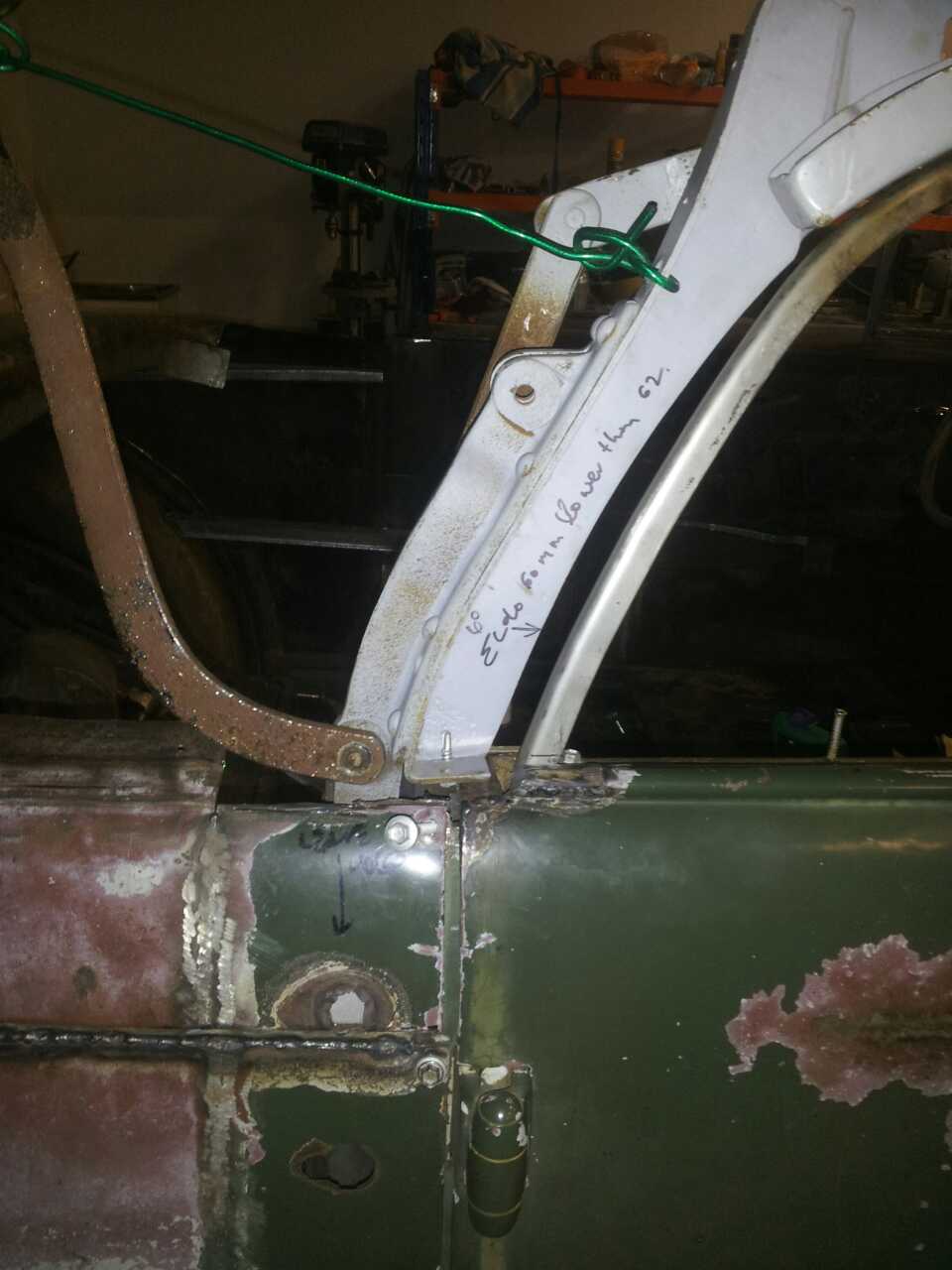

    46 cad conv top mech cut and shut to fold compactly so parade boot will cover. rps20141202_204554.jpg rps20141201_215338.jpg rps20141202_204421.jpg rps20141202_220653.jpg

    Where did you get this window channel from?
  17. CadMad
    Joined: Oct 20, 2012
    Posts: 886
    CadMad
    I cut 1.6mm stainless and folded it in pan brake to about 70 degrees and then flattened in a press to get the rounded top.

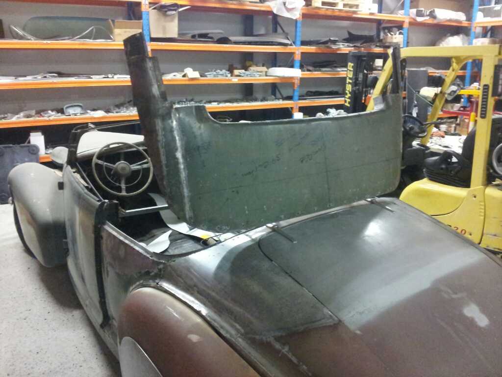

    Wait for it. Last piece of parade boot can now be detirmined. I kept it rather fat which really emphasises the roadster style back. Going with low square buckets , no back seat. rps20141203_220229.jpg rps20141203_220145.jpg rps20141203_220114.jpg

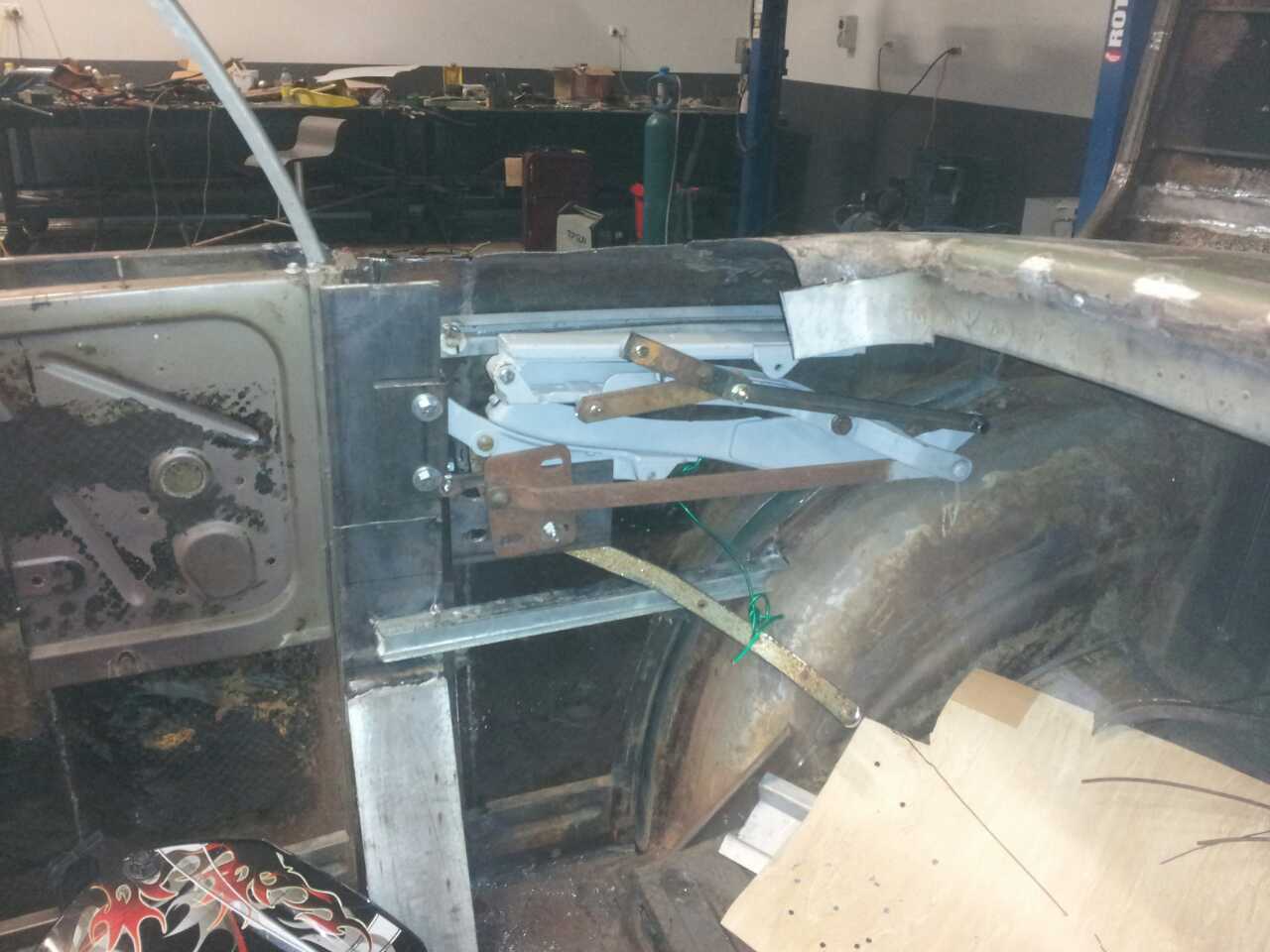

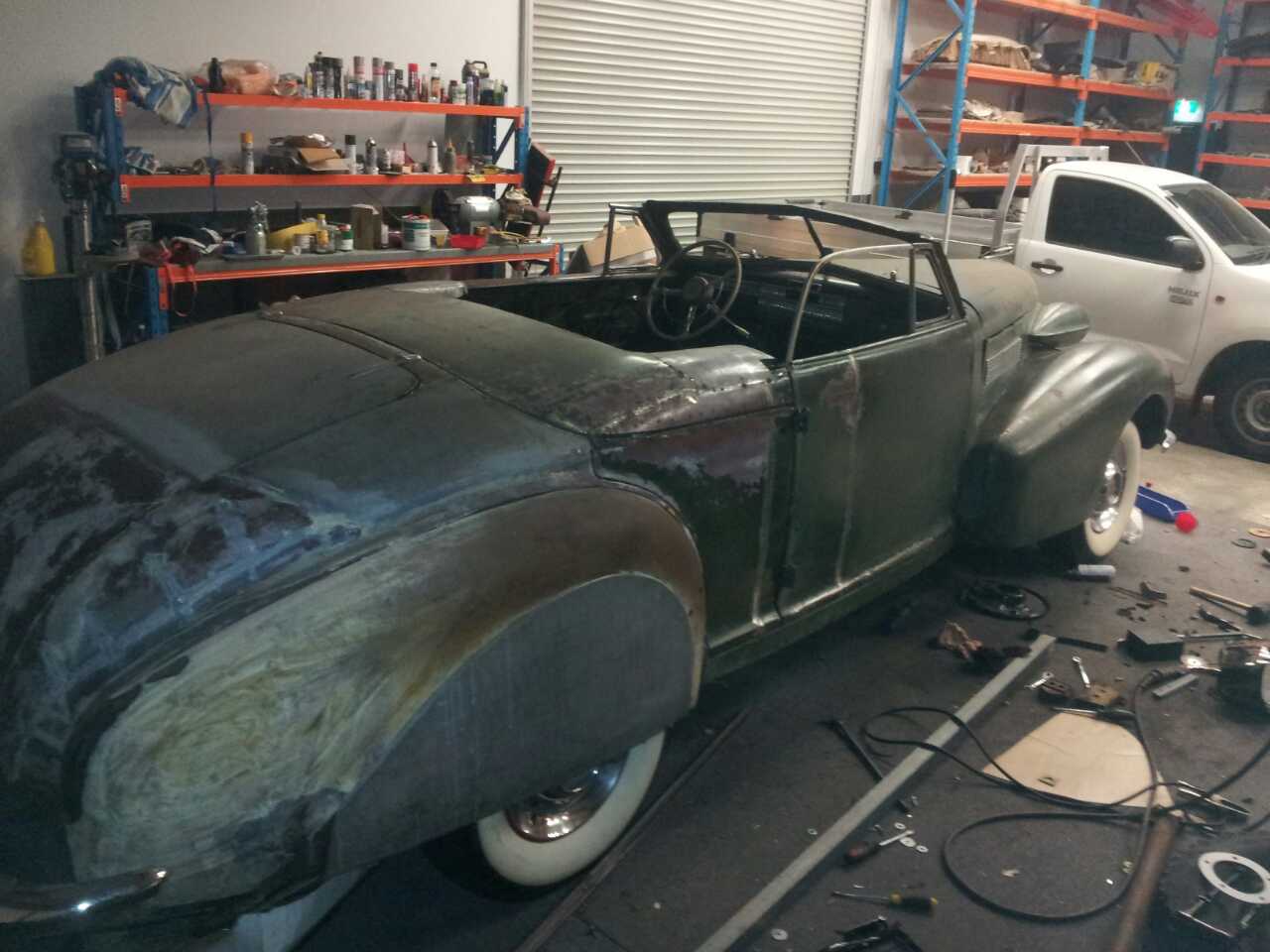

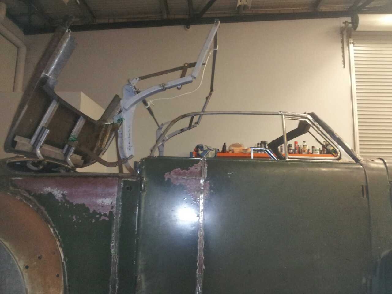

    This will be it for a month or so. Going back to Brisbane for Xmas. Gonna have withdrawel symptoms while im away. Last night was another milestone. Foldaway top in action. Works like a bought one. rps20141206_201843.jpg rps20141206_201814.jpg rps20141206_201749.jpg rps20141206_201722.jpg rps20141206_201701.jpg
  29. 13clicks
    Joined: Dec 2, 2014
    Posts: 166
    13clicks
    That is ****ing bad***!
    Sent from my iPad using Tapatalk
