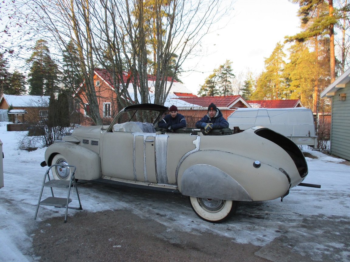

    I have also been planing same kind of project about two years (after the I got my '55 Caddy finished). Four months ago I found '40 Caddy from Michigan and bought it to here Finland.
    Month ago friend sent me link about your project and told that some guy from Australia is building same kind of kustom, WTF!! Luckily we are living in opposite sides of the Globe! :D
    My plan is built 2-door Roadster with Duvall-style windshield and soft-top. I'm trying to build very long and low 'coupe rear. Here is some pics from my project: https://www.flickr.com/photos/129186651@N08/

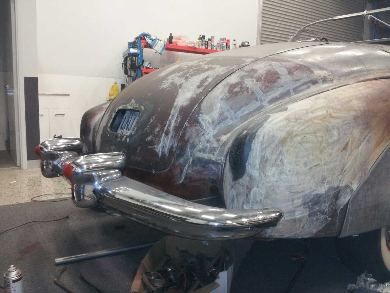

    I extended my trunklid and sectioned the trunk sides. It really helped to get the bum to flow better. Look at my pics carefully prior to doing it cos You need to put a filler piece in above the fender lips.
    Glad these Caddies are finally getting some attention. They are just beautiful. Why dont you start athread on the CCC or here or both. Merry Christmas. Quentin.

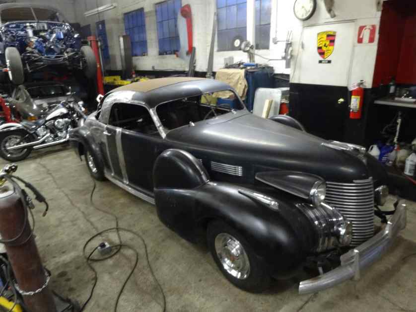

    There is a revolution afoot , I tell you. Hamber John Walker sent me these pics a few weeks ago. Hope it is ok I post them John??? You might see that he used the trunk from a 41 coupe so it has adifferent rear profile to mine. Looking good and all have slightly different styles. The great thing with Customs. All different. All Unique. 1940 John Walker custom.jpg 1940 John Walker Rear.jpg 1940 John Walker Side.jpg

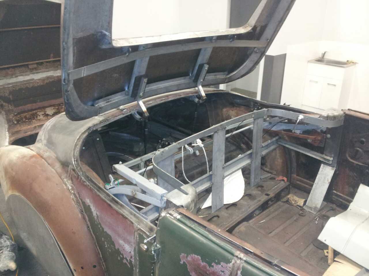

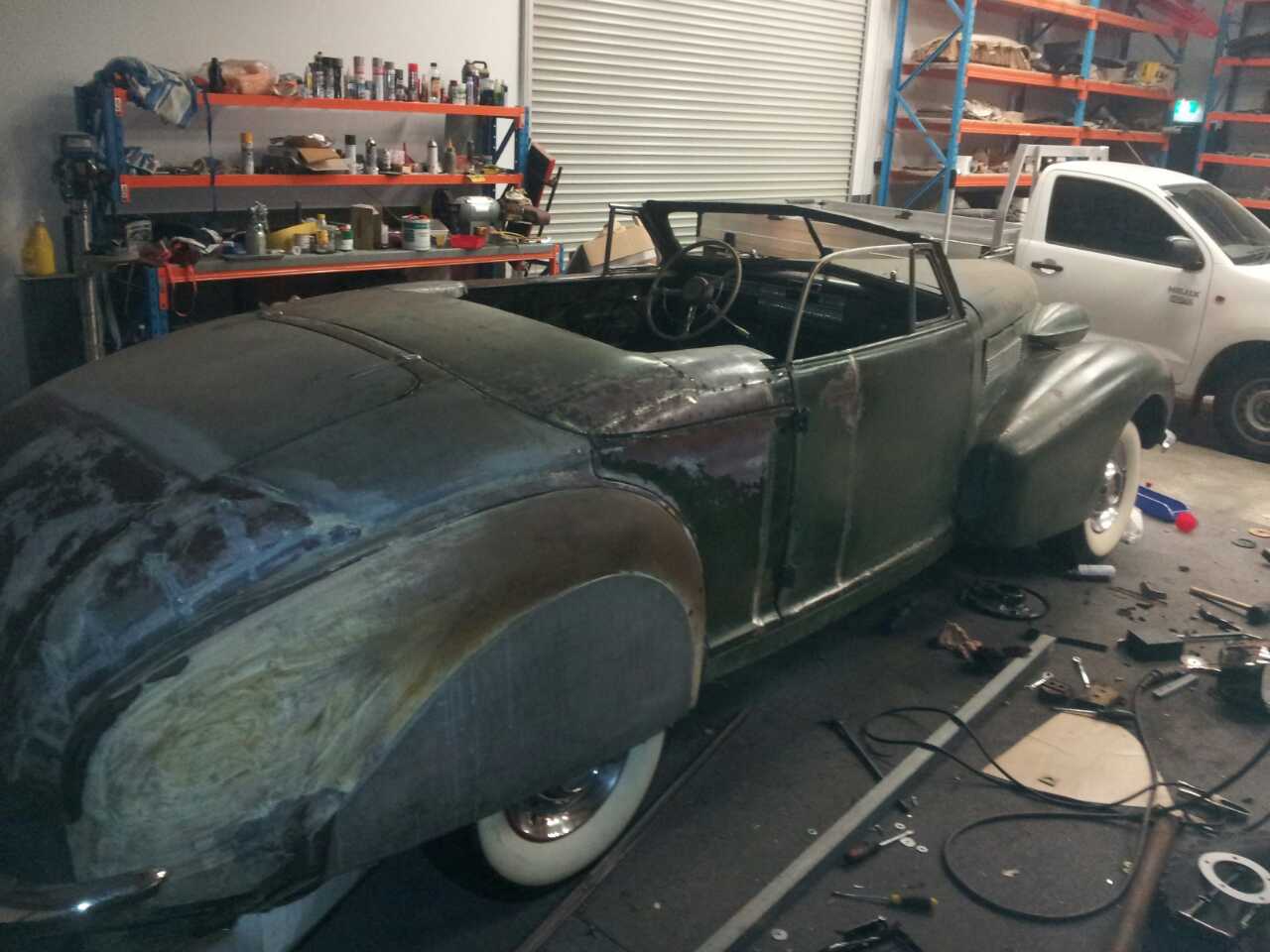

    Been awhile since i did much as i was away for amonth. Back onit and tackling lots of structural details around the rps20150123_223016.jpg rps20150121_201322.jpg parade boot. Built up a frame to locate alock . Not gonna have a back seat. will be a trimmed out"extra cab" if you like. rps20150123_223016.jpg

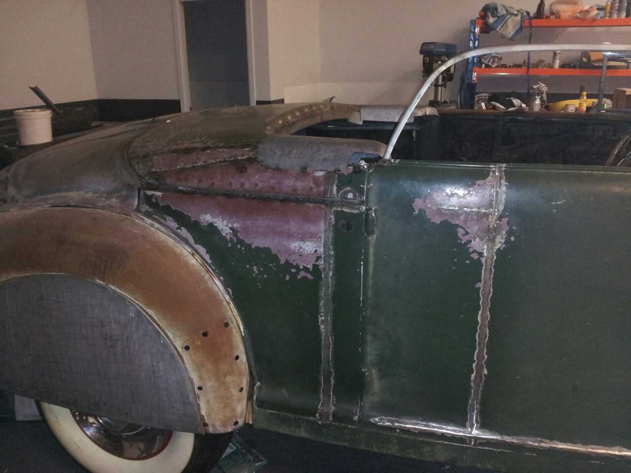

    Another day of work around the parade boot. Tidying up small details. Really happy with t rps20150126_195243.jpg rps20150125_170330.jpg rps20150126_195151.jpg he result. Smooth streamline look i wanted.

    The last pic...wow.Looks wonderful.Really look forward to the day you gonna lower this piece of art.Great work.

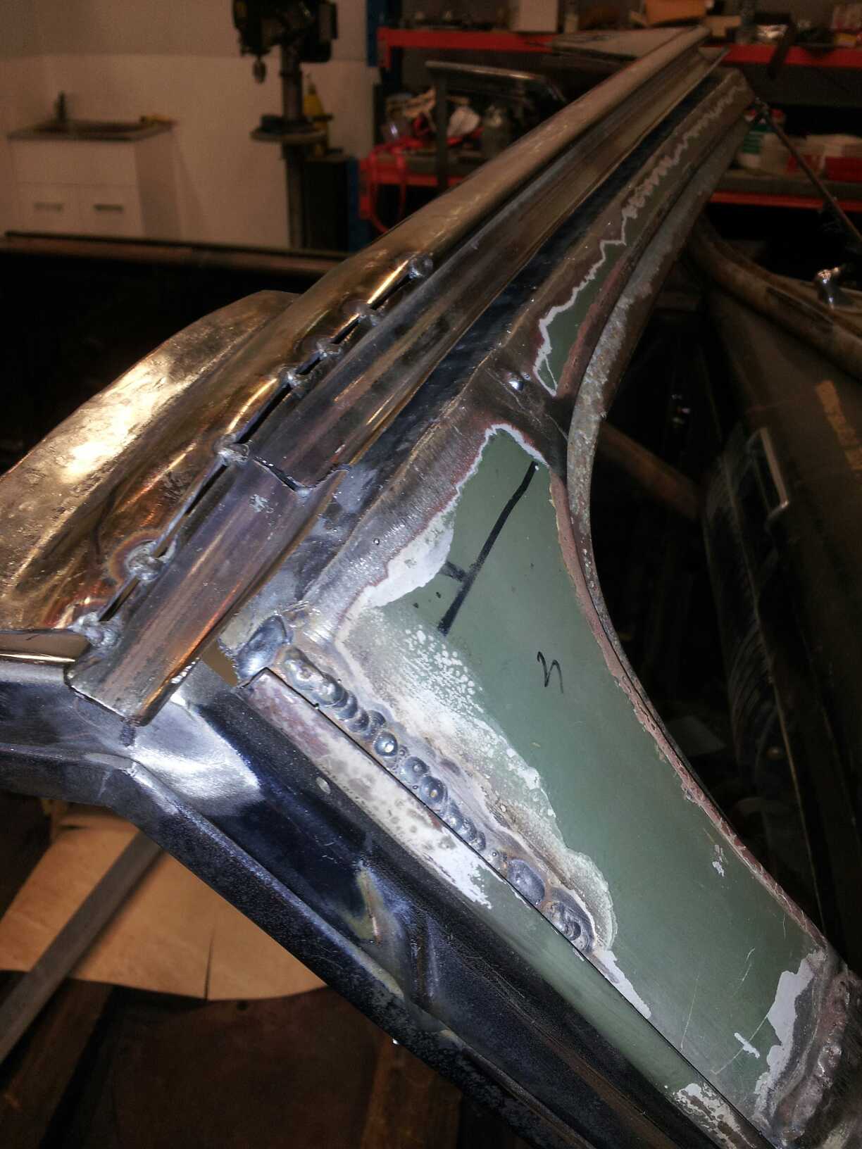

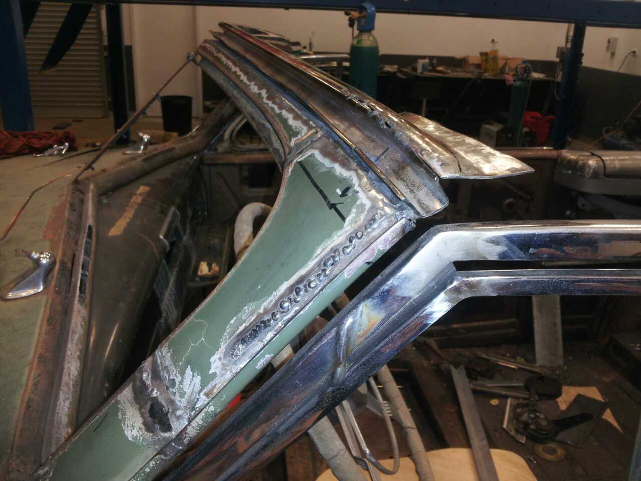

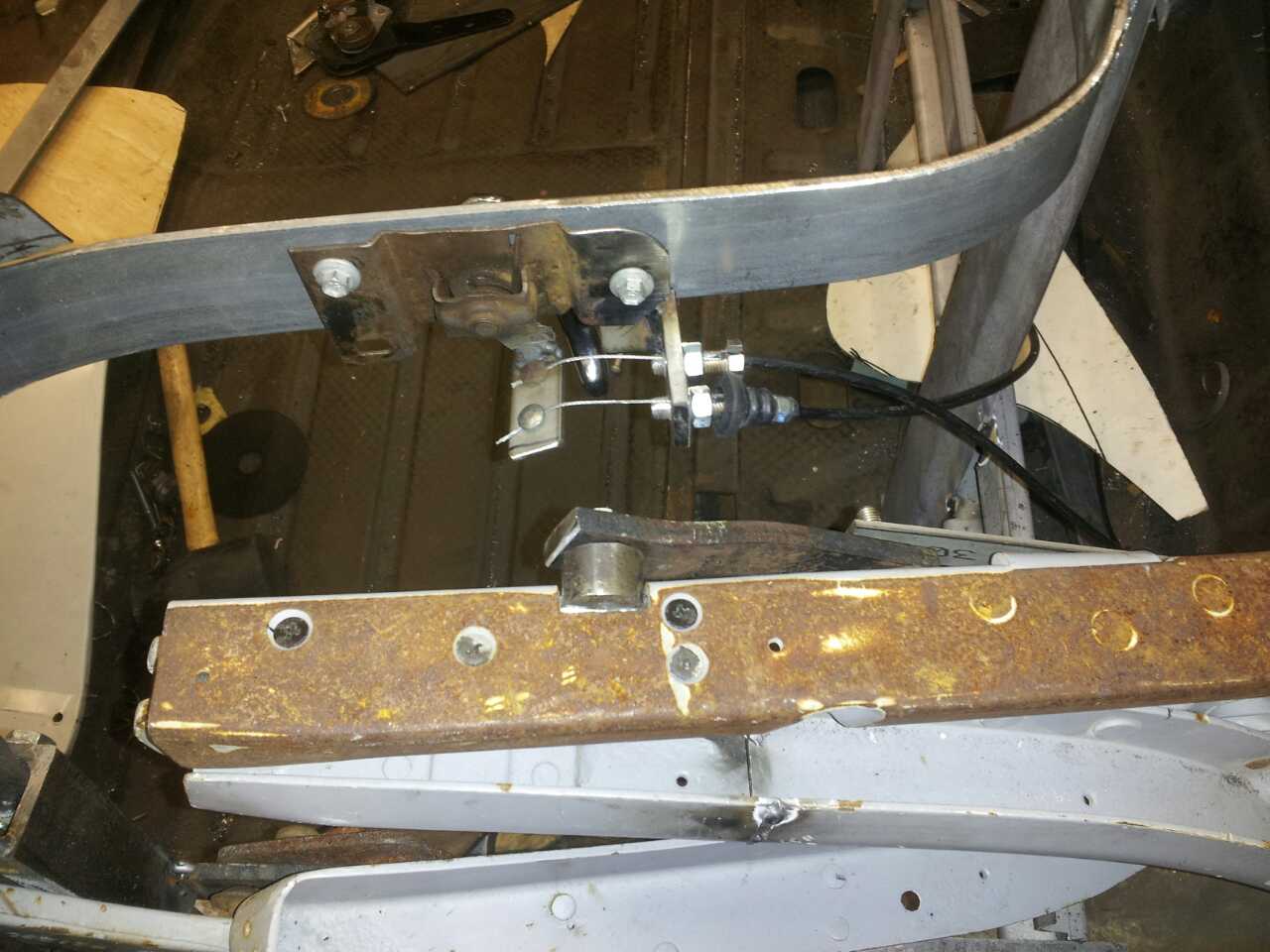

    Made a header for the soft tp last night. Also put cable operated release handle on the parade boot as well as finished up the structural support. Crossing little jobs off the list one by one. rps20150130_202228.jpg rps20150130_202141.jpg rps20150130_202108.jpg rps20150130_202029.jpg rps20150130_201949.jpg

    Hi Quentin..Really intrested in the fabrication of the header bar pieces on the windscreen frame..want to do the same on my 41 Caddy to fit a Carson top
