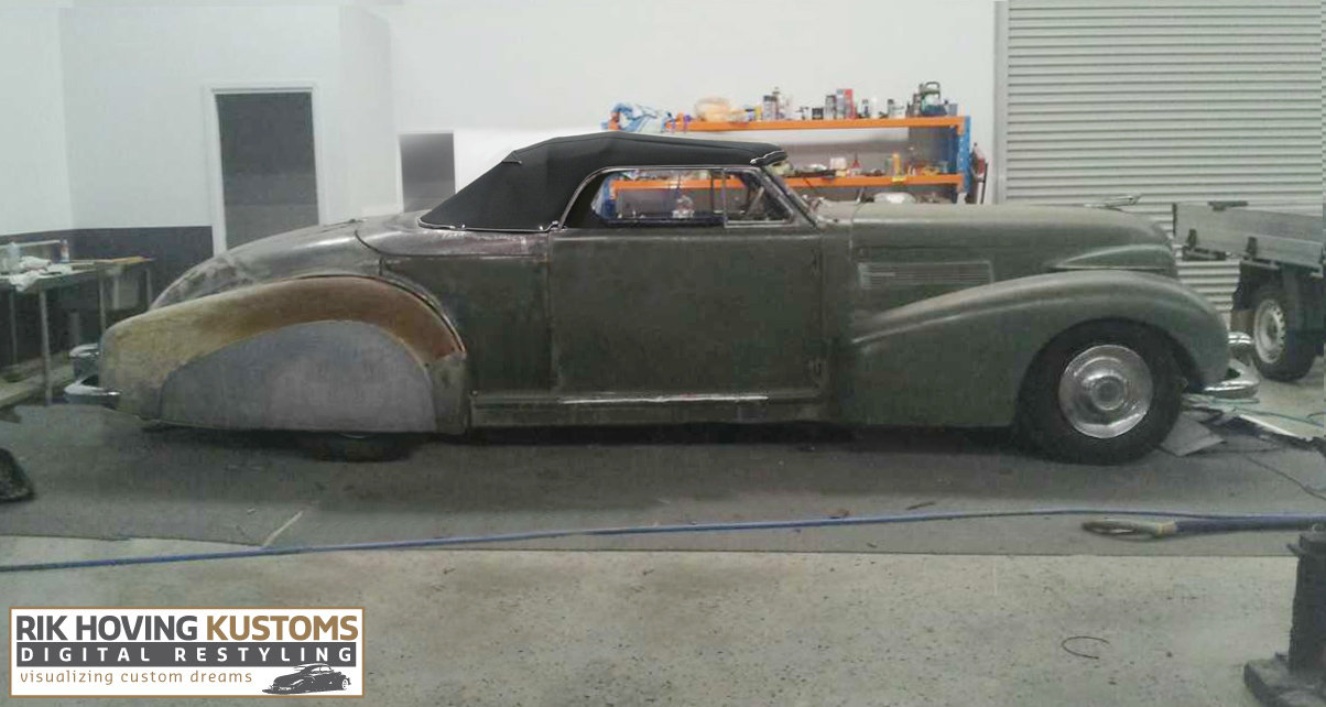

    Tony, this was the image I worked with. Quentin placed the tubing on the parade booth to show where it needed to end.
  4. CadMad
    Joined: Oct 20, 2012
    Posts: 886
    CadMad
    Because I have gone for a retractible conv , ie it has to fit under the parade boot,I am limited for space to get it to fold up and fall below the belt line.
    Rik and I discussed this and that is why I used Riks talent to get afeel for the look.
    I am thinking about alternatives for the rear bow to maybe be detachable , or to slide over itself into a less bulky form.
    The other thing to consider is that i dont wantthe soft top to be the same shape as the hardtop.
    I think a short top looks quite dramatic from a 3/4 veiw as it emphasises the rear end and big bottomed girls.,you make my rockin'world go round.

    Even the 53 Eldo hsd the same shortened top profile for exactly the same reason. The standard issue conv had the top attached to the edge where the Eldos parade boot ends, a good 6inches,rearward.

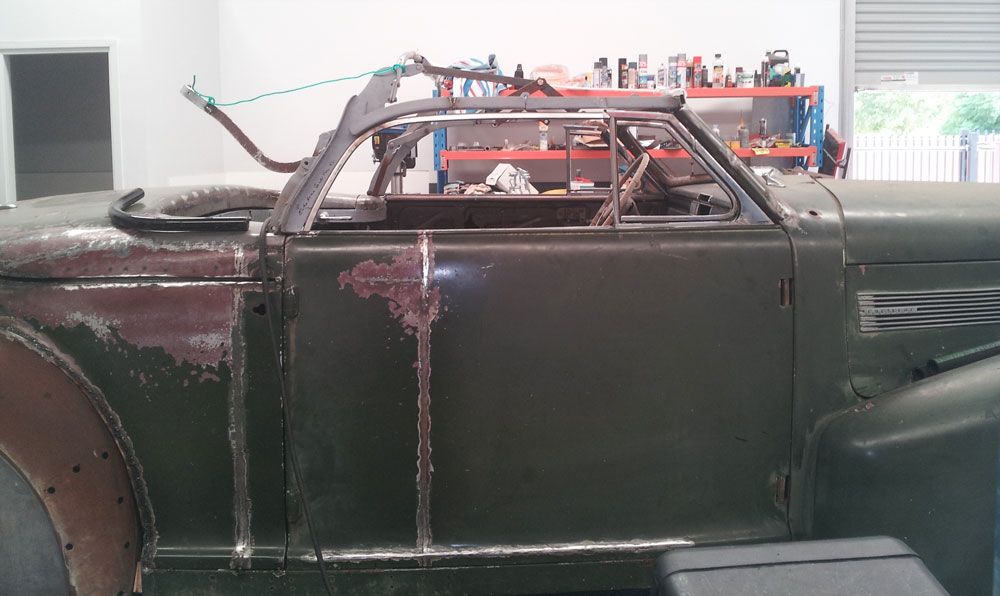

    Finally had the guts to cut the br*** windshield frame surround. I was nervous that it would be difficult and so kept putting it off. But it went like a charm. took out 110mm of developed length. rps20150201_202200.jpg

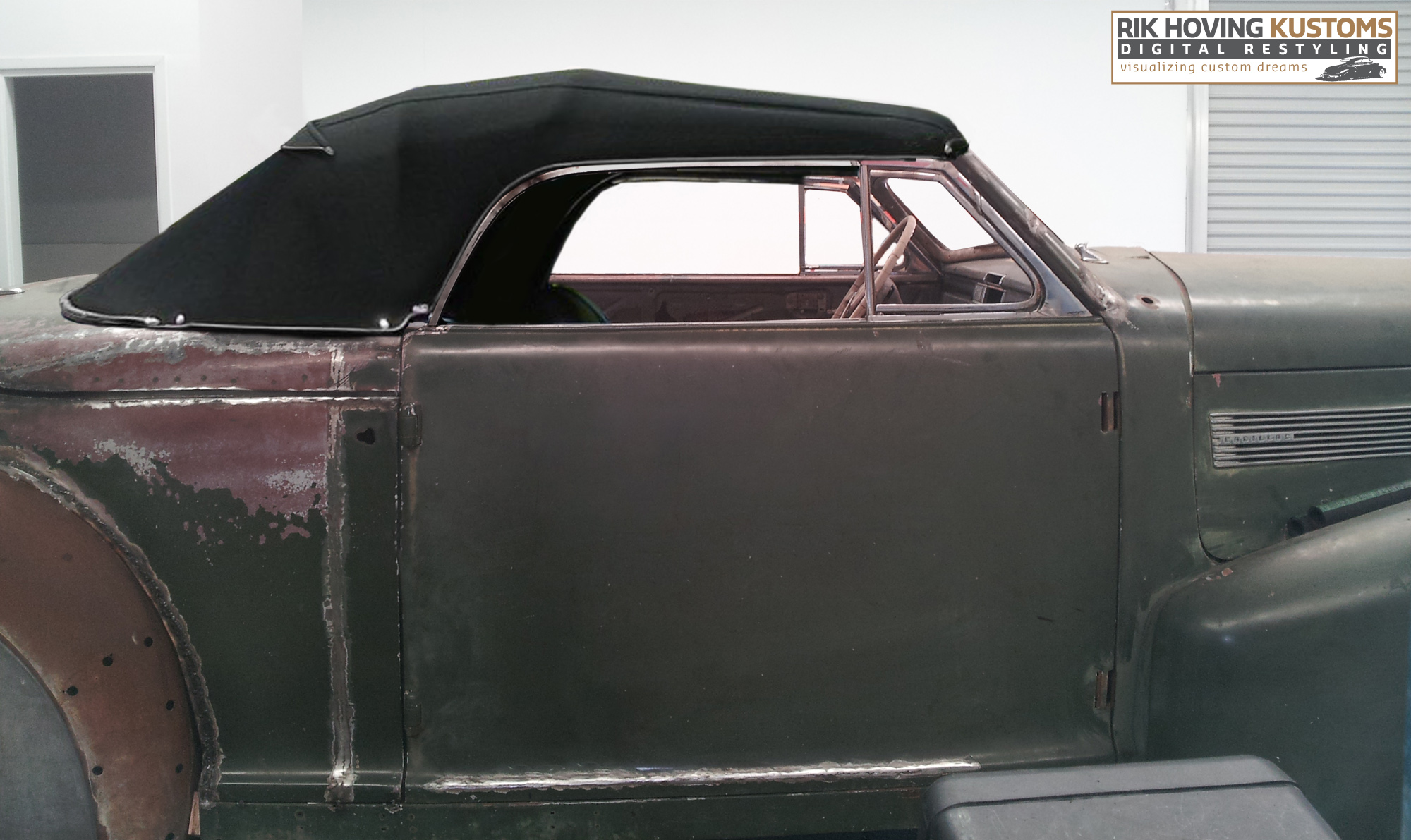

    So to show what a great tool digital customising is check out Rik's "option 2". I'm gonna have to rethink the lower bow and perhaps sleeve it so it collapses on itself. RHK-Quentin-39-Cad-Folding-Top-shape2-03.jpg RHK-Quentin-39-Cad-Folding-Top-shape2-01.jpg

    Peanut 1959
    Idunno, I like the more formal soft top, myself.
  12. robkirk71
    Joined: Jan 19, 2013
    Posts: 5
    robkirk71
    from Austin, TX
    I find option #2 to be more appealing to my tastes.
  13. Hot Rods Ta Hell
    Joined: Apr 20, 2008
    Posts: 4,839
    Hot Rods Ta Hell
    I favor the 2nd option as well.
    The formal top looks nice but out of place on a Custom. The Custom (option #2) soft top is more appropriate for a Custom and more closely resembles the chopped hardtop (I'm thinking Barris or Ayala shop/look c. 1950). The formal top looks like it was set on the car while the custom top looks like it grew there. And when all is said and done, the chopped hardtop is what dialed in the lines of your creation. Hats off to you and Rik's eyes for detail and your building skills.This has been a fun project to follow along on!
  14. 50Fraud
    Joined: May 6, 2001
    Posts: 10,099
    50Fraud
    I do think that works better with the overall dimensions of the car. The top may now be longer than is really necessary, but it works with the extravagant proportions of the vehicle itself.
    ynottayblock likes this.
  15. Gerrys
    Joined: May 1, 2009
    Posts: 326
    Gerrys
  16. The 39 guy
    Joined: Nov 5, 2010
    Posts: 3,844
    The 39 guy
    #1
    #2
    Both tops are nice. I have no experience or professional eye for such things but I prefer #2.
  17. CADSLED50
    Joined: May 27, 2009
    Posts: 34
    CADSLED50
    My vote is the second one with the more streamline look
  18. flynbrian48
    Joined: Mar 10, 2008
    Posts: 8,787
    flynbrian48
    I like the second version much better also . It flows better than the original image, which doesn't look chopped because of that longer third bow. (Curtain bow)
  19. Finnrodder
    Joined: Oct 18, 2009
    Posts: 2,971
    Finnrodder
    from Finland
    The second version looks good to me too.
    And so does everything else in this build thread.Keep up the good work!
  20. chickenshift
    Joined: Feb 14, 2010
    Posts: 363
    chickenshift
    Great build so far. I'm diggin option 2
  21. i.rant
    Joined: Nov 23, 2009
    Posts: 4,890
    i.rant
    IMHO option #2 has a smoother, more natural flow. This is an outstanding car to put it mildly. Amazing craftsmanship.
  22. grease4life
    Joined: Apr 24, 2008
    Posts: 234
    grease4life
    Option 2 for sure. Glad your going this route!
  23. Peanut 1959
    Joined: Oct 11, 2008
    Posts: 2,189
    Peanut 1959
    Will the parade boot need to be modified to make option #2 work?
  24. CadMad
    Posts: 886
    CadMad
    No. parade boot is given. So is the space that the top folds into. To fit the larger rear bow under means that it has to collapse on itself. I'm gonna go to a camping store and look at tent poles
