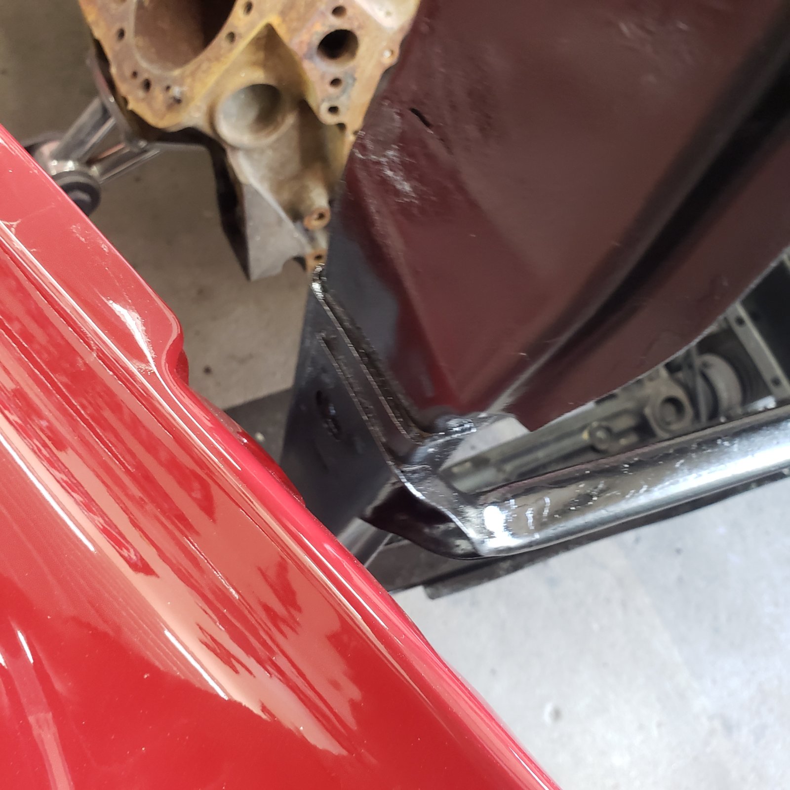

    Don't you love putting **** together that you didn't take apart?? The front fenders on a 39 Chevy, do they bolt directly to the radiator support? Am I missing something? Signed, **** this **** in Kentucky

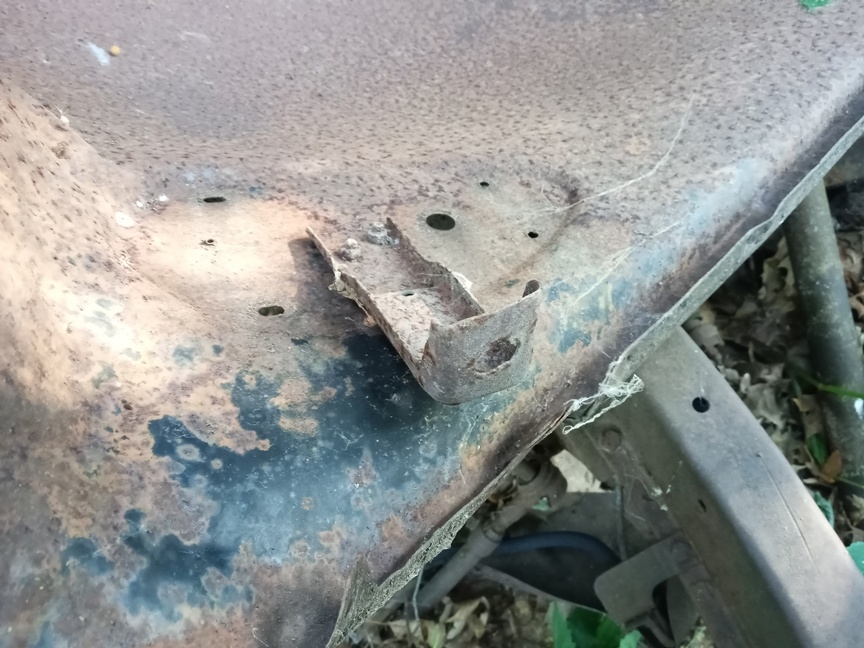

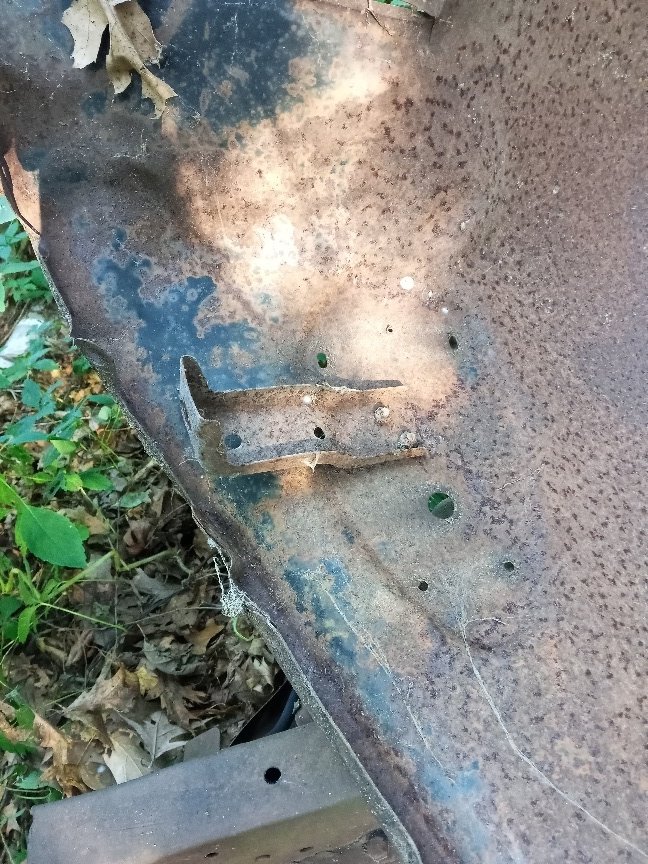

  10. 24riverview
    Joined: Jan 13, 2008
    Posts: 1,122
    24riverview
    The inner fenders and grille tie the whole clip together but this piece is what actually bolts fender to support.
    Bet you wondered what the other holes under headlight were for...:D
  11. Lloyd's paint & glass
    Joined: Nov 16, 2019
    Posts: 10,914
    Well I'll be a son of a *****! There's what I needed to see! Thank you my kind sir

    Thanks man. I'm gonna look in my boxes of parts first, because the owner still has the grille, so I don't know the spacing i need.

    Easy bracket to make, but not knowing the space needed for the grille to fit makes it impossible. The chin piece under the grille is ****ed up, so I need the spacing to be correct so I can use it to straighten the chin piece. Aggravating man lol

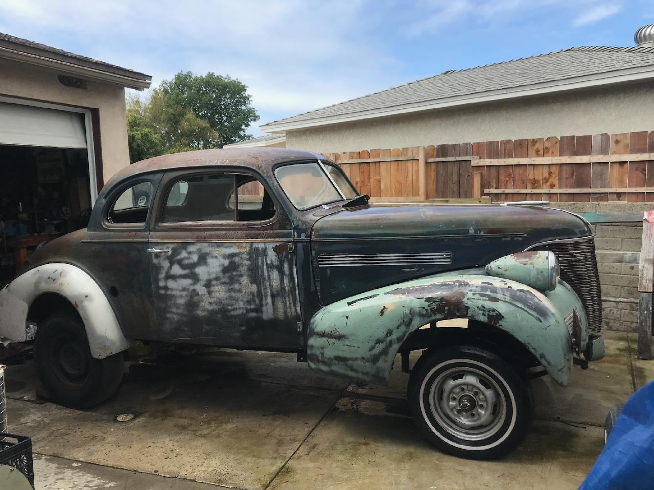

    My buddy Gerald took this picture of his, and lumpy sent me a couple of his neighbors. 20240814_175501.jpg IMG_5212.jpg IMG_5213(1).jpg

    BB427 has what I think is the best way to go about this. For what it's worth, a couple more pics of the brace that mounts under the headlight pad.
    I bought my car complete 14 years ago, and when going thru spare parts a couple years ago, I had these braces in there, all pretty and painted. Asked on a 1939 forum what they were, and finally installed them! Had driven the 39 about 20,000 miles by then, with no slumping or problems, but glad I now have them where they should go. 20210213_155316.jpg IMG_2700.jpg
