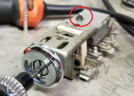

    My 39 Chevy light switch keeps blowing 30 amp gl*** fuse thats attached attached to the back of switch...can anyone tell me how to get switch out or off the dash.and does replacement fuse have to be 6volt..as that is what is in it
  2. squirrel
    Joined: Sep 23, 2004
    Posts: 59,920
    squirrel
    is the wiring original?Usually when a fuse blows, it's because a wire shorted somewhere in the car.
    Should be a ****on on the light switch that lets you pull the knob all the way out. First disconnect the battery, then pull the knob out enough to turn on the headlights. then push the ****on, as you gently pull the knob out the rest of the way.
    the ****on is circled, it might or might not look exactly like this. It's a generic internet picture.
    After you get the knob out, you need to unscrew the nut that the knob shaft goes through. I don't remember what they look like, it's been a long time since I had a 39, but usually a large screwdriver might fit the slot.
