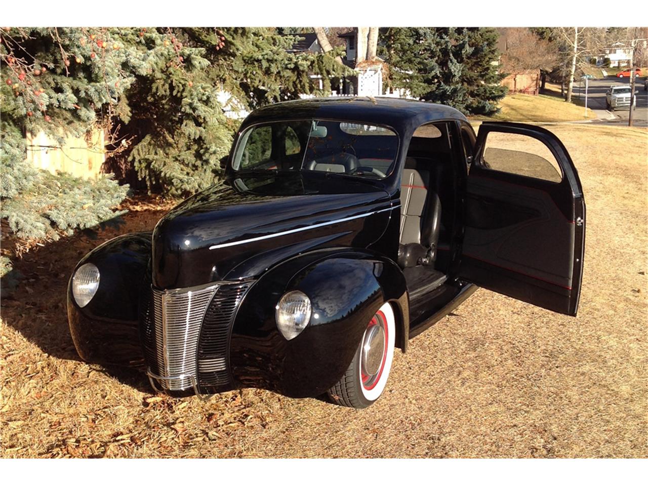

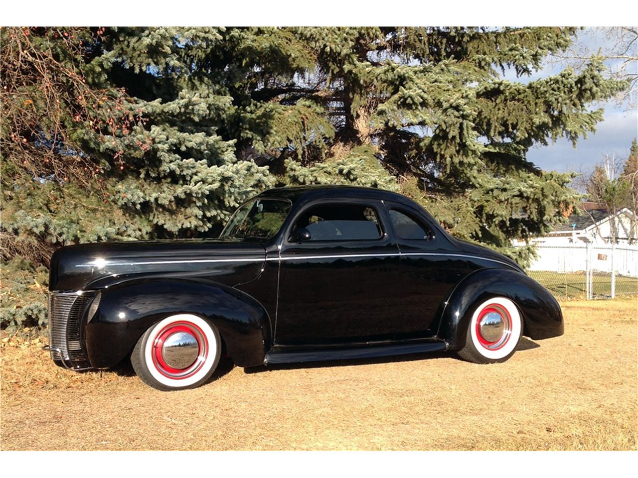

    I have 1939 Fordor front doors on my 1940 deluxe coupe I like the 1 piece gl*** (smokers window) I don't smoke but I think it looks better and no noise from the vent windows and less possible leaks I am uploading some photos
  15. geoford41
    Joined: Jul 26, 2011
    Posts: 766
    geoford41
    from Delaware

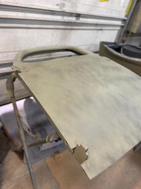

    ok finally found the 2 reworked doors trimmed to fit and reweld seem
    I choose to cut down the original folded sheet metal over (about 1/2" ) and cut out section to make the removed section fit as stock coupe top.
    I have trouble,uploading the word doc I will try another post

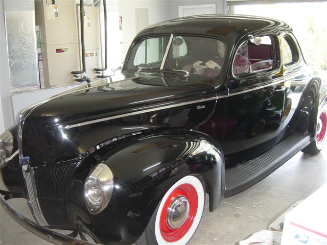

  21. simplestone
    Joined: Aug 18, 2010
    Posts: 955
    simplestone
    The 38 club coupe doors are longer than on the regular coupes. I'm not sure how they compare to tudor sedan doors, tho.
    Below is a picture of the club coupe (not my car).
    And here is a regular coupe (not mine either).
    Maybe the club coupe door is what you are looking for? Or find a club coupe and use a regular coupe roof and quarter window on the rear portion?
    Hot Rods Ta Hell likes this.

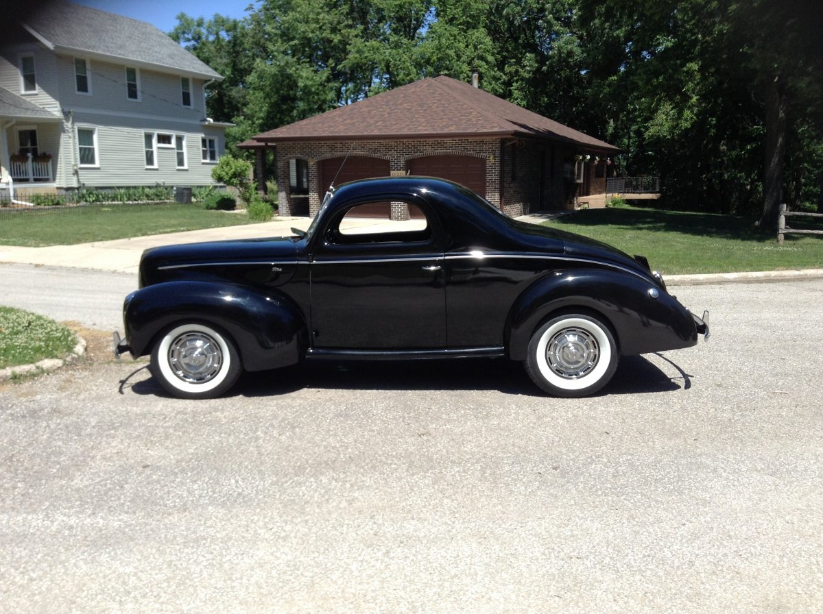

  29. The 39 guy
    Joined: Nov 5, 2010
    Posts: 3,778
    The 39 guy

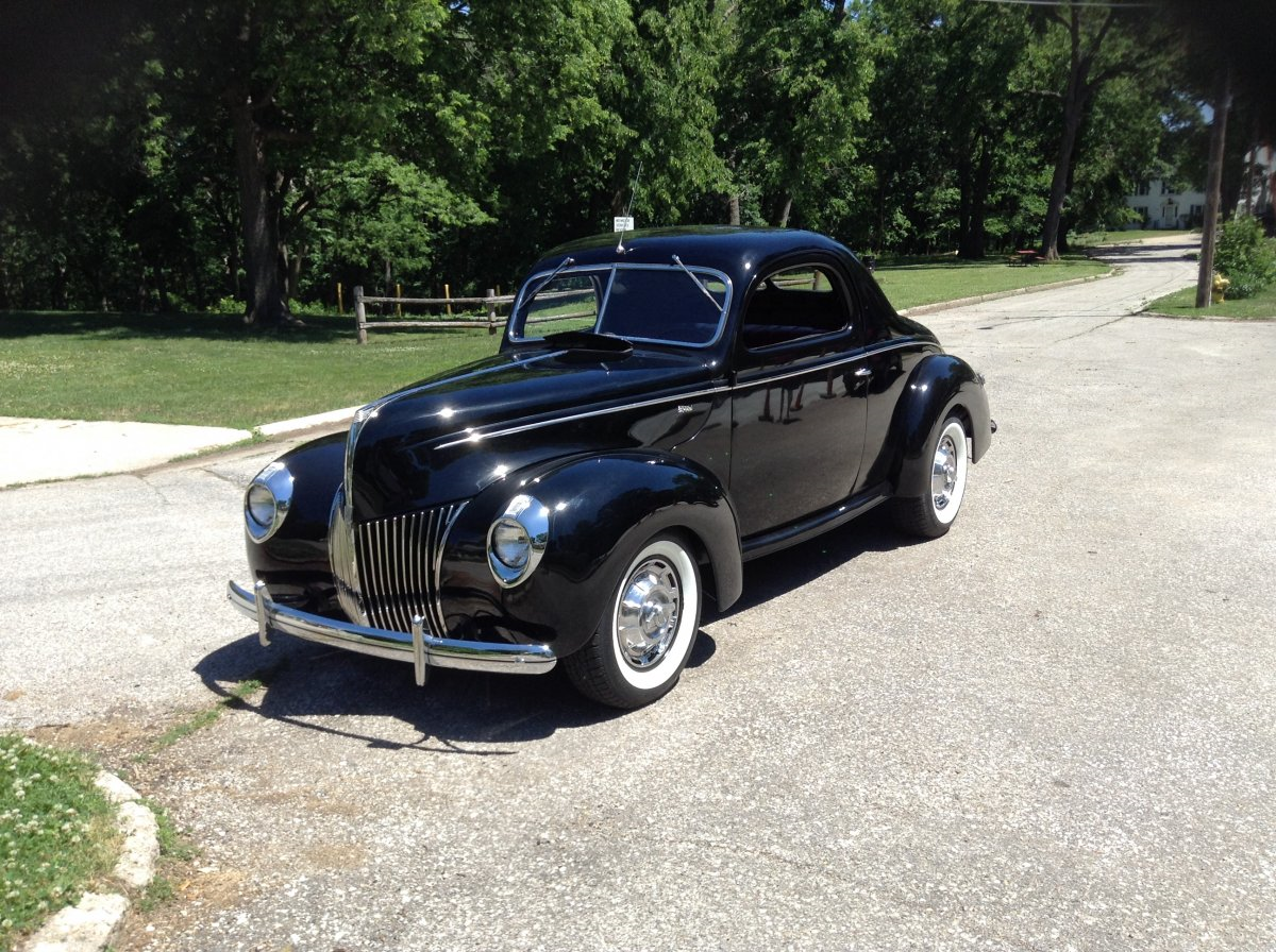

    I am not clear on what you are wanting to do but here is a 3window with longer doors slanted B pillars.
    Another
    Even though I have shown many examples I don't want anyone to think I am in favor of making this change or any change to the body lines of the 39-40 ford deluxe coupes. Some people like it though and a few can pull it off well enough to make it worth while. I do like the last illustration however. I am going to look for a 40 coupe that I think Sam Foose built many years ago and will post it here if i find it.
    Here are the pics I could find of Sam Foose's 40 I think it has the sedan doors. Not sure though. Foose 2.jpg View attachment 5140984
