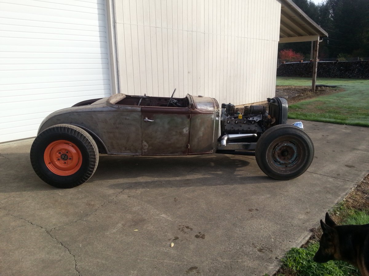

  5. You mean like this? Photos of my chassis were all over here a few years back.
    It's been on hold for a few years but here is where it's at now.
    Also I say Screw the 5 speed. You will get maybe 5 feet in first gear and with a little 21 stud it's going to lay down on ya in 5th on any kind of up hill grade. All you'll end up doing is shifting way more than you'll like. Way over rated and unnecessary in my book. It's just Flap for bench racing B.S. talk. If you really want something that 's just a little better choice than a T-5 use a GM truck 3+1, at least you can get moving with First gear. The big plus is you can run a Hurst shifter. At least that part will look correct.

  6. And there you have 2 different ways to do the same basic job.
  7. Here's the car I base my T-5 comment on. We never use 1st gear.
    The Wizzard
    Texas Webb likes this.

  10. The channeled Roadster is mine. The Sport Coupe is my running buddy's. We were just getting ready to put the Top on. That was about 8 years ago. That car gets driven a lot and 1st gear is near never used at all.
