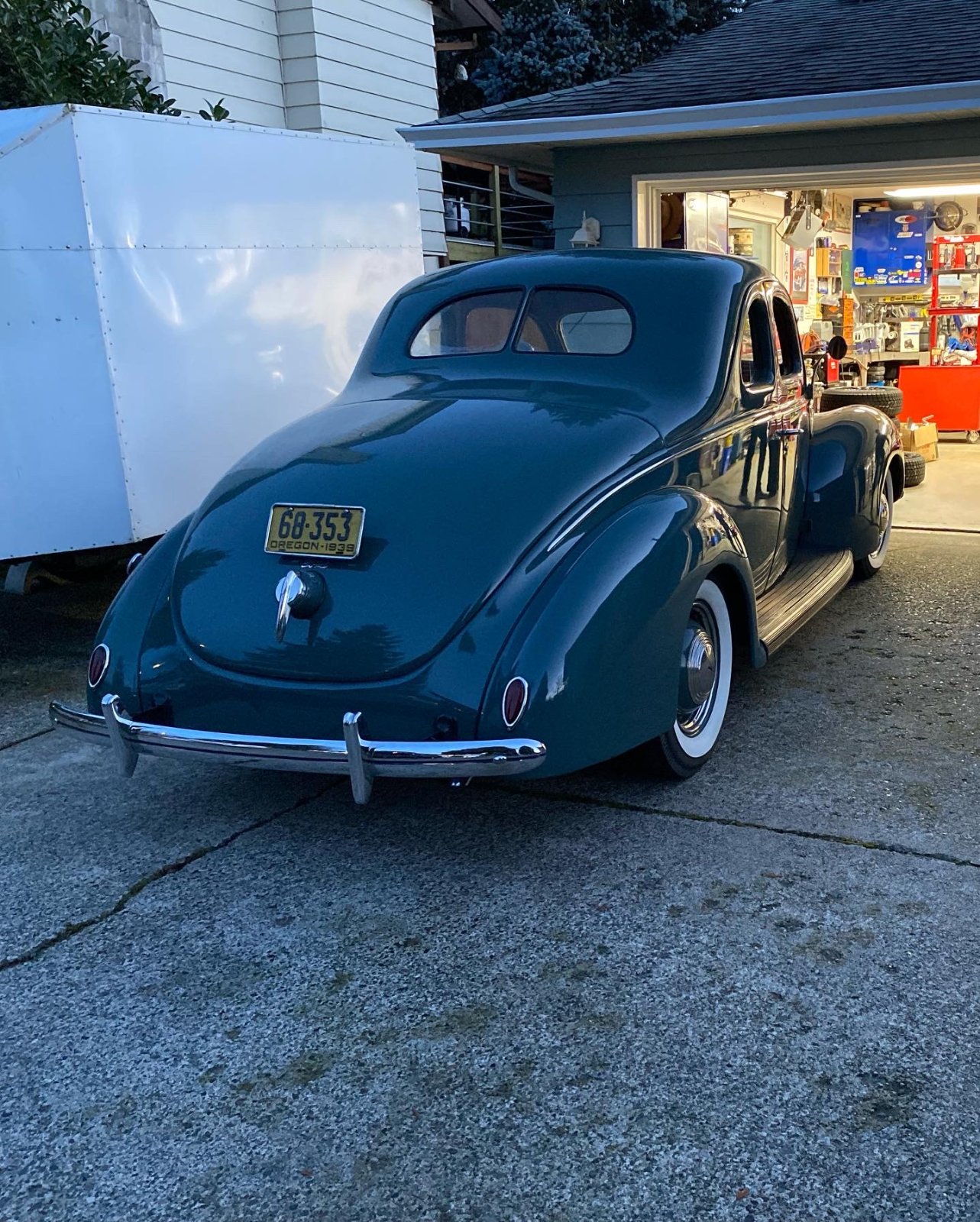

    Not much for updates on the car.
    Sorted out some electrical gremlins for the lights, a couple bad grounds on the headlights, a voltage drop to the taillights and a missing wire to the dash lights. All are working properly now.
    Installed a Edelbrock Sling Shot intake, still need to complete the choke and throttle rods and the fuel lines.
    Also got the Posie front and rear reverse eye springs. painted them up and installed them this weekend. Front came down another 1" for a total of 3". Supper happy with the height.
    But the rear actually came up 1.75" from where it was.
    It had a stock OEM spring that had been reverse eyed from what I could tell only lowered the rear 1" before. The Posie is supposed to be a 2.5" drop. But I don't think it is. I know it will settle, but not that much. :)
    So I will have to figure that out latter.
    House renovations have priority until Christmas, so the car will have to wait.
    Here are a couple pics.

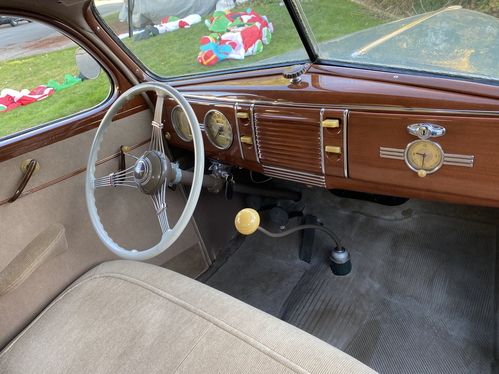

  23. toolz
    Joined: Dec 4, 2010
    Posts: 52
    toolz
    It’s a beautiful thing! Can you give us some interior photos too?

    Toolz, here are the only interior pics I have at the moment.
    The car is under a car cover right now due to house renovations taking priority for now.

  26. toolz
    Joined: Dec 4, 2010
    Posts: 52
    toolz
    No kidding!
    It’s perfect, even have the clock-setting knob, can’t see any room for improvement in here.
    Thanks for the pix.
