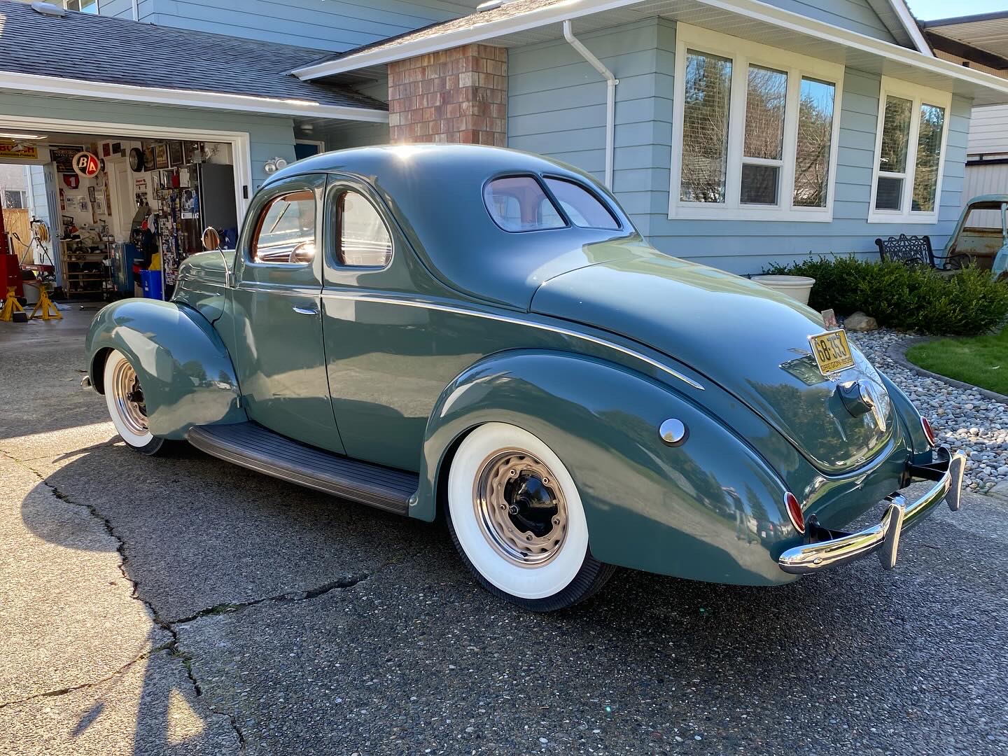

    I mounted and balanced my new tires today and got the 39 back on the ground. Rolled it out and cleaned it up and took some pics. Cant wait to get this thing on the road.

    Thank guys. Super stoked on the stance
    dugydog, I went 7.00x16 in the rear and 5.50x16 in the front.

    @woodz , did the Posies spring ultimately settle in the rear or did you take additional action? It looks fantastic!
    woodz likes this.
  9. woodz
    Joined: Feb 23, 2010
    Posts: 611
    woodz
    @anothercarguy I took the two smallest top springs and moved them to the bottom of the spring pack (they are basically spacers IMO) and then removed 1 leaf from the top completely.
    The spring pack seemed to thick when I first installed it, as in too many springs. The castellated nuts would not thread far enough to be able to install cotter pins. So with one spring gone, it fit perfectly.
    I also installed 41 Ford rear shackles which are 1/2" longer than 37-40 rear shackles.
    I think the ride height is perfect now, not too low but looks mean.

    @Busmania I have 6" to the front chin and 7" to the front of the running boards, lots of clearance IMO.
    @Zax The posies are Front #2040 and Rear # R40L. My front wishbones are not split.

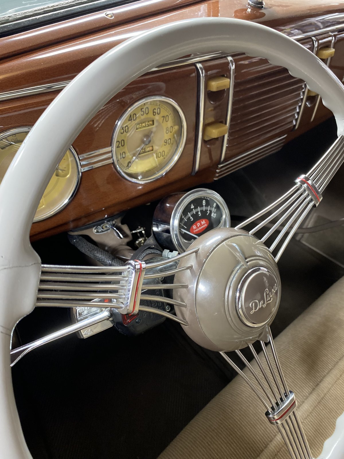

    Also picked up a converted Sun Tach at the swap meet and got that mounted and wired up when I got home yesterday. IMG_9509.jpg

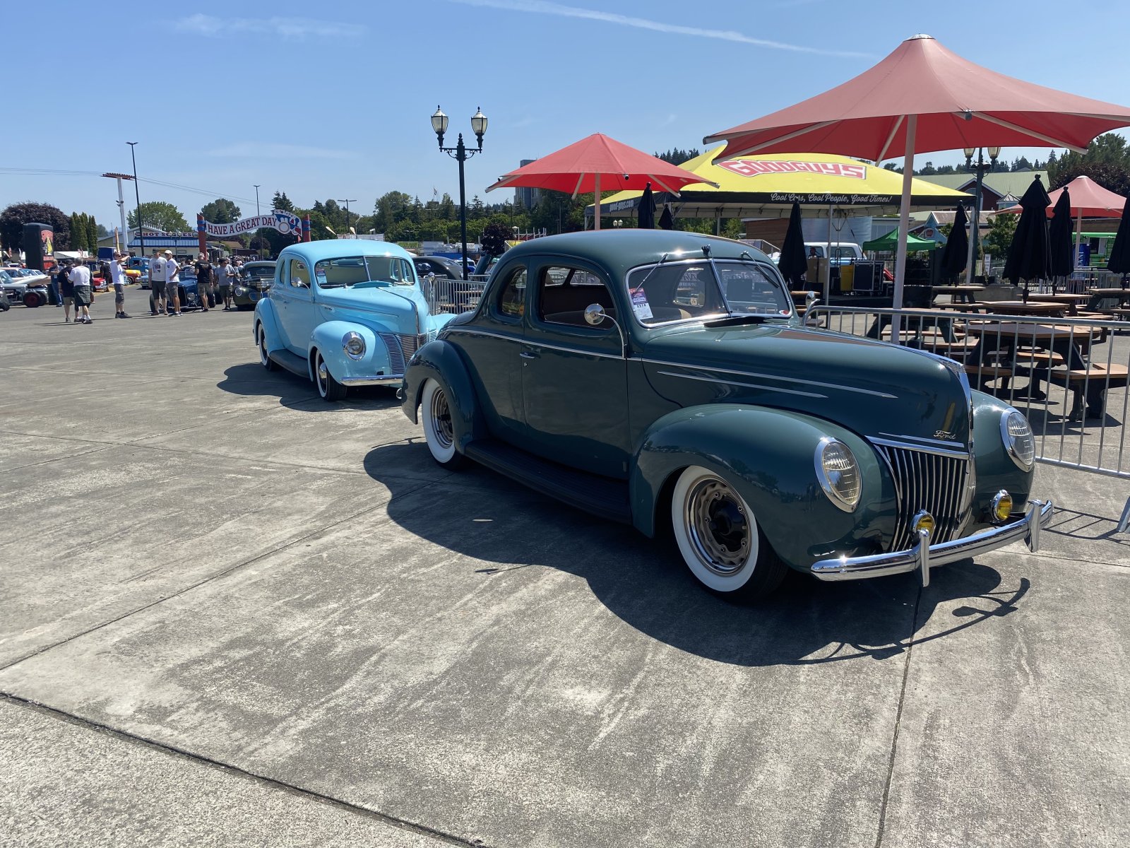

  28. woodz
    Posts: 611
    woodz
    Thank you.
    Saw you car during registration on Friday and snapped some pics there.
    Had to squeeze in front of your car when I saw it parked there in Sillyville. I just love it.
    Did you remove the vent windows from your doors or install 39 doors?
