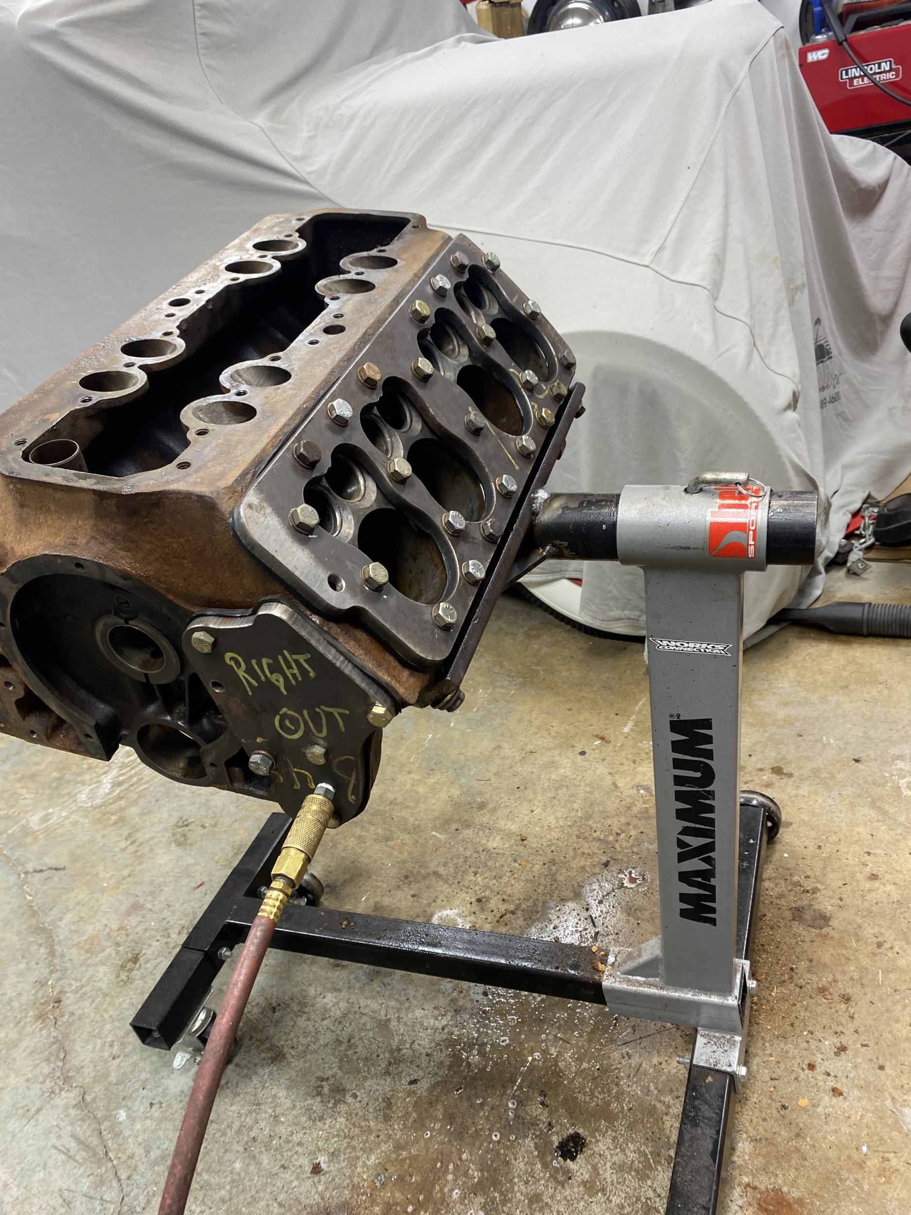

    The 39 developed a small coolant leak that I traced down to hairline crack on the side of the block. :( I ended up just sealing it up with some JB Weld (I know o_O) and it held somewhat for the rest of summer.
    I have always wanted to build a Flathead engine. So here we go.

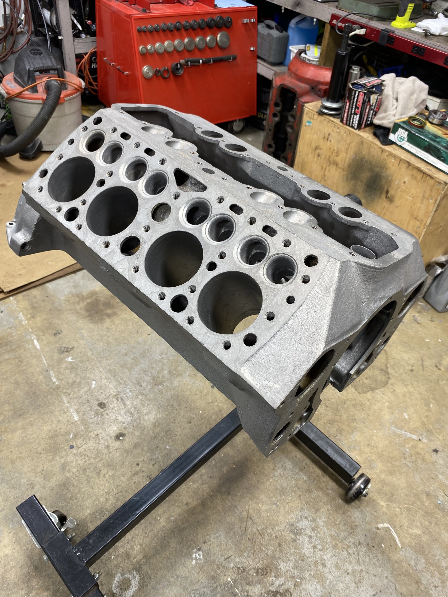

    After a lot of searching, I finally have a good block.
    P***ed a pressure test and then sent it out to get tanked and bead blasted.
    I cant believe how clean the coolant p***ages were. This engine was seized solid when I got it. It had been rebuilt a long time ago, and then got left in the rain for a few days for some reason. Then sat with the moisture in the cylinders for the last 20 years or so. Took a lot of soaking in ATF to finally break it free but it came apart eventually. Has adjustable lifters and new valves that I will be able to reuse. IMG_0367.jpg IMG_0481.jpg
    Time to do some mild porting and relief job on it.
    Ordered a **** rotating ***embly. 4 and 1/8" stroke and 0.125" over pistons.
    I managed to pick up a Kiwi L100 Cam from KiwinUS on here.
    Not trying to break any dyno records with this, just want a strong engine to add to the enjoyment of driving this thing.
