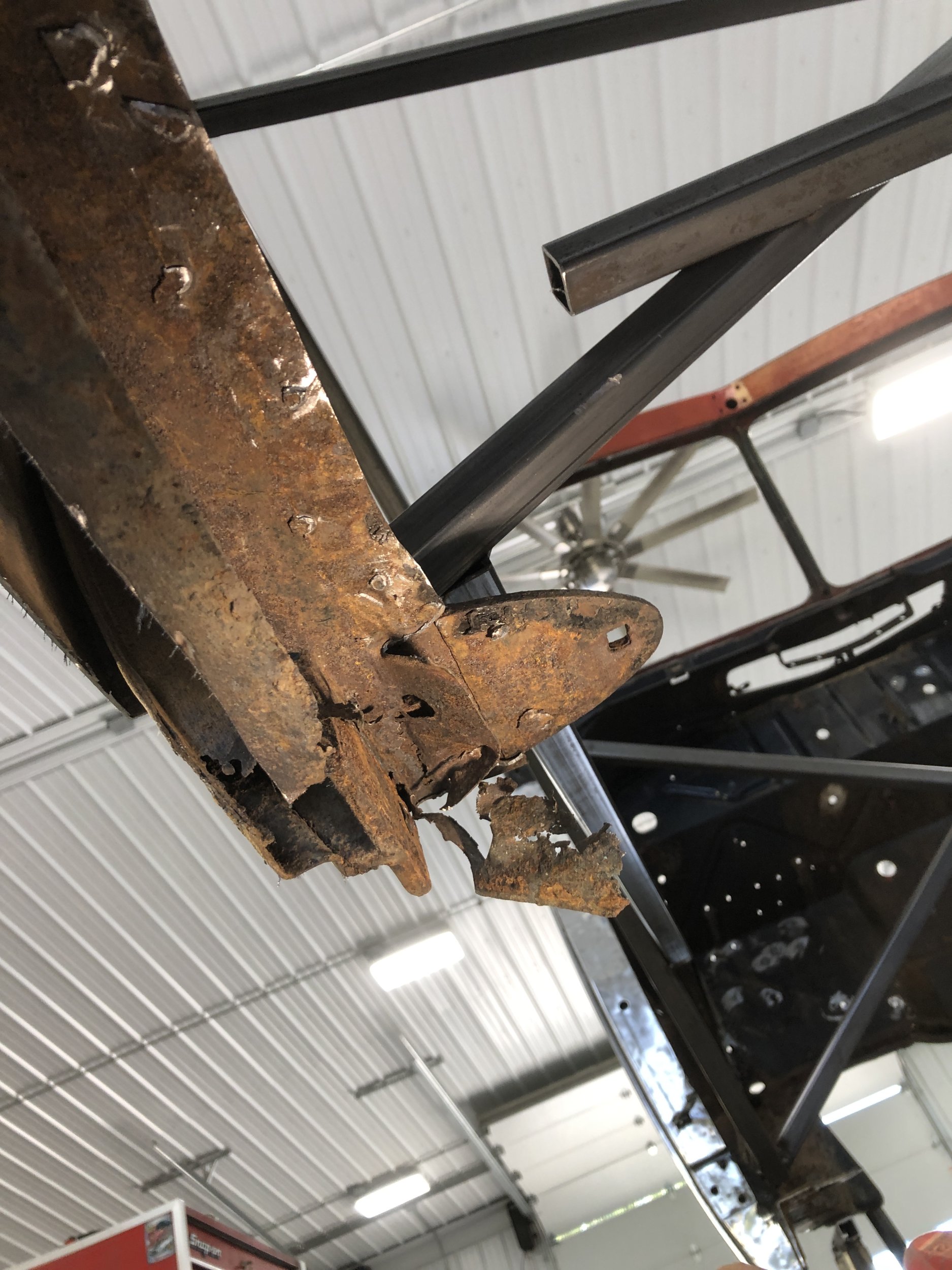

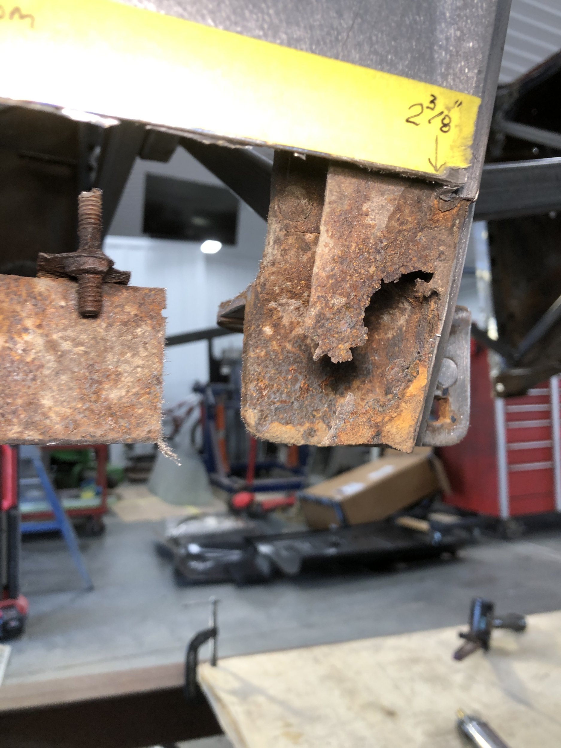

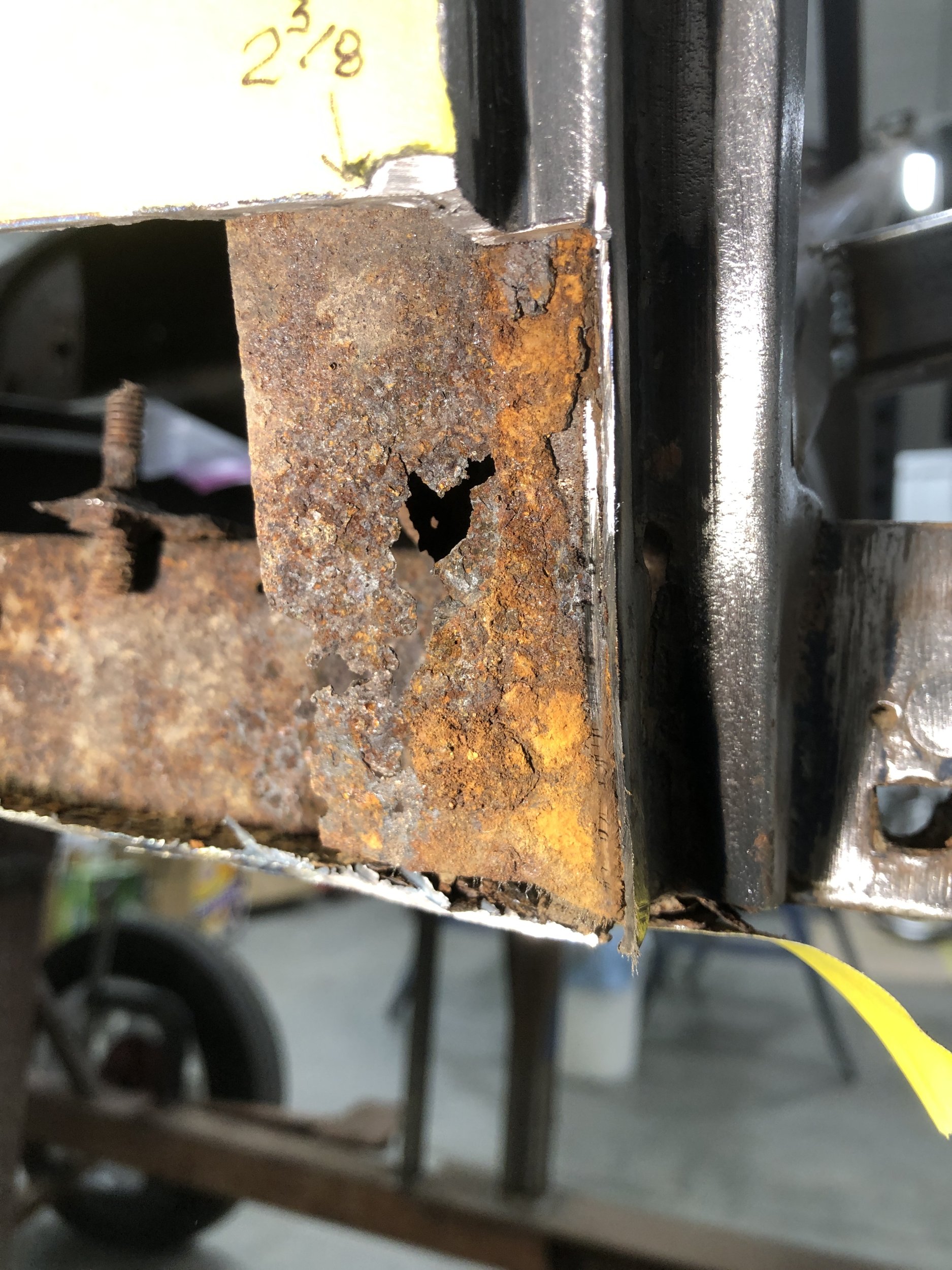

    Moving back to work on the body, I cut the bottoms off of both quarters front area to get to some rot that needed cut out and fixed. IMG_8066.jpeg IMG_8069.jpeg IMG_8496.jpeg IMG_8498.jpeg IMG_8499.jpeg IMG_8500.jpeg IMG_8501.jpeg

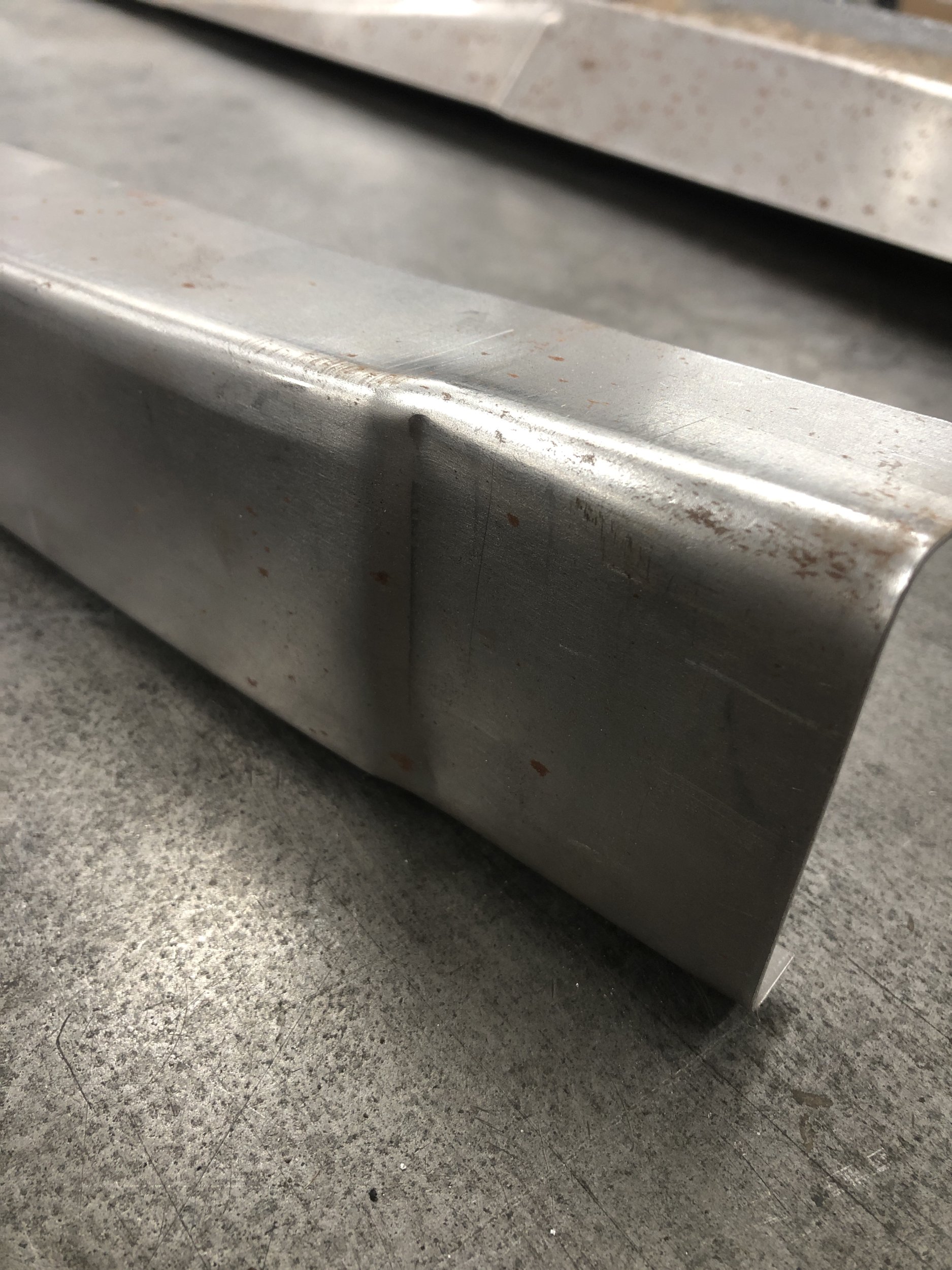

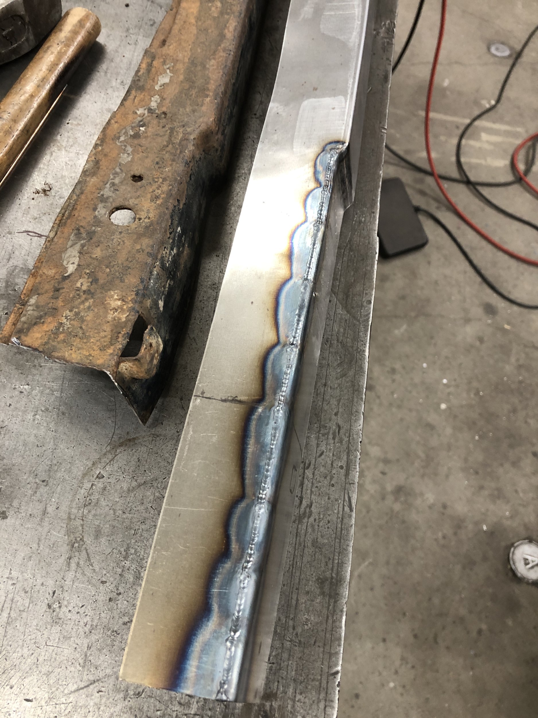

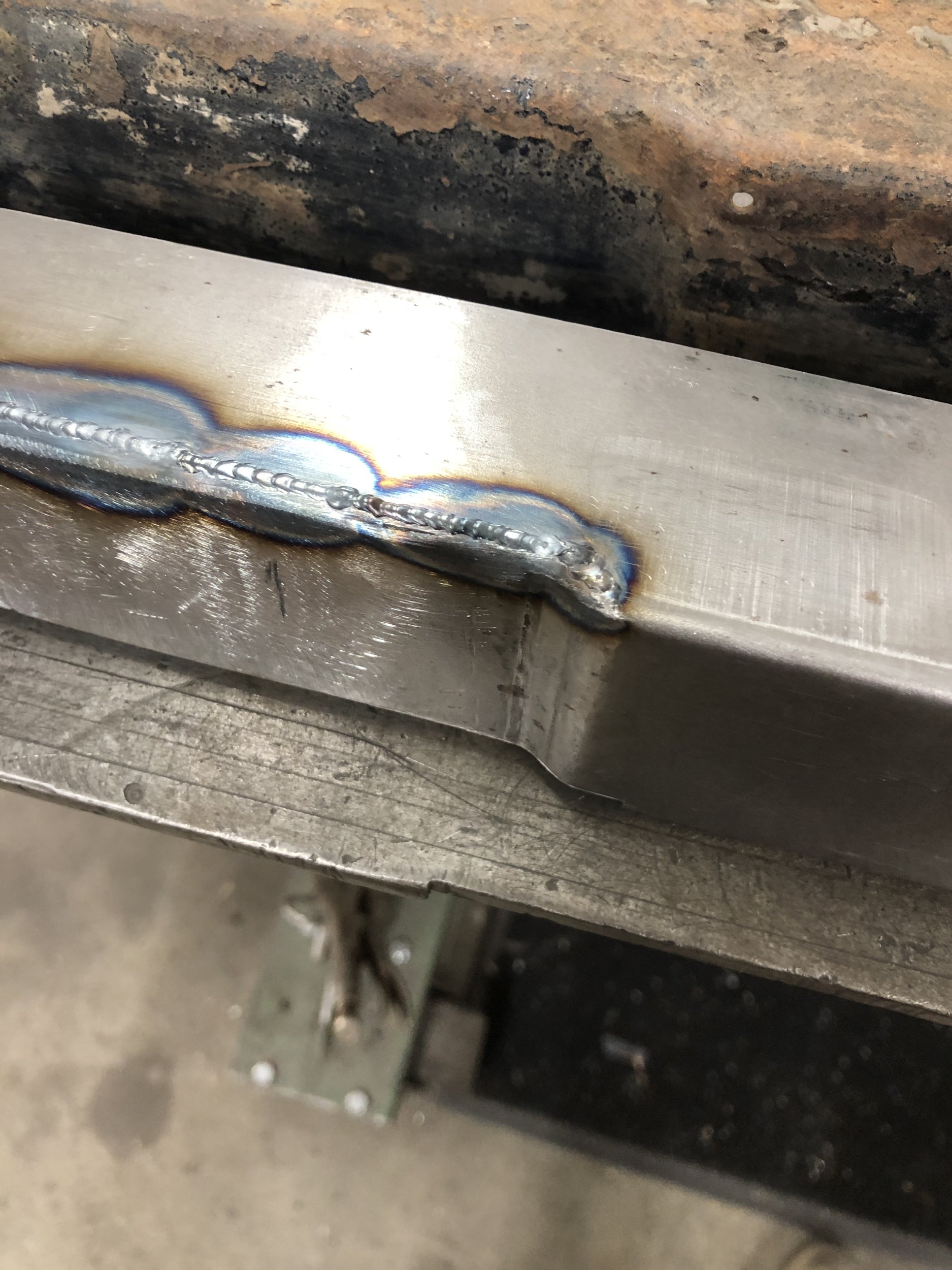

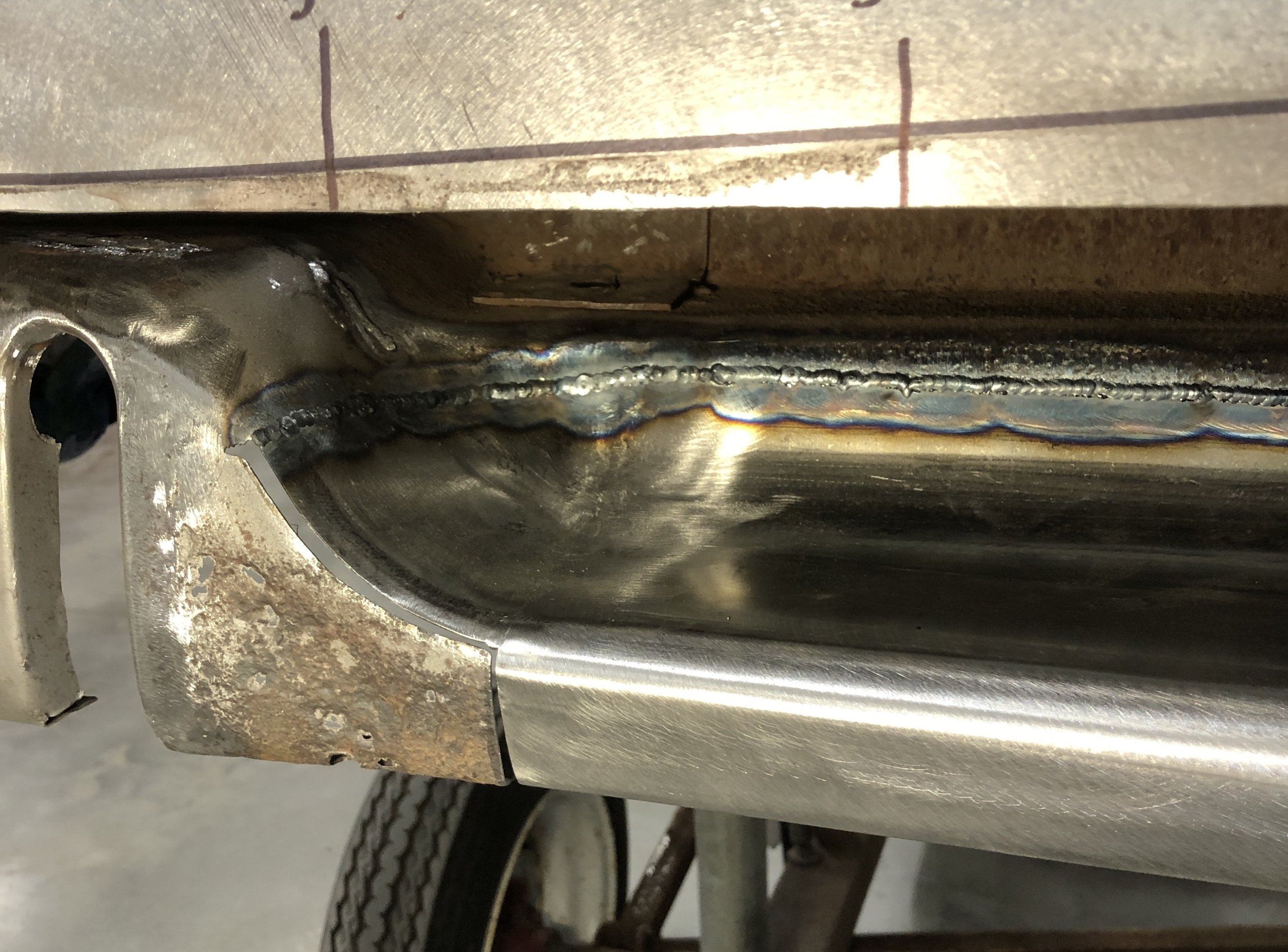

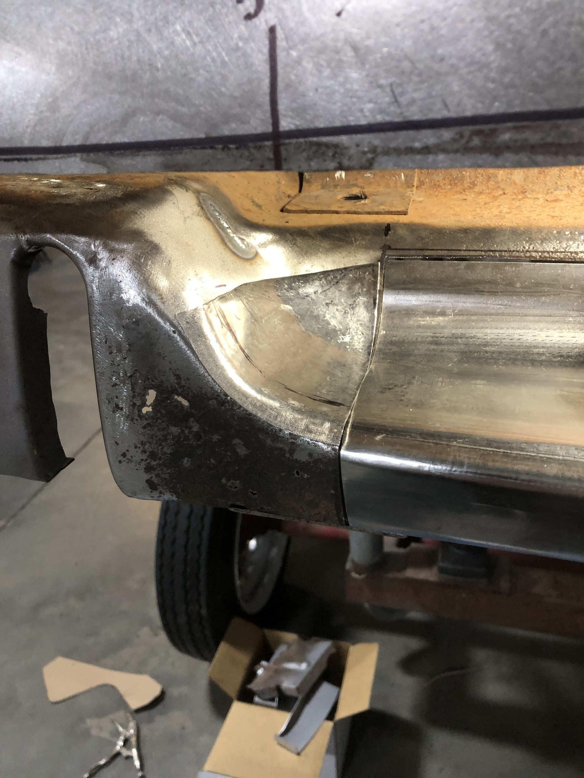

    My pics may be a bit out of order but I sandblasted these areas and got started on the repairs. I bought a pair of reproduction rockers, however they were not long enough on the rear to take care of the problems back there. They also didn’t really have the right inset where they step inward in the b pillar area. So I cut along the top edge and removed enough material to increase the offset and welded them back up. IMG_8545.jpeg

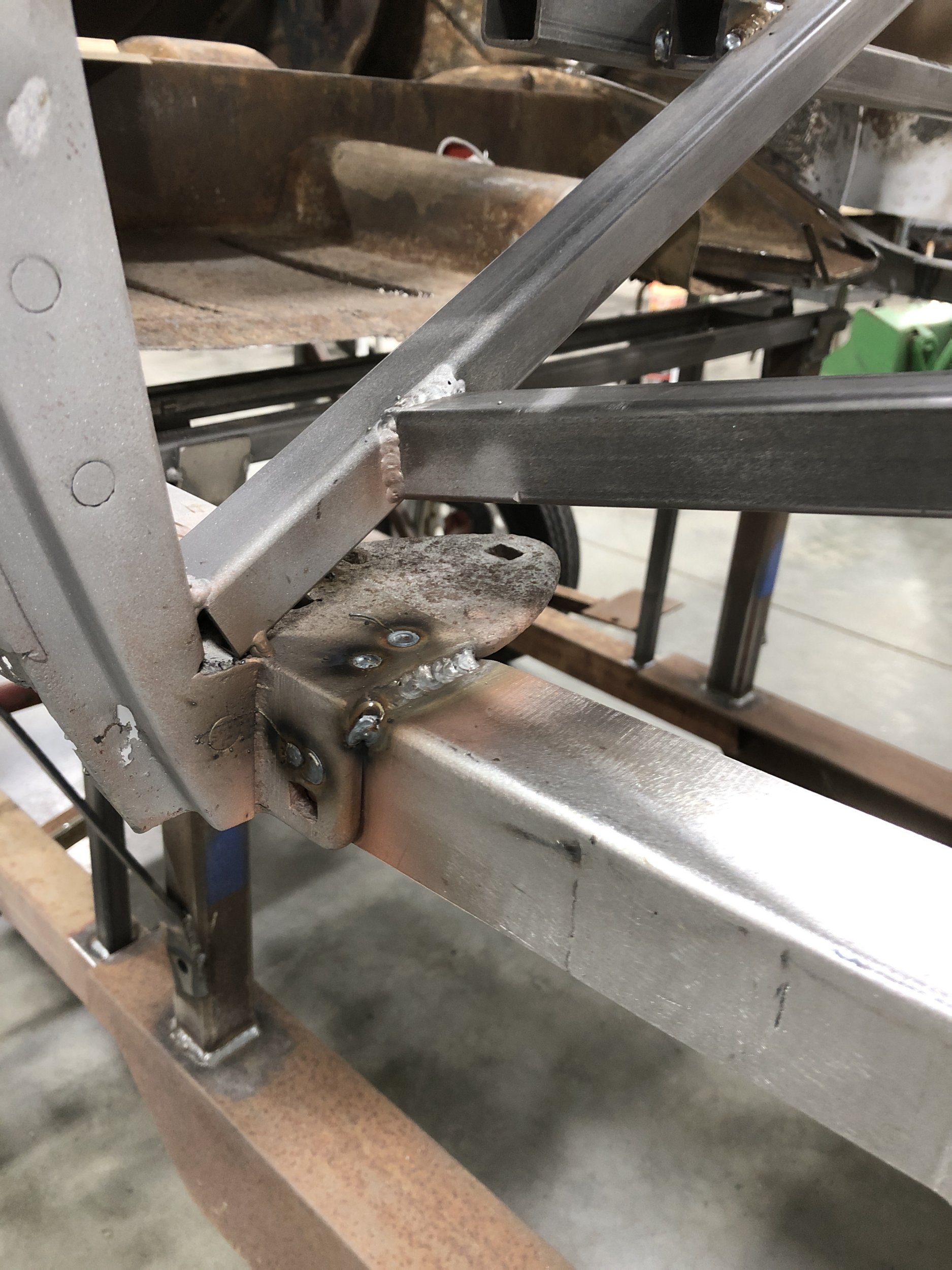

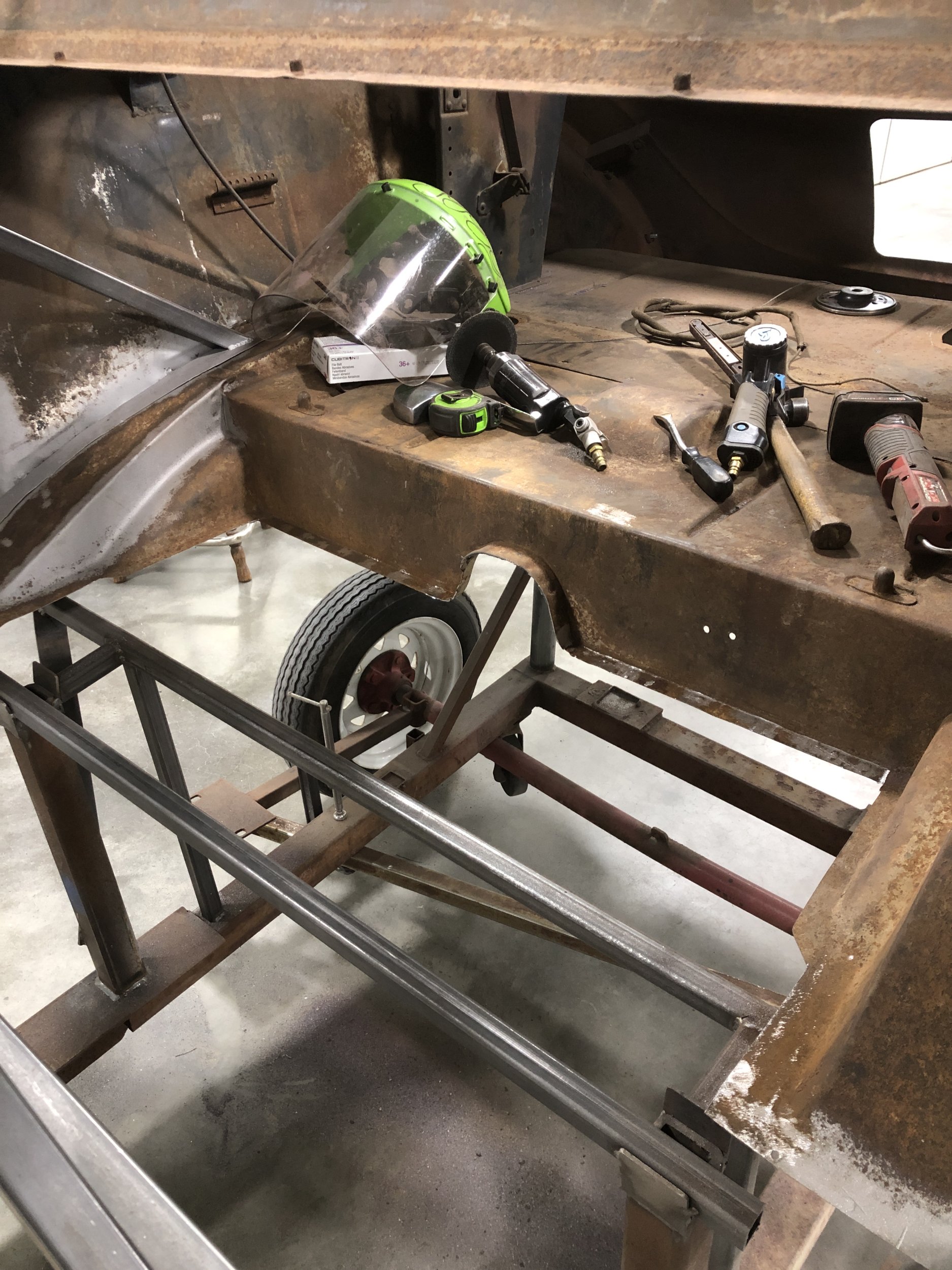

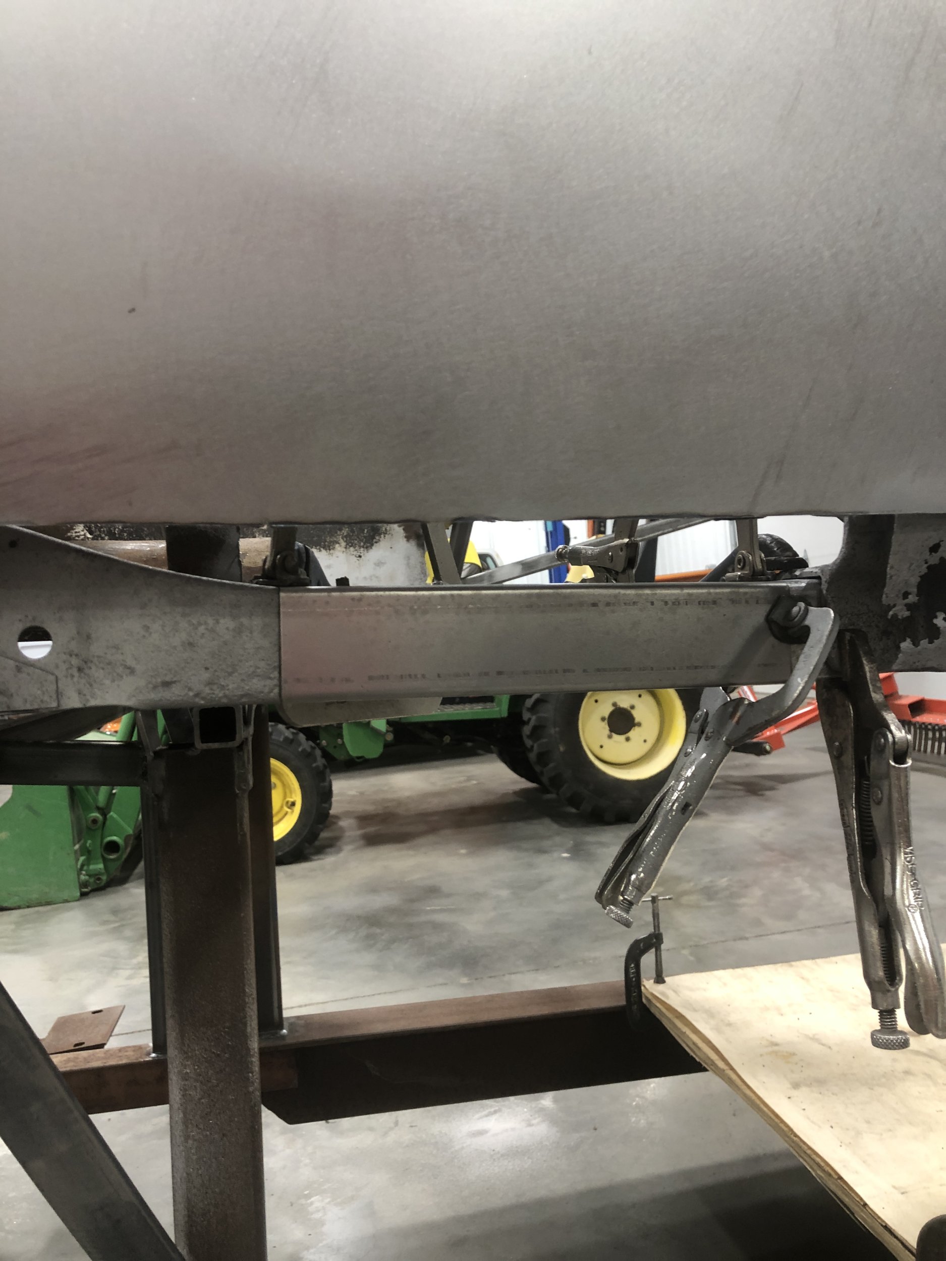

    After getting the rockers tacked in place it was time to move rearward and fabricate the rest of the rocker between the b pillar and the rear wheel well. IMG_8565.jpeg IMG_8556.jpeg IMG_8557.jpeg IMG_8558.jpeg IMG_8566.jpeg

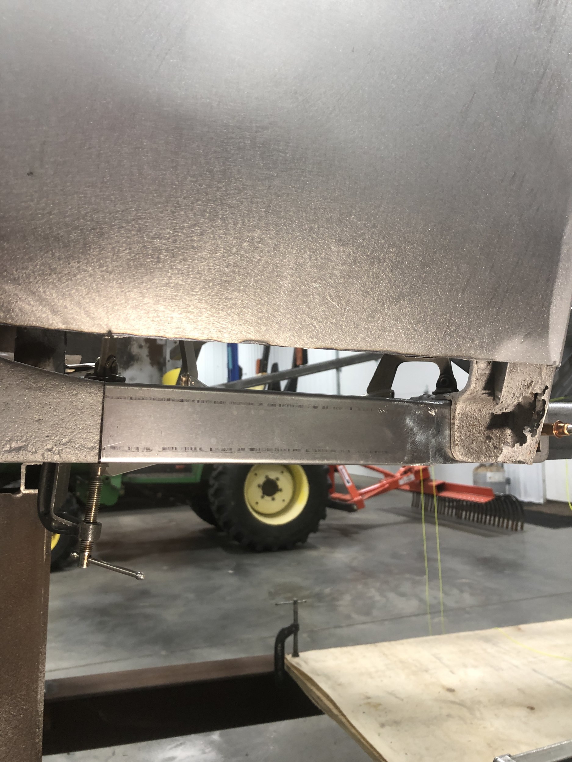

    Using string lines across the rockers to make sure we’re still good and square, I’m not too unhappy with the results so far. IMG_8567.jpeg

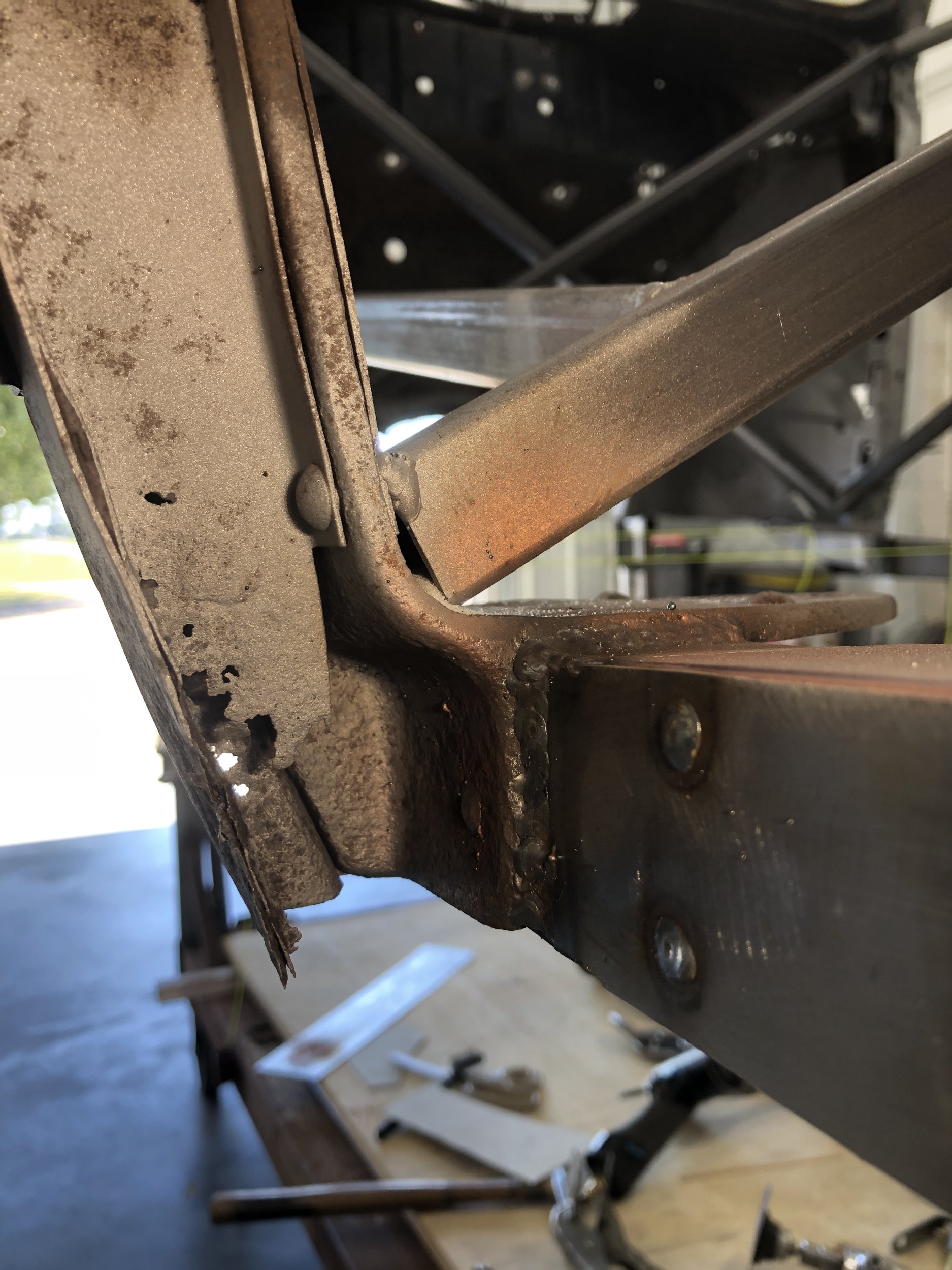

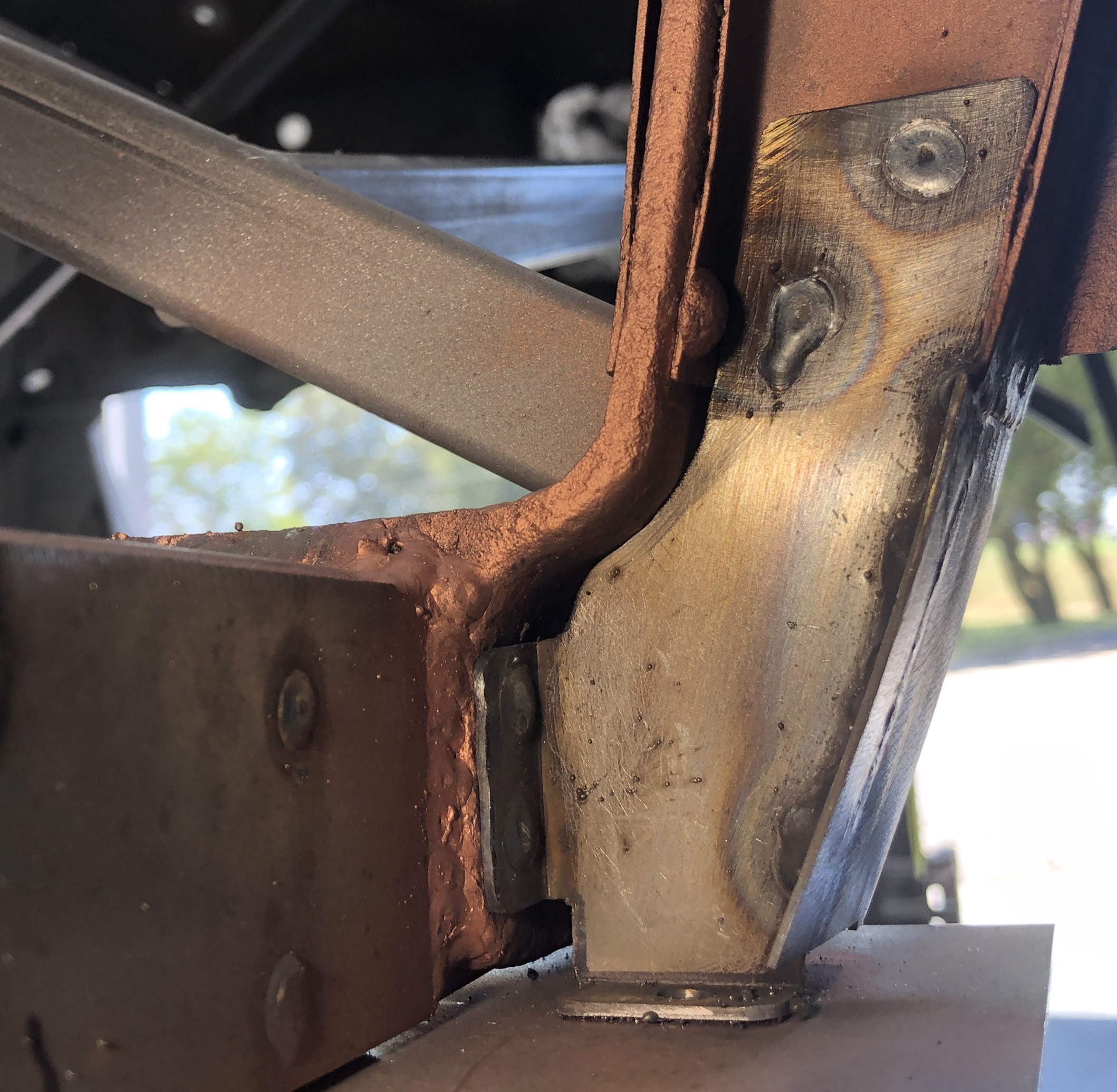

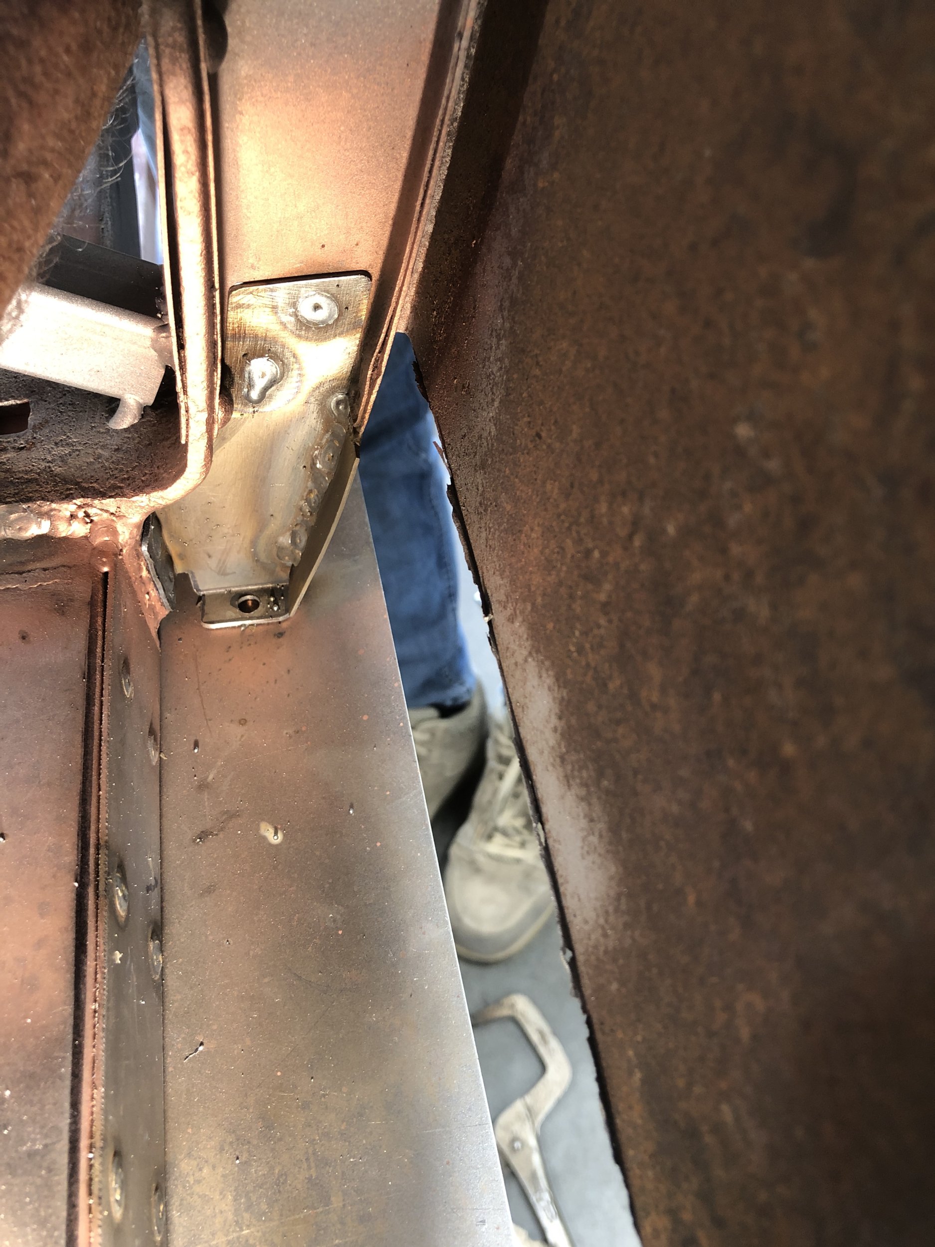

    Now on to making the patches for the b pillar areas that needed replacing. IMG_8659.jpeg IMG_8662.jpeg IMG_8663.jpeg IMG_8664.jpeg IMG_8657.jpeg IMG_8658.jpeg

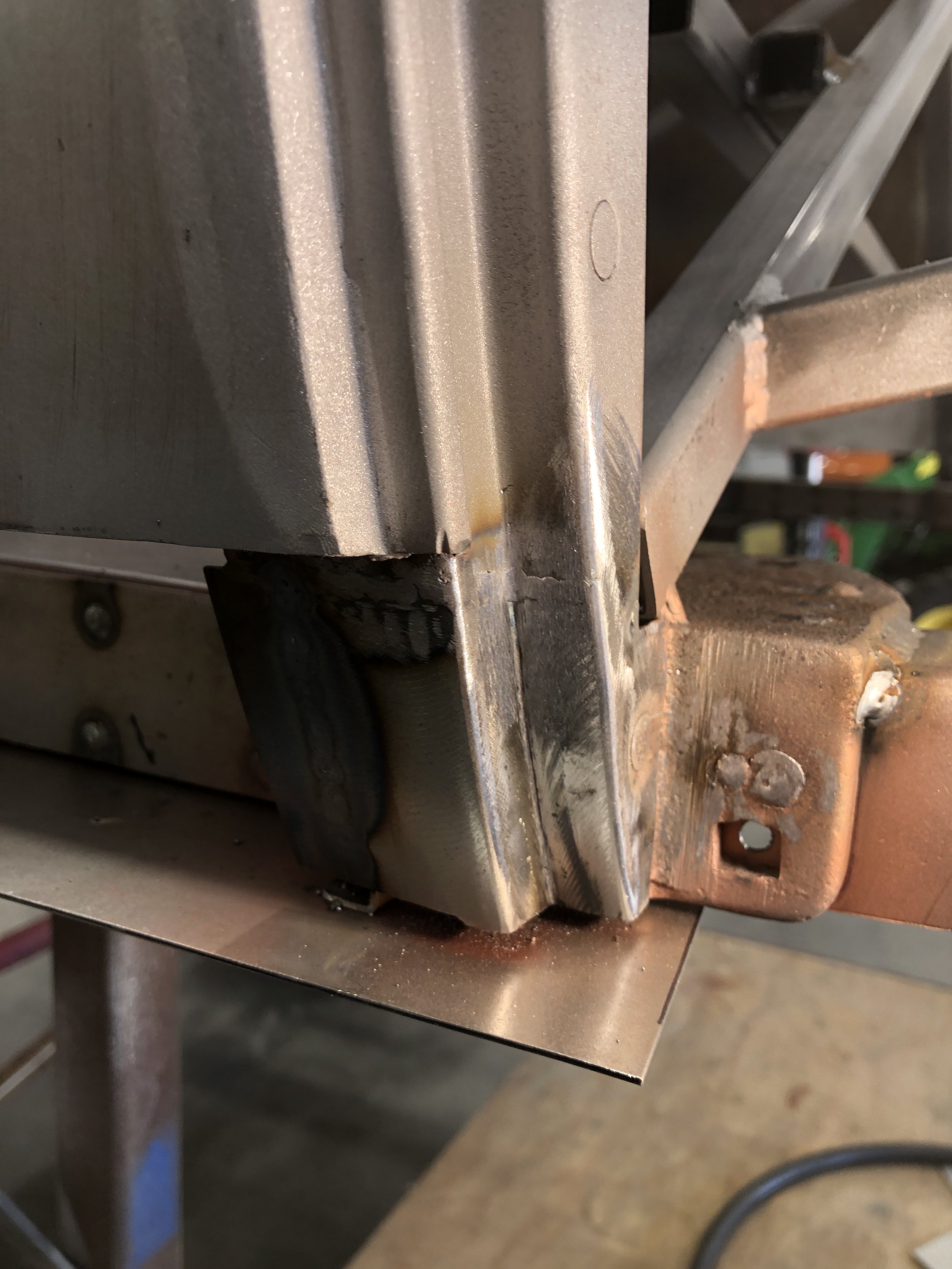

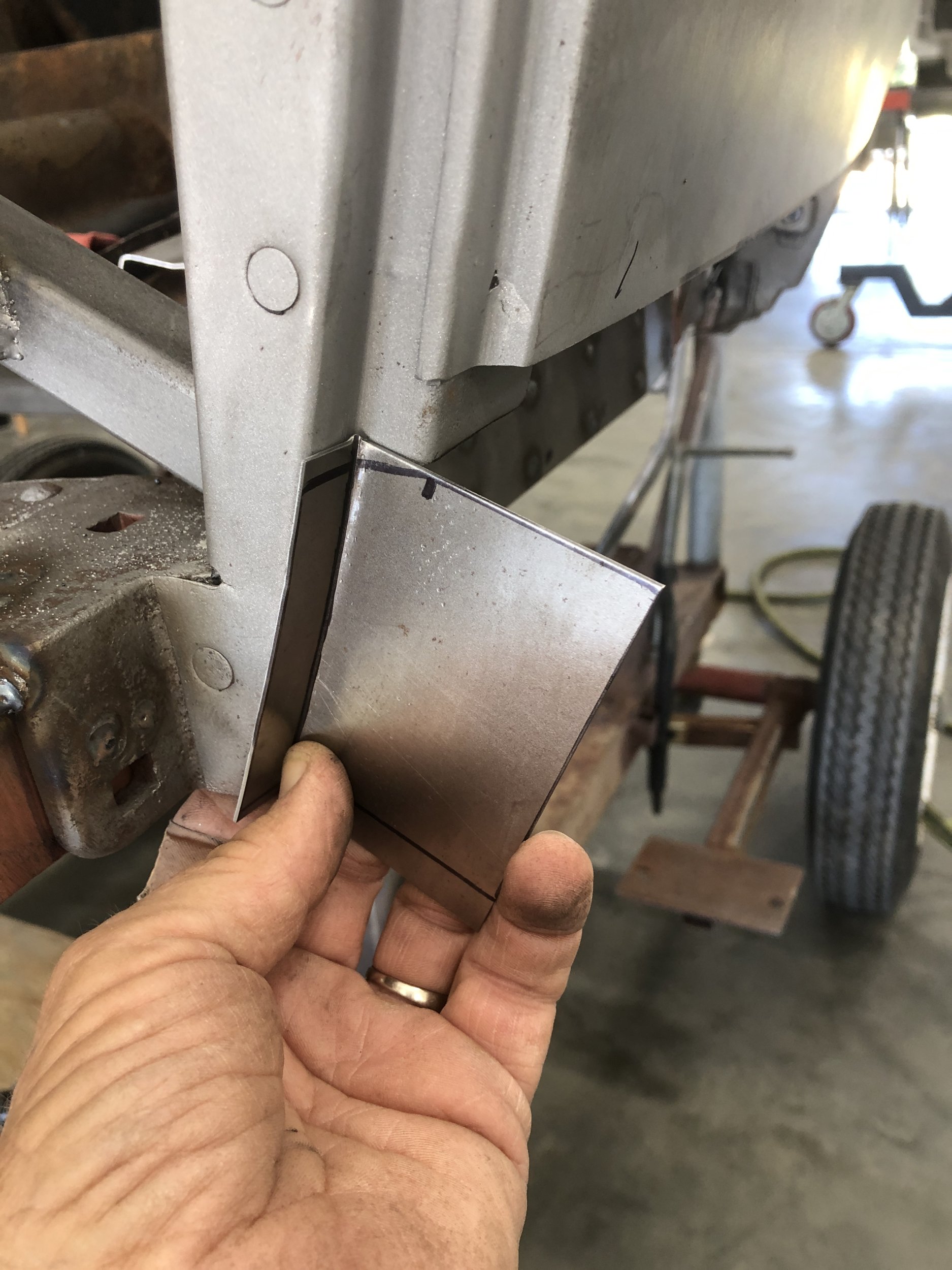

    Fabbed up some pieces for the front side of that same area and welded them in. IMG_8661.jpeg IMG_8660.jpeg IMG_8656.jpeg

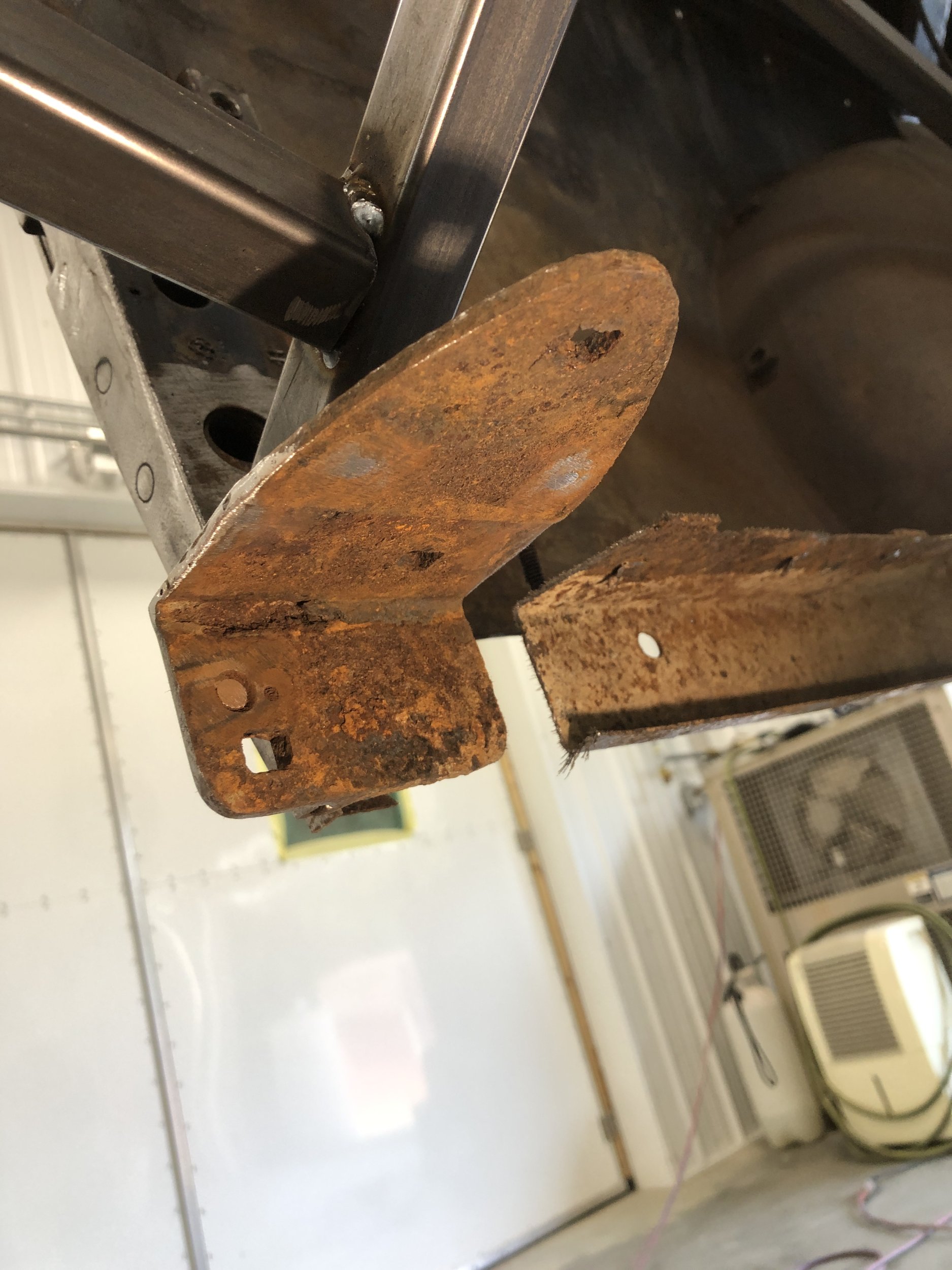

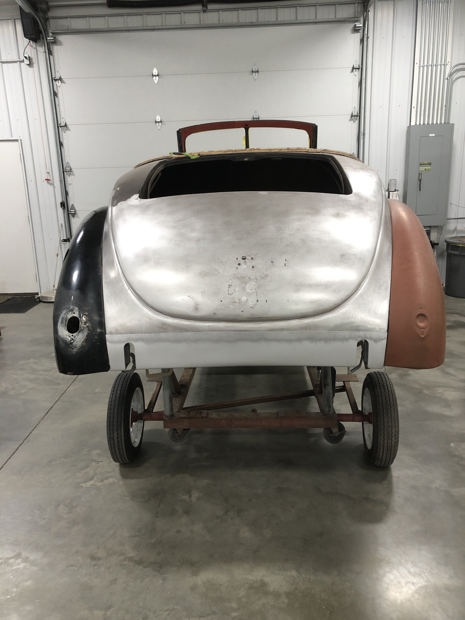

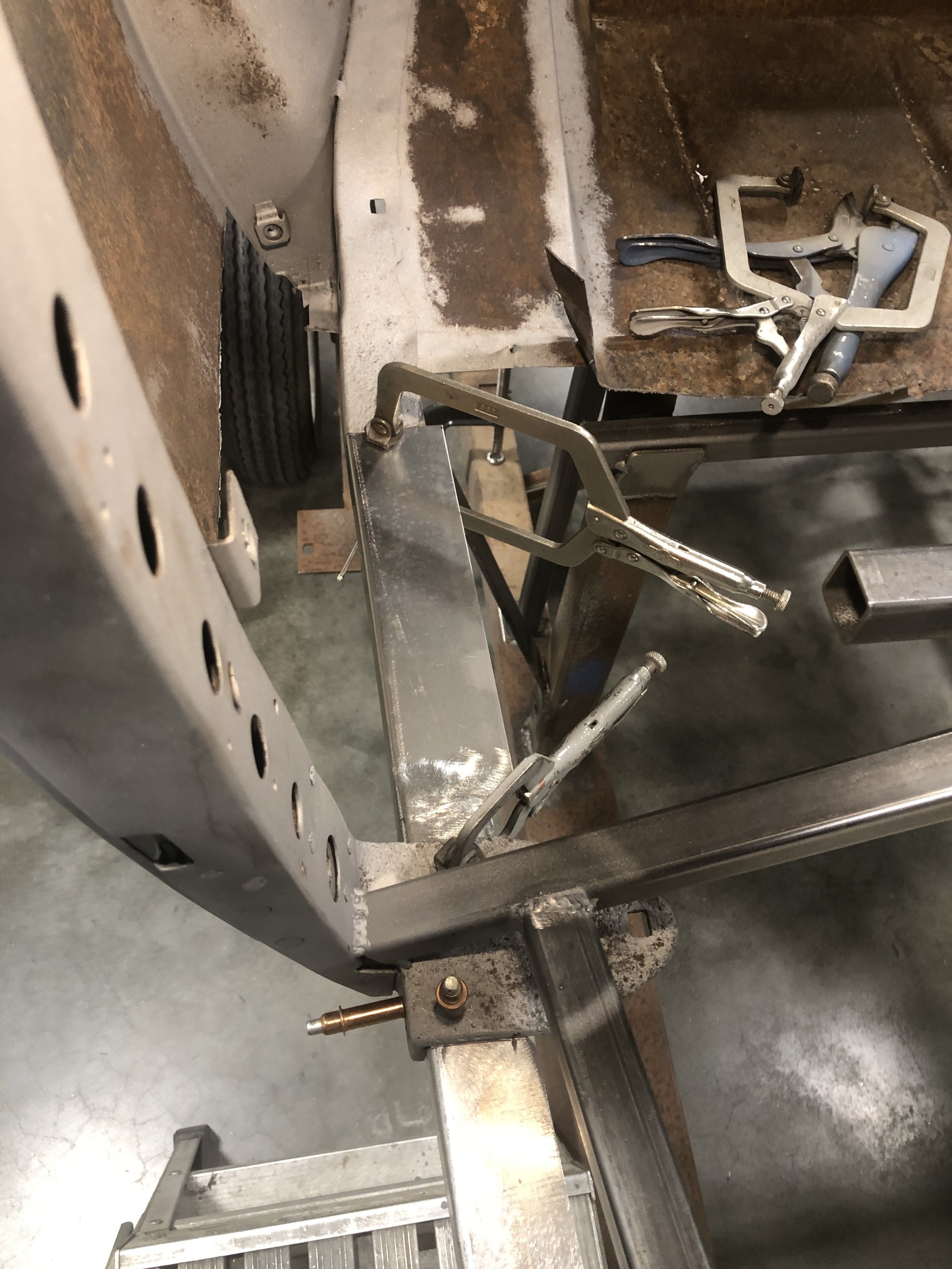

    My wife bought me a rear body repair panel for Christmas, so I started prepping for fit by bolting up the rear fenders. I was lucky enough to get an NOS right rear fender with the car when I bought it, but will have to straighten up and repair the left rear. The prior owner thought he had an NOS left rear, but as it turns out, it is for a 38 club coupe I believe. IMG_9289.jpeg IMG_9302.jpeg IMG_9304.jpeg IMG_9303.jpeg

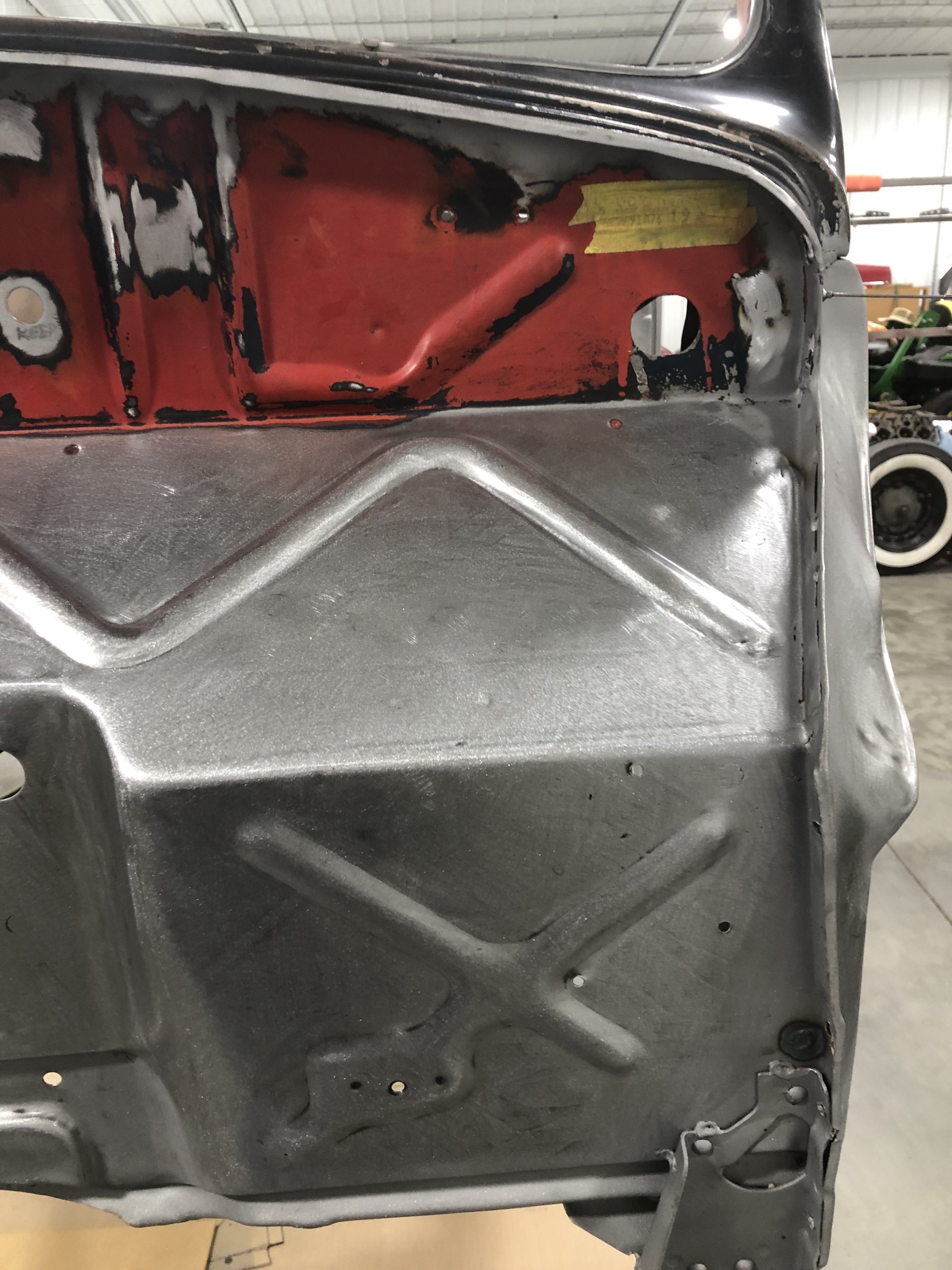

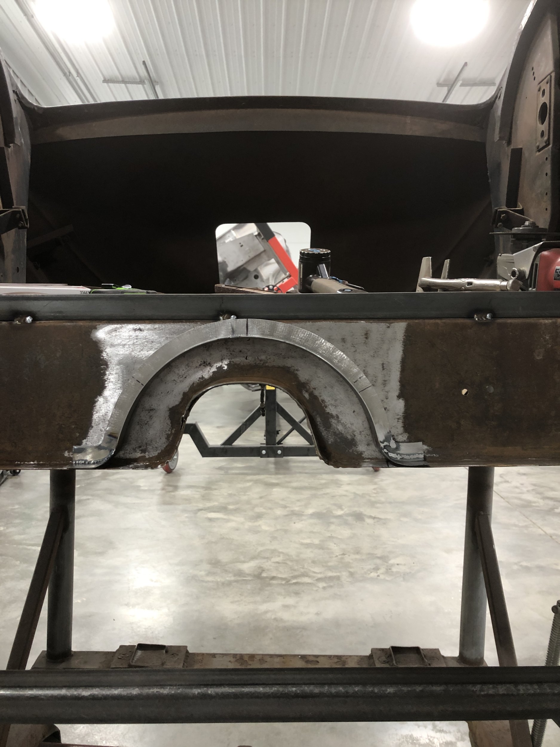

    I’ve been trying to work on several areas at the same time as time will permit. Gonna dump several pics to update my progress. First off, cutting out the rotted rear inner panel across the back of the body and making some patch pieces to fix that. Lotsa shape there so I had to make the repair in several pieces. IMG_9383.jpeg IMG_9384.jpeg IMG_9386.jpeg IMG_9390.jpeg IMG_9392.jpeg IMG_9434.jpeg IMG_9437.jpeg IMG_9440.jpeg

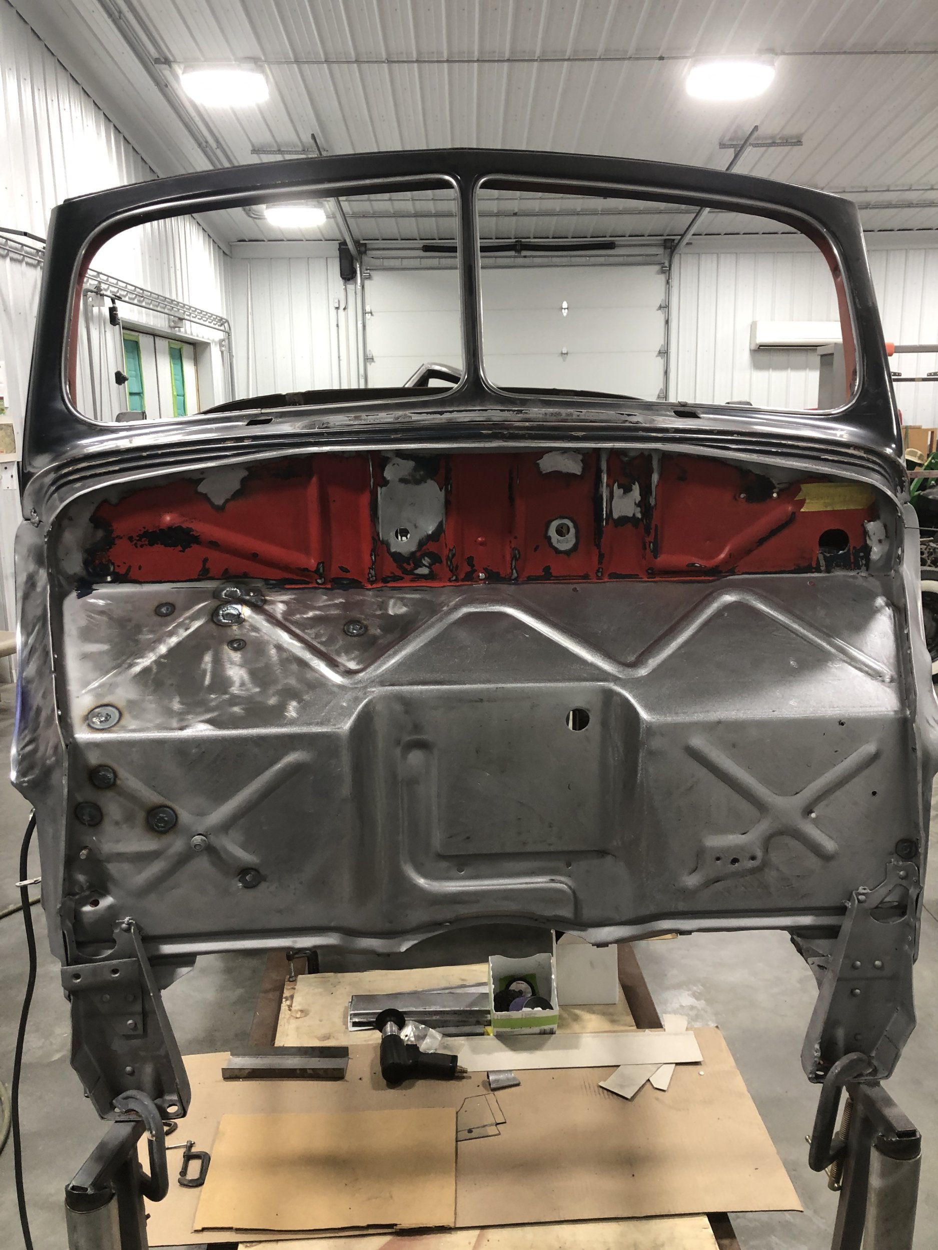

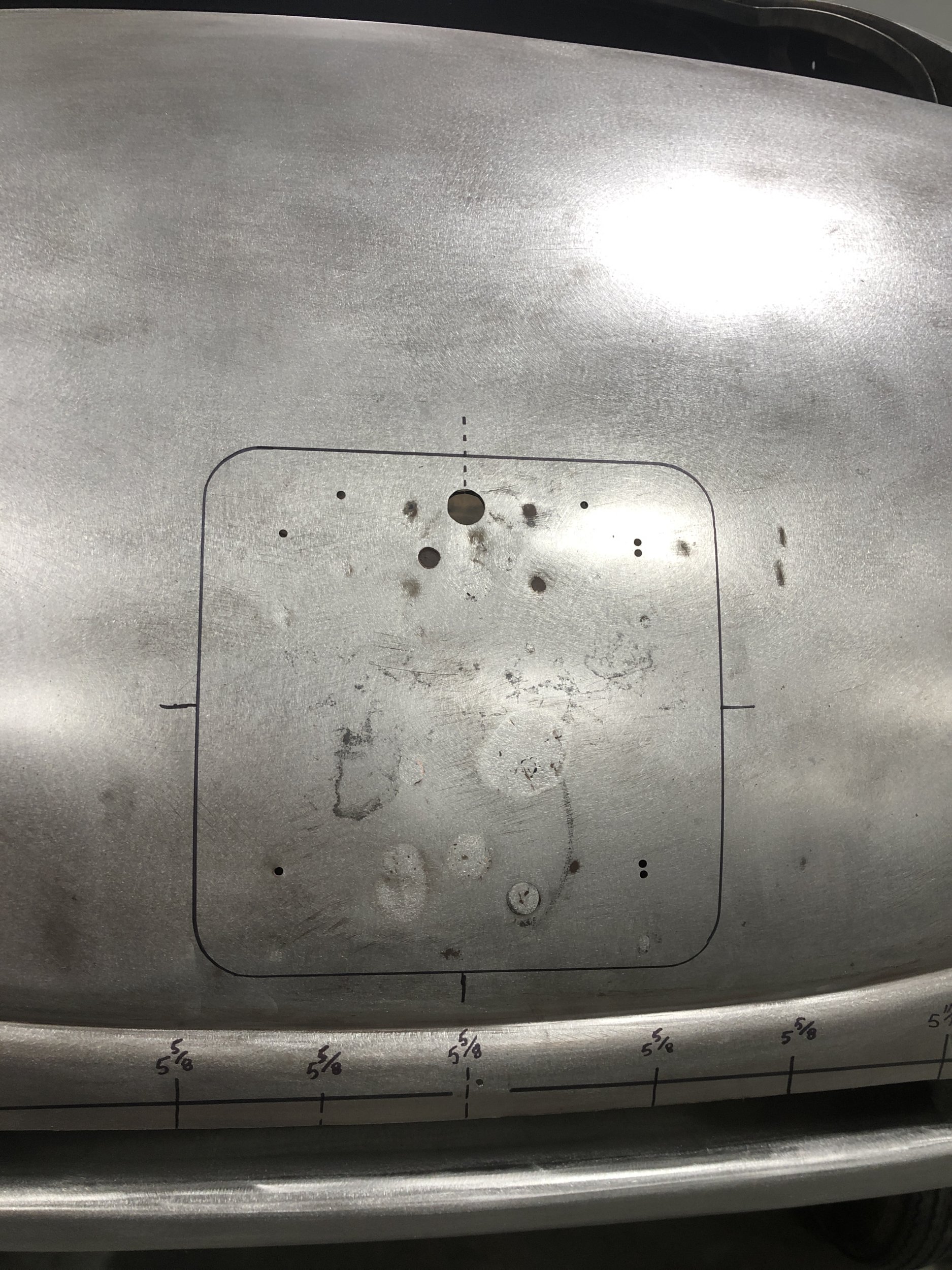

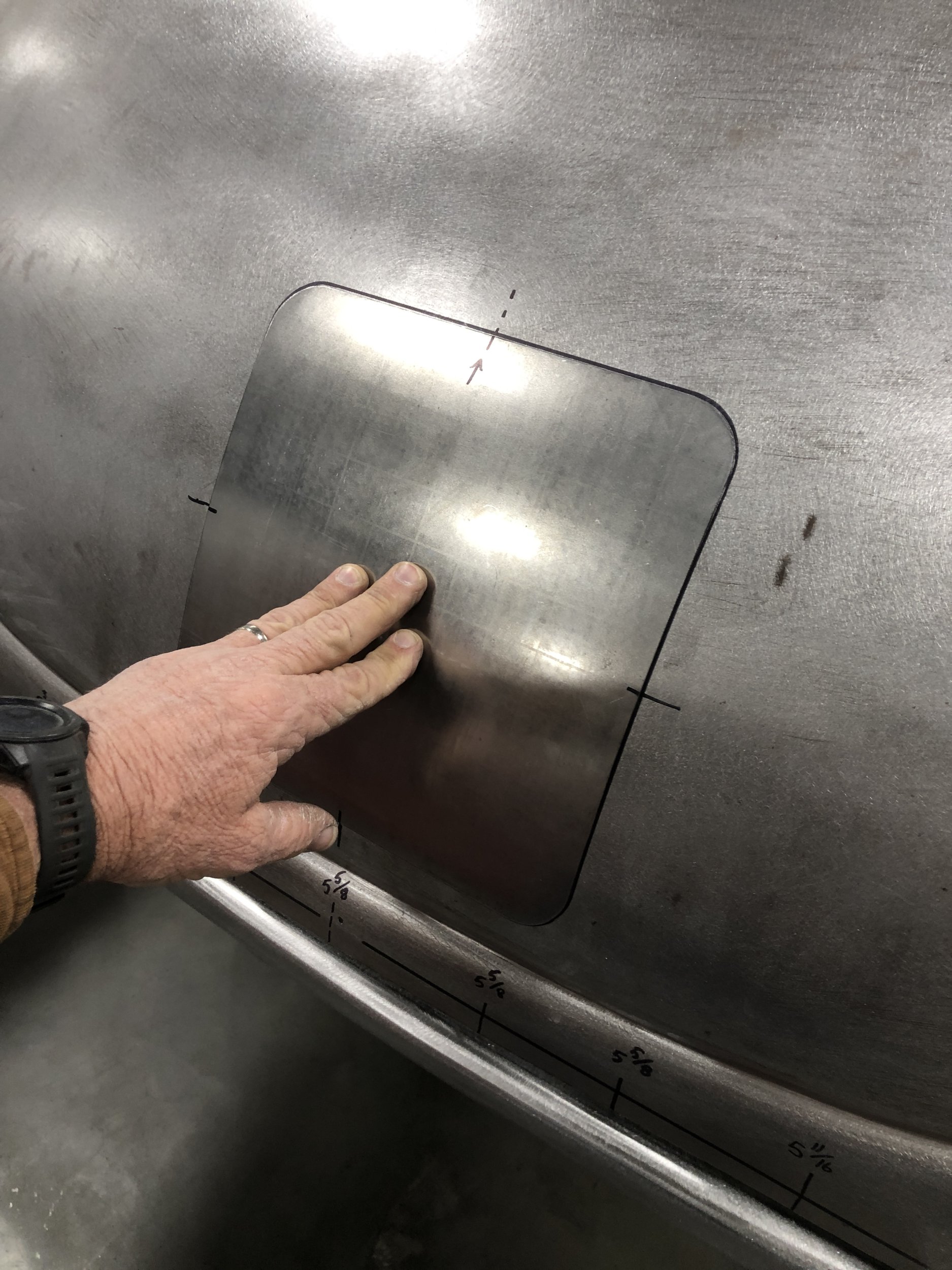

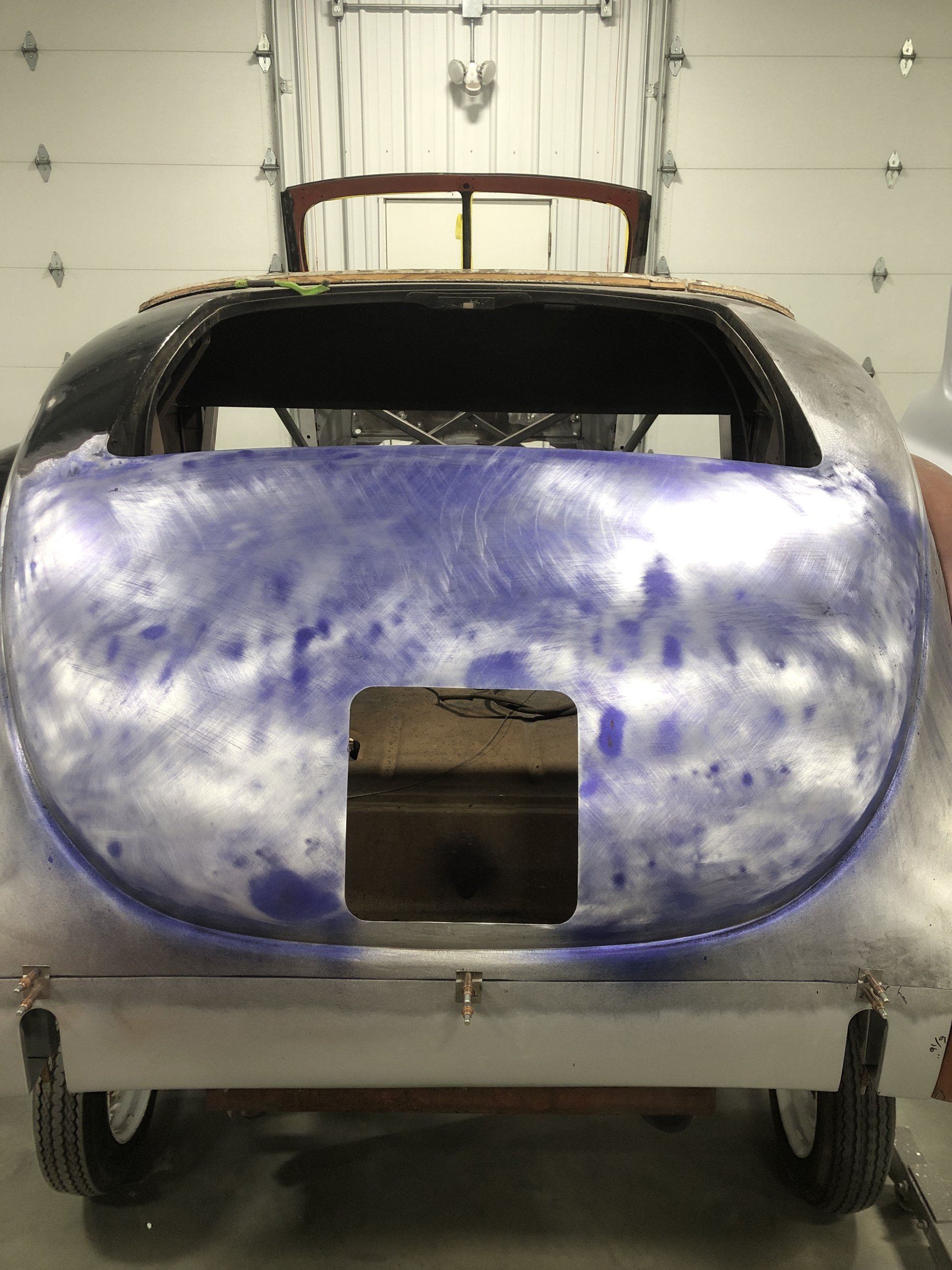

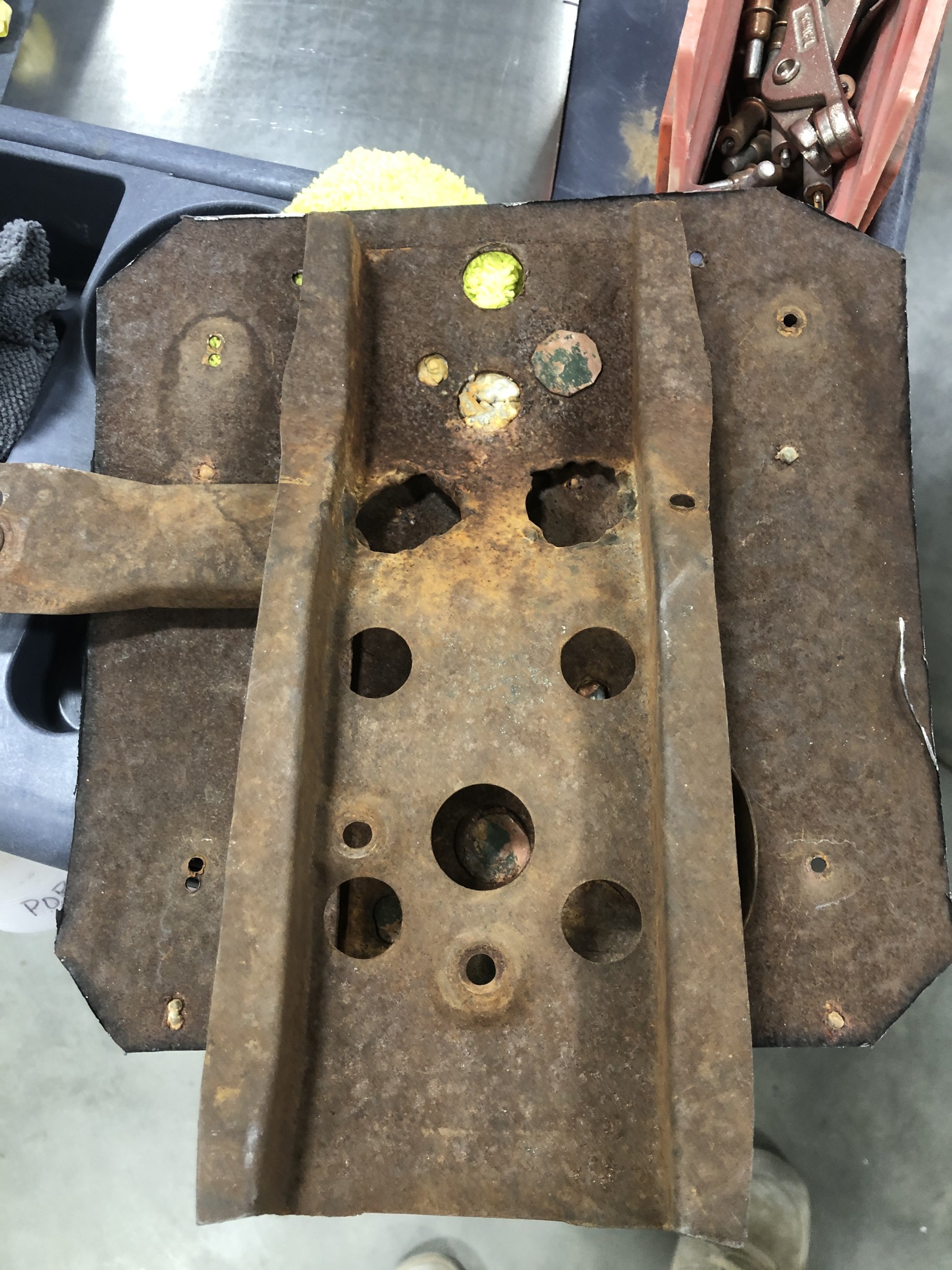

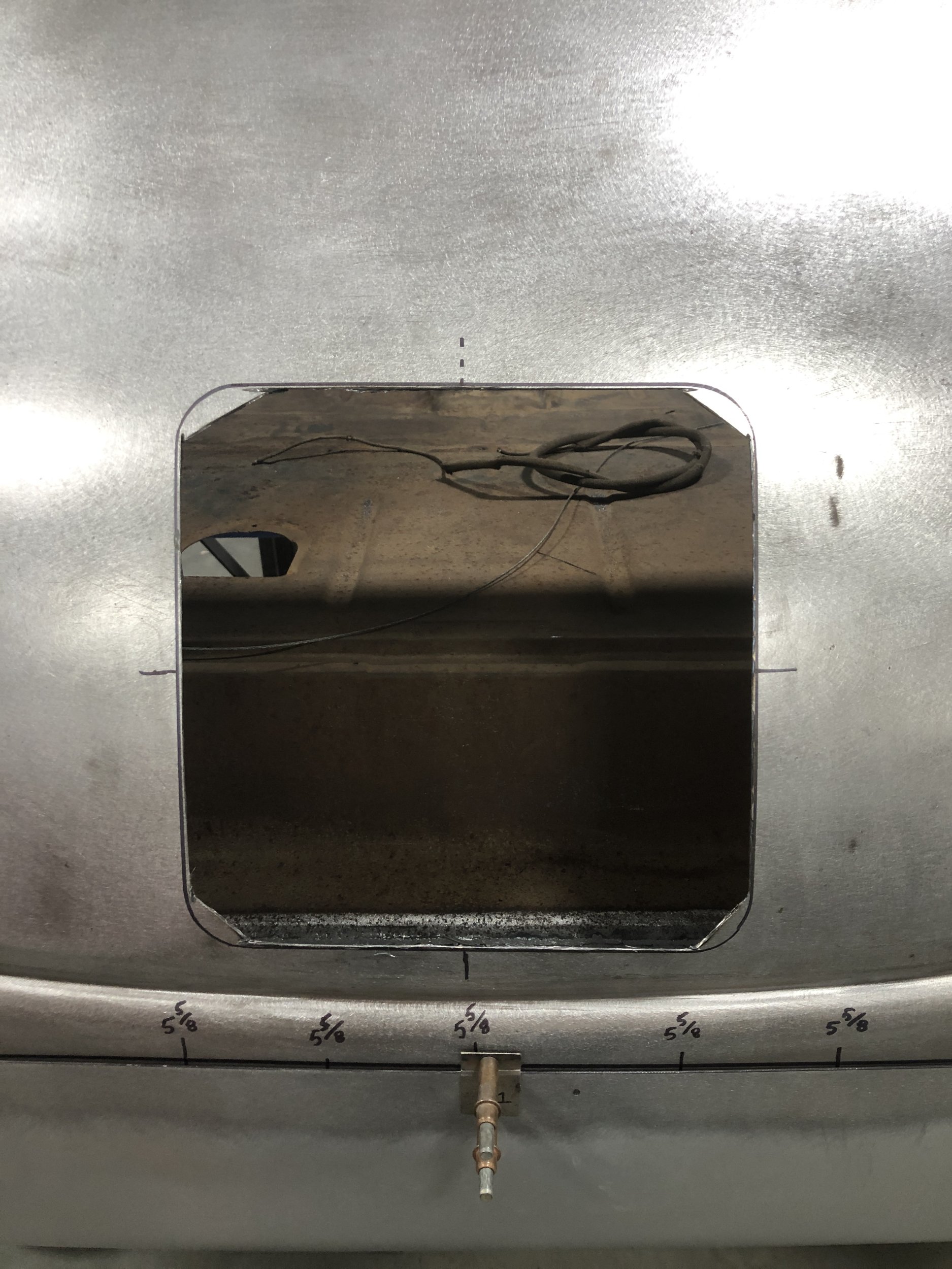

    Next area of work was where a prior owner removed the rumble lid handle and brazed and leaded in holes, added holes for a license plate and old hollywood light. It was a mess because they left the inner structure in place. No way to straighten it up short of just cutting it out and making a patch panel for it. It’s good though, because it will allow me to reach inside and hammer and dolly out the dents above it and also across the tail pan after I weld it in. I will put the patch in last but I’m waiting on favorable weather to finish sandblasting the inside of the body. With the tail pan off, it will be easier to get the sand blowed out. IMG_9563.jpeg IMG_9564.jpeg IMG_9565.jpeg IMG_9567.jpeg IMG_9568.jpeg IMG_9569.jpeg IMG_9570.jpeg IMG_9571.jpeg IMG_9572.jpeg

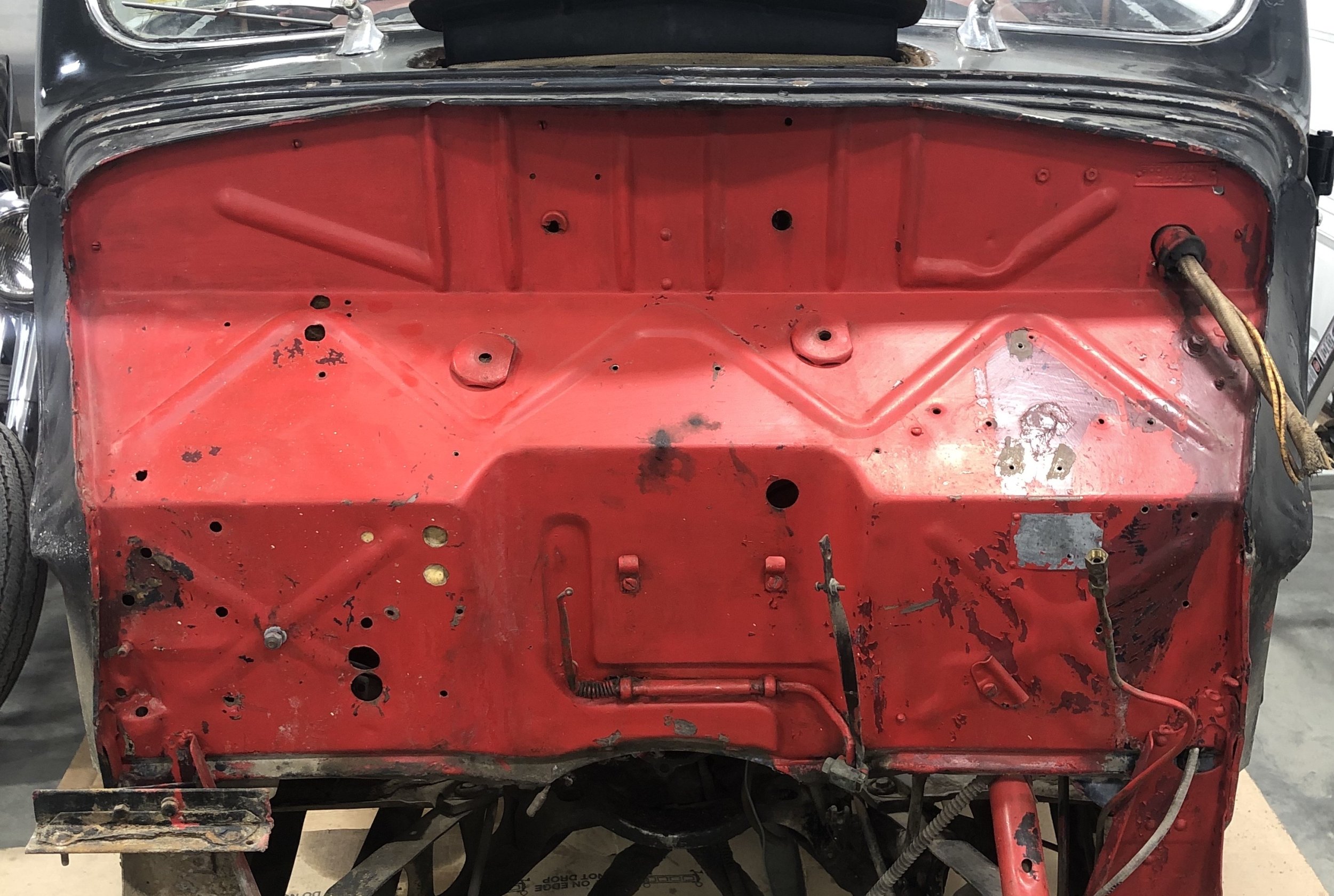

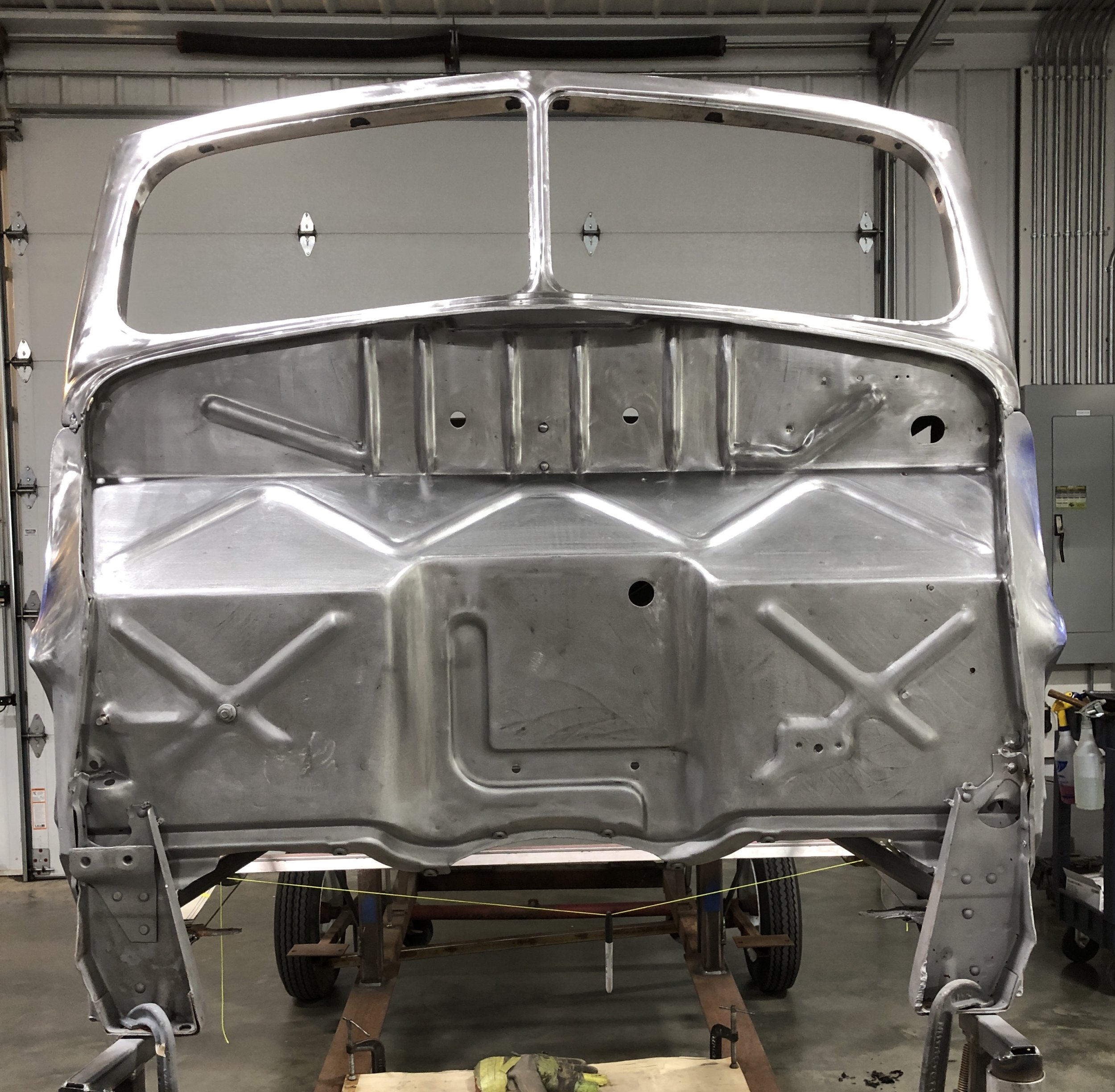

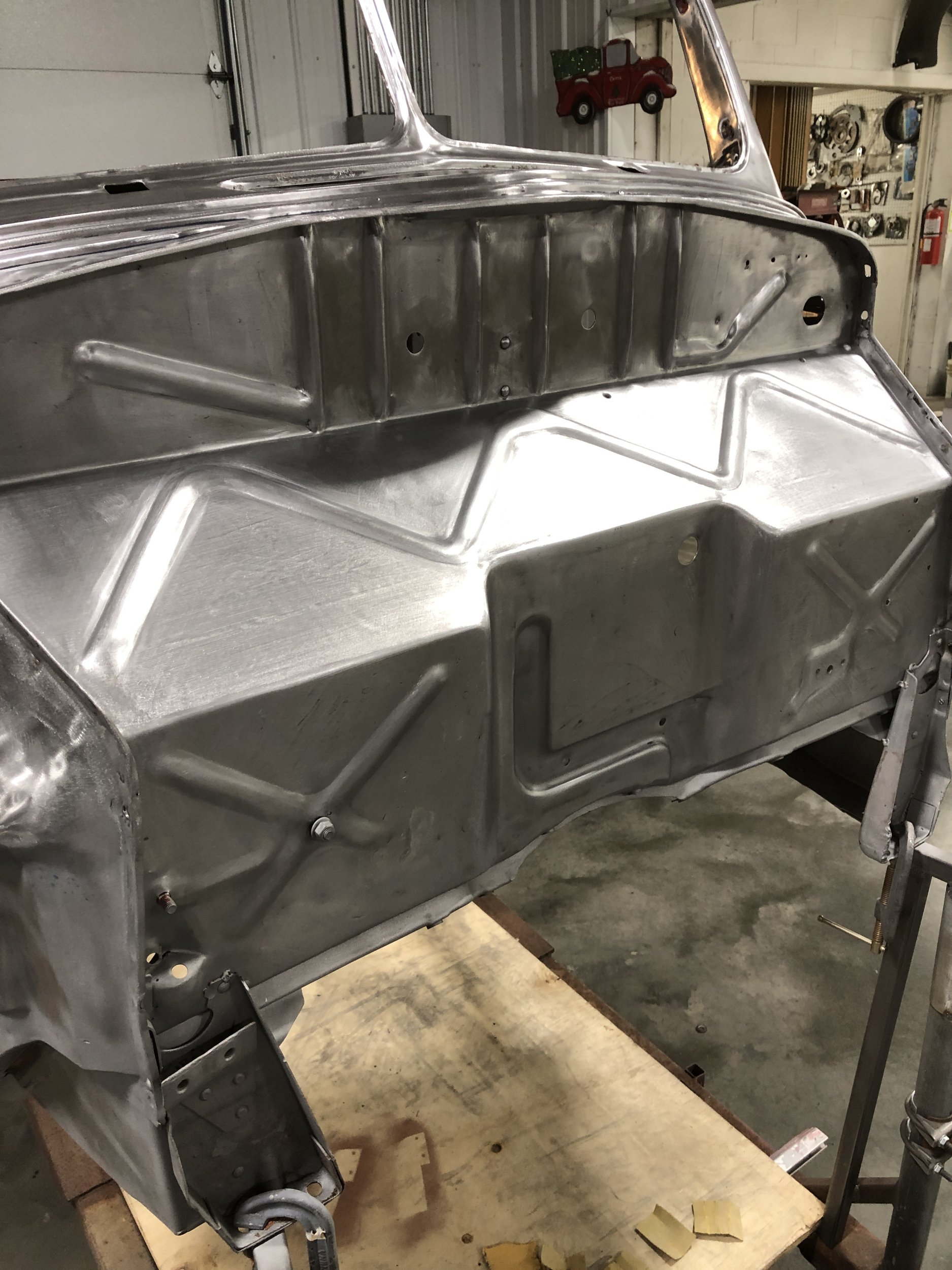

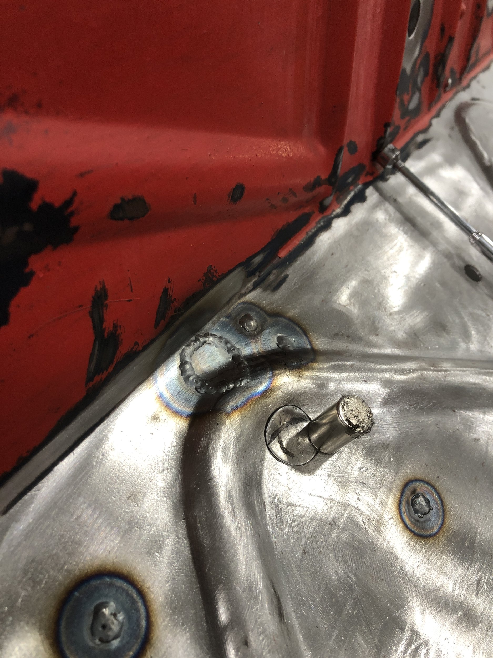

    I’ve also been plugging all the forty five holes in the firewall for a fresh start. Lol IMG_4634.jpeg
    IMG_7429.jpeg IMG_9643.jpeg IMG_9644.jpeg IMG_9658.jpeg IMG_9659.jpeg IMG_9660.jpeg IMG_9661.jpeg

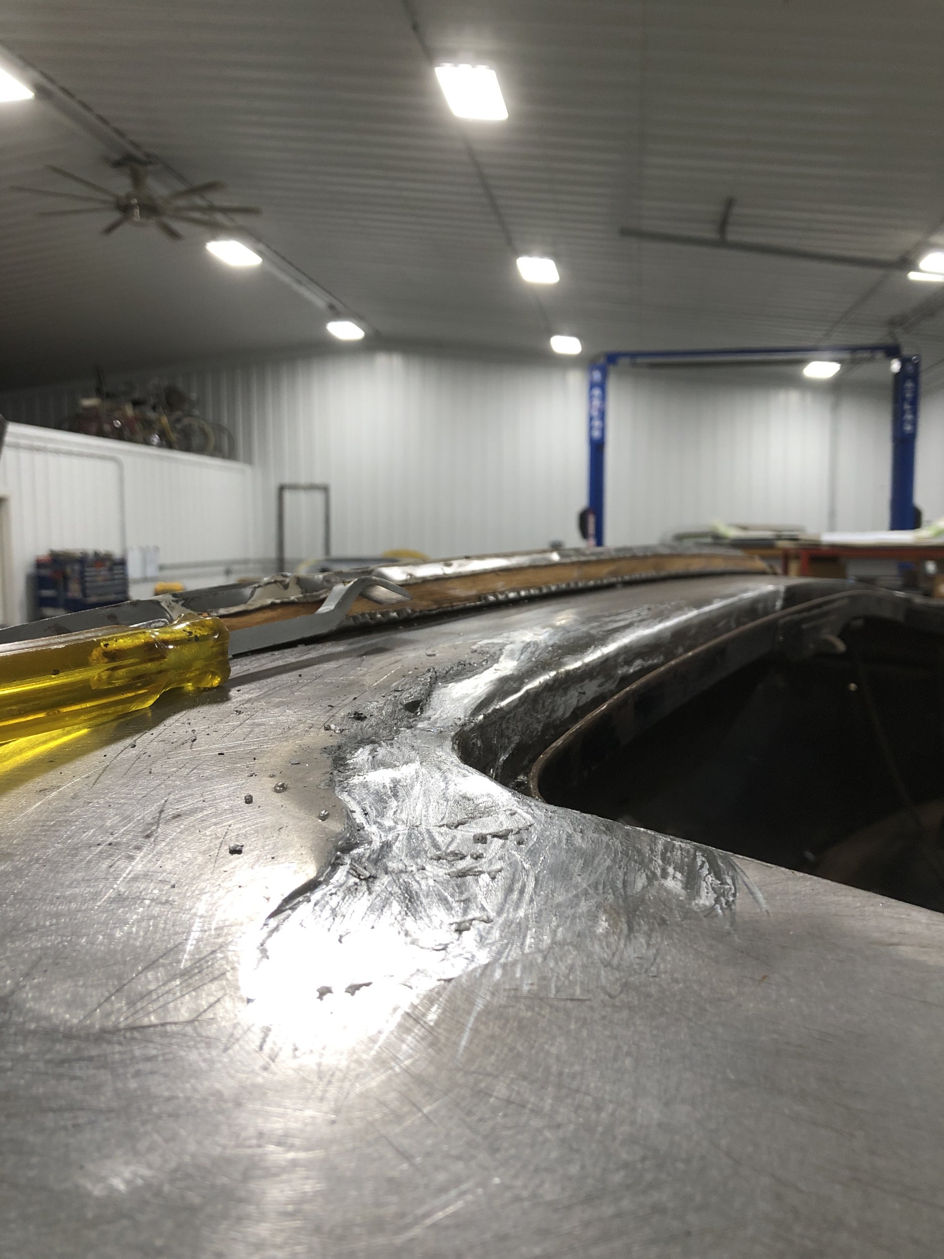

    After getting the rest of the paint off the sail panel/quarter tops, I opted to melt out the factory lead on the seams. This may have been a mistake, but as some of lead was cracked, I had no way of knowing what kind of condition the base metal was in underneath it all. Turns out it wasn’t rusty, but was the absolute crudest panel fitment on a car I’d ever seen. It’s hard for pictures to do it the injustice it deserves. Lol. I’ll probably end up cutting a good portion of it out and making the gaps in steel after the body is back on the frame. I might mention that this is body #19 of the Conv Coupes for 39, so maybe they just didn’t have everything ironed out yet. IMG_9960.jpeg
