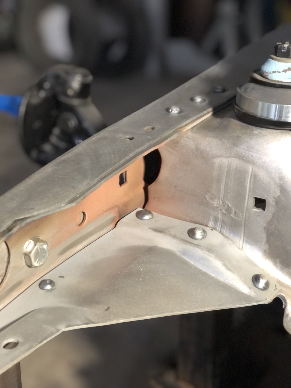

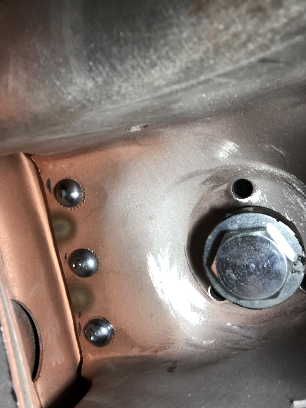

    Actually I have been getting in an hour or two occasionally, but the progress seems to be minimal. I guess the first thing I did since I last posted was enlisting a buddy to help me get the front crossmember and front gussets riveted in. F1961D64-37F5-4A1D-B56E-C5874E0059AE.jpeg 6B827D27-7AA2-4C55-B3FF-6D20E50AE4D1.jpeg D3C45965-2829-47AB-BDC8-9F2B039F3FA7.jpeg 66C2D4B3-7442-4B75-9705-137A4A942D74.jpeg

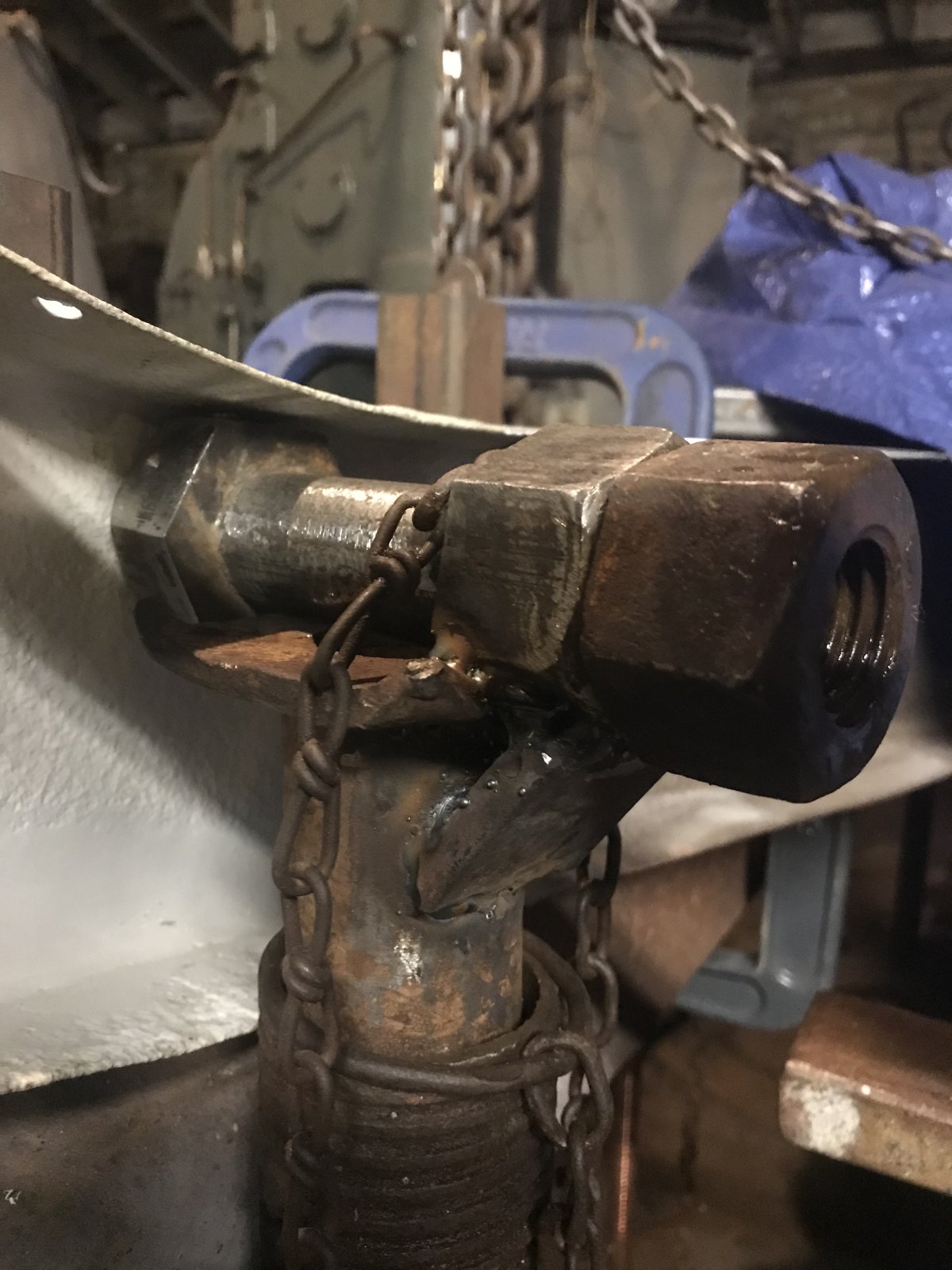

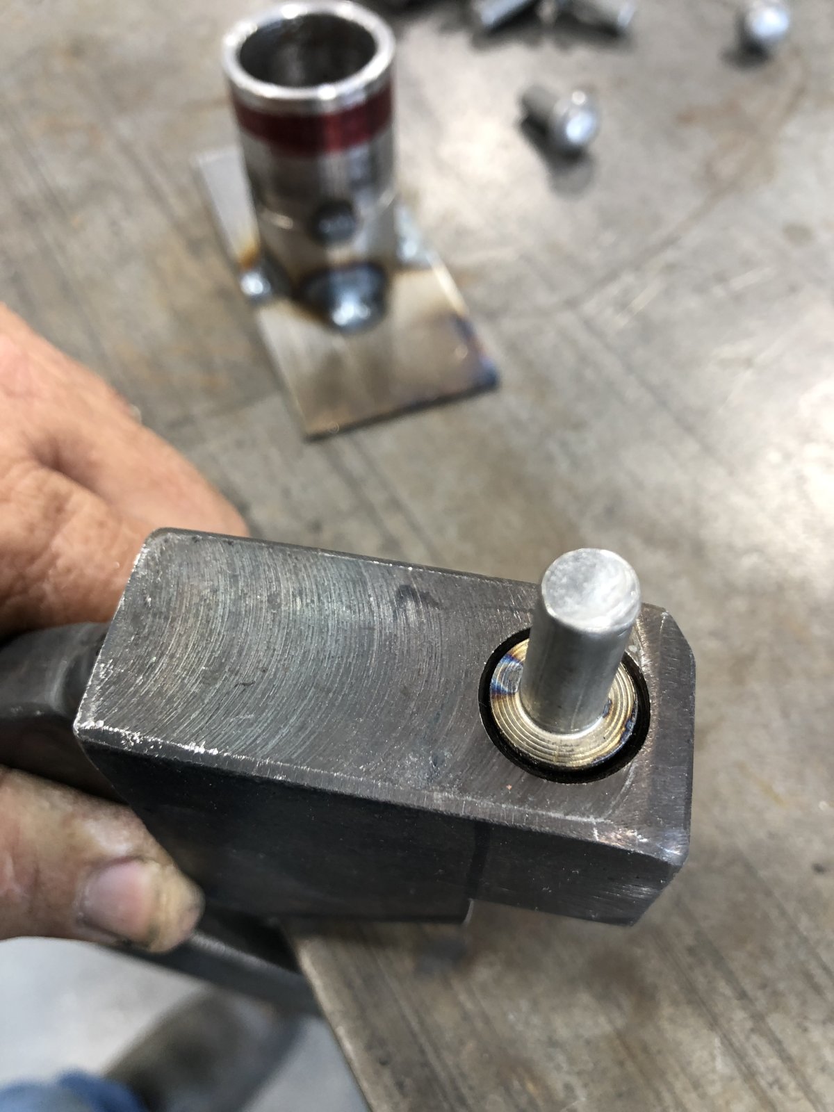

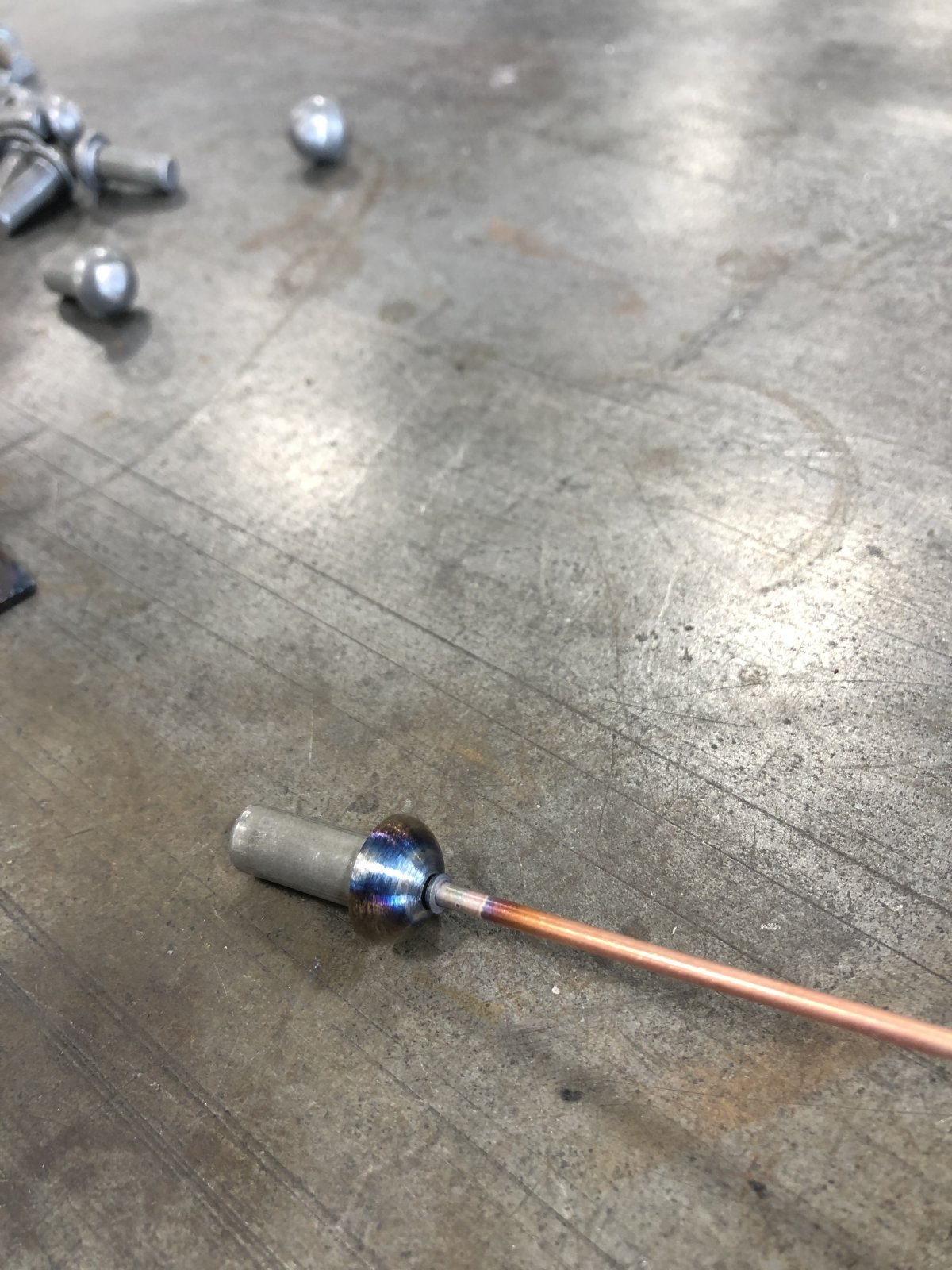

    Hahaa. Thanks. I put that off for a while because honestly I wasn’t real sure the best way to go about it. I ended up making a bucking block that was welded to a sort of C shaped piece of thick steel. The problem was figuring out a way to hold the rivet into the bucking block so I could heat the rivet red hot, and get it pushed up through the bottom of the frame and hit it with my air hammer on the top, all before the rivet cooled off. Here’s what I came up with: AEB3CA9F-03EC-4D71-BFC3-138AB2A9BB93.jpeg I first drilled a hole through the bucking block. Then I made up a jig to hold the rivet so I could fuse dent puller nails to the rivet head. Set the rivet into the bucker, then bend the nail on the other end so it stayed in the block. Surprisingly, it worked well. 09156EB0-066F-468B-9537-A3B7E6C492F6.jpeg 2A961A18-FA33-4594-94FA-D930DE4D2DF8.jpeg FDAD01FD-C711-4A78-80D1-51FC5FC564C0.jpeg DA290261-2D6A-4AD9-B689-BCD4117014C7.jpeg 24521585-F52C-4917-A462-61BA1D0690BC.jpeg 179E5642-420F-42B9-93CB-B6B2D9989CFF.jpeg 88C2C97F-27E4-4DB0-B737-BBF00B5F7628.jpeg 03F93CAA-1A44-41C3-A7AE-25511AF13C8F.jpeg CD1D985C-FDE4-43A7-8EB0-BF733218D092.jpeg

    Very nice, love the rivet solution, I've been wrestling with that one myself, my solution was no where near as elegant.

    A little better pic of the bucking bar/block, or whatever you want to call it. The c shape let me get around the bottom of the frame rail and reach the underside of the top rail. It took a little practice and a couple failed attempts at “hitting the hole” before it got too cold. Lol. It could be improved upon a lot, but I figured it’s probably the only time I’ll use it, so I didn’t want to waste too much time on it. 5530E3E2-785A-4148-8C5E-484D67AFF673.jpeg

    My not so elegant 's**** yard' version. worked really well though, did mine cold because I couldn't figure out a clever way to make them hot like you, but to be honest, they are really tight, and I have no issues with how they seated.

    I used an old Snap-on air impact hammer. Probably not ideal for the job, but I figured since I was putting them in hot, it would have enough oomph at 100 psi. Just for some added piece of mind, I did two plug welds on the top rail close to the riveted area and a couple of tig welds from crossmember to frame rails underneath the gussets before I installed them. The rivets on the top of rail/crossmember are 5/16” shank and all the rest I put in 3/8” dia shank rivets. Not stock, but it’s not a resto so in my opinion, it really didn’t have to be original size. The tool for the hammer is just a home made piece I made on my lathe with a ball end mill. Again, probably not ideal but since there were only 16 rivets total, I figured it would do. If I was going to do an entire frame, I’d probably spring for an actual riveter and some proper rivet set tooling. (And some good ear protection. Hahaa) 35B4FCB3-5411-4A31-BF69-5F06ACB81874.jpeg
