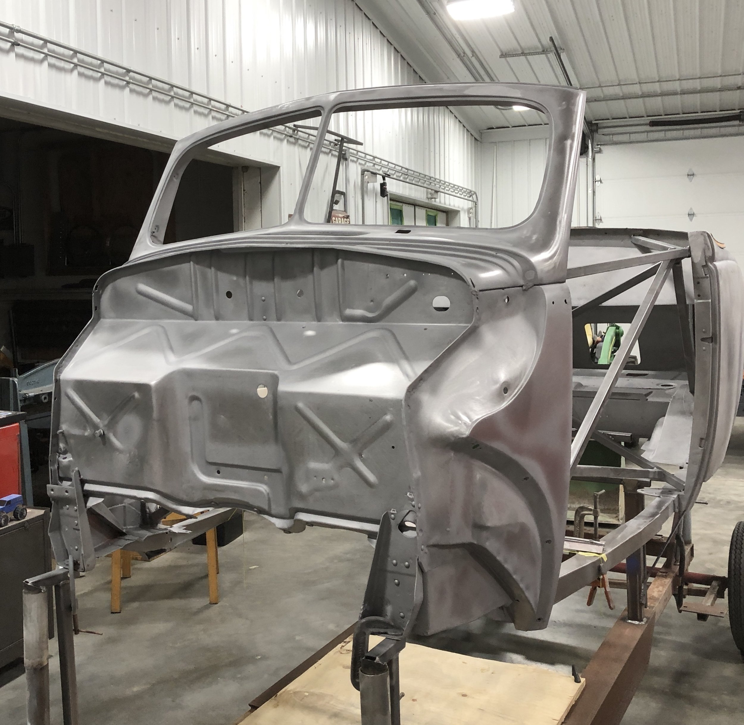

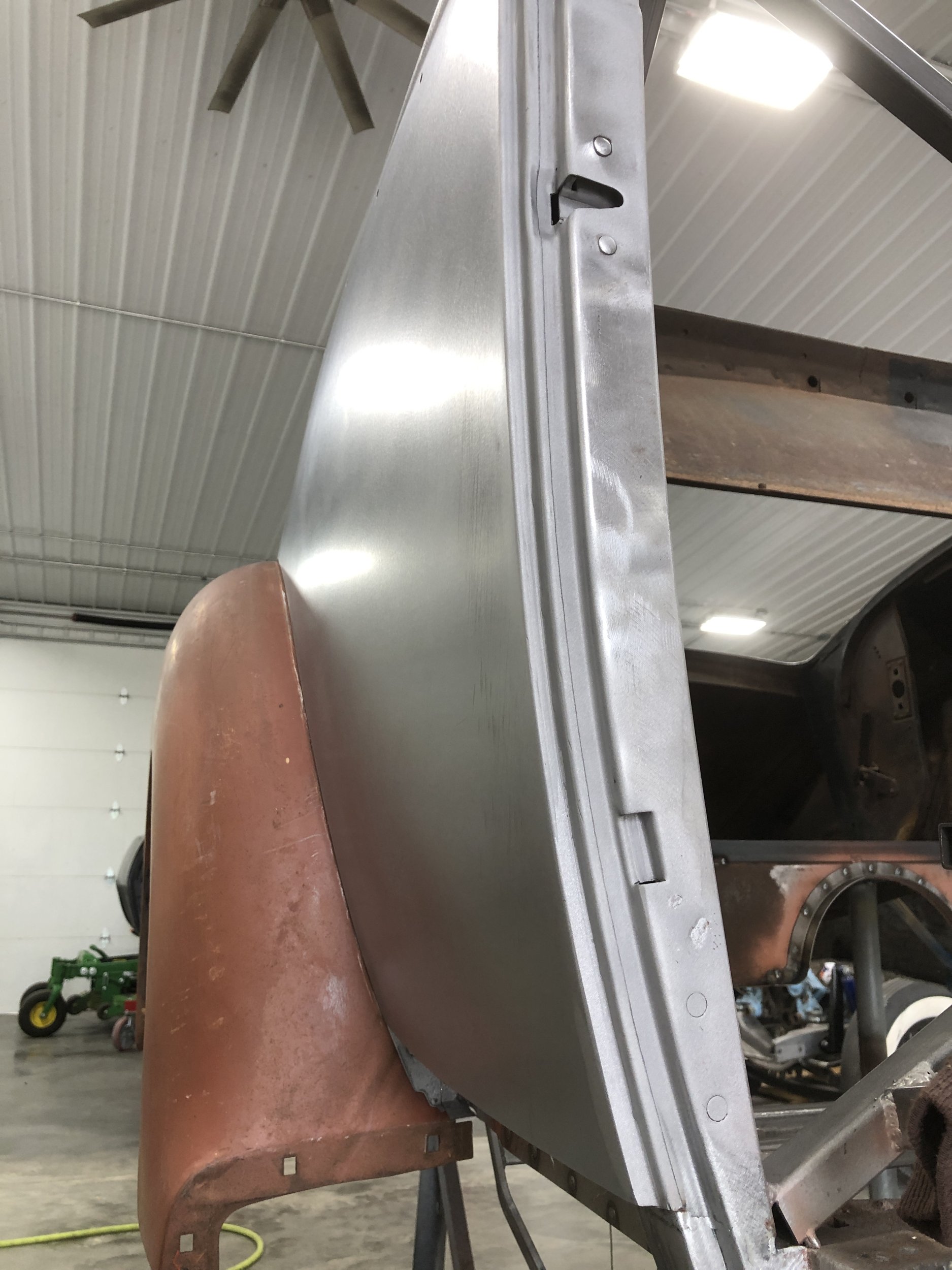

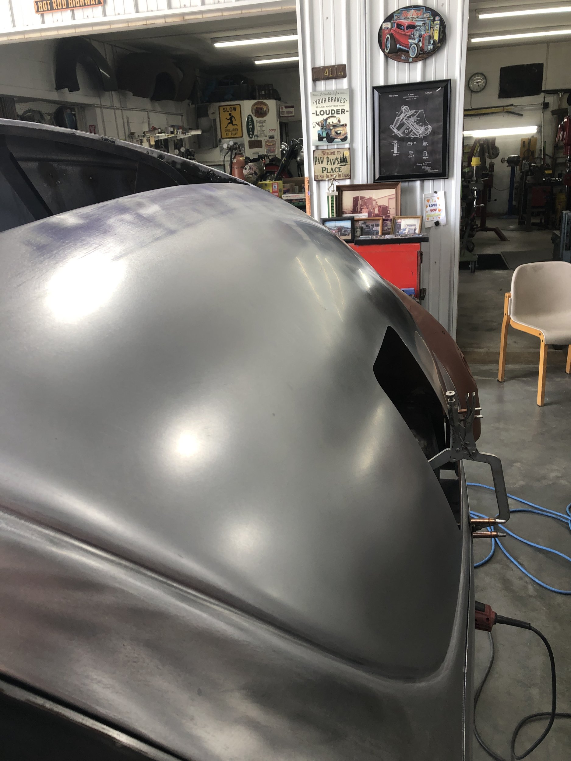

    Just a little update on some progress. IMG_0196.jpeg IMG_0197.jpeg IMG_0203.jpeg IMG_0201.jpeg IMG_0207.jpeg IMG_0216.jpeg IMG_0221.jpeg IMG_0220.jpeg I did a little bit of finessing on the sheet metal here and there.

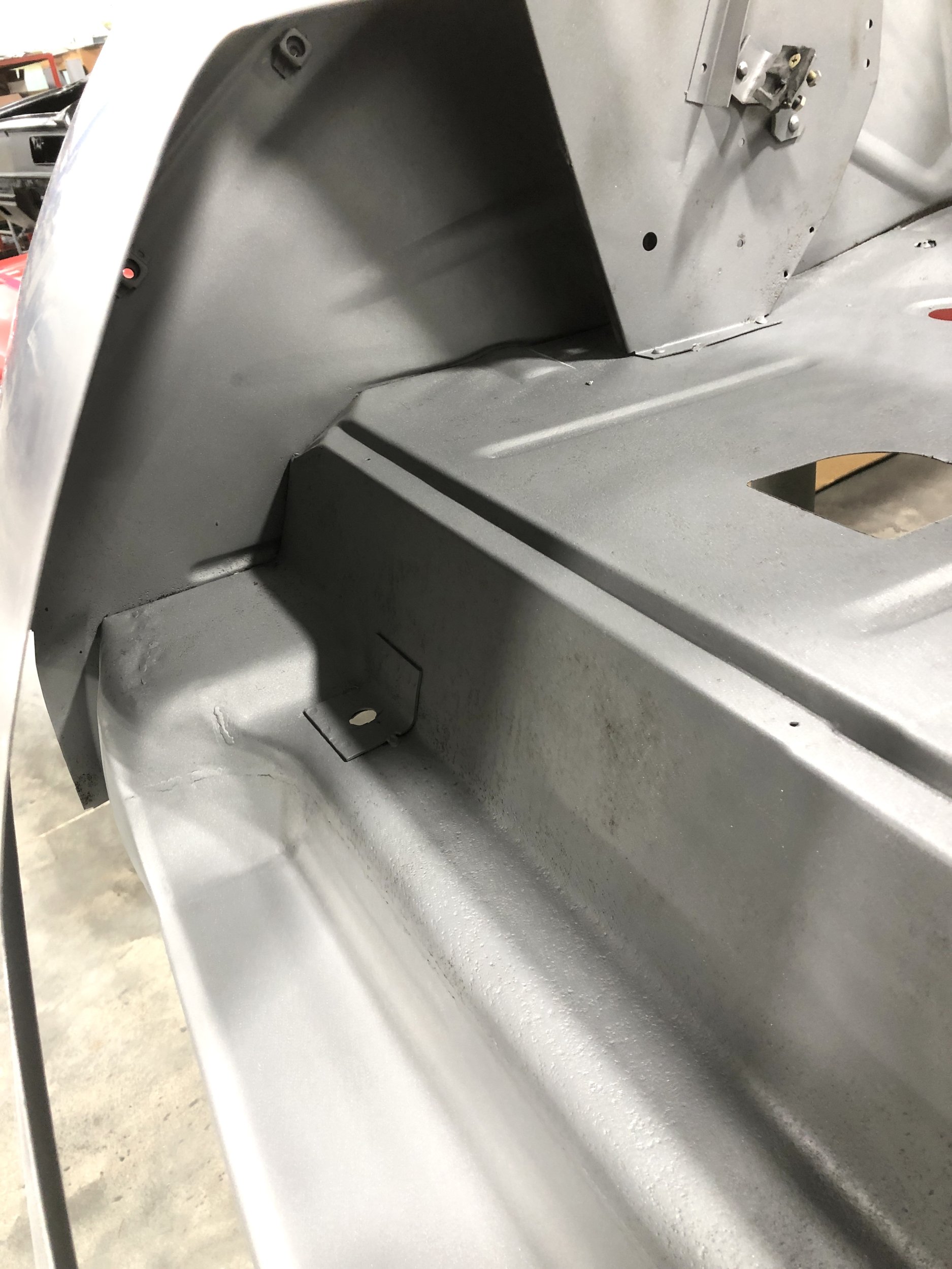

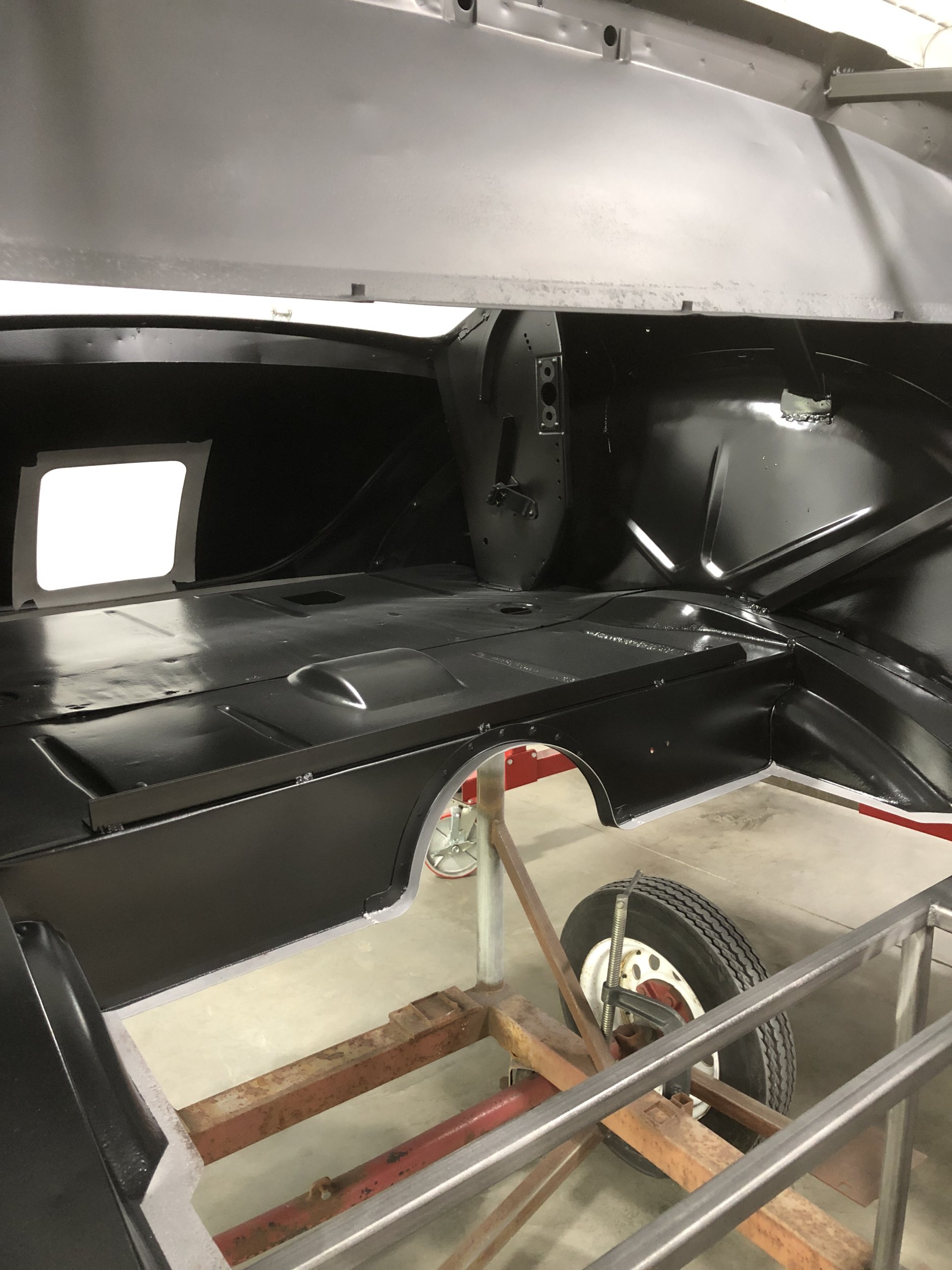

    Monday I decided to take the day to get some epoxy primer shot on the sandblasted areas to keep everything protected. I used black PPG EPX epoxy on the cowl section and the rear wheel wells and some Sherwin Williams industrial epoxy on the rear floor/interior metal as well as underneath. I then used some white EPX on the inside of the firewall area because I’m planning on painting that area with a Wimbledon white eventually. It will make it much easier to see under the dash when working under there. IMG_0293.jpeg IMG_0294.jpeg IMG_0295.jpeg IMG_0296.jpeg IMG_0297.jpeg IMG_0299.jpeg IMG_0300.jpeg IMG_0301.jpeg IMG_0302.jpeg

    Thanks. I agree, getting the sand out is tough. That’s the main reason I left the tail pan off until after I blasted it. It made it a ton easier to blow it out the back. I still have a good bit of metal work left to do, but I’m planning to get the body setting down on the frame before I put the rumble lid back on. Then I can finish the work around the opening. And then there’s the doors……lol. I’m a long ways from having a car but hopefully I’ll get there one day.
