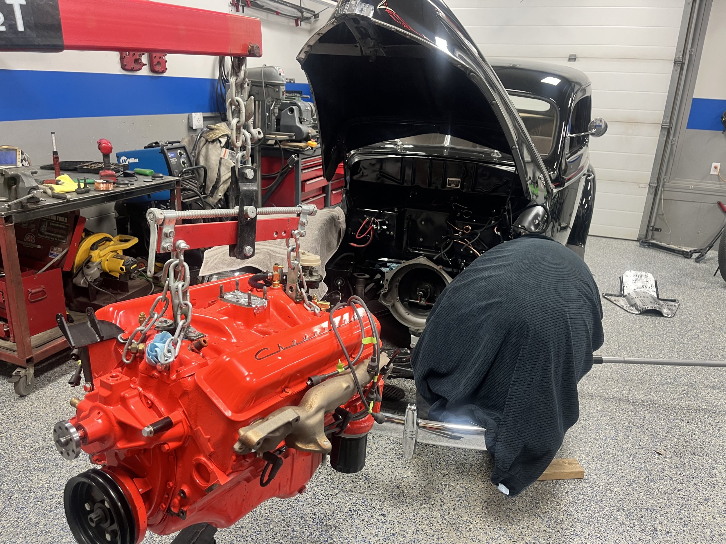

    I have a 39 Ford Deluxe Coupe with a SBC ( I know , IMG_20250727_123453905.jpg IMG_20250727_123453905.jpg I know ) it's still in the car but everything is off so It's just a short block sitting there. I purchased a 383 SBC for it but I'm wondering about pulling the engine. Do I need to take the hood off ? I've heard there hard to install one once off because of alignment problems and gaps. To me it looks easier to take the grill out so you wouldn't have to raise the engine so high to get it in but I would like your ideas or someone who has done this already. Thanks so much in advance !!

    If you take the grill out, you still gotta take the radiator out. You might as well take the front clip off and you might, I say might be able to leave the hood in place. Do not lose any of the bracketry behind the grill. It's essential to ever get things re-aligned

    Undo the hood at the shoulder bolts at the outer ends of the hinge arms. It shouldn’t get out of alignment then. If you pull the grille you’re asking for trouble.

    You do not have to take the hood off.
    olscrounger and lothiandon1940 like this.
  7. 42merc
    Joined: Dec 19, 2010
    Posts: 985
    42merc
    Easier to remove the hood than the grille.
    Hood & radiator removal gives plenty of room.

    Done many 40's both ways. Usually pull the radiator and grill and leave the hood like 40PU above.

    What he said. Leave the hinge alignment on the cowl alone as that's what sets it where it has to be. Much ado over...

    I agree with Alchemy. Remove the hood,but leave the hinge brackets attached to the cowl. Remove the radiator and you will have plenty of room. Separate the transmission from the engine before pulling the engine.

    Check it out, there's no way the hood ends up outta whack if you leave these here.
    Last thing, and it might be a biggie. Would you rather argue with a trouble light or have full shop light to work with? Just sayin...

    I have removed my 40 engine 4 times over 69 years. On my 40 I found it easier to remove the hood as shown in the photo posted by "the HIGHLANDER" and also remove the radiator. No need to remove the grille, fenders or front end. Take photos of the special shoulder bolts and little spring washers that secure the hood. Those bolts are a special length so they don't dimple your hood.

    10/2/25 From personal experience, it is possible to remove the hood by yourself. Loosen the hood bolts (not the cowl bolts), place a thick blanket of top of each fender and gently slide the hood forward. Then physically lift it up and off. Of course, having a helper does make it easier.
