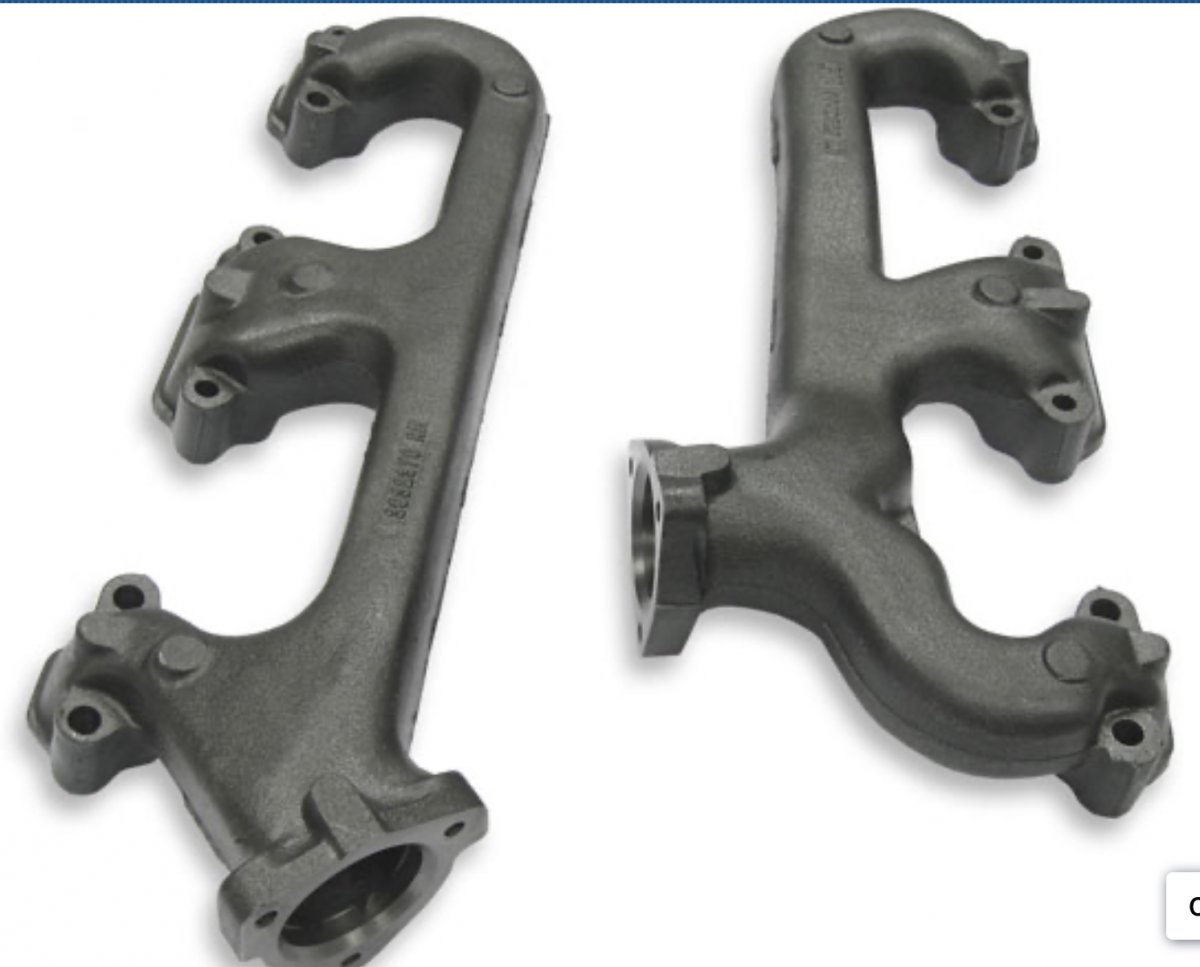

    I have a 39 ford deluxe coupe with a 327 chev and power glide in it. I want to put headers on it but want a more or less bolt and go header, with steering and frame clearance. does any header company make such a thing or is there modifications needed. I have the stock front axle and steering box. thanks for any input.

    If you don’t mind cast iron manifolds thy early 65 Chevelle manifolds they clear the steering box and look like were made for the swap. 99E9B560-8118-4337-BF6E-E731992600B5.jpeg

    thanks I-shot. that's what i have on there now but been thinking of using headers
