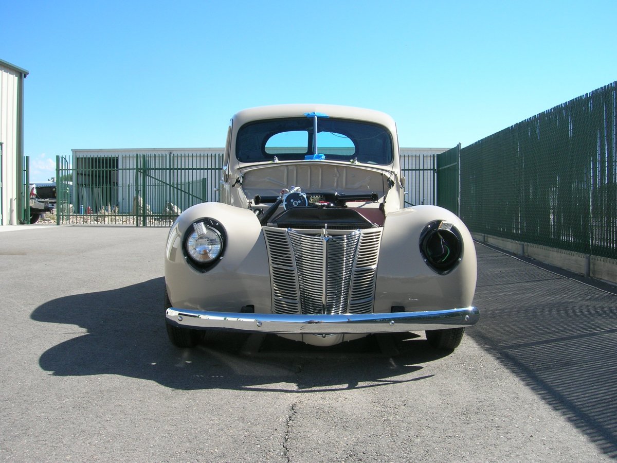

    I see 1937 ford headlights in 40 fords, if you use the 37-39 deluxe headlight bucket does it fit the 40 ford fender or do you alter it ? comments appreciated.

    I actually asked the Bob Drake Rep that question at Turlock this last January.
    According to him they bolt right in with no mods required, I have not tested this myself but do have a buddy building a 40 PU right now and he has purchased 39 buckets.....we shall see.

    I have done it in the past and they fit like a glove HRP

    drops right in

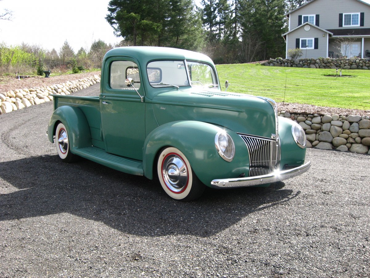

  13. 40FORDPU
    Joined: Mar 15, 2009
    Posts: 4,044
    40FORDPU
    IMG_1855.JPG They screw/bolt right in.

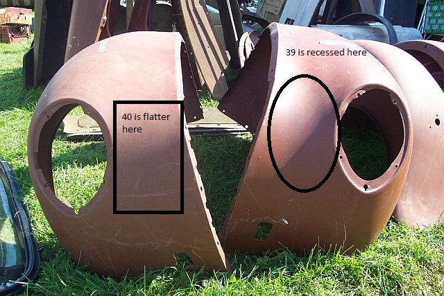

    You are seeing 39 Deluxe headlights on 40 Fords. 37,38 and 39 standard are a different shape to fit the earlier fenders.
    Although 39 Deluxe fenders do differ from 40 deluxe the actual area the headlight bucket fits in is the same.
    The headlight buckets between 39 deluxe and 40 differ in several ways. The stainless headlight ring attachments are different and the light bulb ***embly differs The 39 deluxe halogen headlight kit (spendy) works well. but as stated here still does not produce as much light as a 40 sealed beam headlight. I had trouble getting the gl*** to fit also. They say they are all the same but I had to try a few before I got the lens to fit.
