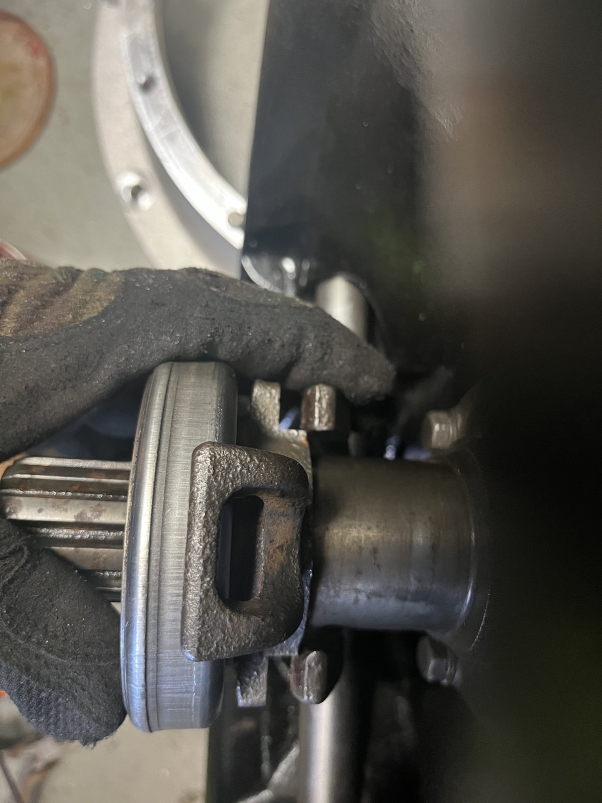

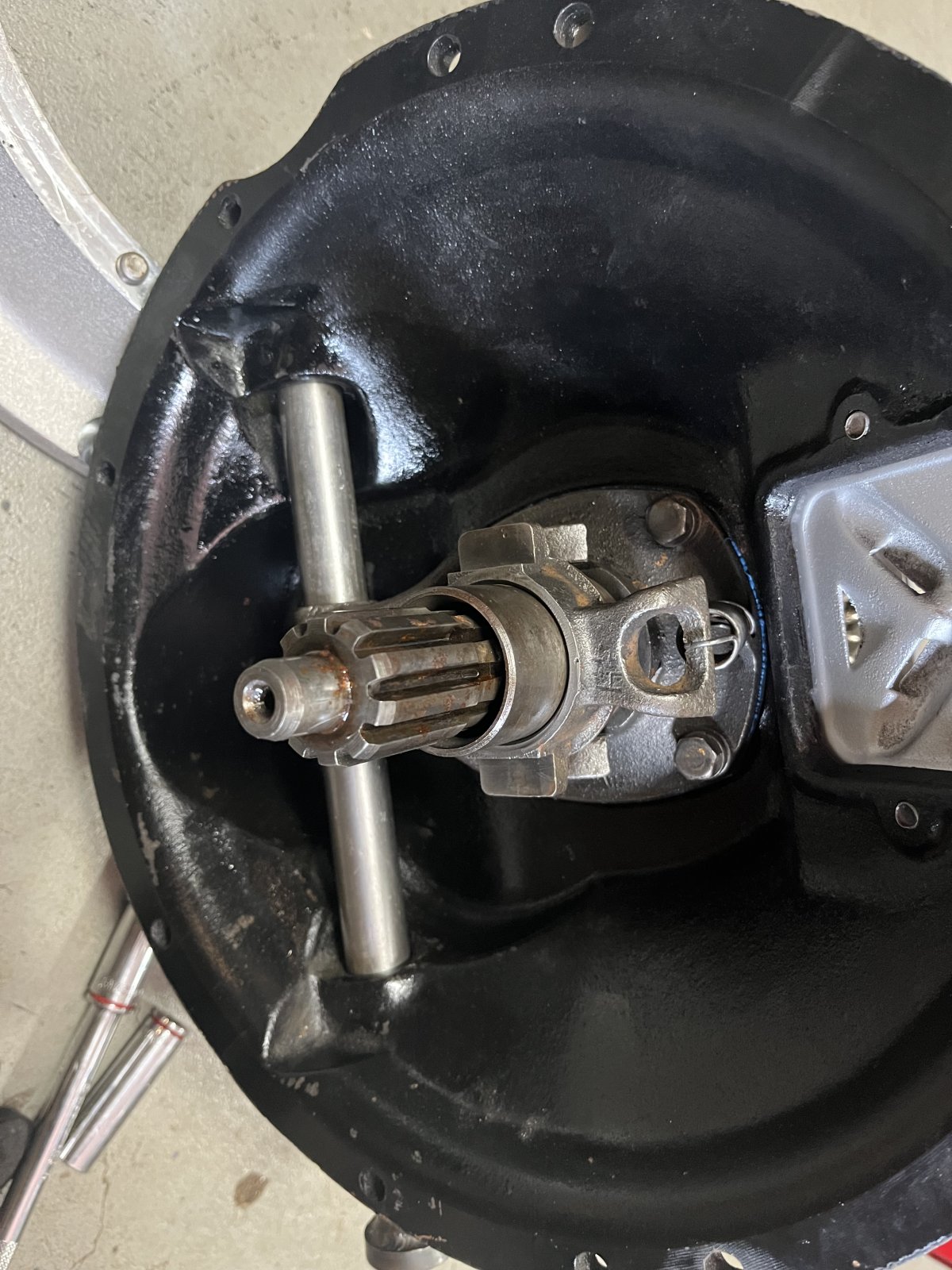

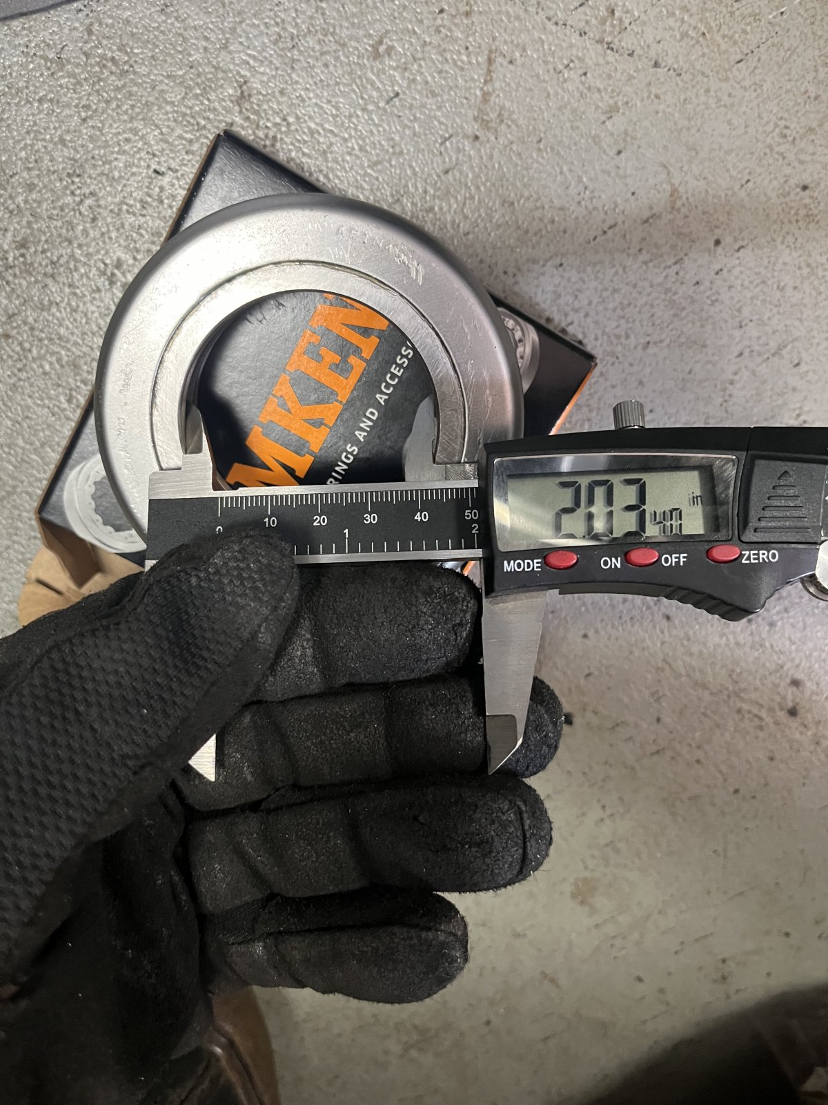

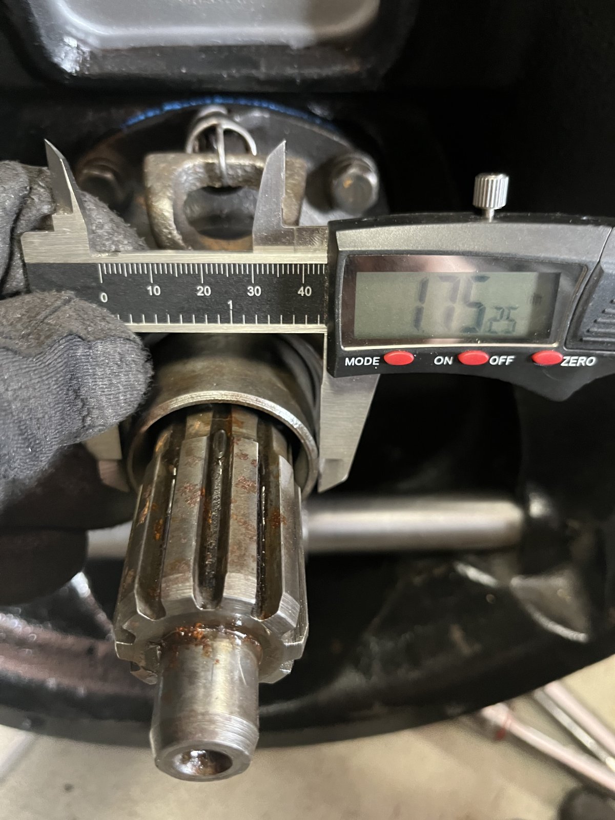

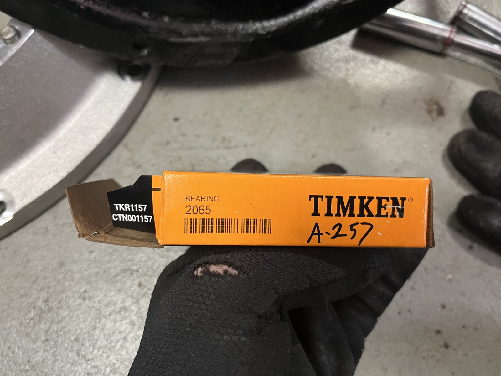

    Do I have the wrong one? Or is there a mix/matched part here?

    Your carrier is backwards.

    2065 bearing is the right number, got several on the shelf. Turn the hub around. press on the bearing with the bearing surface toward the PP, put just a dab of white grease on the bearing retainer, install and hook the spring.

    One other thing, make sure you have the radiused side of the fork against the hub not the flat side.

    Got it….And hopefully last question
    I ***ume the fork should be contacting hub on the flat area and I either have mix matched parts or I’ll need to grind a bit off one or the other to make fit correctly.

    Your on the right track. A couple times over the years after I used up all the NOS Ford forks I could find (I used to buy a 100 at a time) and Job Lot closed their doors some of the aftermarket forks were to narrow and didn't fit. Since they were cast I had to grind slightly to fit. If your fork is a gennie it's forged and can be bent.

    Grind either the fork or the bearing carrier.

    Check to see if the part number of the clutch fork is 48-7515.
    The inside dimension between the two fork arms should be 2 and 1/8 in.
