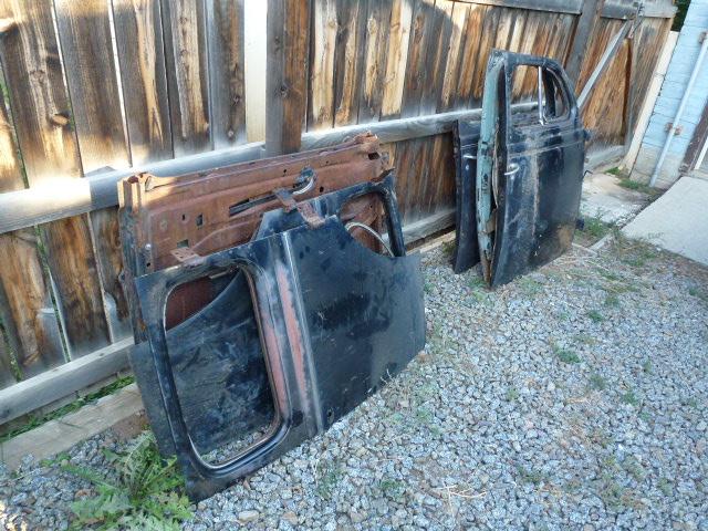

    I've got all the 39 Plymouth parts down from Crested ****e. I've got a coupe body, in poor shape, a sedan body with the roof cut off. There are some parts from a 4 door, but the body went to s**** years ago. There is also an extra ch***is. I'm not sure what I'm going to do with the bodys if they don't sell quickly. I really don't have space for them, I'd hate to s**** them but I may have too. The coupe body may be too far gone, but there are a few salvageable parts.
    I've got a few real nice body panels & trim pieces I'll save for my build, and I got the center grill trim, but its kinda banged up. I was glad to read that they can be reshaped & fixed. I kind of feel like hording the nicest pieces even if I don't need them. You never know...... I do have too much now and will have to sell off some of the pieces I won't be using.

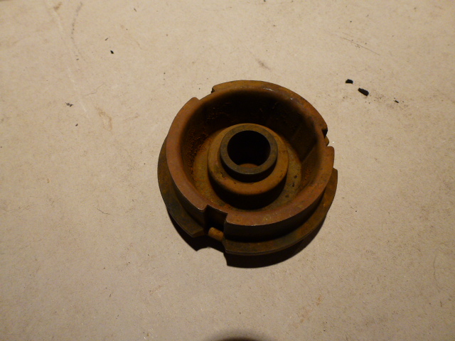

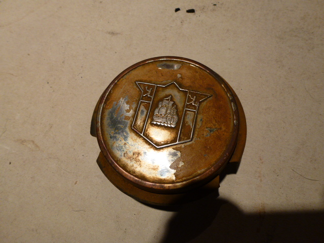

    The last 2 pics are of a chrome cap of some sorts with a Plymouth ship, I can't figure out what it is. Any help?

    I believe that chrome cap in post #44 is your horn ****on.
  19. c-w-a
    Joined: Feb 9, 2012
    Posts: 53
    c-w-a
    Oh yeah, I figured out its a horn ****on from a 49-50, not my 39.
