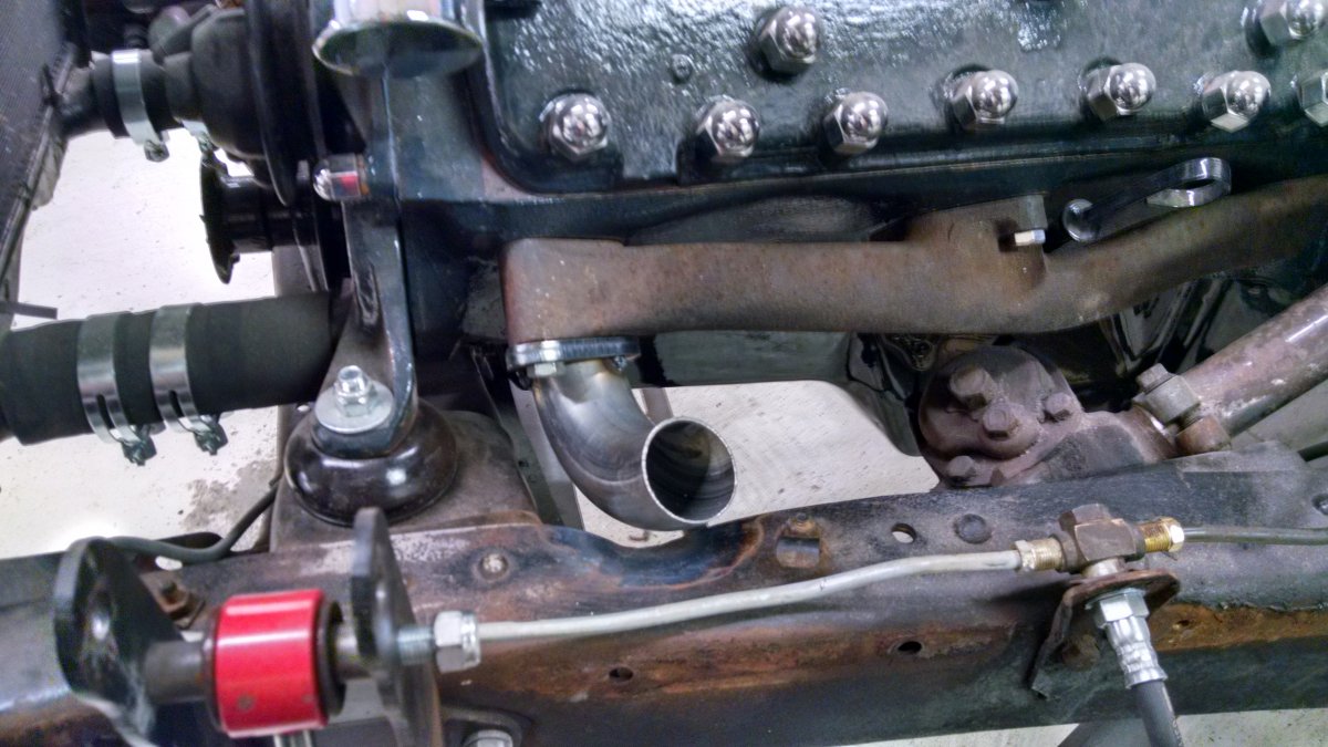

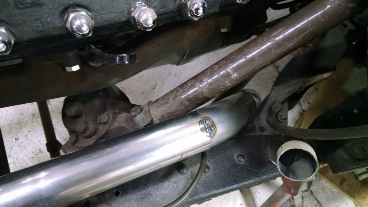

  4. On the dual exhaust - my 41 which was started to be mildly customized in in the late spring of '41 had the drivers exhaust similar to your idea but mine curved straight down and under do the frame did not require to be relieved - had to slightly dimple the pipe by the clutch pedal to clear at full travel - other then that easy peasy! My 41 is also going to be @ the Autorama - see you here

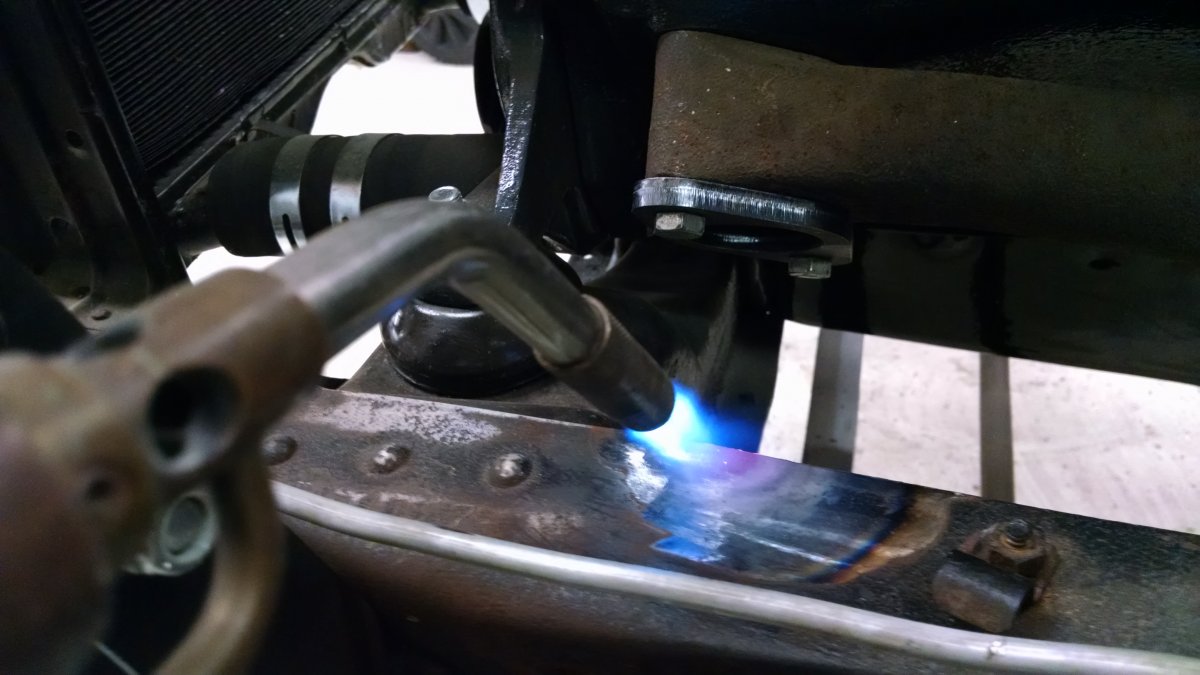

    I did some practice silver braze on the other stainless to hold a "nail" as seen on some interior trim parts. I'll be doing some stainless trim on the inside door panels and 1/4 trim panels. The heat anneals the wire just right to allow nice bends and even 2nd and 3rd chances of bending and straightening. Since these are only 1/4" I'll do the same vs trying to drill n tap. I'll just align a bendable nail to the 3 holes in the hood side. the 39s really need all the bright trim in the front. Looks naked without it. More to follow...
