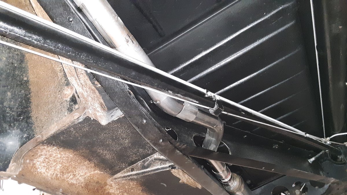

    Proceeding on the exhaust. I'm past the master/pedal areas, keeping it inside the frame through the existing holes in the X member. I flanged the head pipe to the muffler unit, just generic gl*** packs being used. The up n over at the axle is next and the tails are almost 2 3/4 OD polished stainless as mentioned before. Also all mandrel bends. Why not, right? It's getting there...
    20190115_192428.jpg 20190115_192441.jpg 20190115_192523.jpg 20190115_192510.jpg
    From here it's planned to follow the rail up and over the axle as far outside as possible, but real estate where the shocks go may be at a premium:eek:

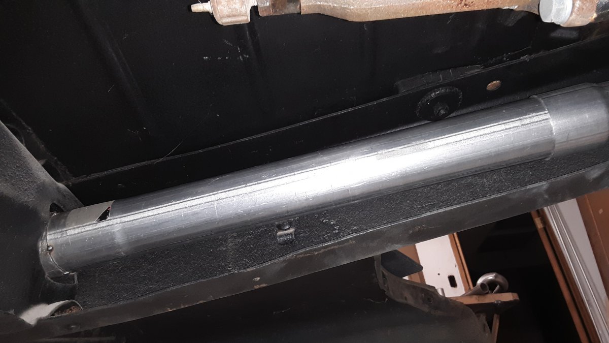

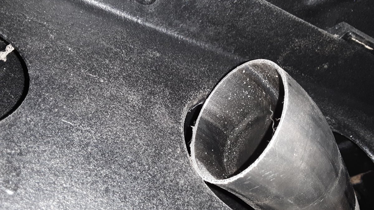

    Well I got to the end of the line on 1 side, and as 1/2 planned some of the more complicated pipes will fit the other side just right. I paralleled the wishbone in the rear then followed up the rail targeting what was likely exhaust pipe clearance in the rear crossmember. From 1 3/4 at the manifold to a 2 1/2" tailpipe as alluded to above. Time to duplicate for the other side then TIG weld it all for good.
    As seen in an earlier entry, starts at the manifold and goes up and over the steering box...
    20190120_173423.jpg from there it weasels on past the pedals and master cyl, and the pedal is shown completely down below the floor level...
    it then got flanged and adapted into a bigger diameter pipe...
    My initial path would have been too close to the master, I changed course and went thru the smaller hole at the outside of the frame support...
    We're up to 2" from here to the wishbone, the pipe is welded to the muffler, effectively making that ***embly pretty long to ease final installation and reduce the number of clamps...
    Once it arrives at the back of the X member it takes a couple turns. I wanted it to parallel the 'bone then turn up in order to have full use of the available real estate and rear travel.
    My target for the tailpipe drop was next...
    From here it went to 2 1/4 then gets to 2 1/2 as it goes thru that 1/2 circle in the rear member, and staying as far inside the rail as possible along the way...

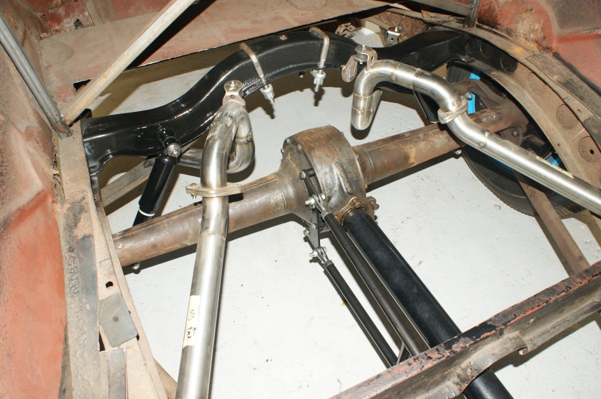

  23. 1pickup
    Joined: Feb 20, 2011
    Posts: 1,982
    1pickup
    @theHIGHLANDER Can you snap a pic of your rear upper shock mounts? Gotta make something for mine, & it looks like it's gonna be tight with the exhaust running through there.
    Stogy likes this.

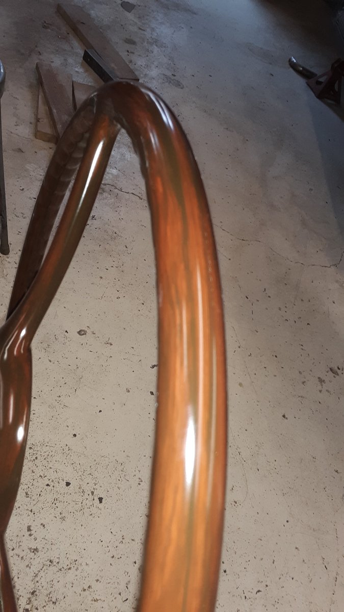

    @theHIGHLANDER Did you get your steering wheel wood grained? If so, any pictures you can share?

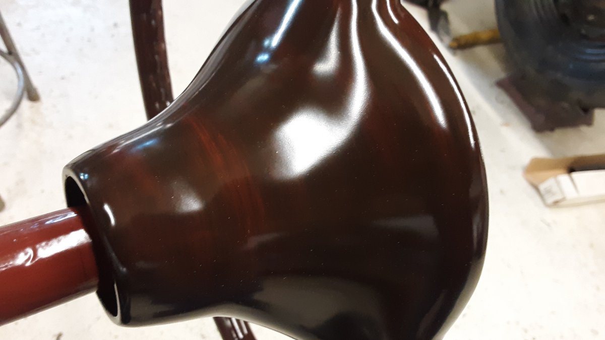

  26. theHIGHLANDER
    Joined: Jun 3, 2005
    Posts: 10,924
    theHIGHLANDER
    Thorl, I'm not woodgraining the wheel. I'm doing a sort of trick paint deal where it will look semi translucent. I was working into the final coat and it came out an ugly almost military green pearl. Still scratching my head on that one. The wheel I was woodgraining was for a 33 Packard 12. It came out like OEM, which was actually cast in a brown and orange swirl to imitate grain. Here's few of that if you like. There was a brown and burnt orange Bakelite mix that they used, this was the base I mixed up:

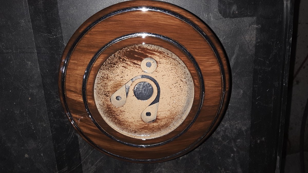

    031.jpg Then did my grain thing and got some satin clear on it. The goal was "as bad as" the OEM look.
    Then the horn bezel gets grain and is gloss clear. Tough to take pics of but in person it looked like the real deal. Client was quite pleased.

    Wow! That looks beautiful! Amazing work - thank you for sharing.

  30. 1pickup
    Posts: 1,982
    1pickup
    @theHIGHLANDER that helps. Just wondering if you had made a "crossmember" to mount the uppers, or just individual mounts on each side. Is yours a bolt in, or welded in? Plus, my exhaust has already been done with the stock shocks, but I will be replacing them. Might be tight, & I don't want to re-do the pipes.
    Stogy likes this.
