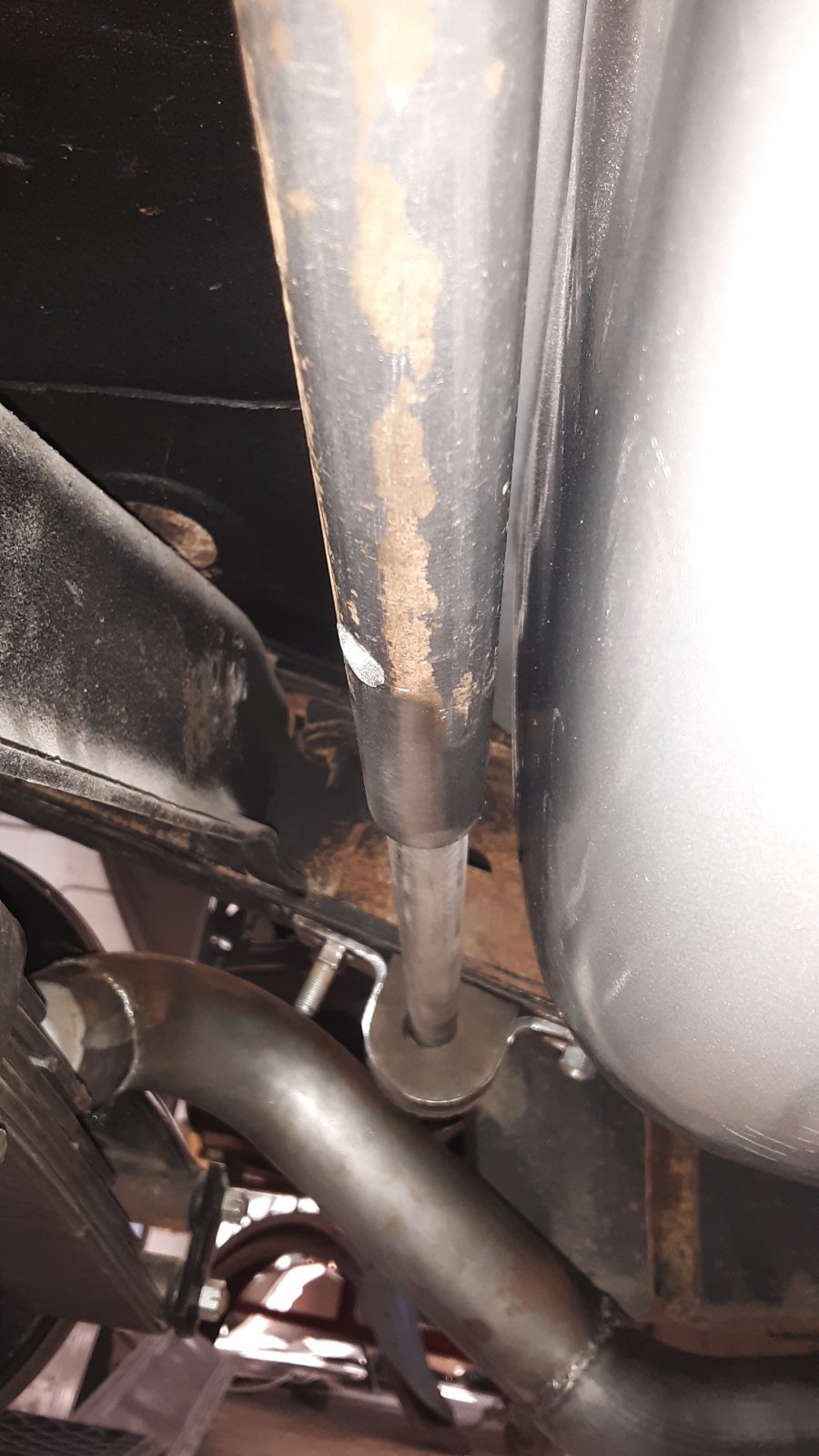

    @1pickup it's a mounting stud that's in the stock crossmember back there. I used a 1/2" Rotobroach for the hole to keep it clean and easy (lots of wax), it comes with a nice heavy washer for the back side. Like I mentioned above, one of my surprises was the tilt in the stock crossmember at that point and it angled the bottom of the shock toward the front of the car. Again, my solution was to squeeze that area with a big 'C' clamp until the shock was plumb with the lower mount, and that was made easier by t******* the outer forward flange about 2 1/2" for clearance. I'll try to **** some close up shots with the pipes out of the way. When you know what you have to do it goes easier and faster, like the other side did;)

    @1pickup here's some add'l upper shock pics. Note where the flange is cut on my crossmember...

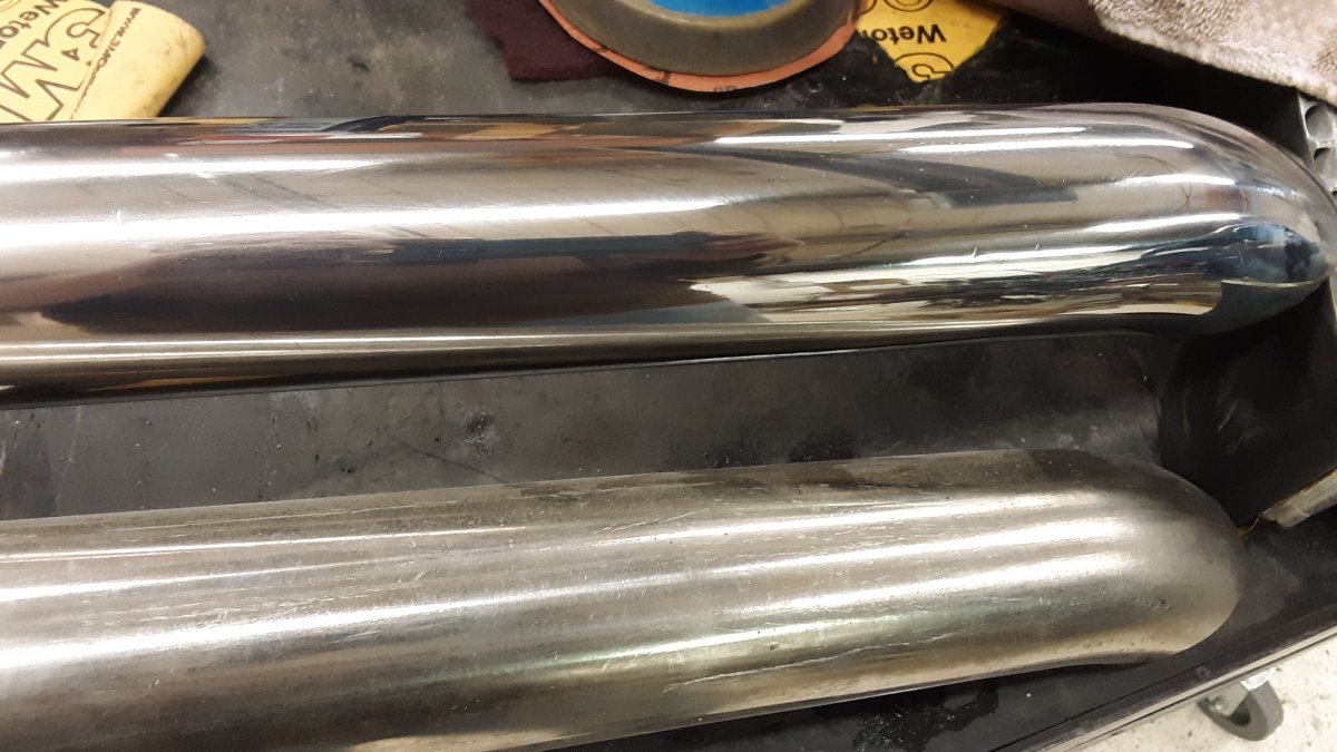

    Another chapter almost completed, pipes. I picked up where the pipes make their way through the rear of the main 'X' member at the back. I ended up keeping the tube size 2" as far back as I could before stepping up to the bigger 2 3/4" for the stainless tailpipes. Just because, I tried to keep each side as symmetrically opposite as possible:

    One side ready to final weld n install. The tailpipe was the star of this show. I had a target in mind and placement too. I think I'll be alright with this:
    20200427_180032.jpg 20200427_175933.jpg 20200428_125137.jpg 20200428_125119.jpg 20200428_125241.jpg 20200428_125208.jpg
    There's a minor turndown at the end. I won't have it point down, each side will face just slightly outward. Seems to fit my vision of this better. It was a little aggravating but the other goal was to have the pipe be seen just below the rear fender. It's the only place I wanted exhaust to show outside the car. They're big, stainless, about 2 3/4" OD.

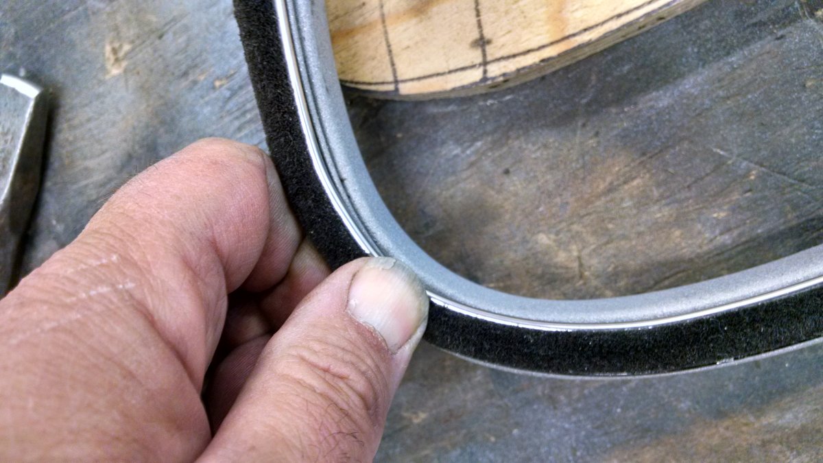

    I was just looking at this on my Sedan yesterday, Not cheap from Drakes, where do you get the straight felts from?

    I had a local swap meet, the guy sells excess and overstocked stuff, and also full straight lengths. You're in jolly ol England, I'd think the ride would be cost prohibitive. These were (at the time) about $30 each. That was few years ago and we gotta hope the rona didn't kill his biz. And I'm not sure it was worth it for the effort needed but they came out just fine.
    Also, on the belts, if you have a drag race friend they expire every 1 or 3 years (depending on cl***) or so and they need new ones. Worth a look.

    You might try any businesses over there that do automotive gl***. Especially ones that work with vintage stuff.
    There's a place near me that does all vintage and custom gl*** and they carry several varieties of those window fuzzies. Very helpful people and they gave me a lesson on bending it. As a result I won't be buying a brand 'kit.'

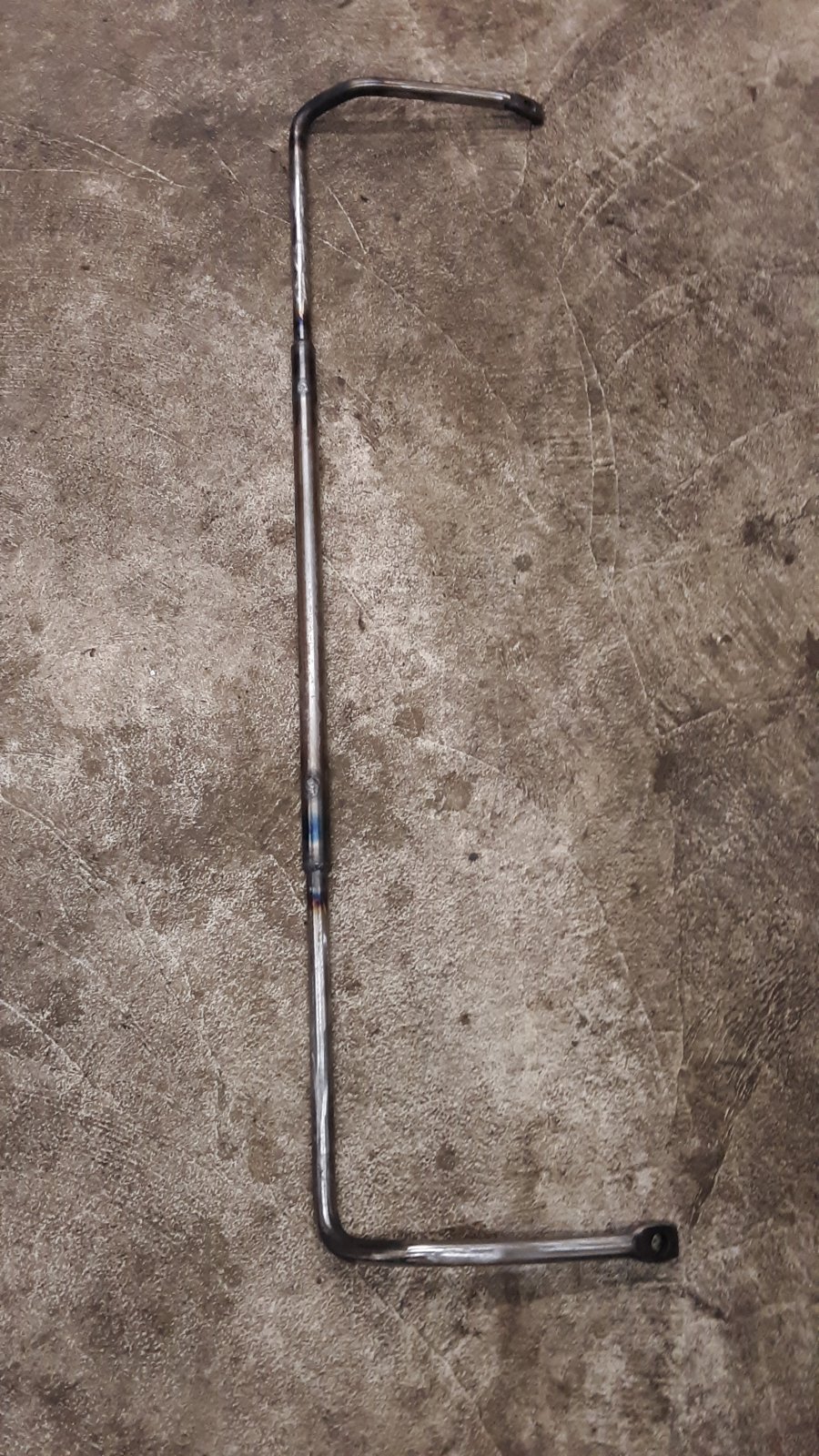

    Ok, another box checked. Shes got a rear sway bar. I ****ged a smokin deal on a Mustang bar that I modified and made to suit my needs and available real estate. Yes, I took a lotta things into consideration and it's also not like I'll be diving into the turn at the end of the Mulsanne Straight at 220 MPH :eek:
    So here's some process and finished pics I'll explain as I go, as usual.
    I made a heavy paper board pattern. Donut boxes work well for this;)
    I made the mounts out of .125 steel and the paper pattern was intended to be reversible. I'm lazy like that.
    So next I bent the bar for 1 side and worked it into place. The hoarder I am, I had 2 bar to frame mounts laying about that fit the old shock holes. No frame drilling thru the double braced area so lucky me.
    Once done I mirrored everything opposite for the other side. I had to widen the bar about 1¾" so I used some .125 wall seamless DOM about 24", used a roto broach cutter for four ⅜" rosette welds to compliment the end welds.
    All of the bar bending and welding was left to slow cool to maintain the properties of the bar and sleeve.
    Painted up everything and just because I'm me I added a part number to the brackets. 81A is all the 37 thru 39 std ch***is stuff so what the hell, why not.
    Next post with all of it installed...
