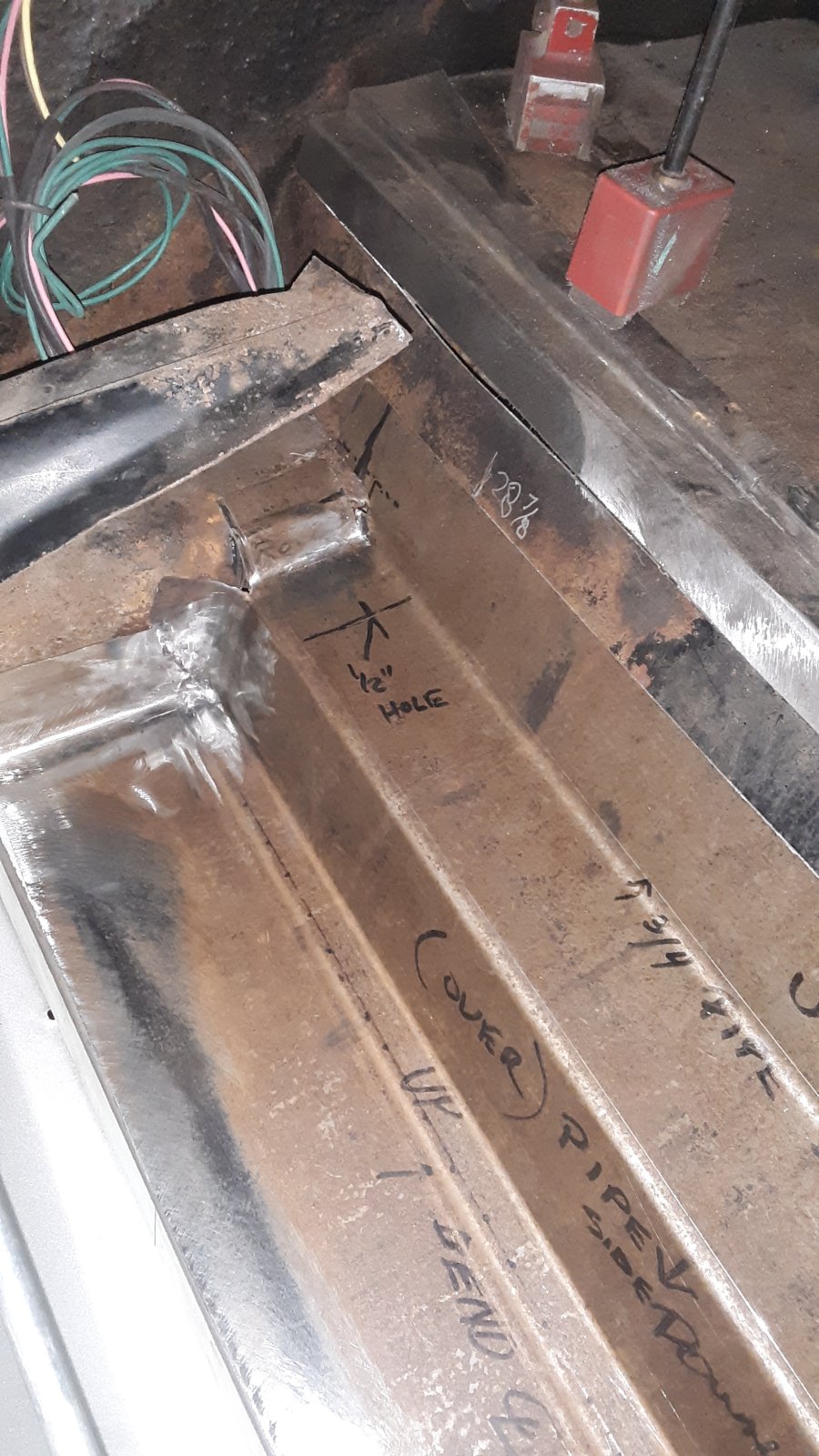

    Next I took a bunch of measurements and started to map out the bigger area. Thought about small sections but then said **** it, make new. Couldn't get sheet metal that day, so I found a trunk section in that old roof from the Impala job;) Heavy enough but not too much so I diced out about 36 X 24 inches. Next I decided measure and sketch and, and, **** it. Grabbed an aluminum welding wire and made a shape gauge. I laid out where I want to bend and took it to the bigger break at home. At 1st the plan was to lay a chunk of heavy tube and get radius corners, it fell out once, then the second time almost smacked my nut sack. Regular bends it is.
    Now the fun starts, cut, fit, install, pull out, measure, cut some more, shape the ends, try to duplicate somewhat but honestly not looking for Dearborn Award restoration. Strong, accurate enough to keep the tool box and panels once done. I'm so close, time to trim out the car for final fit and get ready to weld it all in.
    For the lower corners I cut a piece of poster board and stuffed it in, observed the bent area and made the cut, sticking it back in to see the final. Laid that in the corner of the new floor and marked, cut and welded to close up that lower transition. Cleaning up the work area of rusty **** and tools not needed for now, install coming soon. I got a new tail panel too that I'm super happy with. Stay tuned...

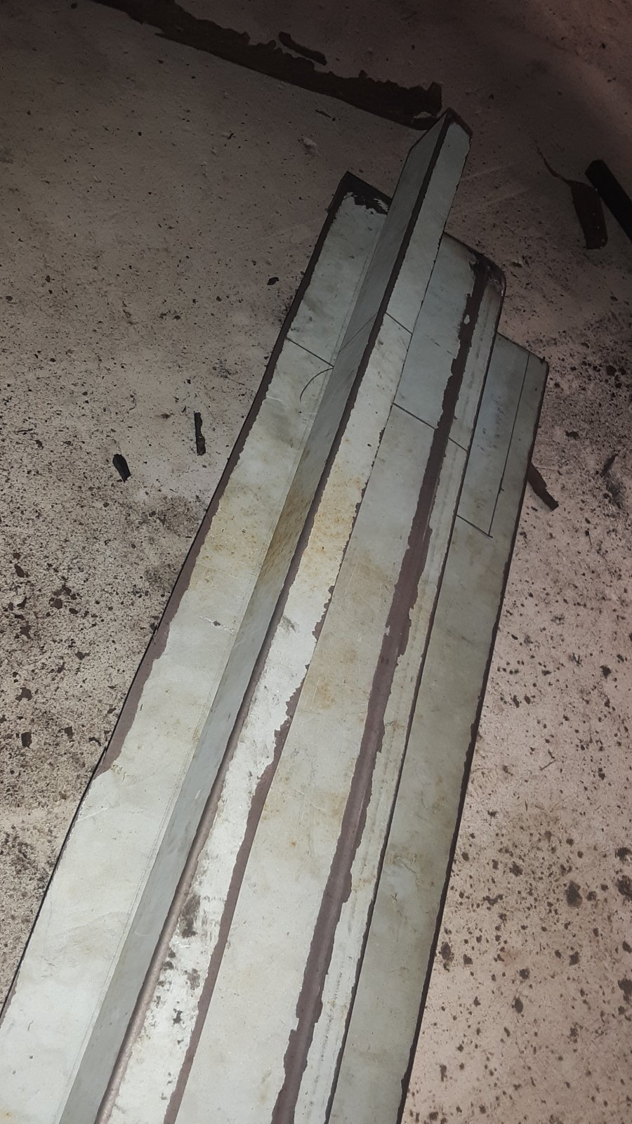

    A couple details I cover more in depth later but 1st important move, I cut a cpl ¾ box tube sticks and supported the original floor before I took the 2 body bolts out. Once the biggest box section is out you don't want the floor to drop and it could, which then could buckle ¼ panels and ****. No thanx. Also leaving the decklid mounted so I can monitor fit as I go. Before the big cuts get done I'll scab in a temporary support across the opening to maintain size as well. If it all can't move around it won't. Film @ when I get some more done tomorrow.

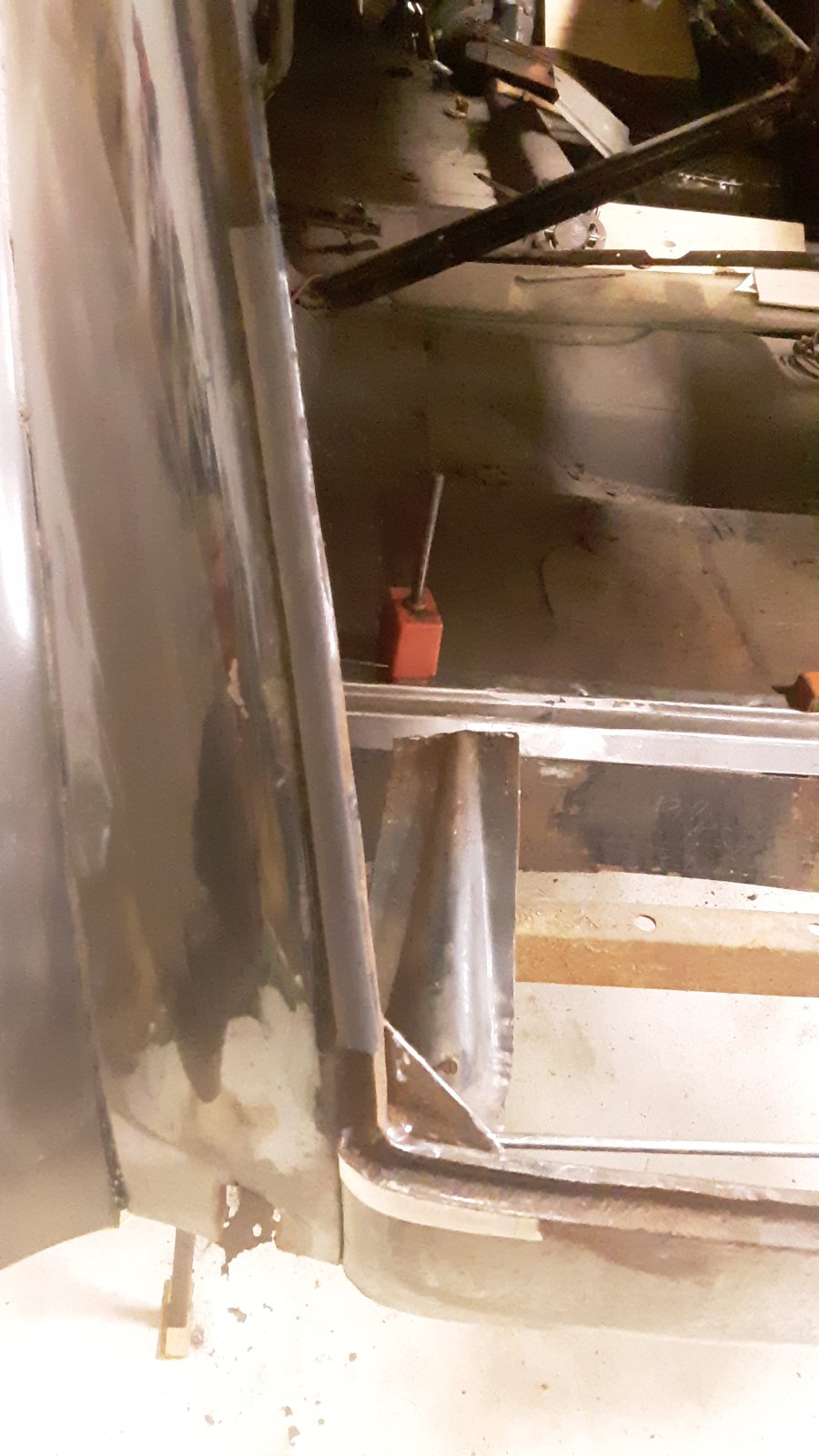

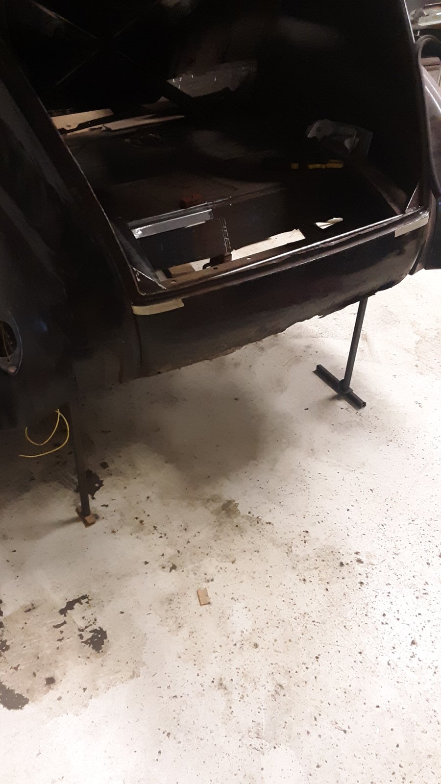

    Well, next phases. I braced the opening side to side, then cut out the old tail panel. Nasty job but...
    The taped area will be left in. I don't want to get into body work on the qtr panels and the corners fit the lid perfect. I'll weld/metal finish to the taped area.
    Once the old was cut and spot welds chiseled off I fit the new panel. Fits like it grew there with just a spot check. No complaints, in stock, got it in 3 days.
    With everything out of the way time to set the trunk pan. Originally it had a 1 ⅞ return flange, I don't have that level of break equipment so I made a separate C channel and will spot weld the trunk floor to it, will weld it to the car to set hgt and distance.

    Next phase is to final trim the car itself, cut the floor bottom back to the channel, clean it all and start makin sparks. New tool box coming soon to a std near me. See ya in a cpl days...:)

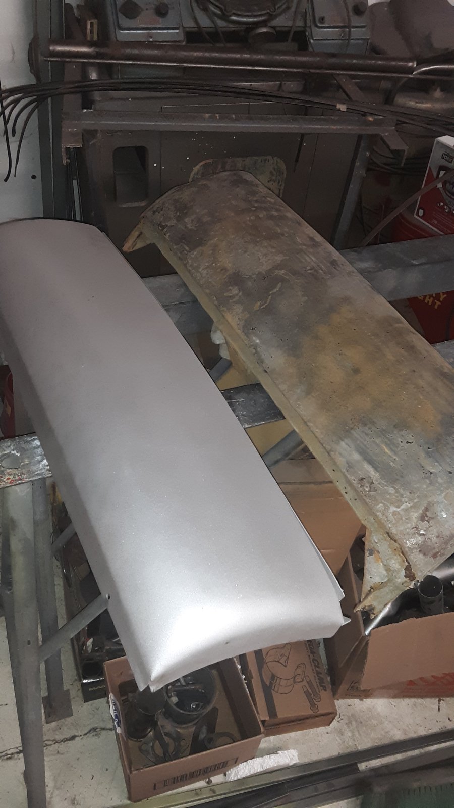

    I have an original tail panel. It came with the car, cut out from another. I soaked it in a mol***es bath for several weeks and it came out full of pinholes. This new one matches every dimension and my deck lid arch perfectly.

    Did some more. Got the new panel fitted now, seems to be as good as I expected, maybe a bit better. I duplicated the mark I made on the original corners. Again, the idea was to not have to do body work on the existing qtrs and preserve the corner fit of the decklid.
    On the car I cut right at the tape line, on the new one I traced the tape and cut inside the line to make up for the blade thickness and reduce the trim/fit effort.
