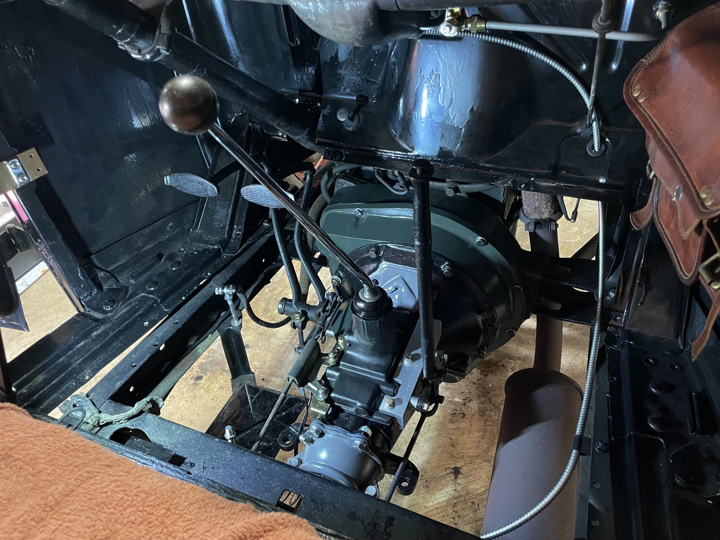

  11. 51 mercules
    Joined: Nov 29, 2008
    Posts: 4,331
    51 mercules
    51504bat likes this.
