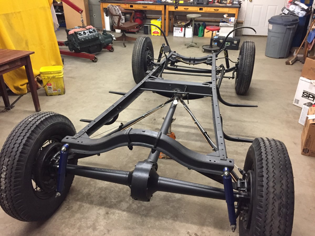

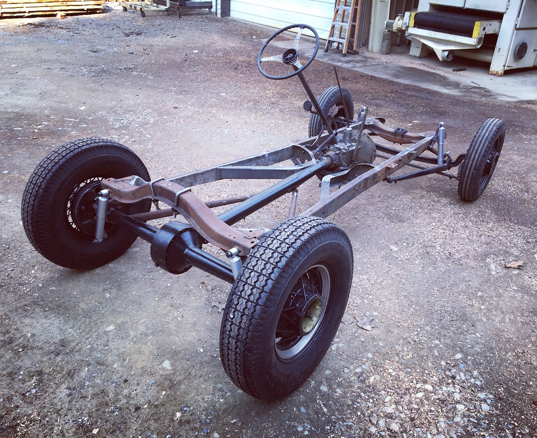

    I disagree with Fred. Yea if you’re expecting a bolt in solution it’s not the answer. I have used many of them and while they do take some modifications to make the fit proper they are a great solution for a v8 trans/pedal setup in an a frame. Note that a k member Will need extensive modification to fit an a frame and if you ever have trans trouble you’re pulling the front sheet metal, radiator, and engine to get to it. Here’s a recent install we did on my pal Dave’s pickup chassis. No firewall mods.

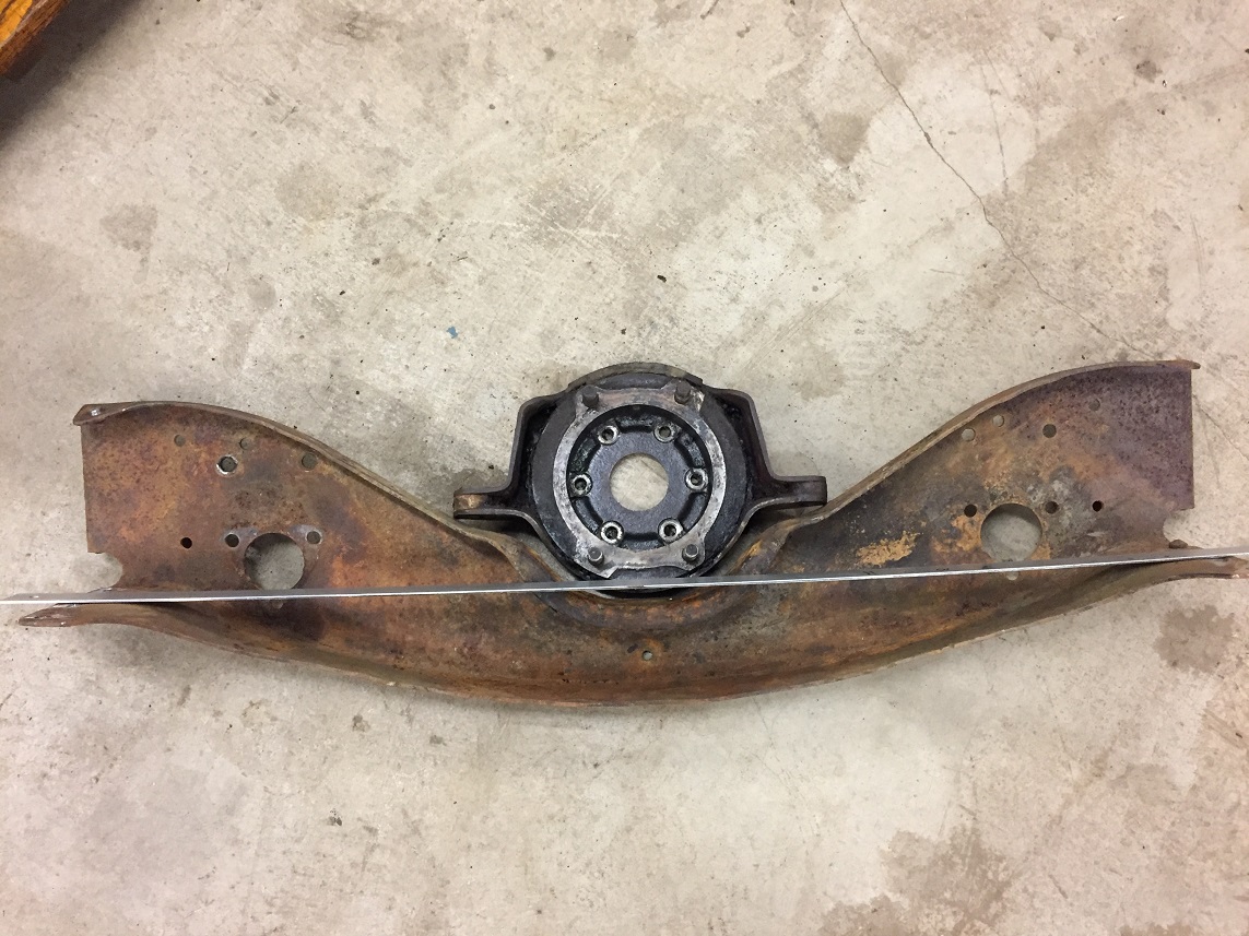

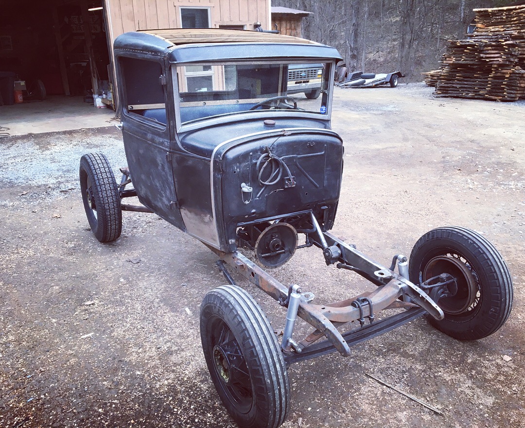

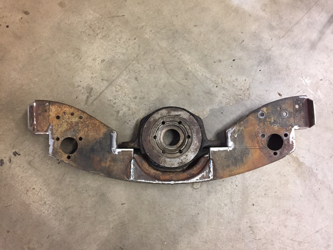

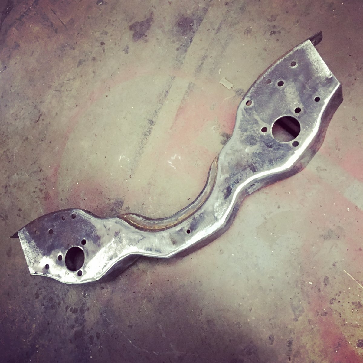

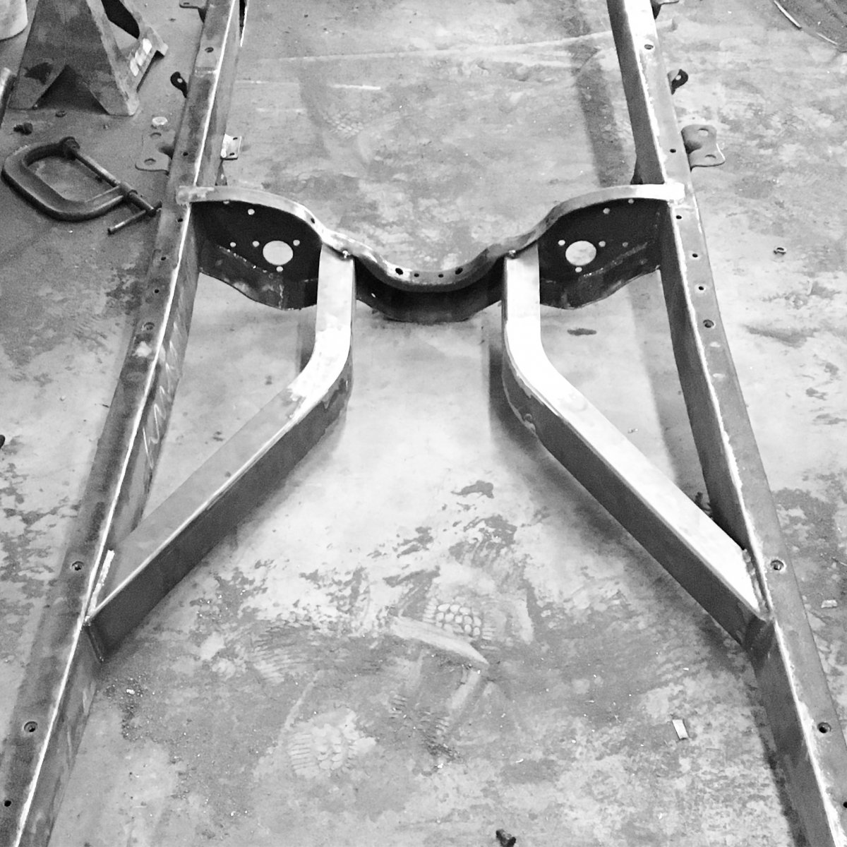

    I saw a thread by HAMB'er Justin in PA, back in March 16, 2018 title "Another way to hack an F1 Crossmember" that seemed to be just what I needed on my 27 T on an A frame. Pictures are of Justin's crossmember before and after. The first pic is a stock F1 crossmember and the second is the result of some careful measuring and fabrication. Mine looks pretty much like his but I haven't cut the ends to fit yet. When I was done with mine, the rear of the tranny sat 1 1'4" lower than stock.

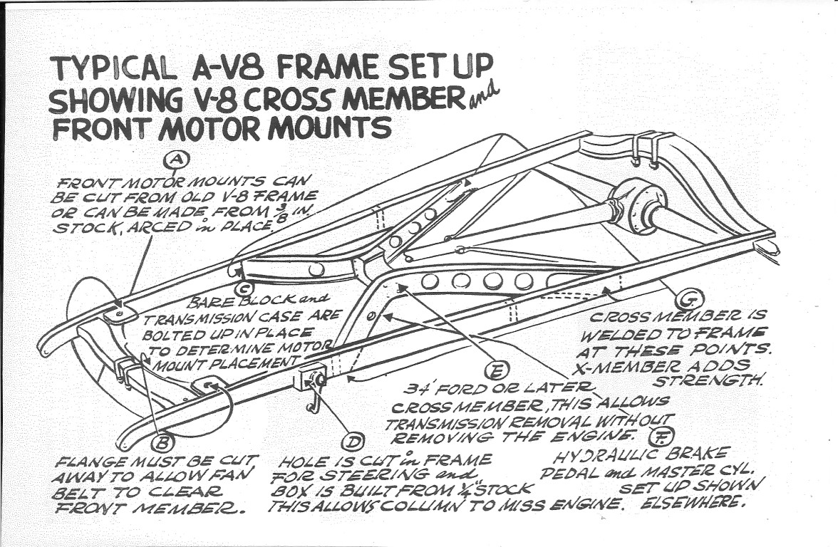

  15. My kid has done a lot of "A"s (including '29s) with F-1 cross-members without any problems; but now that we have now learned that it doesn't work; here is another way to consider. As a bonus junk '35-'40 frames are cheaper than '32 Ks.

    thats out of floyds book, aint it rich
  17. Could be; don't remember exactly where I found it; but it is a neat drawing.

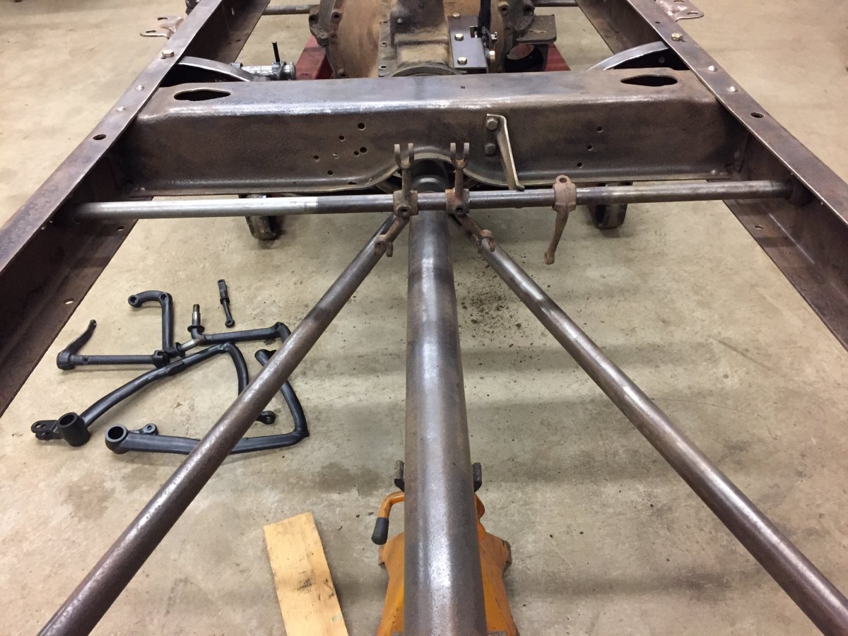

  19. Justin in PA
    Joined: Sep 27, 2017
    Posts: 128
    Justin in PA

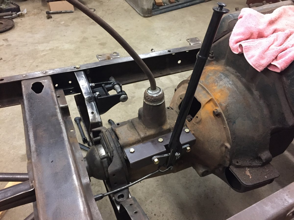

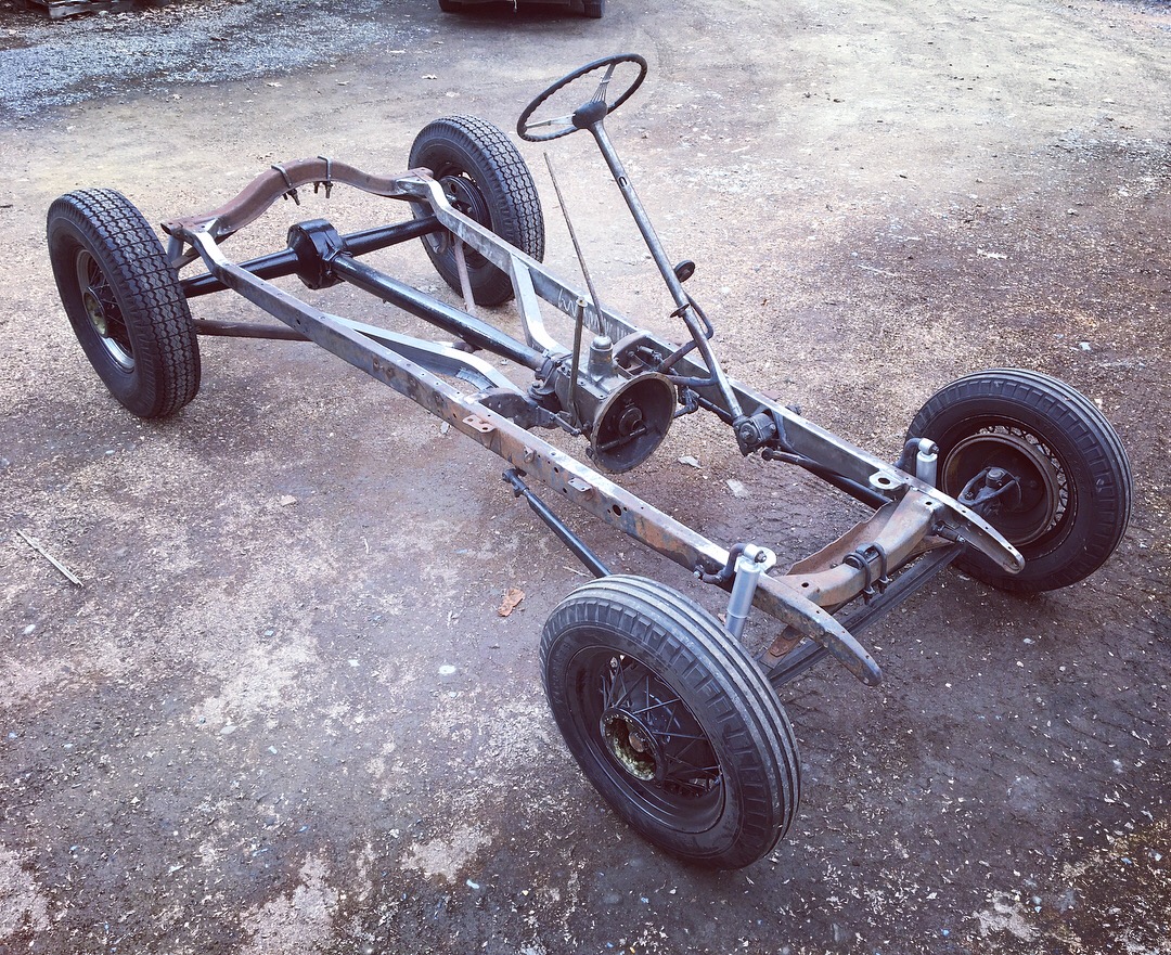

    Alan, here are a couple of more shots of my F1 cross member in place. They work just fine if modified correctly. I left the stock A cross member in place also. It is true that using the F1 cross member with the original F1 rear trans mount without modification puts everything way too high. For my stock flathead I don't need an expensive '32 K member or one of the high priced aftermarket ones.

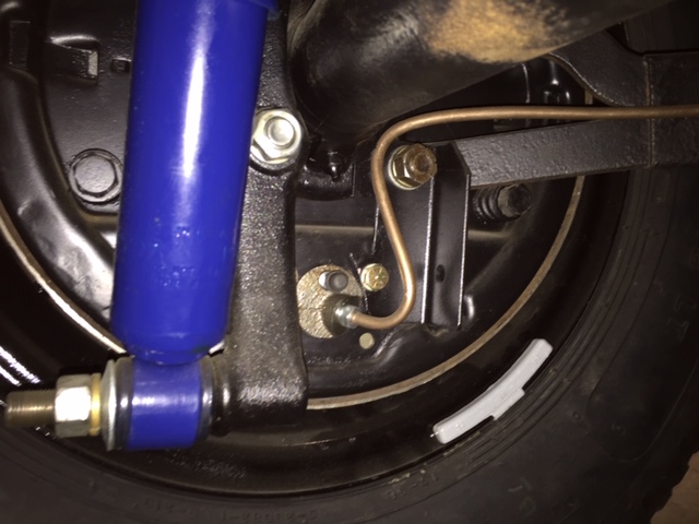

    justin in pa, what are you doing with the A mechanical brake shaft?

    Rusty Valley, I'm using it for my emergency brake. It was in the mock-up stage when the photo above was taken. I don't have a great picture of the final product except for below. I rotated my rear backing plates to get the e-brake passages on top and then ran cables from an equalizing pulley to each wheel.

    Rich B, when rotating the backing plates you need to keep the wheel cylinder upright with the bleeder on top. You need to relocate the large center hole as it is offset from the mounting bolt holes. You don't want to just re-drill the mounting holes as that will put the cylinder pistons out of line with the brake shoe push points. Of course, now the brake lines have to run downward which puts them at risk of being damaged. Since I used Ni-Copp, I added a deflector just in case something flies up from the road and the shock mount protects them from the rear (it is hard to tell from this angle but the deflector is out as far as the brake line). I also am using a dual master cylinder as a second defense against a broken line.
    When the wheel cylinders are arranged like this, you want the large bore end of the cylider to be pushing on the long shoe.

    I can say, from experience, it works in an A frame with a '28/29 body. Mine wasn't as modified as Andy's cross member, but it works.

  30. The drawing says '34 or later; I think a '37-'40 would be the best due to trans mount. Just set the X on top of the A frame in the right fore and aft location, mark the legs where they cross the frame, cut them down, pie cut the ends to match the height of the A rails, slip the X in place and weld it in. Maybe a good use for a frame with the typical rear kick-up rust out. You could also take the stock center out and use the two legs with something like a CE center kit if not using a flatmotor' like in this picture of Mike's '32 frame over at my kid's place.
