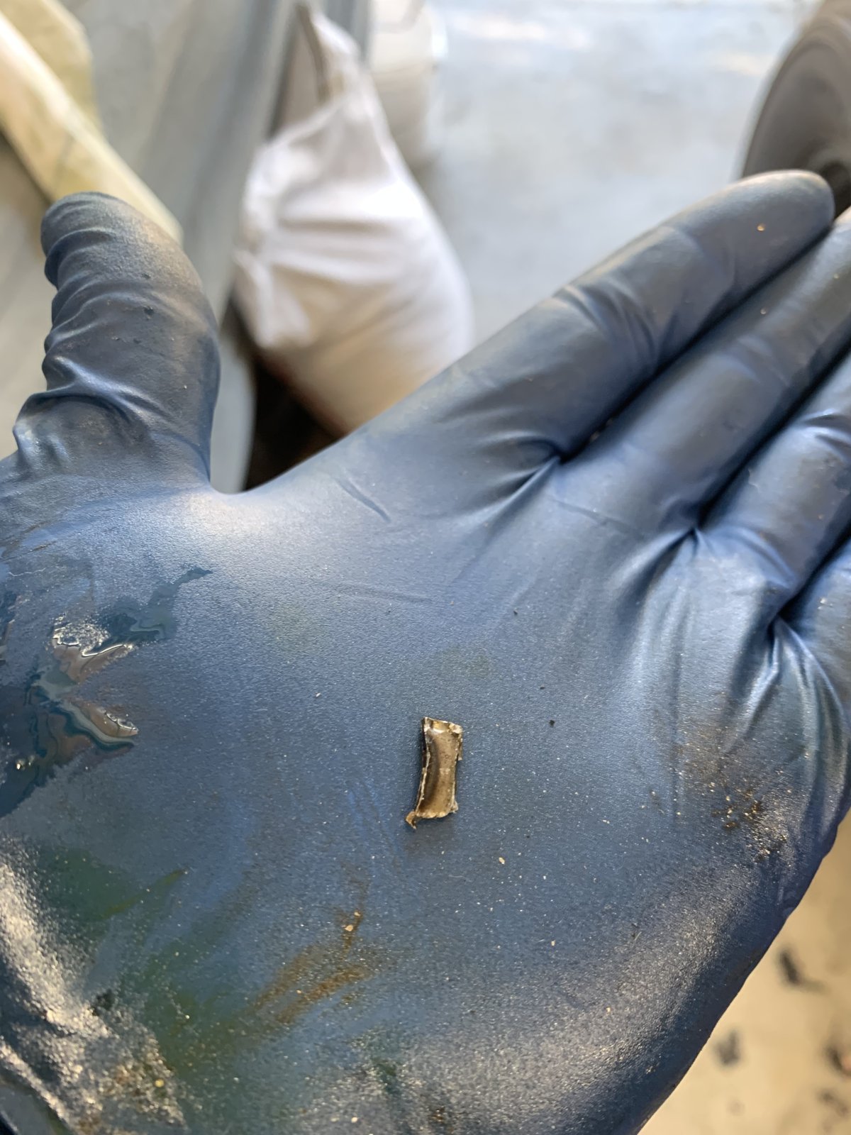

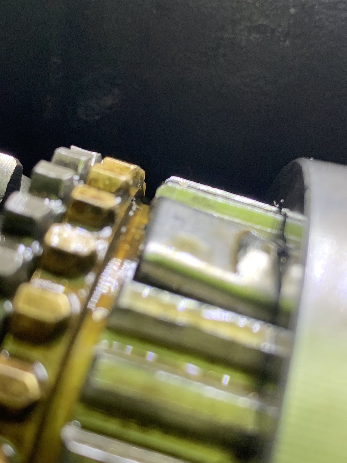

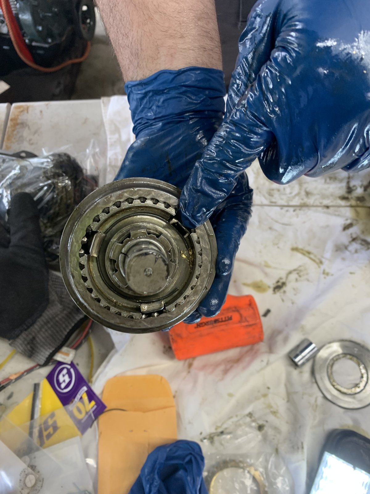

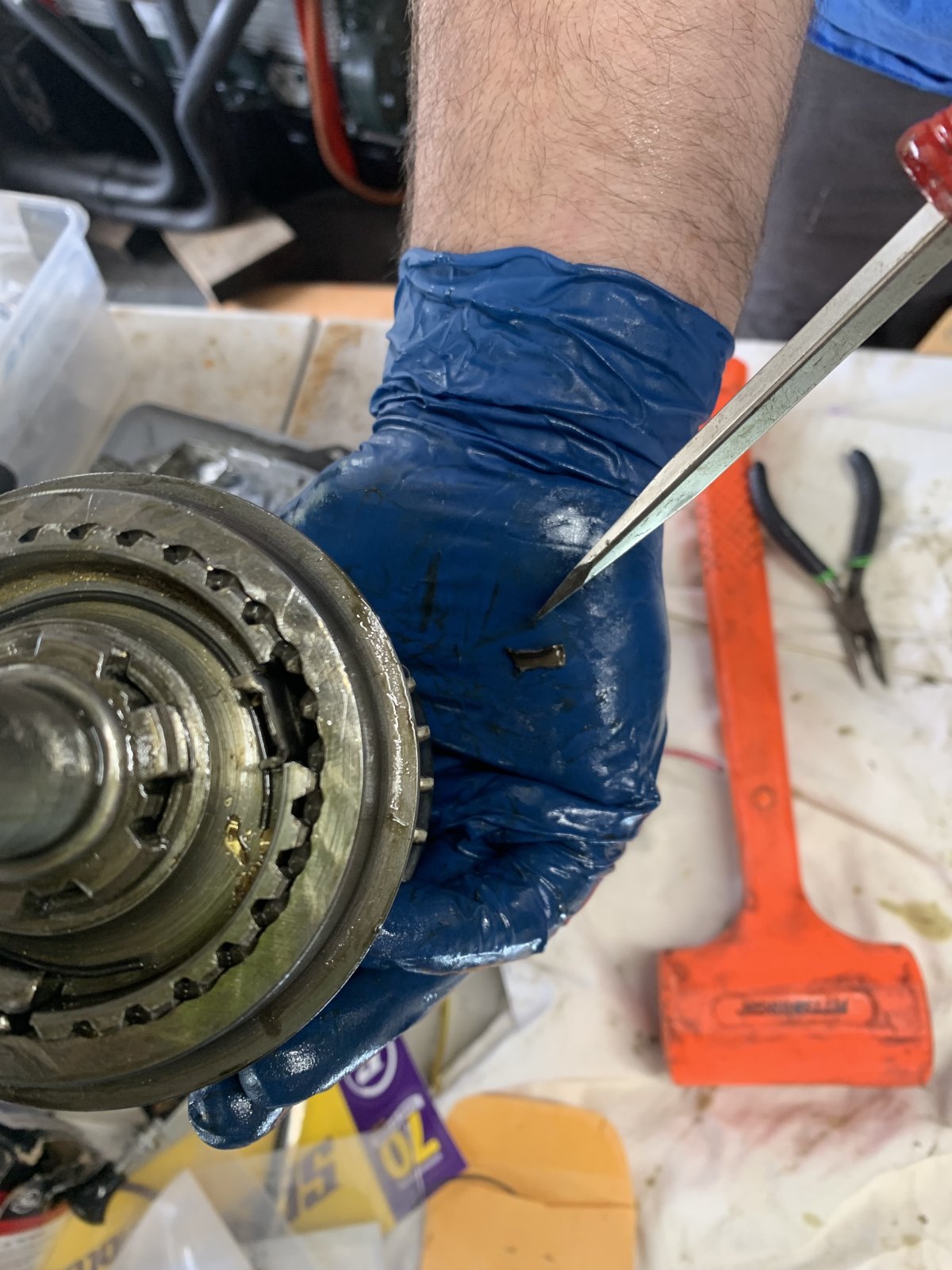

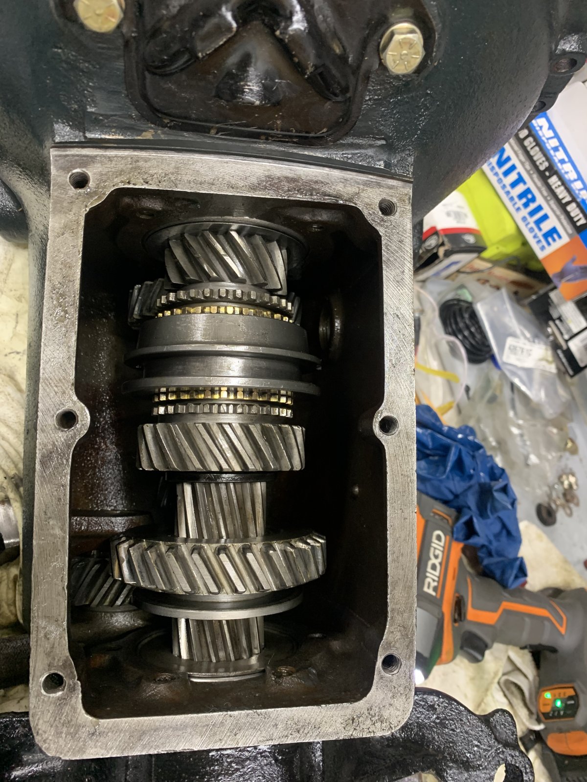

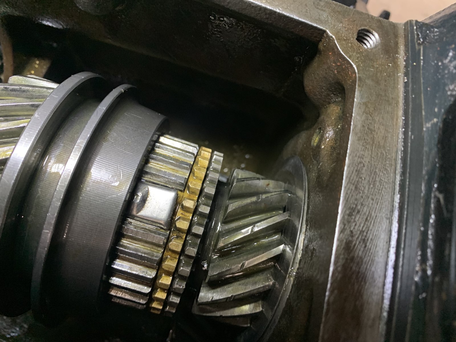

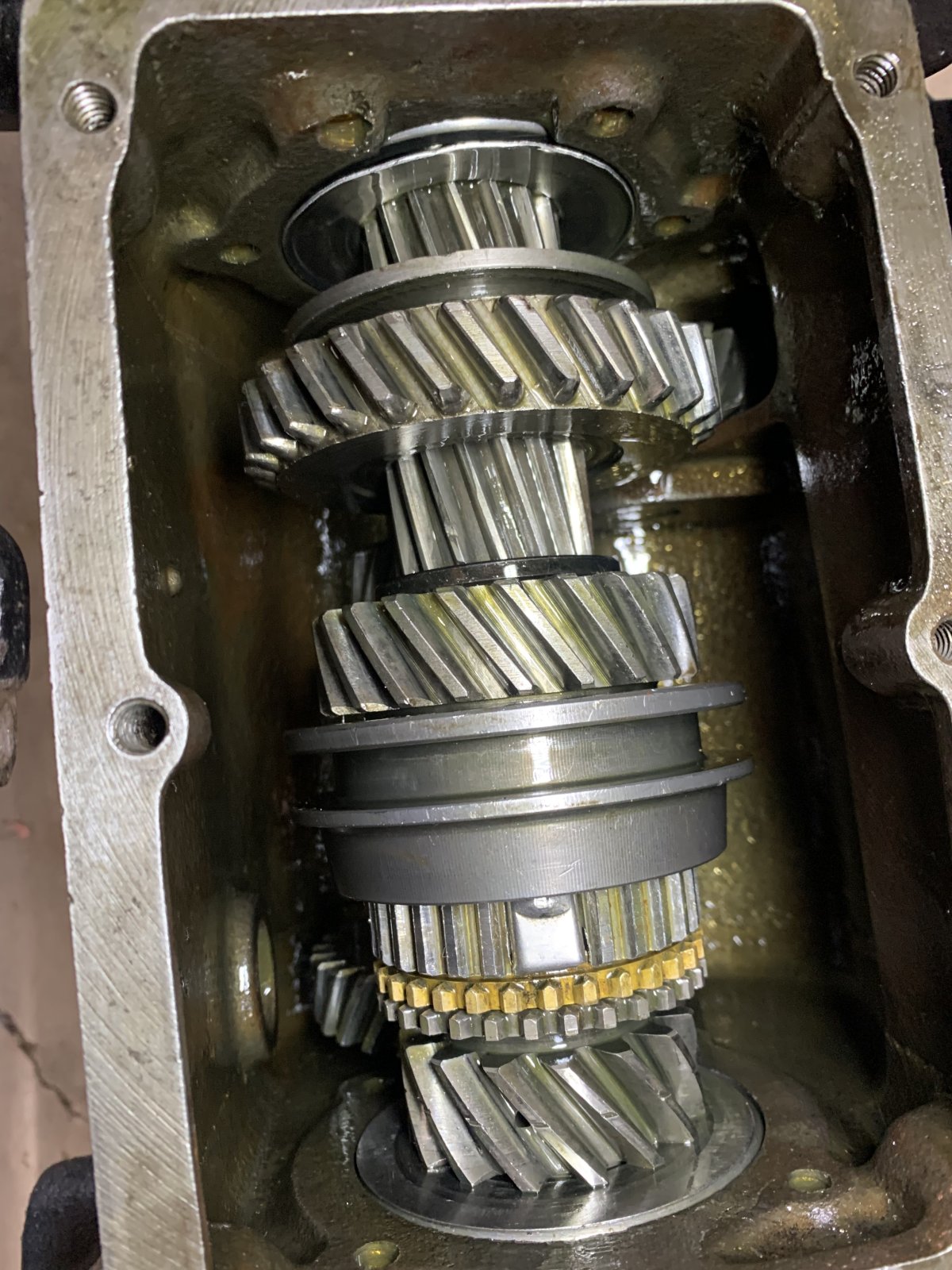

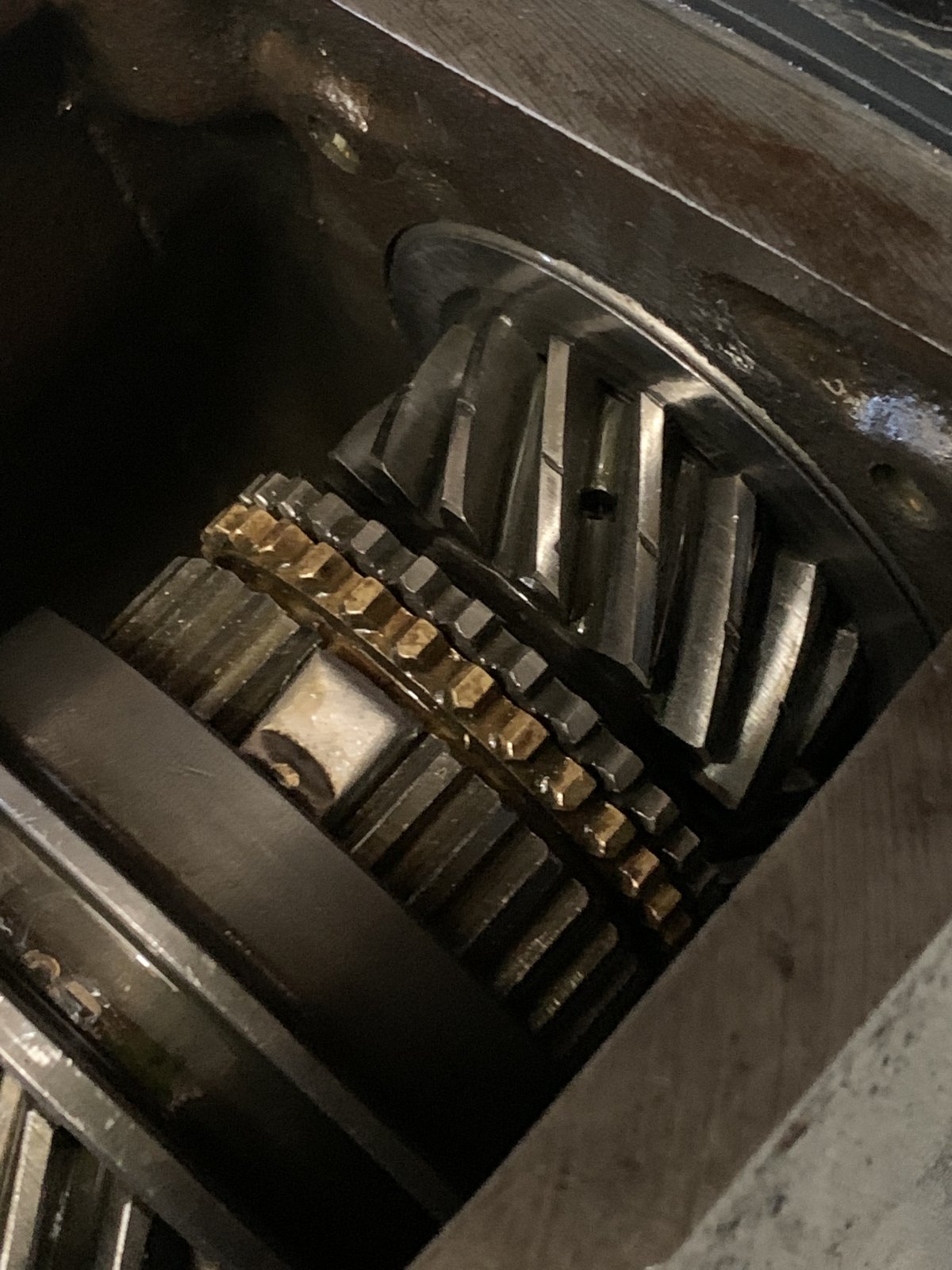

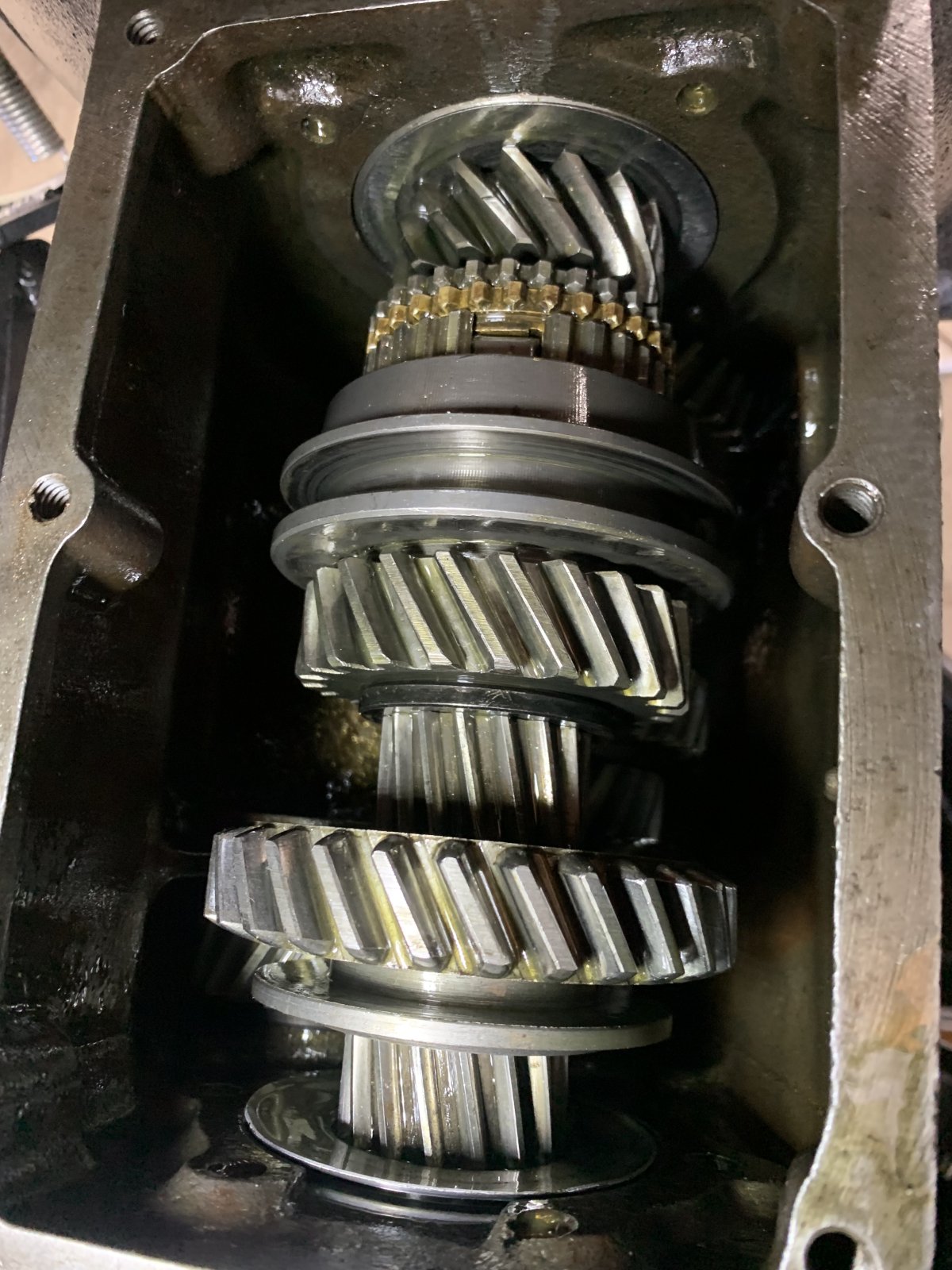

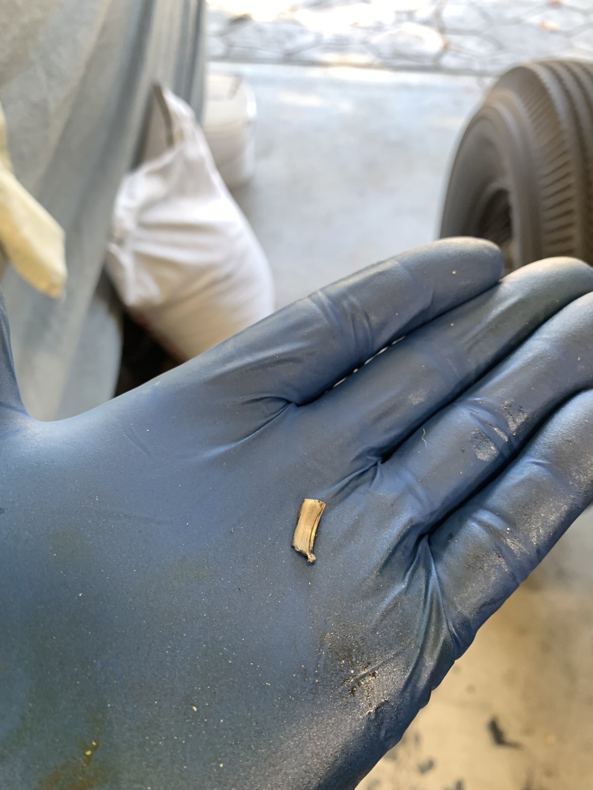

    I was driving the car to the DMV to finish my registration (after a few months Of blood sweat and tears) when the transmission got stuck in second gear.

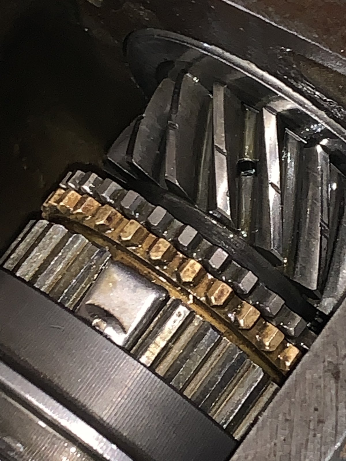

    I took the top plate off and found that one of the Synchro gears was riding upward and locked up shifting. I also discovered a small metal fragment that appears to have come from the backside of the synchro ***embly block.
    Did I rebuild the trans correctly, do any of the photos create red flags for you? does anyone know why or how my synchro block would ride upward, lock in place, and prevent the shifter ***embly from coming out of second gear? Please see the attached photos.
    Note: I do have and followed the vanpelt trans book.
    Thanks m***ively in advanced! Jay

  2. Johnny Nitro
    Joined: Sep 28, 2005
    Posts: 100
    Johnny Nitro
    from Chicago
    I had the exact same thing happen to me last year. After seeing this I’m chalking it up to poorly made aftermarket synchronizer blocks. ***uming those are reproductions…
    trad27 likes this.
  3. trad27
    Joined: Apr 22, 2009
    Posts: 1,224
    trad27
    Had the exact thing happen in my A when first together. It was the re pop synchro rings, I don’t remember exactly of the top of my head but in the VanPelt book walks you through. Had to file them down, has specs and everything. After the re rebuild has lasted several years and many miles no problem.

  5. Kevin Ardinger
    Joined: Aug 31, 2019
    Posts: 1,049
    Kevin Ardinger
    Looks to me like it may have too much clearance between the gears allowing the synchronizer ring to move too far.

  6. Mac VP
    Joined: May 13, 2014
    Posts: 512
    Mac VP

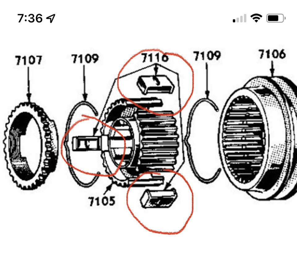

    I suspect the inner springs for the synchro are not installed at staggered locations, and/or the small bump out of the spring is not settled under an insert fully. By placing the bump out of each spring under a different insert (comparing front and rear springs) it keeps a consistent pressure on all three inserts. Once any single insert can pop up like shown in the photo, it prevents the synchro slider from shifter back to the center (neutral) position.
    I ***ume that this shifter housing has the correct original 91A-7230 shifter fork. This fork always has that part number cast into the front face of the fork.

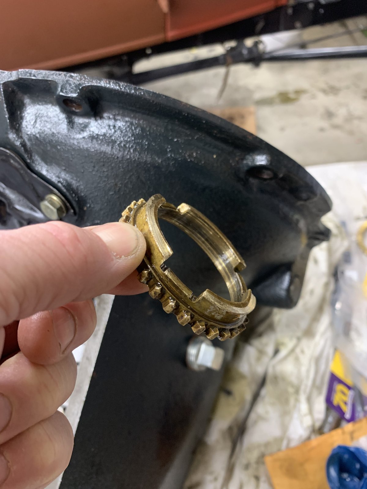

    Also, it appears that the br*** synchro rings are worn to the point where they practically touch the matching teeth on second gear and the main drive gear. This has nothing to do with the problem of being stuck in second gear. Just my observation. I’d replace the rings when tearing the transmission apart to fix the main problem. There were some aftermarket rings that have a poor fit (brand new out of the box). It’s hard to see if these particular rings are used or new.

  7. DreamerJ
    Joined: Oct 3, 2021
    Posts: 134
    DreamerJ
    Thanks everyone. Huge help and confirms my su****ions as well.
    - I bought new synchro blocks
    - will ensure the springs are staggered
    - I bought new synchro gears and will install them conparingthe spacing before and after.
    - will also check on that filing procedure as well, I don’t think my van pelt book contains that but I’ll find it.
    Have a wonderful day. J

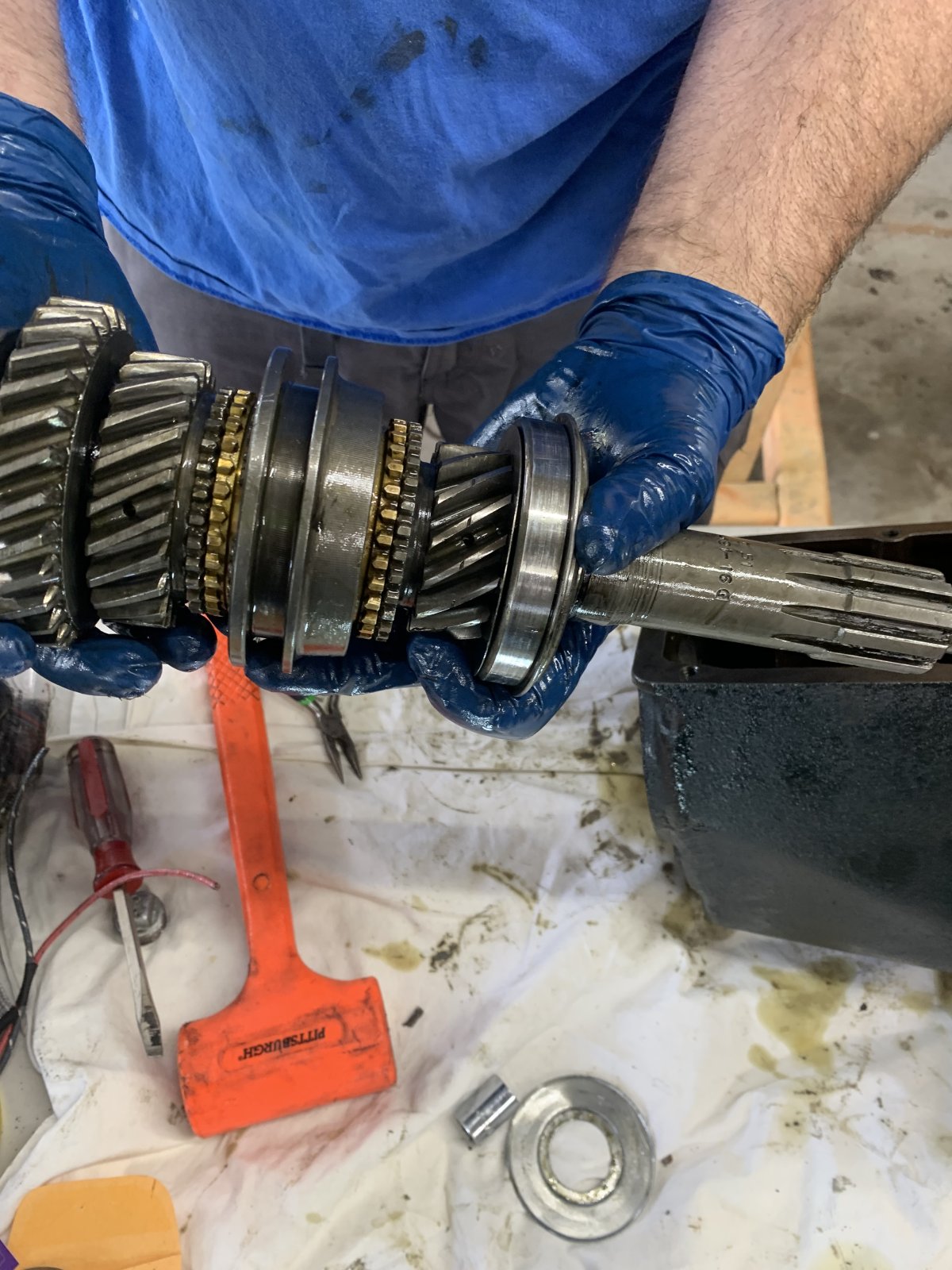

  10. DreamerJ
    Joined: Oct 3, 2021
    Posts: 134
    DreamerJ

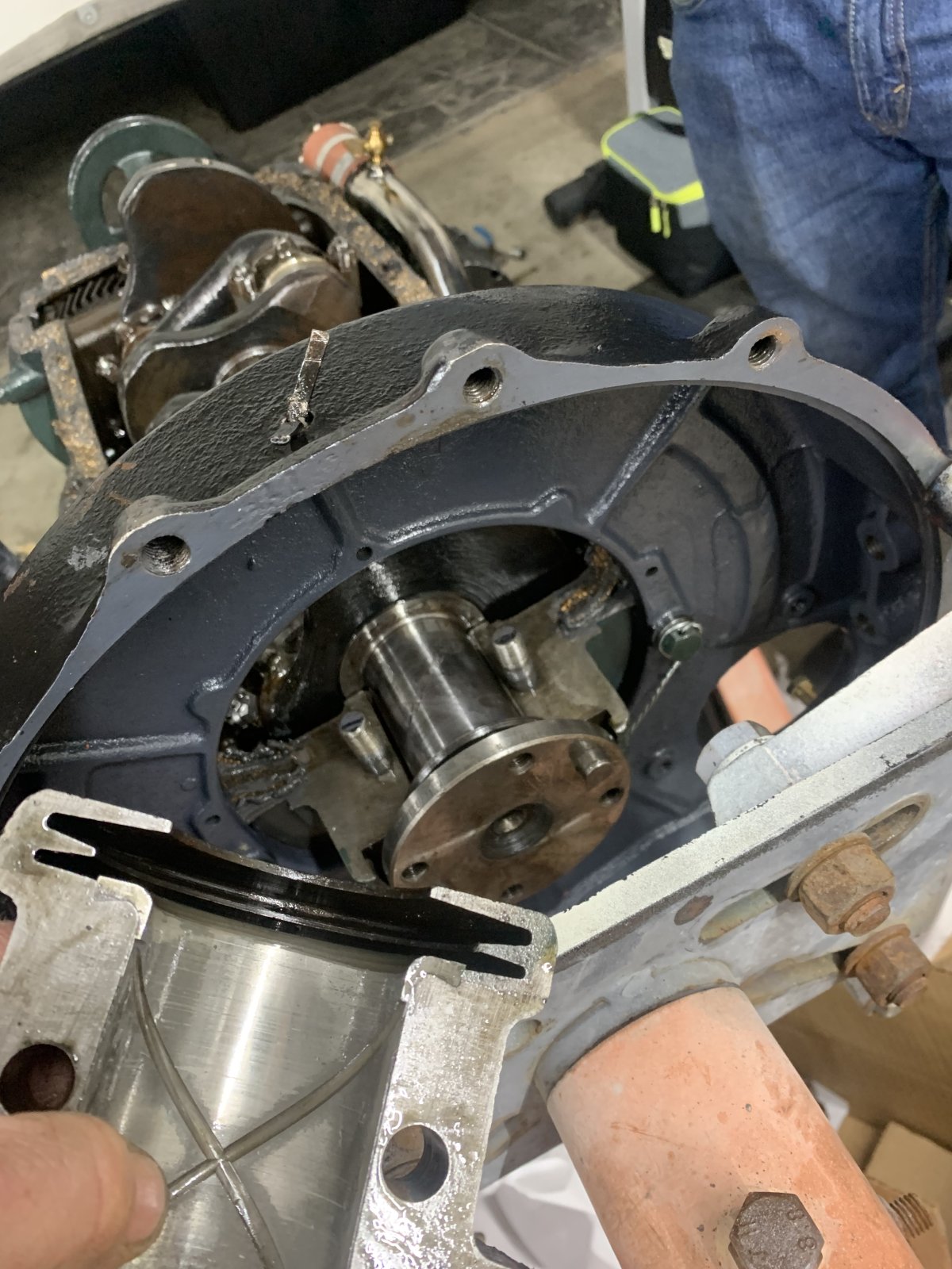

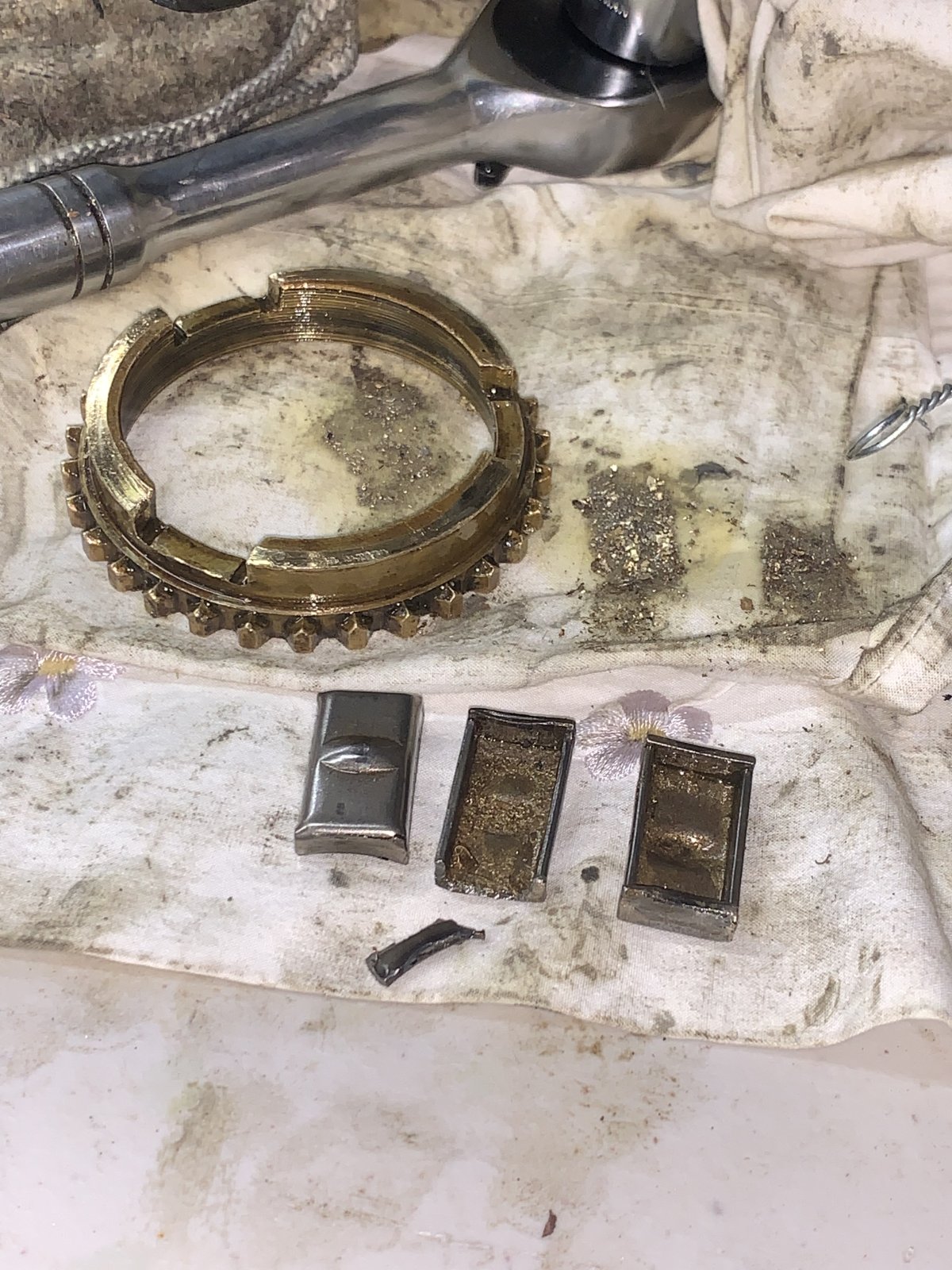

    C9FF44BA-3CE1-40E7-A8D0-0F7A916C962D.jpeg 19762067-D046-468A-9BD2-10E30109F518.jpeg D0DDBB89-0E7E-44C2-80FA-65857C78CB10.jpeg 90005302-51AE-49AA-B8C0-CBAB4B019AD2.jpeg 058AE1F6-B24E-445C-91EC-8EA4E4F05A49.jpeg D942A91A-493C-485D-8333-C6965B86A851.jpeg 99E368B5-6FED-4F8A-B050-6C049B64EF15.jpeg 46810231-3E2C-4959-969A-F000A3156EFE.jpeg A0AF304F-8903-479E-930A-99EC665ACB7F.jpeg 14251075-06D4-42A6-AB72-547F14155FC0.jpeg 526CE292-A12F-40B8-892C-8411A9EB3166.jpeg B9B48BDC-363D-4E9D-93C1-87F6255B1BD6.jpeg 7D187F64-458F-4831-8497-90A9DCBB99D6.jpeg 0B65A048-D153-4332-88DB-838338EB910A.jpeg D18EA6A4-63DE-4CC6-A392-C628FDFED02E.jpeg ABAA99BE-6A8D-475B-8DB4-9E8193F1035F.jpeg E564EAB4-E0EB-416B-A695-4CE16B7BA47D.jpeg F6E0C16D-531E-4F1F-977E-FAED6198CA92.jpeg F9E4BD38-90E1-4C03-BA67-0F6B69E86543.jpeg Ok, so here’s the download on the ****** tear down today. For the record, these things are easy to work on, just go slow and take cell phone photos of the order of things.

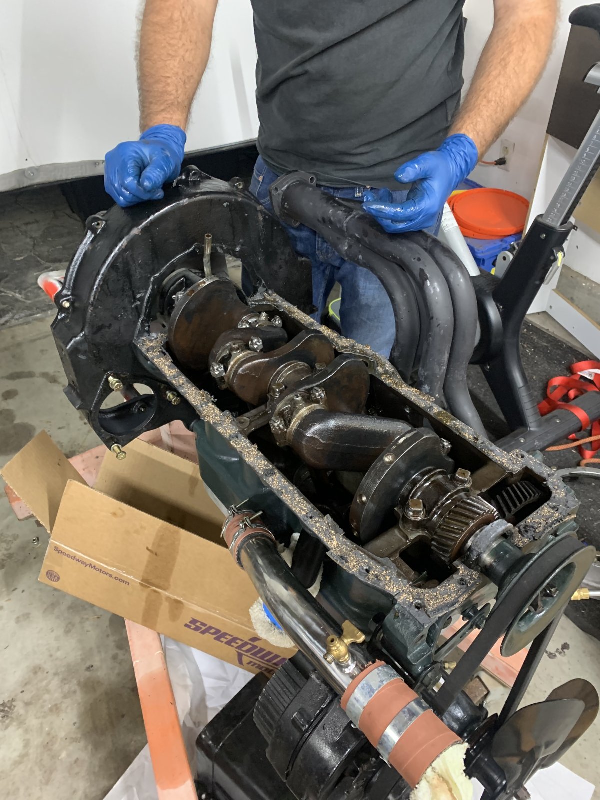

    Side note: I was wondering if I had a rear main oil leak because after replacing the oil pan gasket, it still puked oil… that’s why I pulled the engine and trans together. More on that later.
    Forensics:

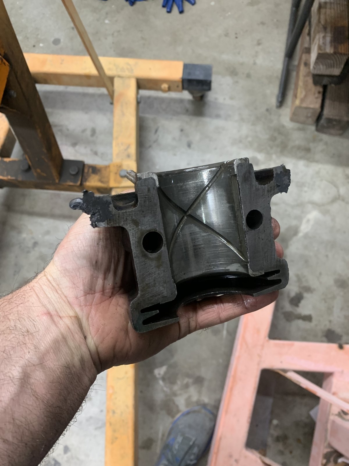

    - the synchro was installed correctly but one of the blocks failed within the ***embly and broke. There is no explanation for the block to fail in the ***embly but it did!!! See photo.

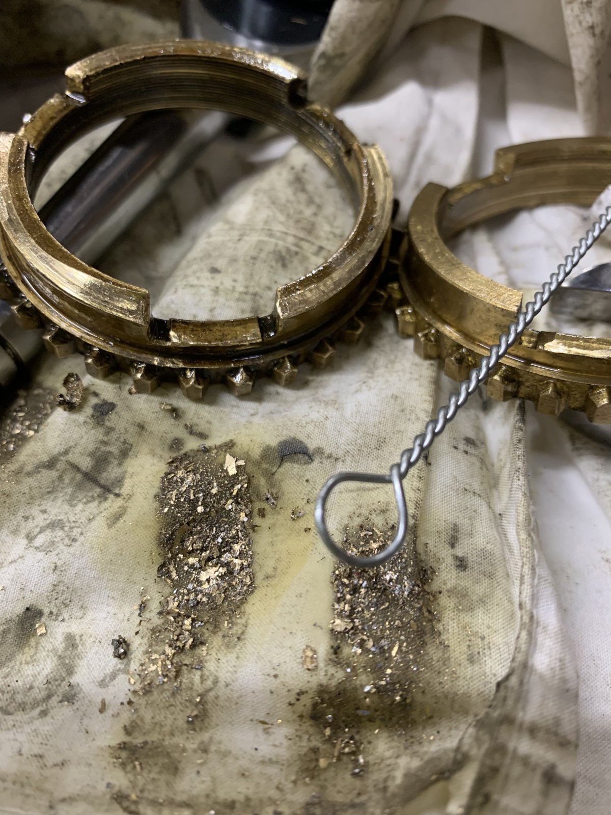

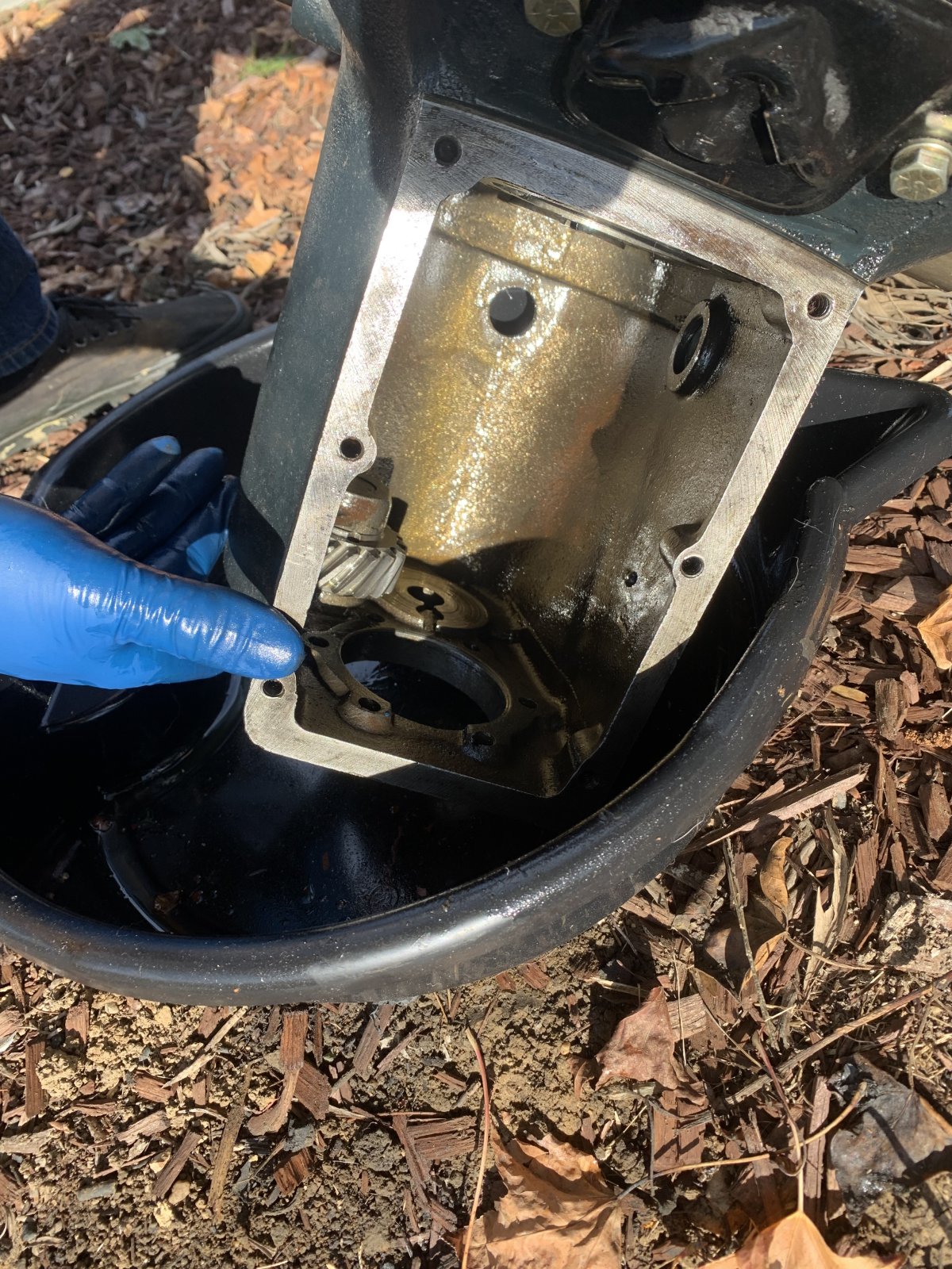

    - the rotation of the synchro gear against the broken synchro “block” caused substantial wear on the Synchro gear and literally turned my trans fluid into what looked like one of my 3 daughters’ experiments with syrup and gold glitter. Or, maybe a 49er’s gold pan. In other words, the entire case and trans was speckled with gold (br***) flakes. NUTS. See photos.
    Thankfully, I had already purchased and installed the new synchros and “blocks” with retaining rings from CW Moss. Thanks Mac VP on that tip!! They are close to me and deliver crazy quick via usps.
    gutted the trans entirely, cleaned it ****k and span to remove the br*** flake and rebuilt the trans (again).
    now about that rear main…..

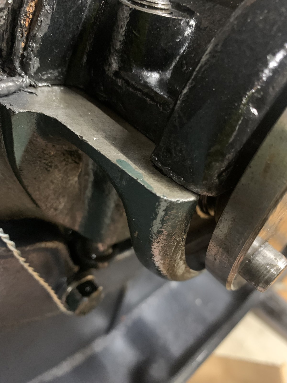

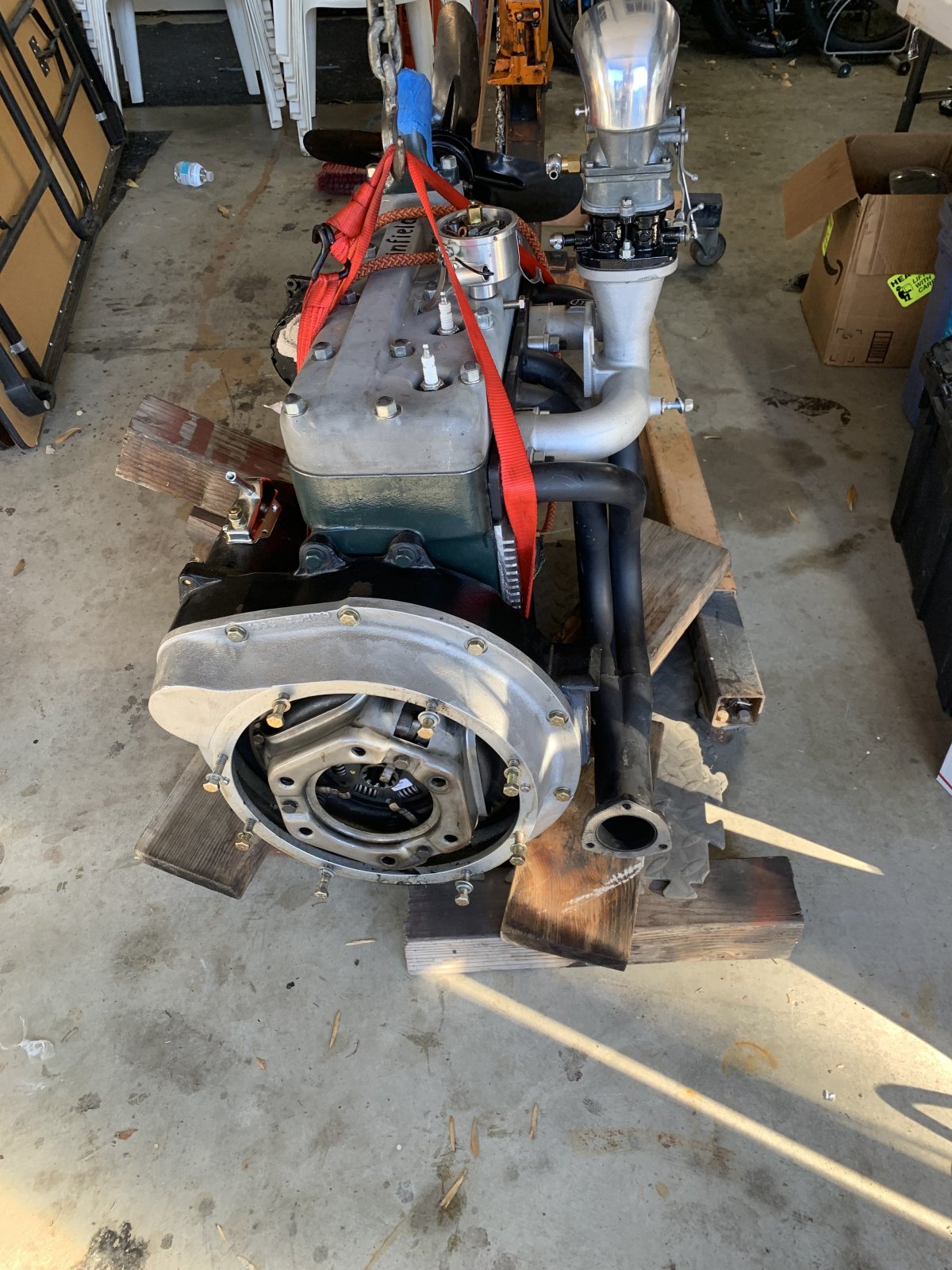

    the previous owner must have forgotten to put a rear main seal in the engine or maybe aliens abducted the rear main seal. Regardless, It was NOT there!
    After many laughs this afternoon with my buddy who was helping me, we made a model a grocery list and I went shopping tonight.
    next, I’ll need to pull the crank, timing cover, etc to gain access to replace the front seal (why not? I’m in this far) and to put the rear main seal where it belongs. Or maybe the aliens will return it tonight. Hahaha.
    It was super fun working with a friend today, i learned a ton, and look forward to diving in further!

    Hey man, no shame in that. It initially confused me too when I tore my engine down. There is no rear main seal on a stock A. Just an oil slinger. There is a drain tube connected to the rear main cap that is designed to return any escaping oil to the pan. If that tube plugs up, you'll get an external oil leak.

    Same on a B. There are modern seal kits offered for the B; they require minor machine work. Lot's of info on this on Ford Barn (Google "Model B rear main seal ford barn"). Also covered in Brierley's "Four Bangers and Me"

    Hi All, I spoke with Mr Van Pelt this week about my trans and his wonderful “ins and out of early ford transmissions book” that I used while rebuilding my trans. Had a Q about the install of the internal synchro hub. We agree and possibly inferred that my synchronizer ***embly block breakage may be attributed to a combo of bad luck, low quality steel reproduction parts, and/or the fact that my two synchro clips may not have been staggered in different positions. Mr Van Pelt mentioned that if the synchro clips are not staggered that they can create uneven pressure/spring tension behind the blocks and (I ***ume) lead to one edge of the block to “ride higher” than it is supposed to, making it susceptible to breaking. He offered some other advice on what to check for while fitting the new br*** synchros on the internal hub ***embly.
    I learned a ton from my 10mins on the phone with him and from this great community. Thank you ALL, I’m feeling pretty good about my rebuild….again :)

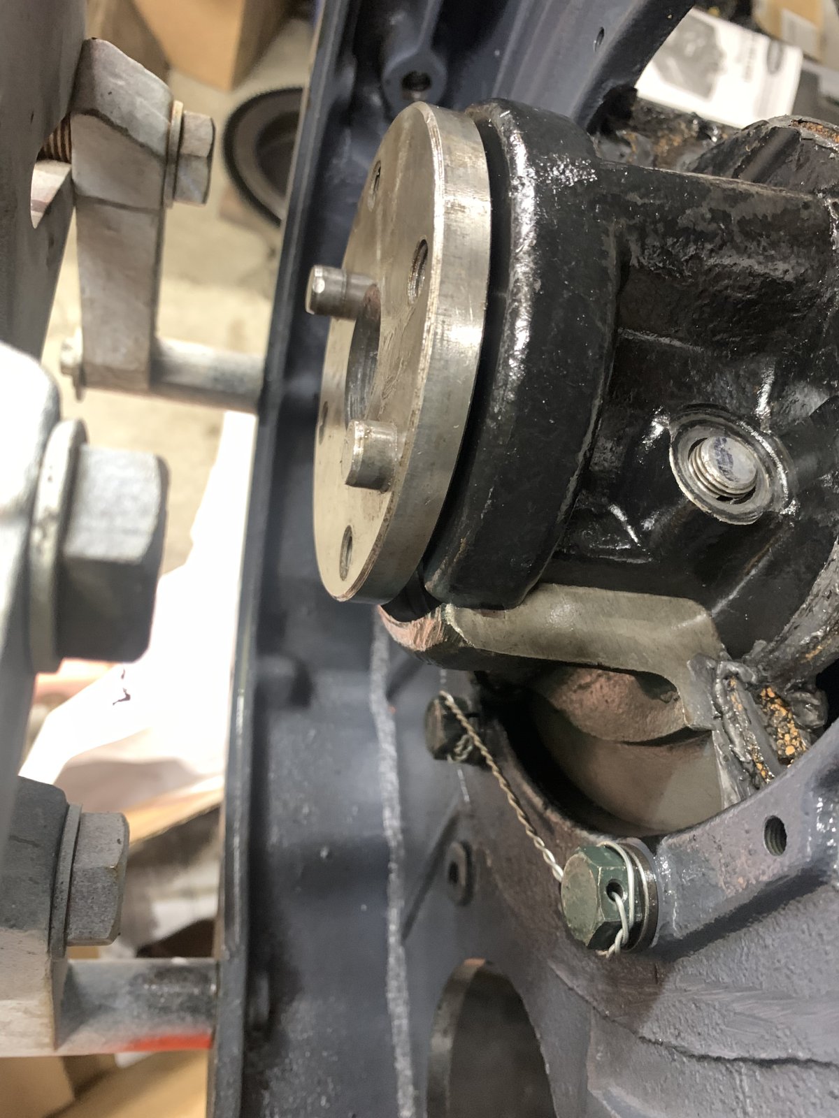

    64B201E6-6BEB-48C9-9372-677597D0667D.jpeg Oh and about that rear main seal…. I’m so dumb as a newbie to this model a that tonight I just realized that I’m missing the rear block insert in my engine, not just the (optional) rear main seal. I’m so clueless on the inside of this engine that I failed to see this…. Dam I feel dumb. Even with all my “how to…” manuals
