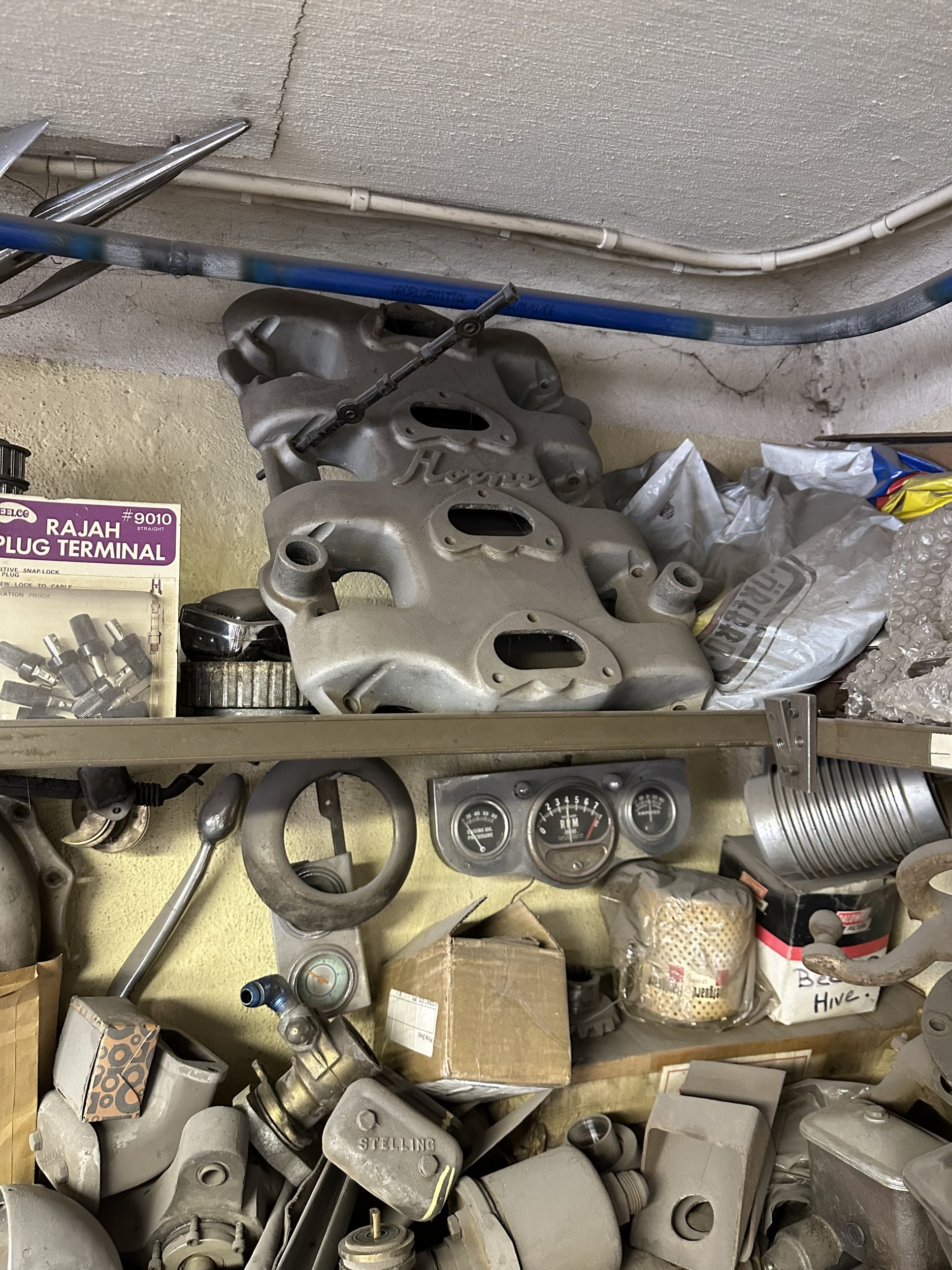

    Tomorrow I will be look at some early Hemi parts.
    I has no plans just now more than its cool to own a 392.
    There are complete engines and parts both 331, 354, 392 for sale.
    I did ask if there was a dual carb intake - but no.

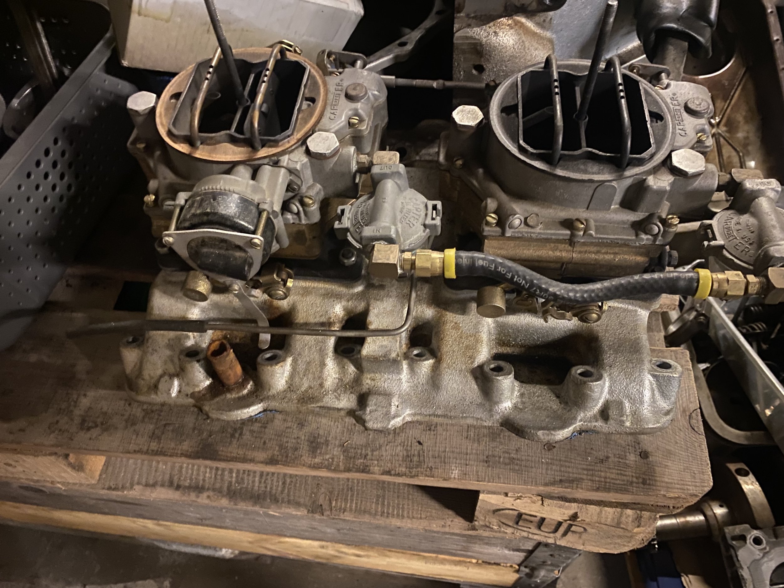

    I did visit a friend in the engine business and he had a Chry 300 in for restore.
    It’s a 58 but a 354 with a uniq 392 dual carb intake ( not the same as the 392 as the 392 had taller deckheight )

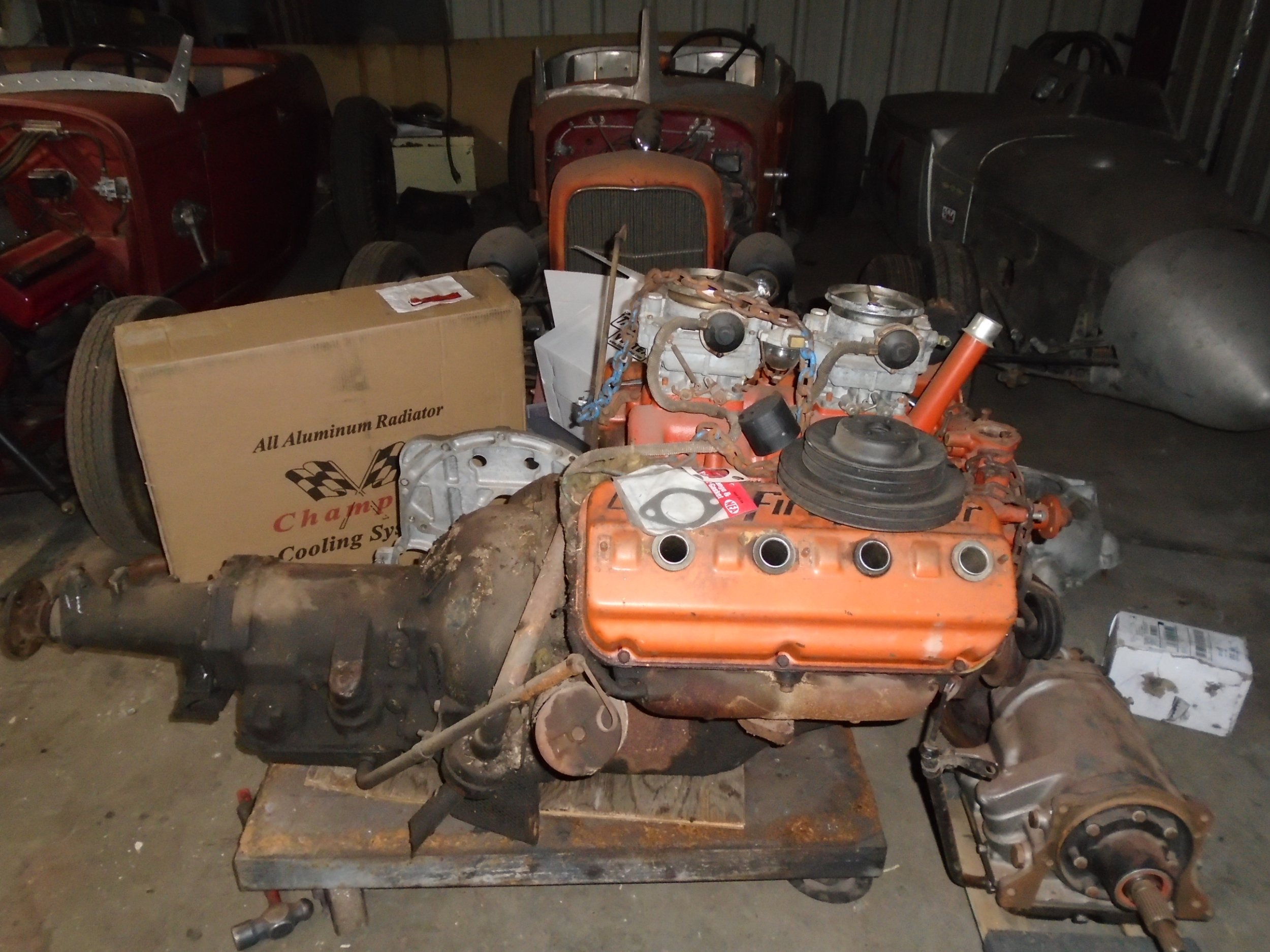

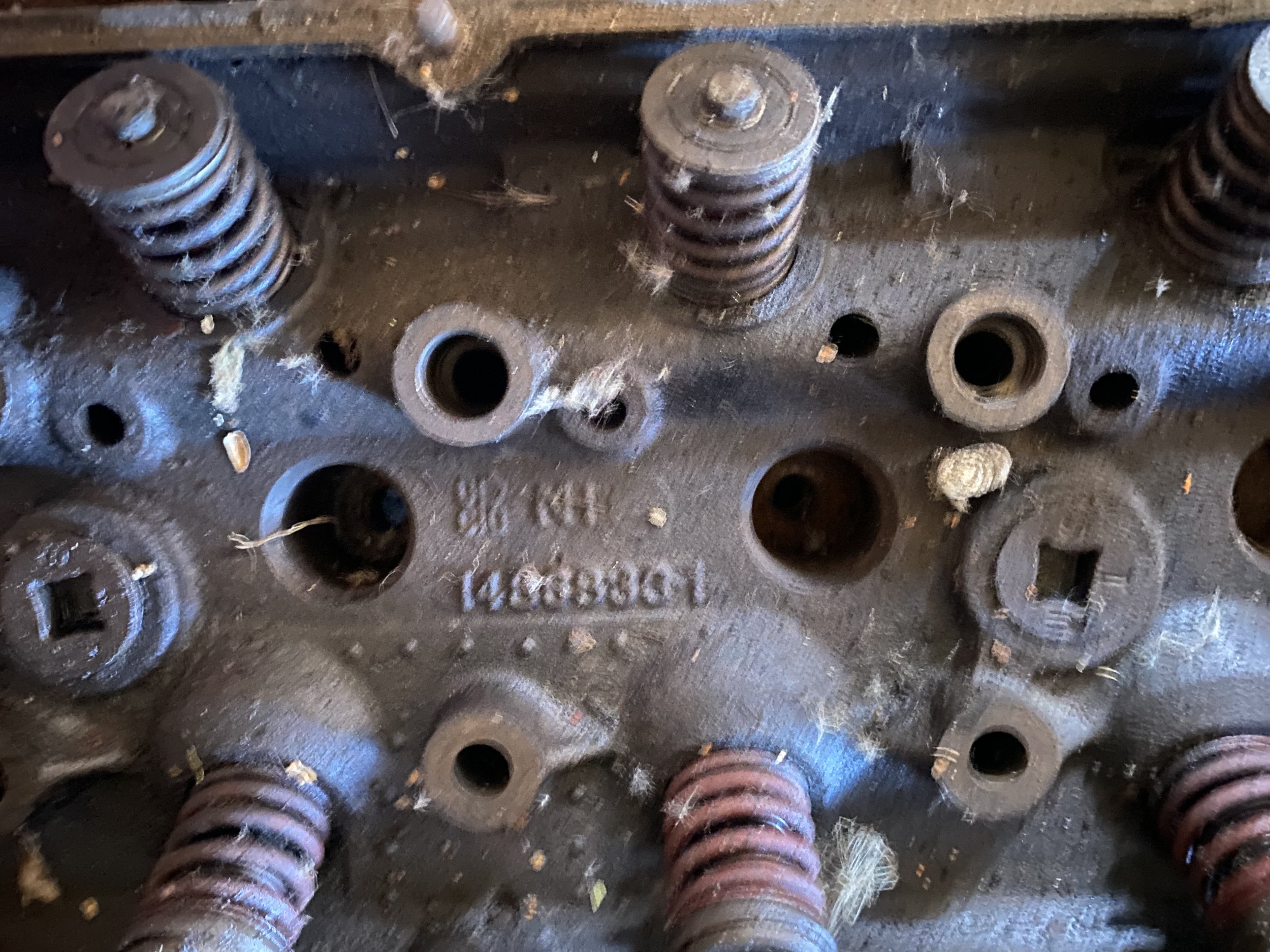

    I can’t find head part numbers on internet, this pair I saw out of ’many’…

    I am pretty sure casting numbers are in the TECH somewhere.

    Is that 1486833? If so it's a solid front head for the '54 331, should have oval ex ports. Would need a wet intake. I ran the BBC pump on a '55 331 in a '48 Plymouth. I currently run an OEM 4 leg W/P on the '55 331 in my '60 Plymouth (see avatar). 392 rebuildable core used to be 2,500, may be higher now. 354 probably in the 1,500+ range and '55 331 and '54 4 bl short tail 331 around 1,200+ probably higher these days. 392 has higher initial price but lower parts prices & better availability vs the others. The 51-3 long tails are the least desirable. Probably will need overbore. cast pistons are in decent C/R range for 392/354, 8.5 for 331. Forged in higher are available for usually about twice as much. figure on turning the crank with new rod & main bearings. New Melling 392 oil pumps available.

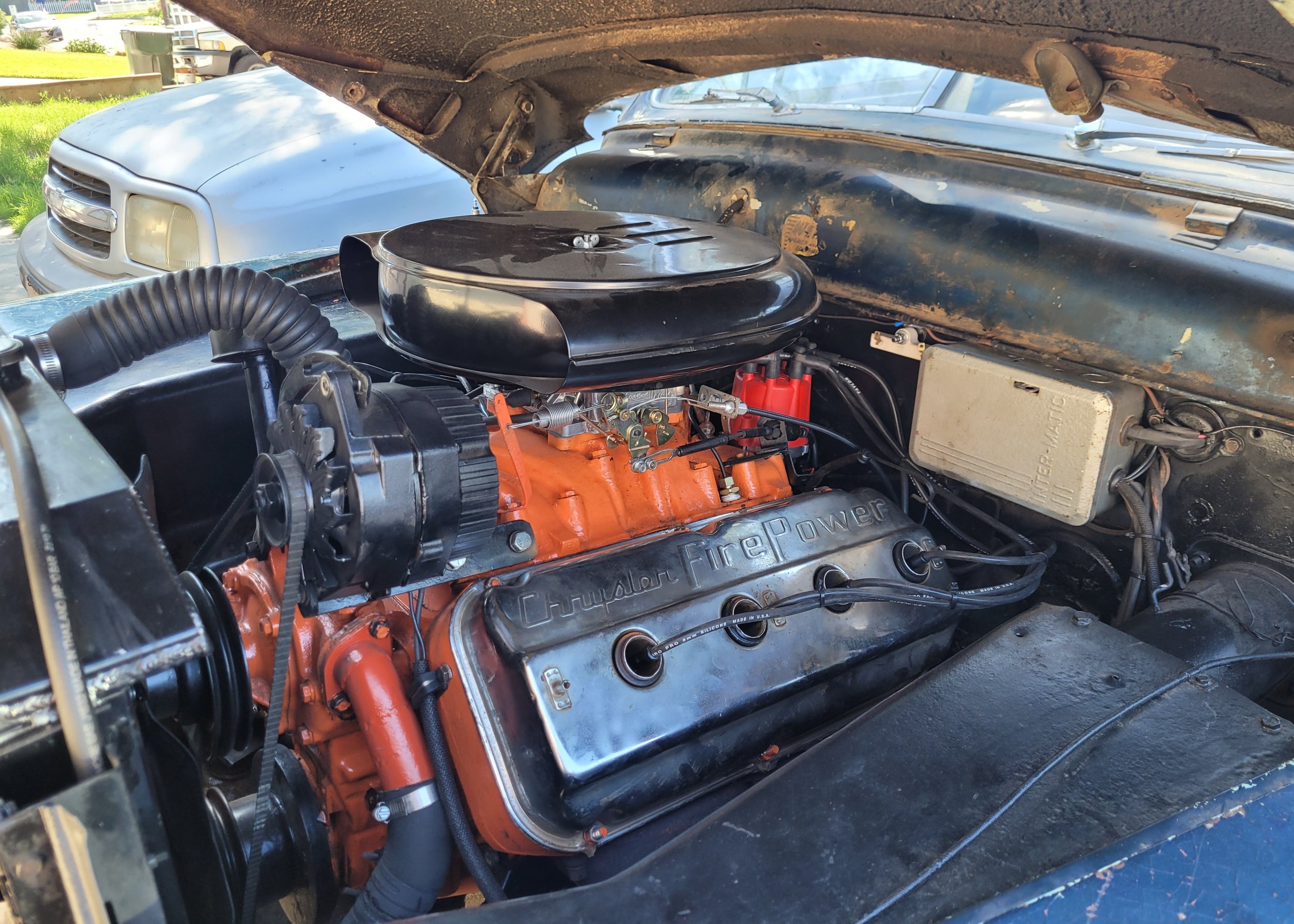

    51 mercules, The hemi you has in the Mercury I do not see the water pump going from head-to-head, so what model is it, I guess a 331, and did they always had a cast-in bell ?
    I was just look at a complete Ca used 354 ( storage here for 25 years ) and did notice the waterpump is at a one piece, as the 392 has a 2 piece waterpump.
    The distance from front block to end of the std pump did 'feel' shorter than on the 392.

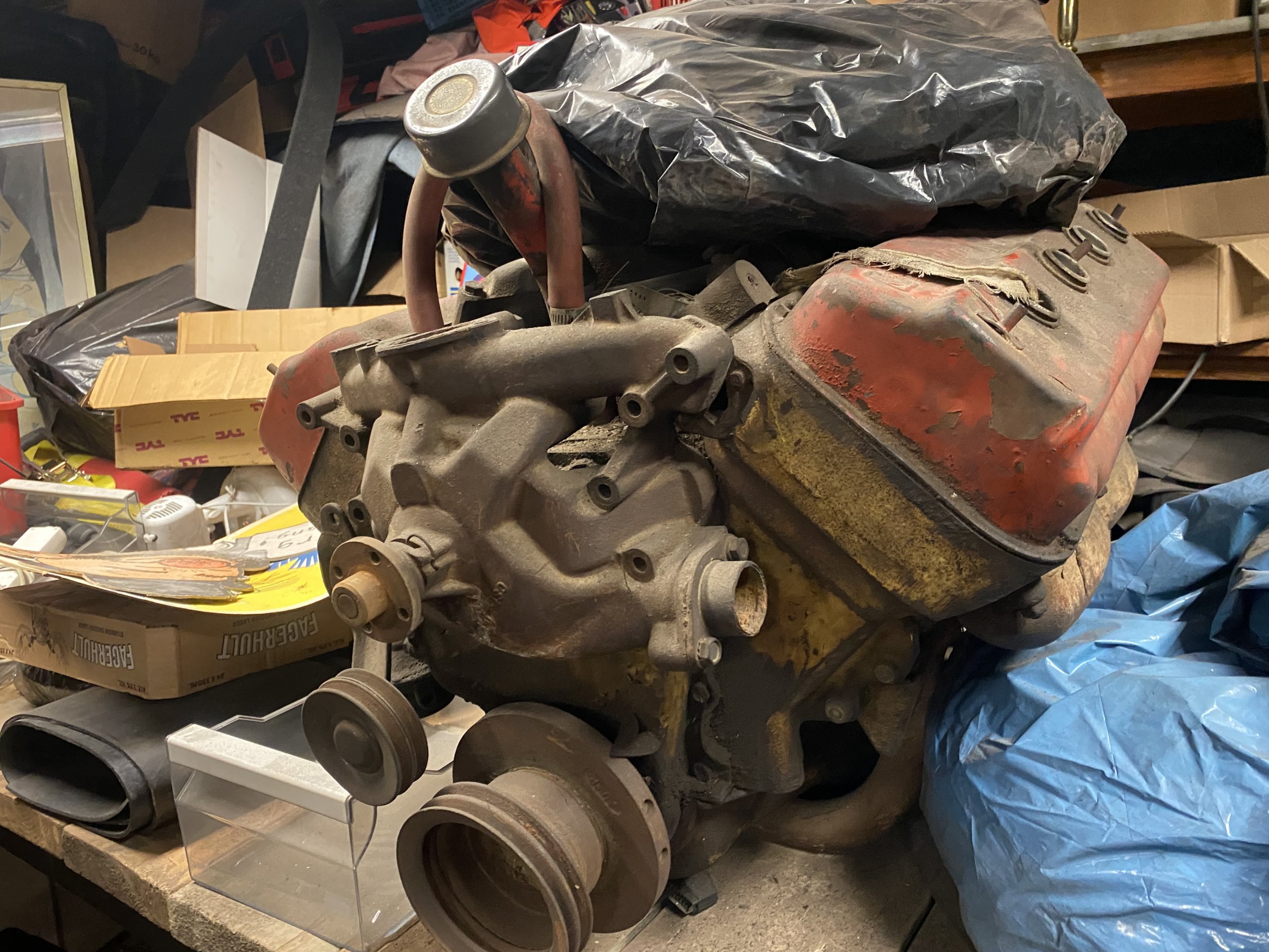

    Here is the 354 I saw today.
    A buddy has this cool intake.
