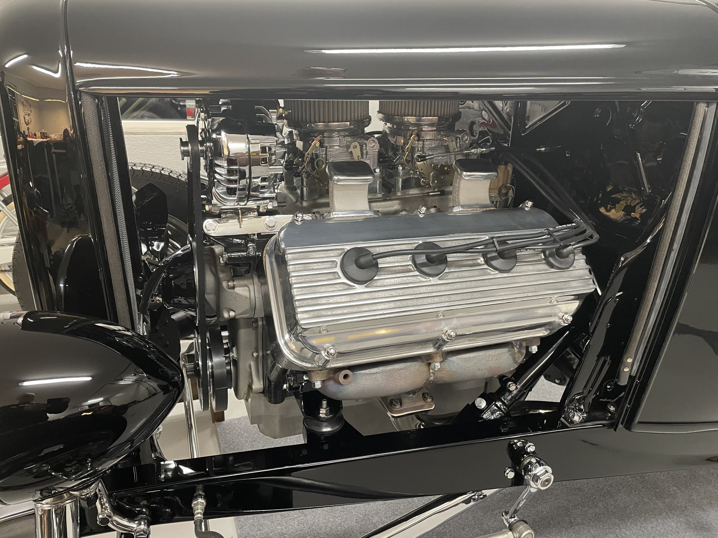

    Look at this 32 3W with std valve covers, this is a Swedes car in California, but what engine is it, I don’t see the rib of the front of the head so maybe a 354, but its the 392 crossover.
    I don’t know him ( cant ask ) but he got it there use the std pump/fan.
    Se picture of the rib on head ( only 392 )

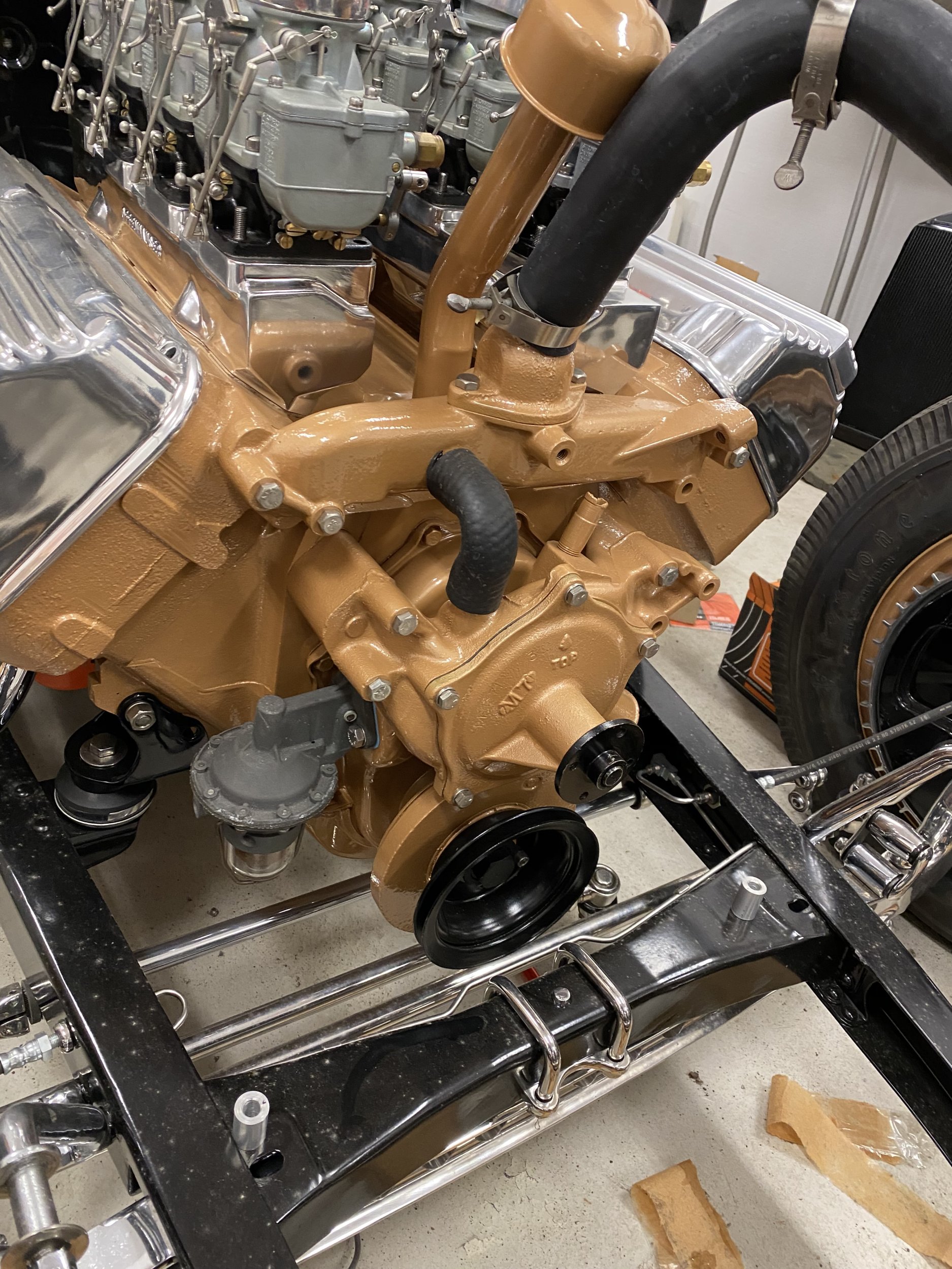

    The ribbed valve cover 392 is in a 32 roadster and my buddy and he told me the firewall is little modify and was using the Chevy BB pump and a fan ( still tight )

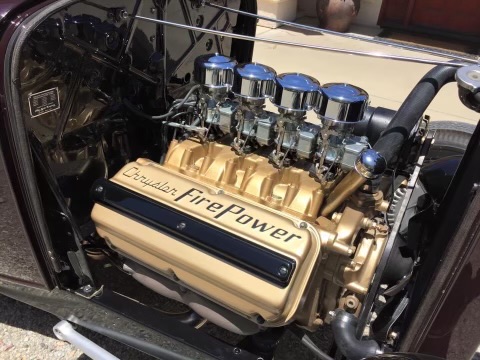

    The next one is also a buddy in 32 roadster and a 392 and he did not modify the firewall and use the std pump, but he cant install the radiator !
    -So my question is, how was it done on the 3W with the std valve covers ?
    Either way a 392 or a 354 he did use the std pump.
    Maybe engine was moved back but I cant see that on firewall.

    The main thing I noted today is headers is possible in a 32 Ford frame but as starter is on the driverside it will conflict with the steering box.
    So a question is, how is the swith to the pssanger side done ?
    Then I really wonder, the red 32 3W I showed above, I'll just note the lower water end is at left side but a 392 is to the right side, so what engine is this ?
    A 'mystory' waterpump..

    -But what engine has the red 32 3W I showed as I cant figure out from any pictures what engine or pumps it has.
  9. George
    Joined: Jan 1, 2005
    Posts: 8,164
    George
    If talking about the one with the 4X2 intake it looks odd, maybe the photo is flopped? Haven't used the OEM 392 W/P. The 331/354 pump bolts together from the back, don't know on 392. The truck/Ind 331/354 ones bolt into the timing cover but that doesn't look right for that either. Lower radiator hose is usually on drivers side. On the 354 with sonic check you can go up to .125 over, 4" standard 392 pistons. Wear will determine. My 1st 331 had to go .030, the current 331 is .060.
