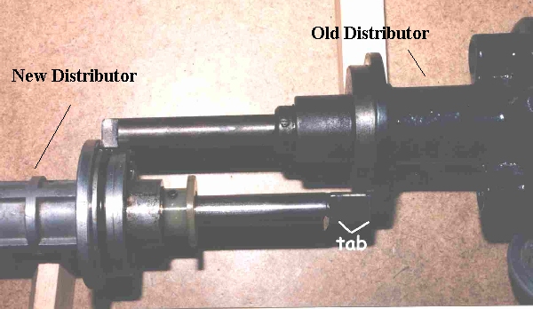

    Don't need to do it for old hemi distributors. All you have to do is weld a 3/8" extension on the bottom for 354s and 331s and a 5/8" extension on a 392 and an electronic small block 318/340/360 distributor will drop right in.
    Here is the converted distributor shown next to an old 331 points distributor.
    There are conversion kits you can buy for stock distributor (Ignitor, Pertronix, etc.)and at least one guy who sells adaptor sleeves that require sawing off the end of the donor shaft and pinning the one on. I am a (CHEAP!) DIY type who always goes with the junkyard option first. Why buy belly****on billet part when you can make a greasy old cast iron one work like new?
