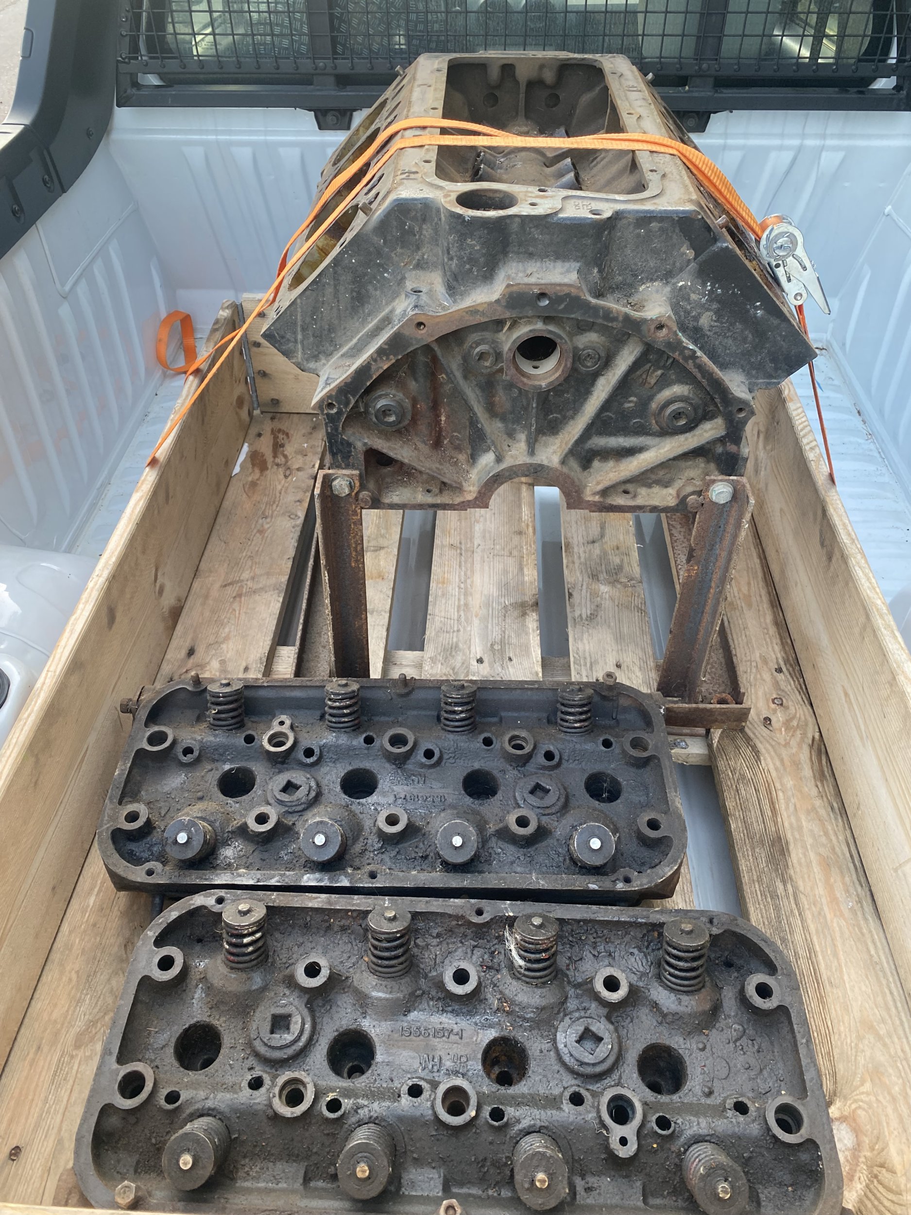

  14. 3w Hank
    Joined: Jan 29, 2022
    Posts: 1,099
    3w Hank
    On my way home to hot tank, got the trippel nickel 555 heads.
    51 mercules likes this.

  17. 3w Hank
    Posts: 1,099
    3w Hank
    Note the A1 castings, I read that was the better ones ( or )
