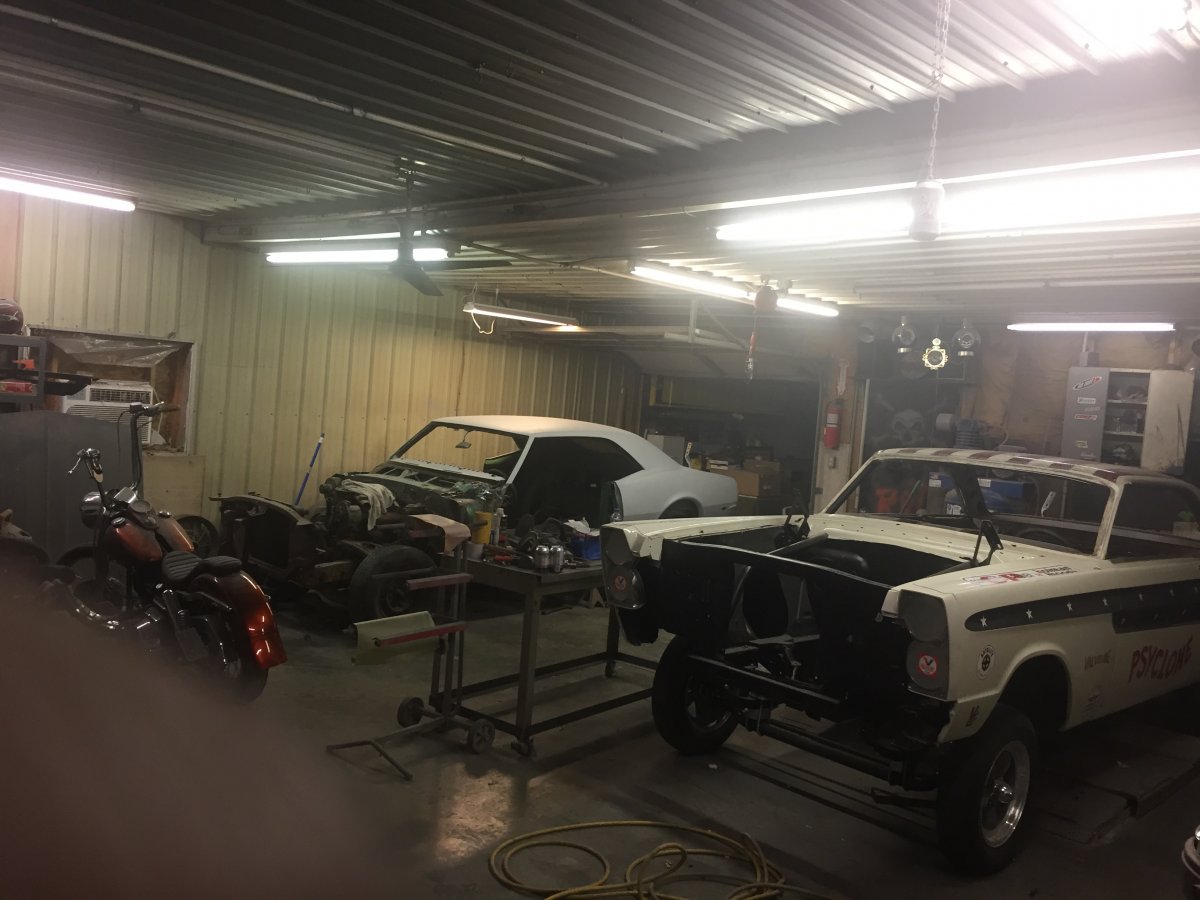

    Ok. Getting my tig welder set up. Gonna build some drain pipes ... as soon as I can get hotdogs pos comet outta my shop. Space is at a premium IMG_0870.JPG

    Actually hotdogs car isn't a pos. I just tell him that cause it's turning out better than mine

    That your Glide off to the side there?

    Yeah. One of em. It's a *****in bike. Built it as a tribute to one of my bros that p***ed

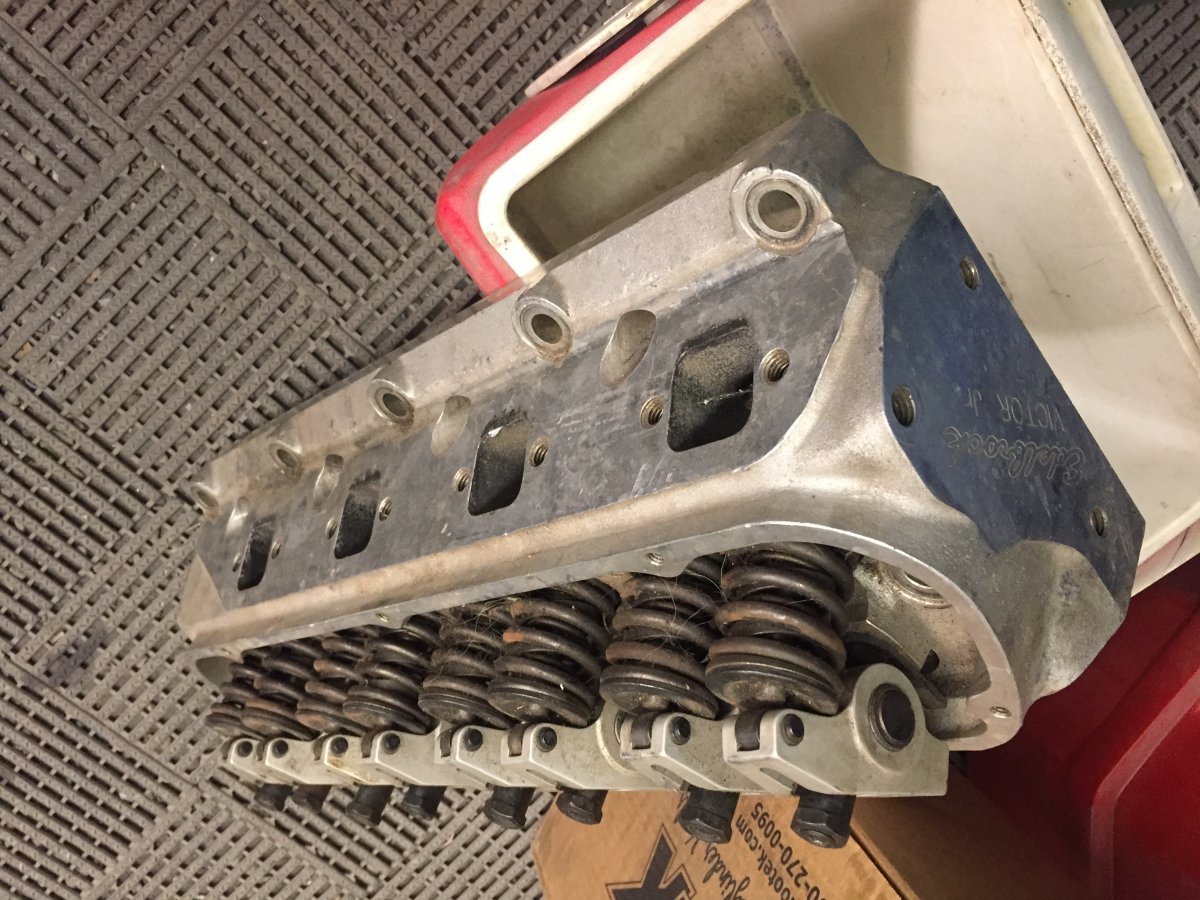

    IMG_0937.JPG Score!!!

    Are those heads stock?Do they have any porting or larger intake valves?
    They work great in stock form,but if they need any work (valve job,etc) that might be a great time to throw some porting work and some 2.08" intake valves at em.
    That 2.08" intake really wakes em up.:)
    Heck,even with those heads bone stock,you should be creeping up on 500hp with that cam.
    A ported version of those is essentially what I'm running on my motor.
    You've got me by 25ci,so you're gonna make a bunch more torque than me,and my little motor was able to make over 600hp with a tweaked set of what are essentially those same heads,so the car you guys are putting together should be a strong runner with a stroked Windsor in it.

    Actually these are for my falcon and I believe they are stock. . The car were building is a 357" Windsor.

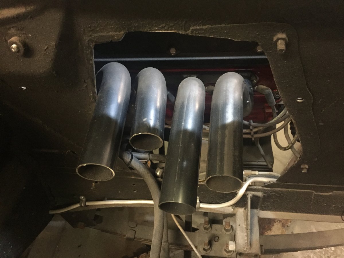

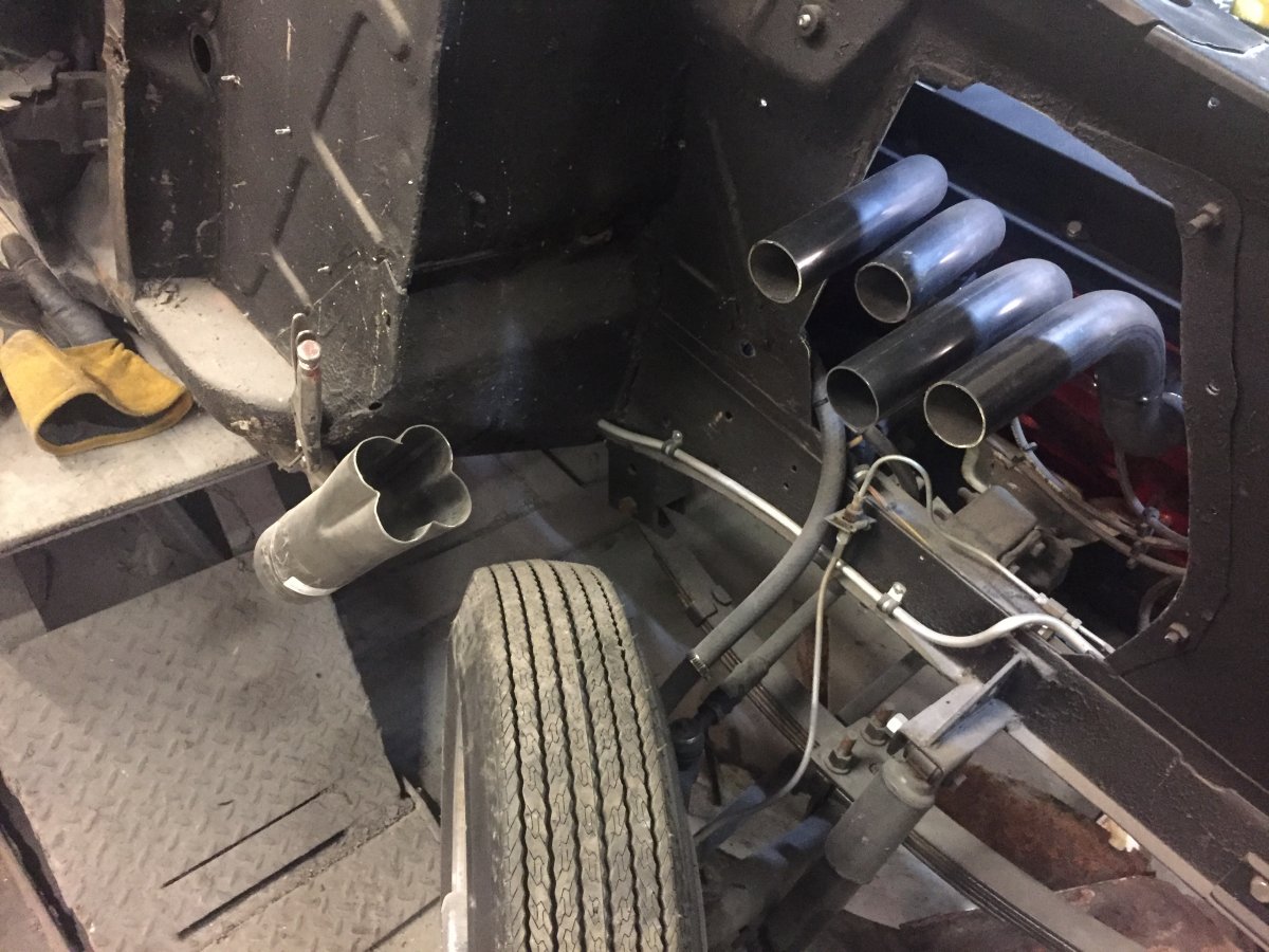

    IMG_1032.JPG IMG_1033.JPG IMG_1034.JPG Well I'll just keep adding to this thread. To update , I did get a quick fuel brawler 950 carb. I did get victor jr heads but I'm not gonna put them on till some other things are ironed out. Also scored a victor intake. Now I'm starting on the headers. Which seems like it's gonna take some time.
    Wish it was a 4 banger. Damn
