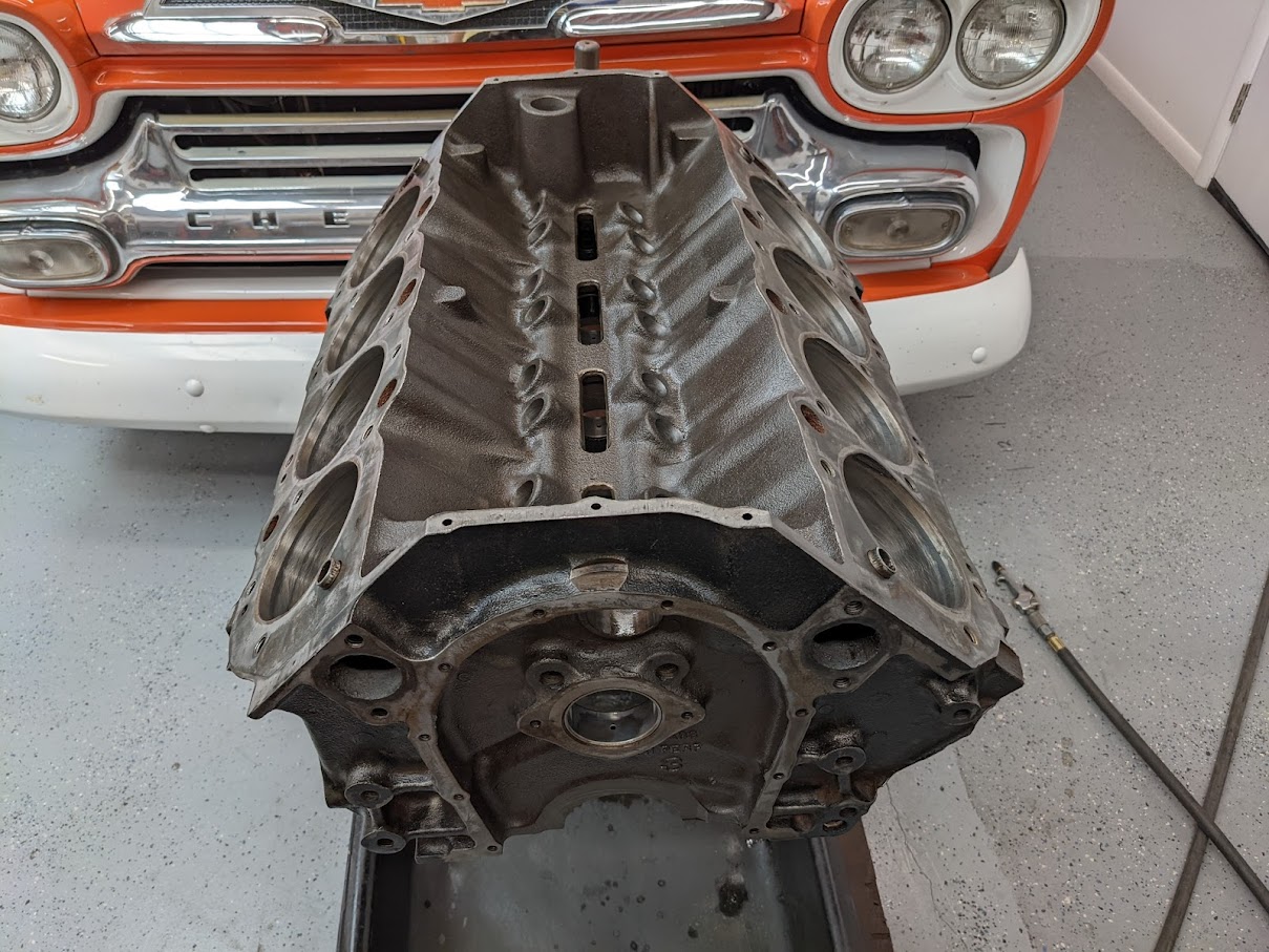

    A few pictures of the block, taken today.
    cast date.jpg Casting date, Nov 2, 1965, as best I can tell. But it could be anything the first week of November.
    A little bit of cross hatch after running the hone through the bores.

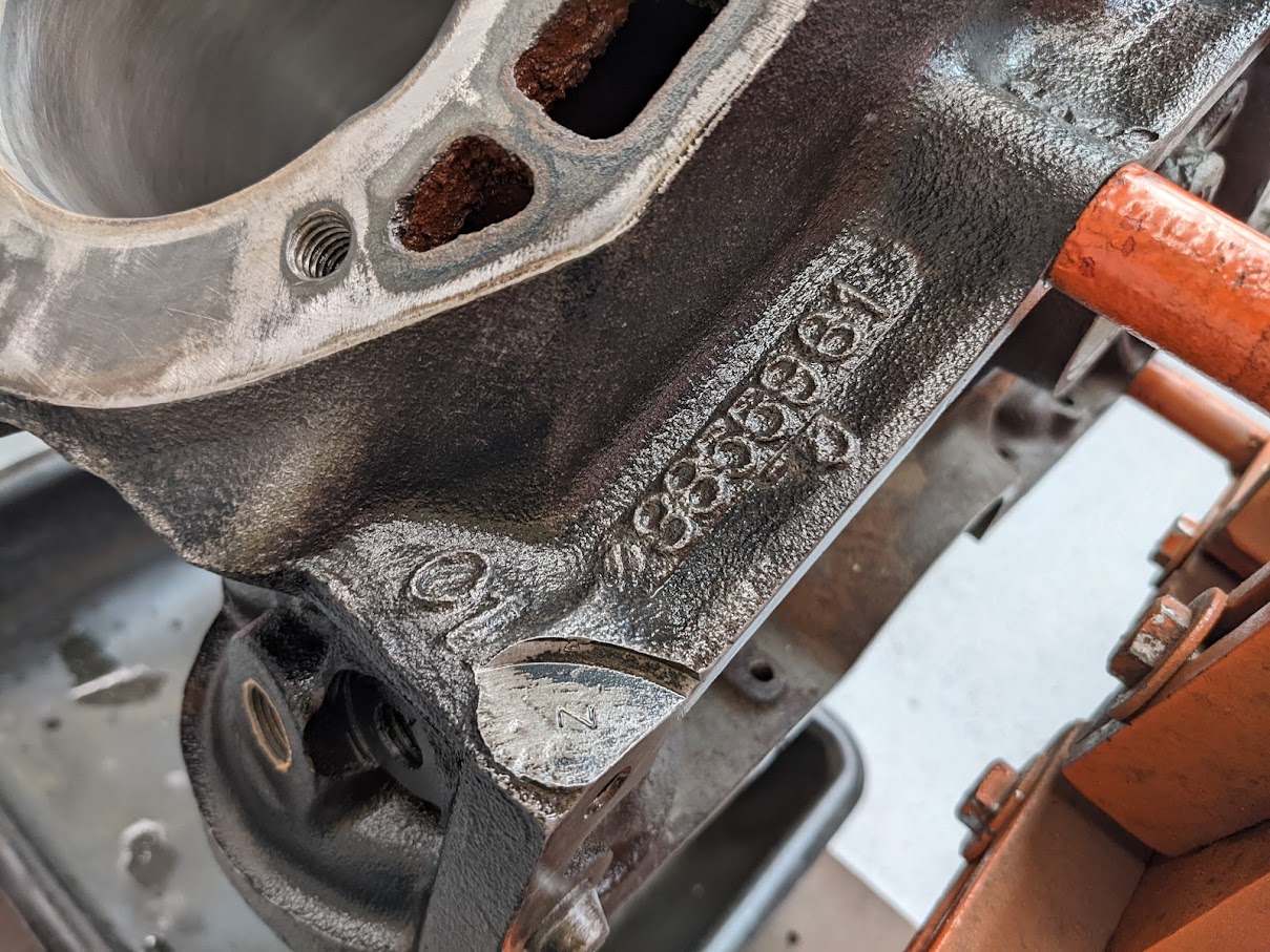

    Numbers. Tonawanda, Nov 4th, IV is a 325 hp engine with TH400, R means it came with a Rochester carb, not Holley. 6L means it was installed in a 1966 model year car in Los Angeles.
    top.jpg A few pics of the block.
    The rust pits. They haven't really hurt anything for the past 42 years, so I'm leaving them alone.

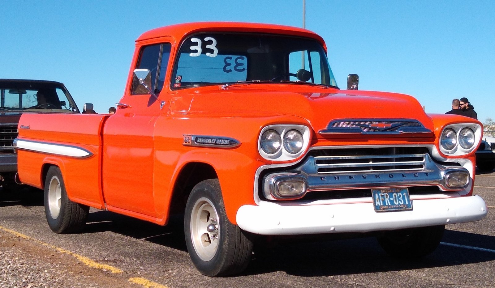

    The 59. When I took it to the races in Tucson Jan 2020, the Zip Tie Drags. Ran low 14s with the 454. It also has 3.54 rear gears, slippery radials, and the fuel system isn't quit up to the task of going faster. If I shifted early, it went slow, if I shifted later, it starved for fuel. So shifting at 5000 rpm, 14.09 was the best it would do.
