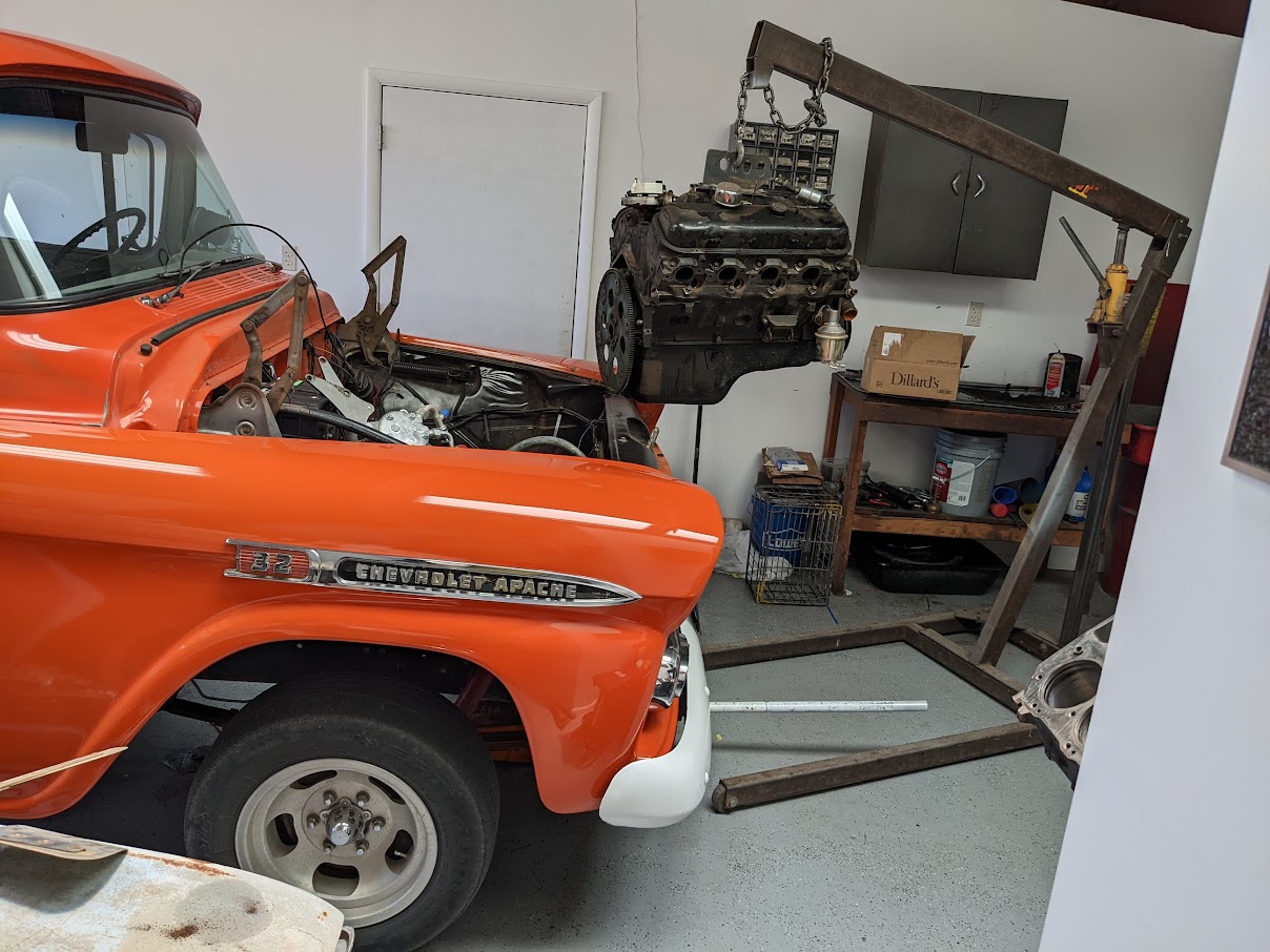

    After a few distractions, I'm back at work on it. I pulled the LS-7 454 out of the truck yesterday.

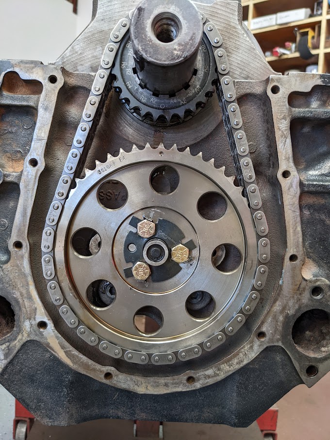

    Double checking the timing marks. This chain set and ****on were in the 454.
    Now I need to put a stop in the back of the timing cover, for the ****on to contact.

  18. Good job Jim ,
    That ole 396 is gonna be very nice,,,,,,and I see the chain is a good D.I.D. model,,,,,good timing set .
    Very good pics,,,,,keep them coming,,,it should turn out great .

    Jim what brand timing chain is that? Looks a lot nicer than the cloys I have been using forever.

  25. Back in the old days,,,,,,Cloyes always used a D.I.D. chain,,,,,,they were the best in my book .
    I’ve torn down a few engines with them,,,…and the chain was still tight with no slack .
    Then,,,.,the bean counters got involved,,,,,and Cloyes chains became ****,,,,like everyone else’s .
    I never knew what the DID letters meant,,,,,I always ***umed it was a company logo,,,,either way,,,,they were tops in my book .
    I also remember using DID drive chains in off road bikes and Atvs,,,,,,top quality product .
    That’s my story,,,,, and I’m sticking to it ,,,,,,LoL .

    The last few cloyed sets I installed were so loose after a few thousand miles it pissed me off. In a few thousand miles cam retarded 4*-6*. That set looked great and still tight that’s why I wondered. Thanks.

    DID chain is manufactured in Japan...They make chains to a price but all grades are good quality
