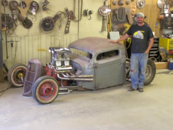

    heres mines....its a .030 402 so basicaly a .060 396

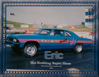

    I raced A .060 over 396 in a 66 chevelle. best Et 11.60 @114.9 MPH. Not bad for swap meet parts, oval ports and a hydraulic cam. It was low maintenance too... low buck AV fuel and change the oil 2 or 3 times a season. Oh yea, I would average nearly 100 passes a year.

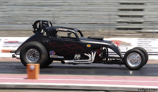

    I bought most of one on Ebay for $387. fairly close to home. Got it home and freshened it up with new rings, bearing and a valve job. We kept the stamped steel rockers and small valve open chamber oval port heads. Bought a summit 540 hydraulic cam and lifters. A used streetmaster intake and 650 holley. We put an electric waterpump on it and a used mallory 9000 distributor. We put a powerglide and a 3500 converter behind it and my son went 10.70.s @ 120 or so.

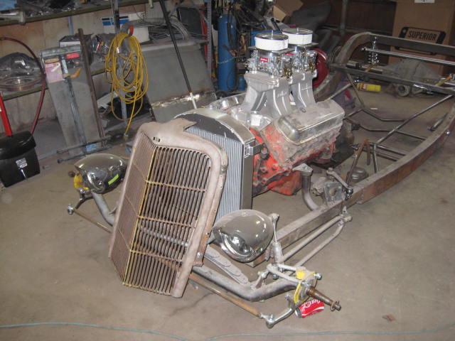

    I knew this would run cooler than a built small block due to the water volume. But I knew I couldnt keep 500 ci or bigger cool. With my 32 style radiator the system holds over 4 gallons of water.

    Hey ardyboy, COOL Fiat. 396's could be made to go much faster if you wanted to throw the $$'s at it but because they were overlooked by big cube guys, there were quite a few of them around then. I think that restorers are starting to snap them up now but back then, you could pick one up for cheap, dust it off, throw a converter and reasonable gear behind it and have a fairly quick, reliable bracket motor.
    I forgot to mention earlier, to answer you question, with descent fuel and maybe a little octane booster, an old 396 will make solid street power and will definitely have a "neat" factor. Keep the carb size reasonable and don't try to spin the old dog to the moon.The first cam I ran in mine had me shifting it at 5,300 and the chevelle would run as quick as 12.30. It sounded like a hay truck but would embarrass fast cars in the first 60 feet....
