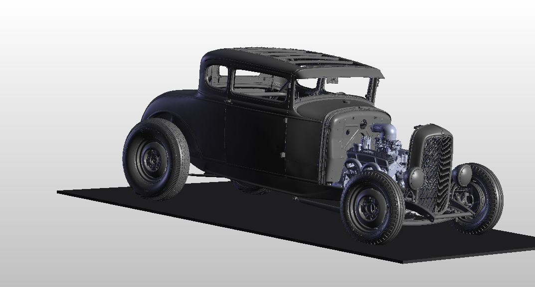

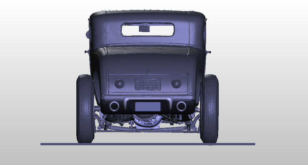

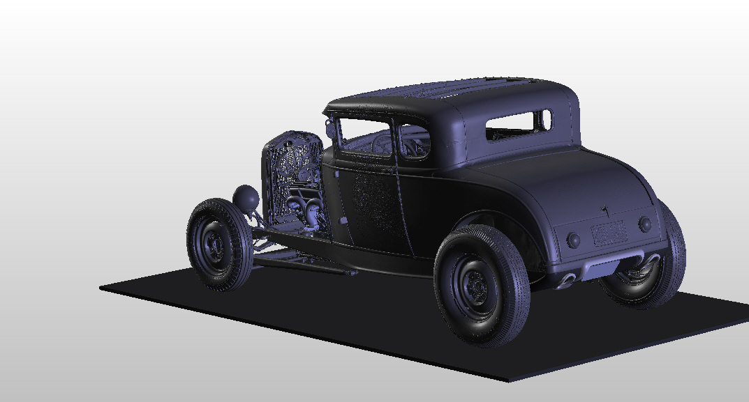

    I am a Hotrodder that owns a 3d design and scanning business. I have been design one off and productions parts for over 20 years. The cad software that i use most is Solidworks. The 3d scanner is a creaform blue line scanner with vxelements software. After seeing my cad work posted on my model a coupe build thread a fellow hamb member suggested that I make a thread for my scanner and design work. I will be using these scans to design parts for my coupe build. I have started to ruff in a rear roll pan as you can see from the pics. I will also use cad to design the duct work from the 32 cowl vent that feeds and cools the 76mm turbo under the dash. The name of the coupe is the Hidden Agenda. I also have scanned my wifes 1951 chevy. I am using cad to do the body mods(chop, taillight, ect.) Hope you guys find this tread to be interesting and inspirational. I will forever use all the tools at my disposal to try to build cooler and cooler everything...
    001 A001 MAIN COUPE BODY.JPG 002 A001 MAIN COUPE BODY.JPG 004 A001 MAIN COUPE BODY.JPG 005 A001 MAIN COUPE BODY.JPG 006 A001 MAIN COUPE BODY(1).JPG 007 A001 MAIN COUPE WITH ROLL PAN.JPG

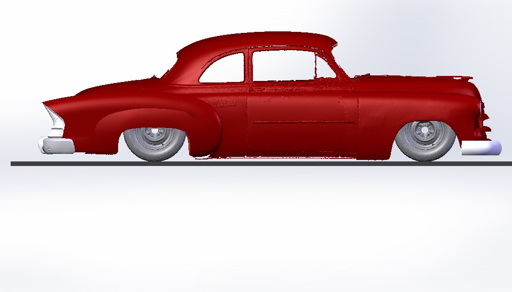

    Heres a picture and some older scans of my wifes 1951 chevy. You can see how im using the scan to find the best fitment of the packard tail lights. The cad allows me to see it before I start cutting. thumbnail_KIMG0178.jpg
    thumbnail_A001-1951 P002.jpg thumbnail_A001-1951 002.jpg thumbnail_A001-1951 001.jpg

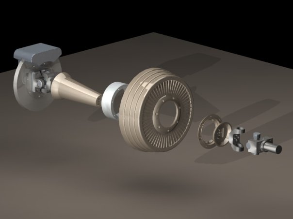

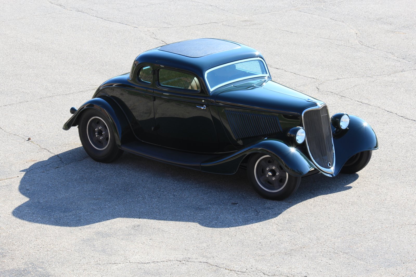

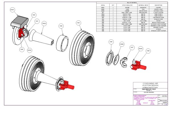

    Heres some of the parts that I did the cad work on years ago. (I sure wish I would have had a scanner back then) This was for the first love a 1936 ford built by Rad rides by Troy. 36 ford ridler 1a.jpg 36 ford ridler 2.jpg 36 ford ridler 3.jpg
    36 ford ridler 9.jpg 36 ford ridler 9a.jpg 36 ford ridler 9b.jpg 36 ford ridler 9c.jpg 20738_108198592524683_7602527_n.jpg 20738_108198585858017_1952753_n.jpg 20738_108198569191352_805528_n.jpg 20738_108198565858019_6650711_n.jpg 20738_108198555858020_7633728_n.jpg 20738_108198552524687_5104560_n.jpg 20738_108198602524682_6709854_n.jpg 76933_1221549676197_445399_n.jpg

    1.I have a few weeks getting the model a coupe to the point you see it here. Its not perfect but will accomplish the jobs I intend to do.
    2.The coupe is made up of 5 scans that are put together in cad. The computer clean up work takes 1-3x the time it took to do the scanning itself.
    3. scanning services cost vary alot from one job to another depending on the desired end results.
    4. I did my design job for years without the ability to scan the parts. Just think of scanning as a way to make thousands of measurements. The scanner that I use is accurate to .001 over an 18" span.
    5. the scanner is a tool than helps us take out alot of human error and guesswork.

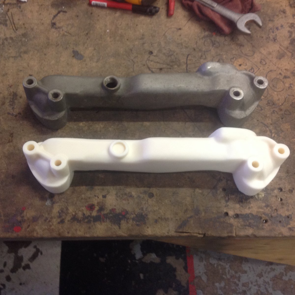

    My little brother has scanned and designed a new backing plate for a brake set I want to cast. Based on 41 Lincoln specs, but with our own shapes and contours.
    First he scanned the Lincoln plate, then changed up the design, then printed a 100% size model. Then I tested fit, and made design changes. We will take the next printed model to the machinist for his approval, and if good will then print an oversized pattern for casting.

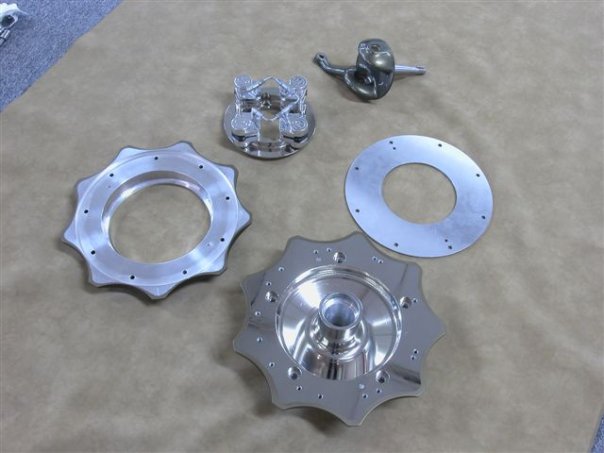

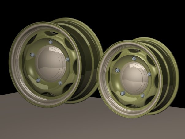

    My CAD usage for projects has increased. It's a great tool for iterating before you try to build something real. On my '33, I pretty much laid out the entire ch***is in Fusion360, which helped with a lot of packaging work.
    My favorite project to date was the the cast magnesium wheels I made for that car, born from CAD of course:

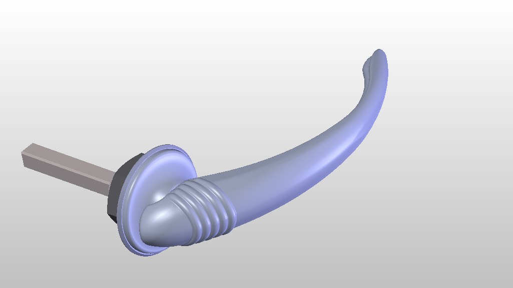

    Here is one of my latest projects. 1936 ford highboy roadster by Rad Rides. I did the cad work on the wheels and door handles. All of the work is done on solidworks. 005-36 gg.jpg 004 36 gg.jpg 003 36 gg.JPG 002 36 gg.JPG 012 A001-DOOR HANDLE ASSEMBLY.JPG 013 A001-DOOR HANDLE ASSEMBLY.JPG 010 36 gg.JPG 011 36 gg.JPG
