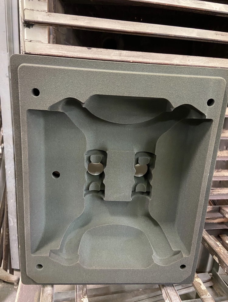

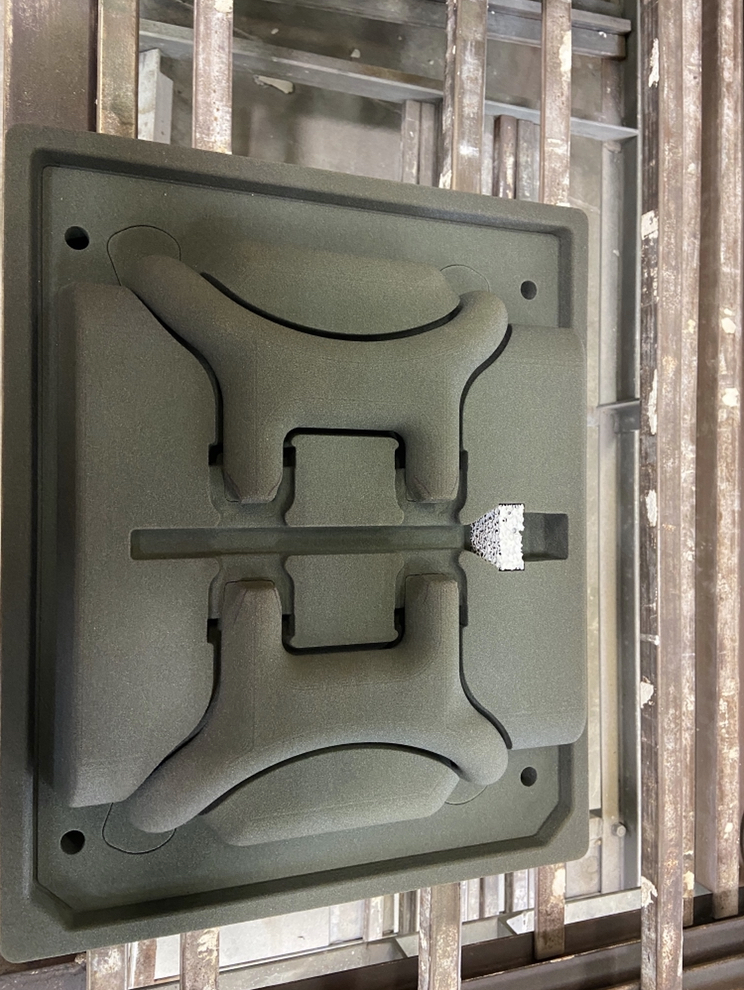

    Here is printed sand mold that pours 2 banger intake manifolds, waaaaay more affordable process than DMLS
    There are also machines that will build up material layer by layer using a CNC mig welder, then machine the OD skin into final shape
    Okie Pete, winduptoy, jet996 and 5 others like this.

    Frozenmerc, that looks like a 3d printed mold. I have seen a few at the foundry I use. They don't know much about them. How close tolerance can they produce? Any other info you can share? Thanks, I too like to read about this type of tech. Amazing stuff going on here.

    Yes, as I stated, it is a 3D printed mold. As far as the tolerances, I would say they are as good if not better than typical cope and drag sand casting. Of course, with a production run of two, tolerances are of little consequence and I built a fair amount of extra material into the raw as-cast model, just to make sure the critical flanges would clean up during machining. 3/16" to 1/4" of extra material on all machined surfaces created a nice pile of shavings.
    The critical step is the engineering of the mold itself. The shrink rates need to be calculated correctly and the cores designed such that they are properly supported and don't move during the pour. We had a little shift with the thermostat housing area that was discovered during final machining. Not a big deal, and nothing that couldn't be fixed with a bit of welding. The machining pattern was adjusted for the 2nd manifold, and it came out perfect. The rest of the manifold was spot on and Hoosier Pattern did an excellent job of designing the mold.
    I would love to make about 5 more and sell them, especially now that the mold design is completed. But it is a very small market as there aren't too many folks interested in building a blown MEL, and I doubt I would be able to make any sort of profit on the endeavor.

    Frozenmerc, thanks for the explanation. How many cycles are the 3d printed molds good for? I have heard that the printer blows sand continually and adds glue for the mold and stops in the cavity. When finished the whole block looks like sand until you blow out the cavity. Is that true?
    Okie Pete likes this.

    Yup, one thin layer of sand at a time, with the printer being basically a big inkjet laying down glue between sand layers. When the printing cycle is complete, a big box of sand. A little time with a vacuum reveals the mold segments. Mold segments are cleaned and ***embled, then delivered to the foundry for pour. Like all sand castings, molds are destroyed after each pour

    Thanks Kevin. I was afraid that they were used up just once. The Amish foundry I use has had some 3d printed molds but they really have no understanding how they are made. I was hoping they could be used a few times. The ones I have seen look like a work of art. The maker ever prints a picture of the part on the outside with a part number so the mold can be easily recognized. The big benefit would be not having to make a pattern. It would go straight from the computer screen to mold.
