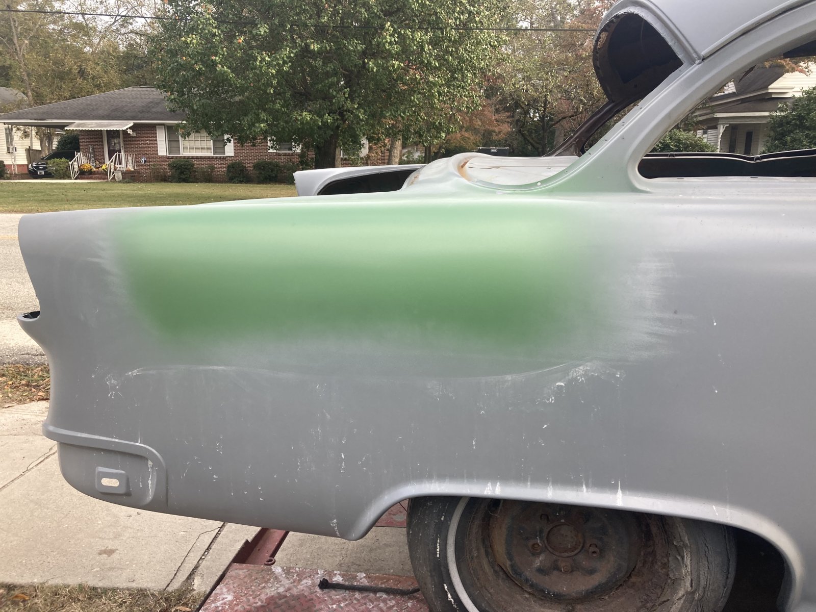

    I bought one a couple of years ago and did not like the way it sprayed. Decided to give it another try and ordered more cups and strainers. I really like the cleanup and mixing cup system. painted my Chevy II from epoxy to final paint using SPI products. Clean up is super easy and you only use about an ounce of lacquer thinner. Take the cup off, throw it away, then pour thinner in the top of the tip, spray it out 2 times, remove the tip and wipe the needle. I use all of the different size tips. Just sprayed a panel in lacquer on my 55, worked great. Only drawback is you can't adjust the fan pattern.
