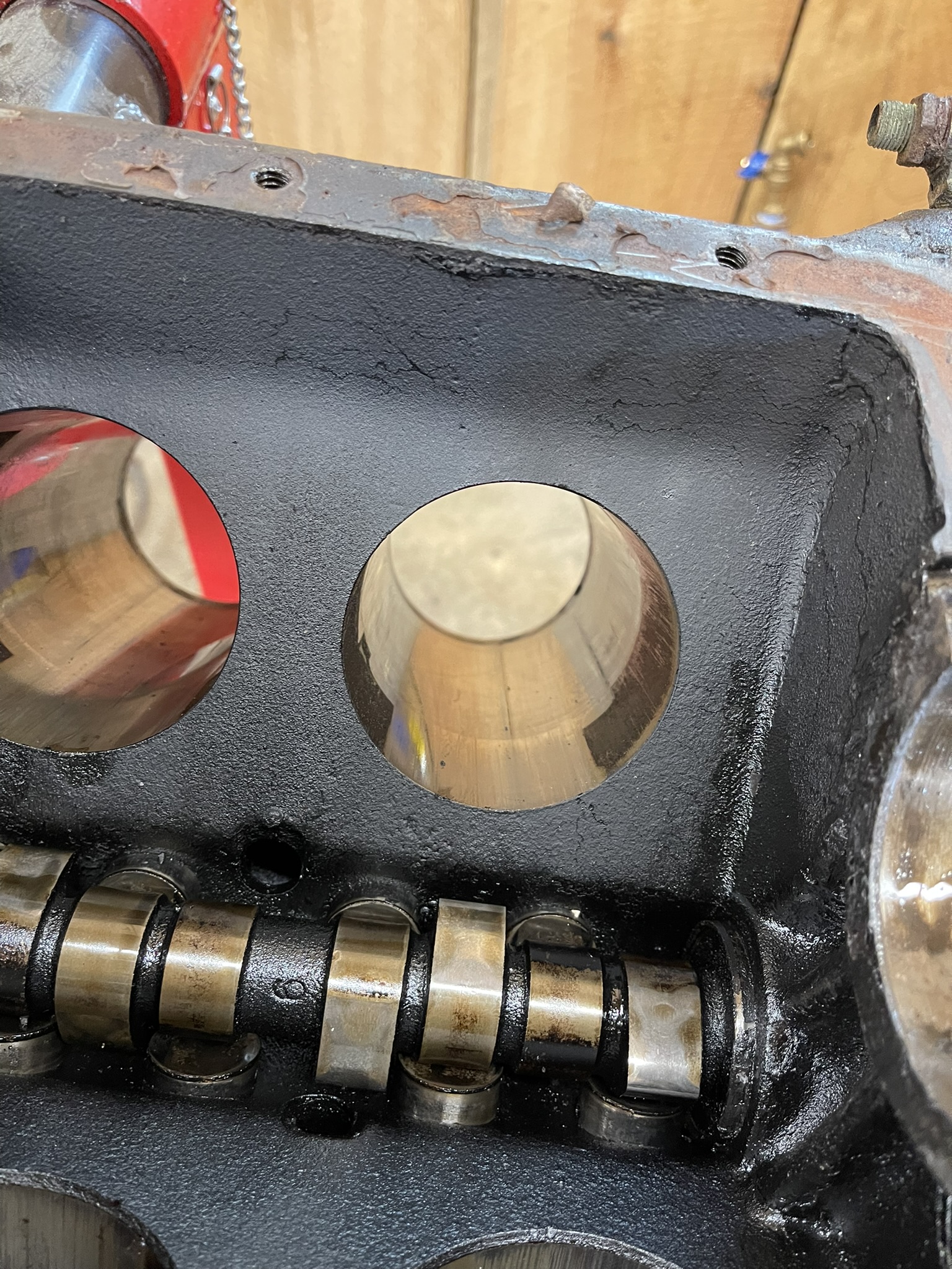

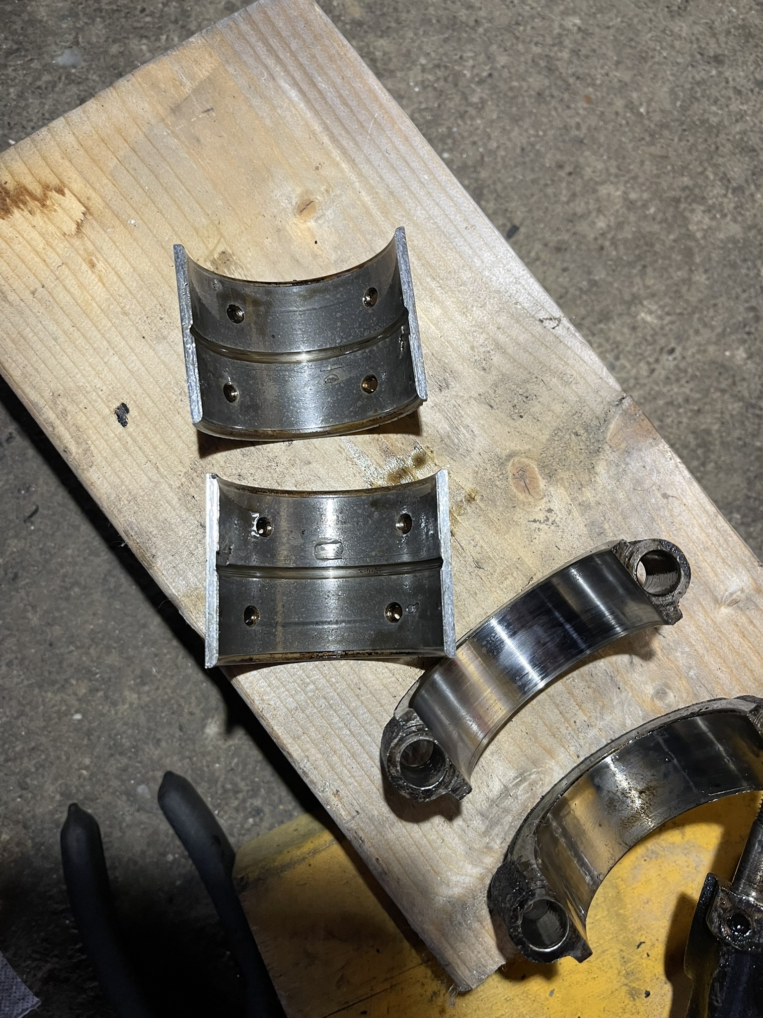

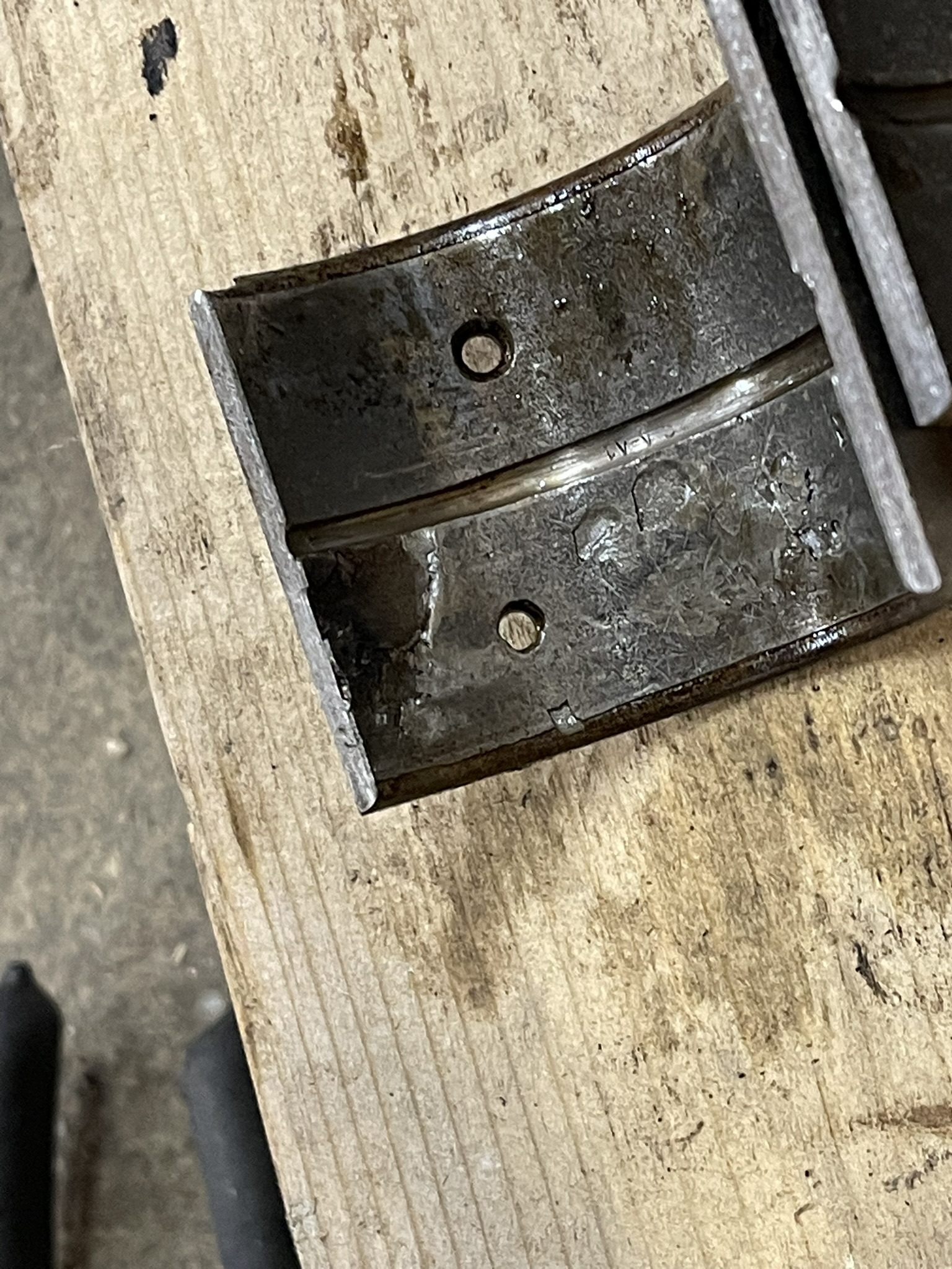

    Back to the motor... These lock washers are something I've not seen. Also, should the center main just lift off after the nuts are off? isn't budging at all. Kroil?
    Deutscher, Thor1 and winduptoy like this.

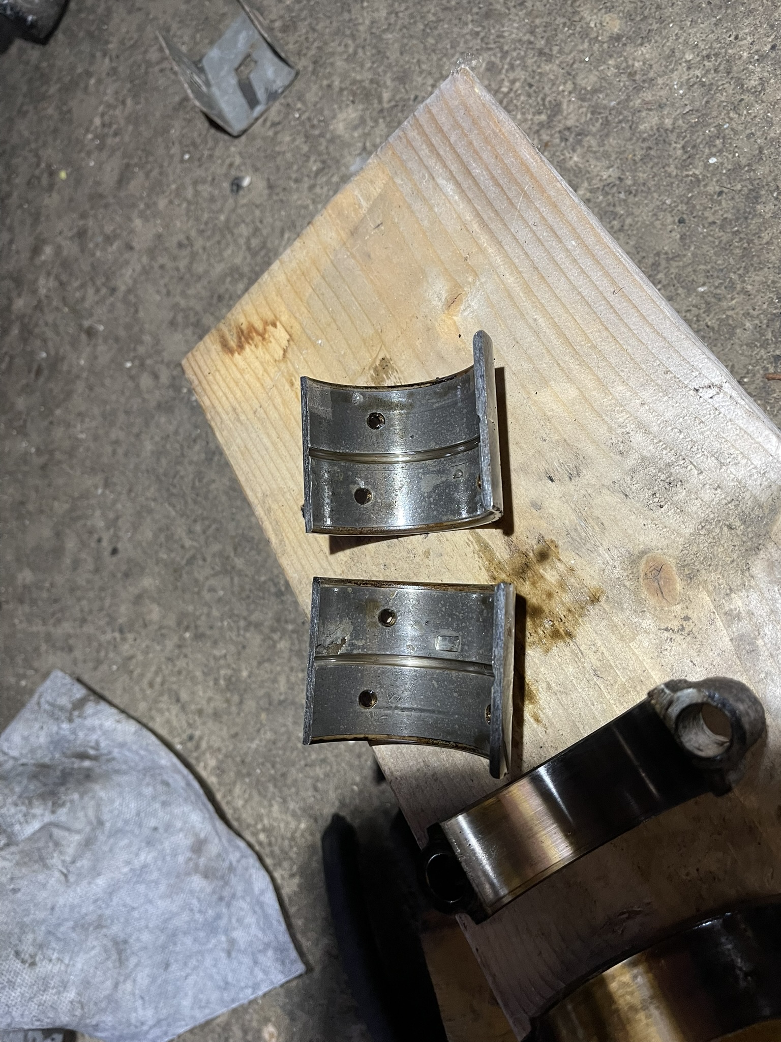

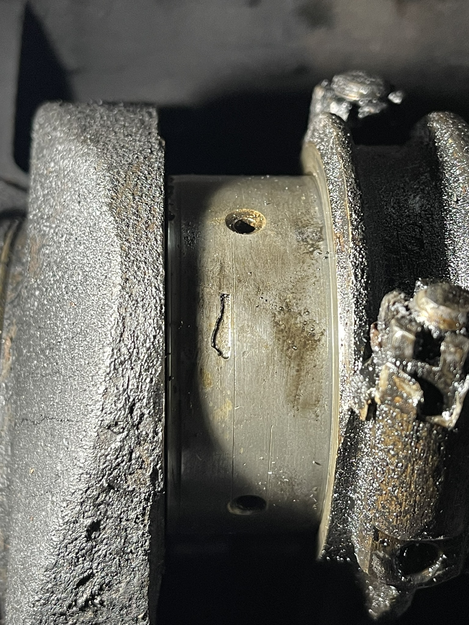

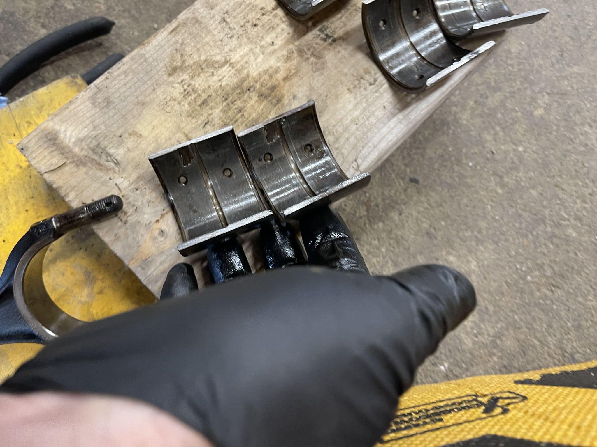

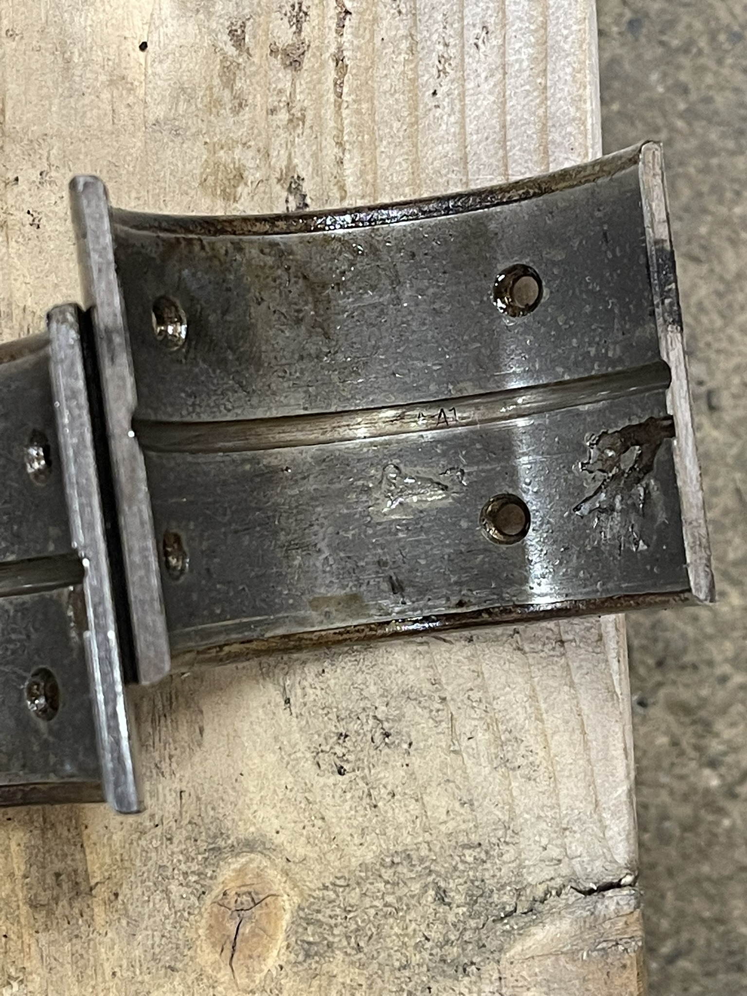

    Yep, good idea to check it out.
  7. winduptoy
    Joined: Feb 19, 2013
    Posts: 4,295
    winduptoy
    could be just suction stuck....tap it side to side slightly to see if you van break the suction

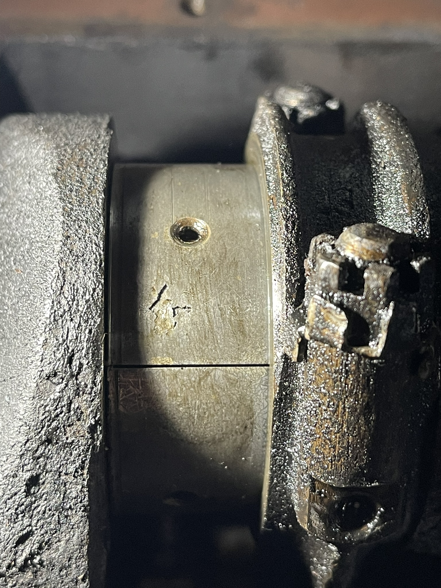

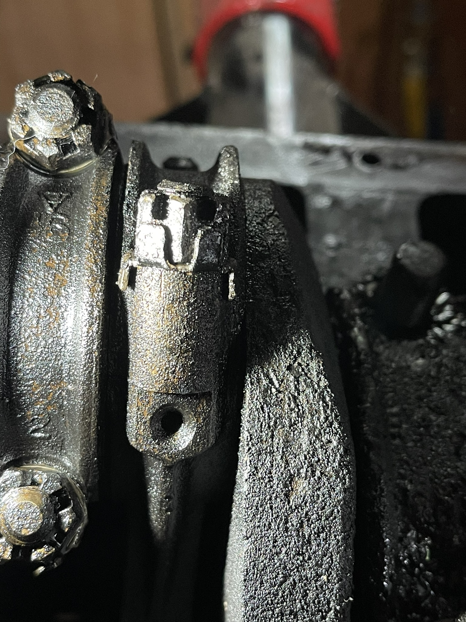

    Thanks, I didn't want to beat on it at random. I would like to pull the crank first so I can take the pistons out the bottom rather than drive them over a ring ridge with the crank in. Not sure which is worse cotter pins or the bending lock washers.....

    Neither are fun but I guess I prefer pulling cotter pins over installing them....and bending lock tabs over removing them...pistons out the bottom soon

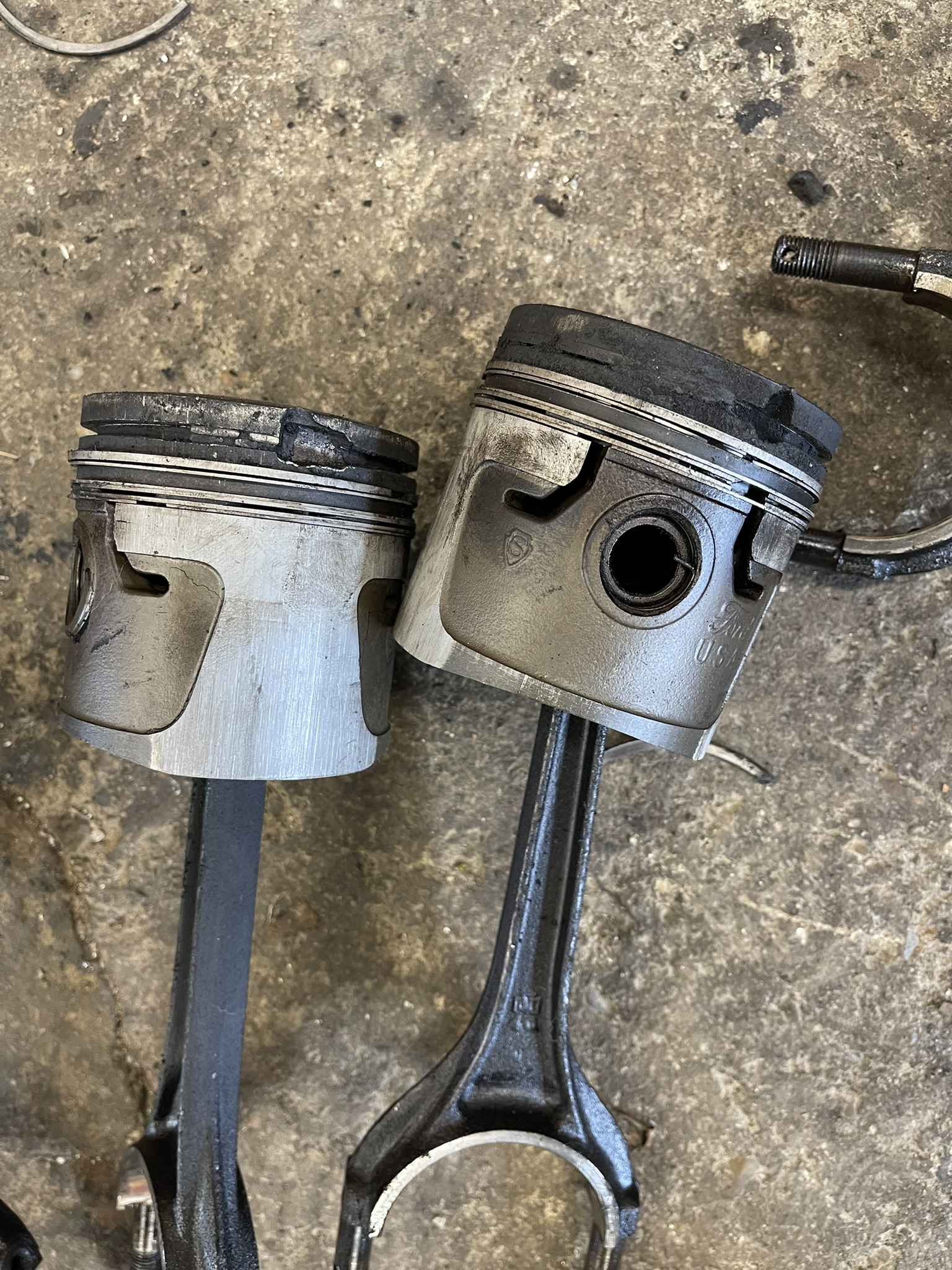

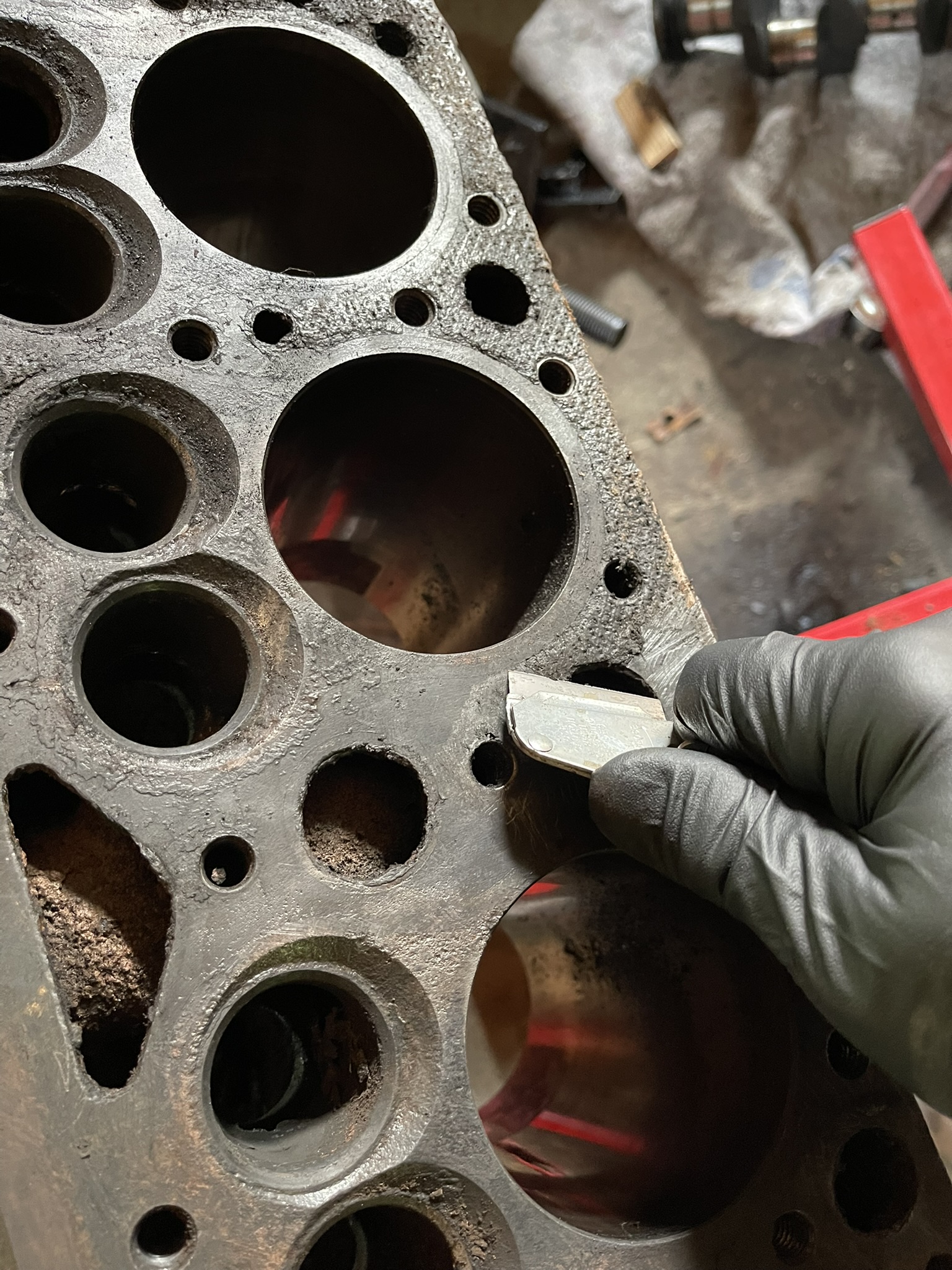

    Amazing those cylinder wall are as nice as they are. Granted I may have broke the top rings on these two going past the ridge at the top of the cylinder.... One of these is the piston with the marks in the top though.

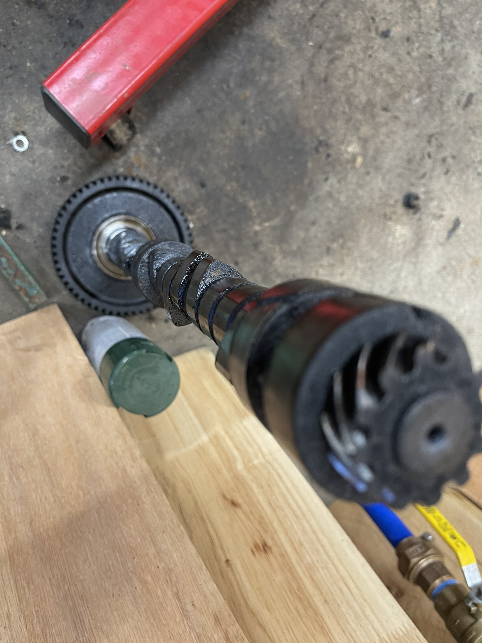

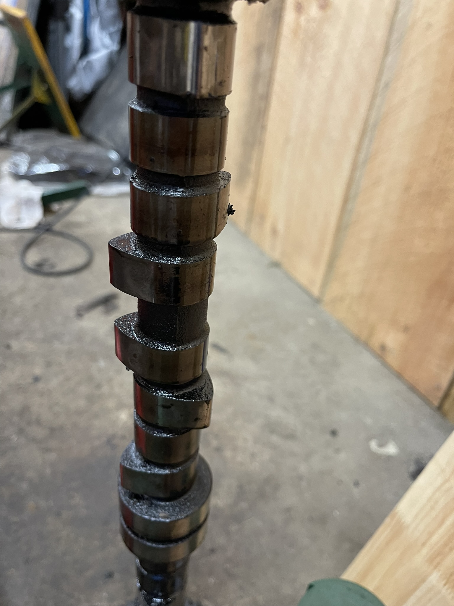

    Definitely looks like a low milage cam to me.... of course a stock cam is not likely after all the work to build this......

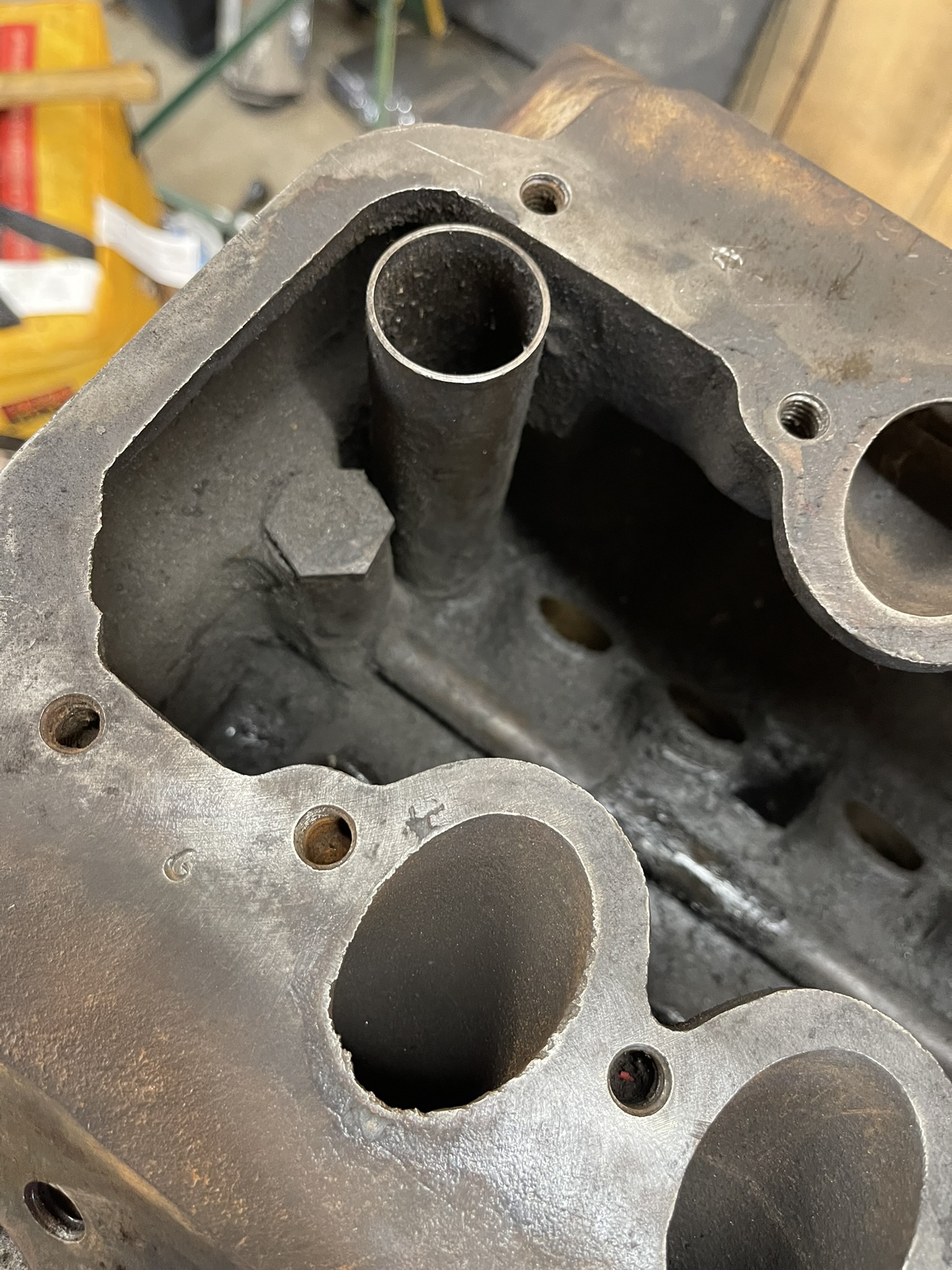

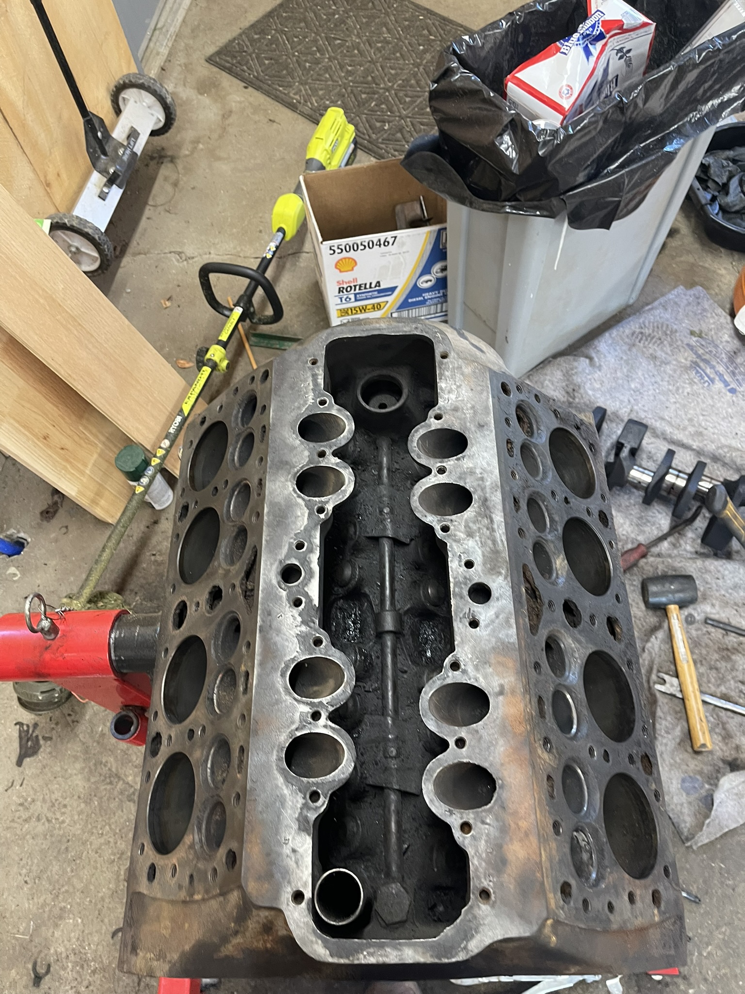

    OK lesson time for me. What is this bolt/plug? and does this shaft come out? Looks like it would slide out if the plug is out?
  20. hotcoupe
    Joined: Oct 3, 2007
    Posts: 647
    hotcoupe
    The "bolt" is actually a plug that caps a pressure relief valve, the "shaft" is actually the main oil gallery. It doesn't come out.

  21. jim1932
    Joined: Jan 26, 2011
    Posts: 1,165
    jim1932
    Next up for the motor is a hot tank at Go Devil.

    Joined: Dec 11, 2003
    Posts: 4,666
    TomT
    After the hot tank you might want to check all the water p***ages in the block for any sand that might still be around after its original casting. My avatar has been everywhere and winduptoy knows my car. I dug out a lot of sand from the block - a gallon paint buckets worth at least. While its wide open, might be worth checking out.

  24. jim1932
    Posts: 1,165
    jim1932
    So are you saying it won't come out? or that people leave it in there?
  25. chlsnk
    Joined: Dec 11, 2008
    Posts: 243
    chlsnk
    The bolt will come out,under it is a spring and plunger for oil byp***. Open it up before hot tanking.

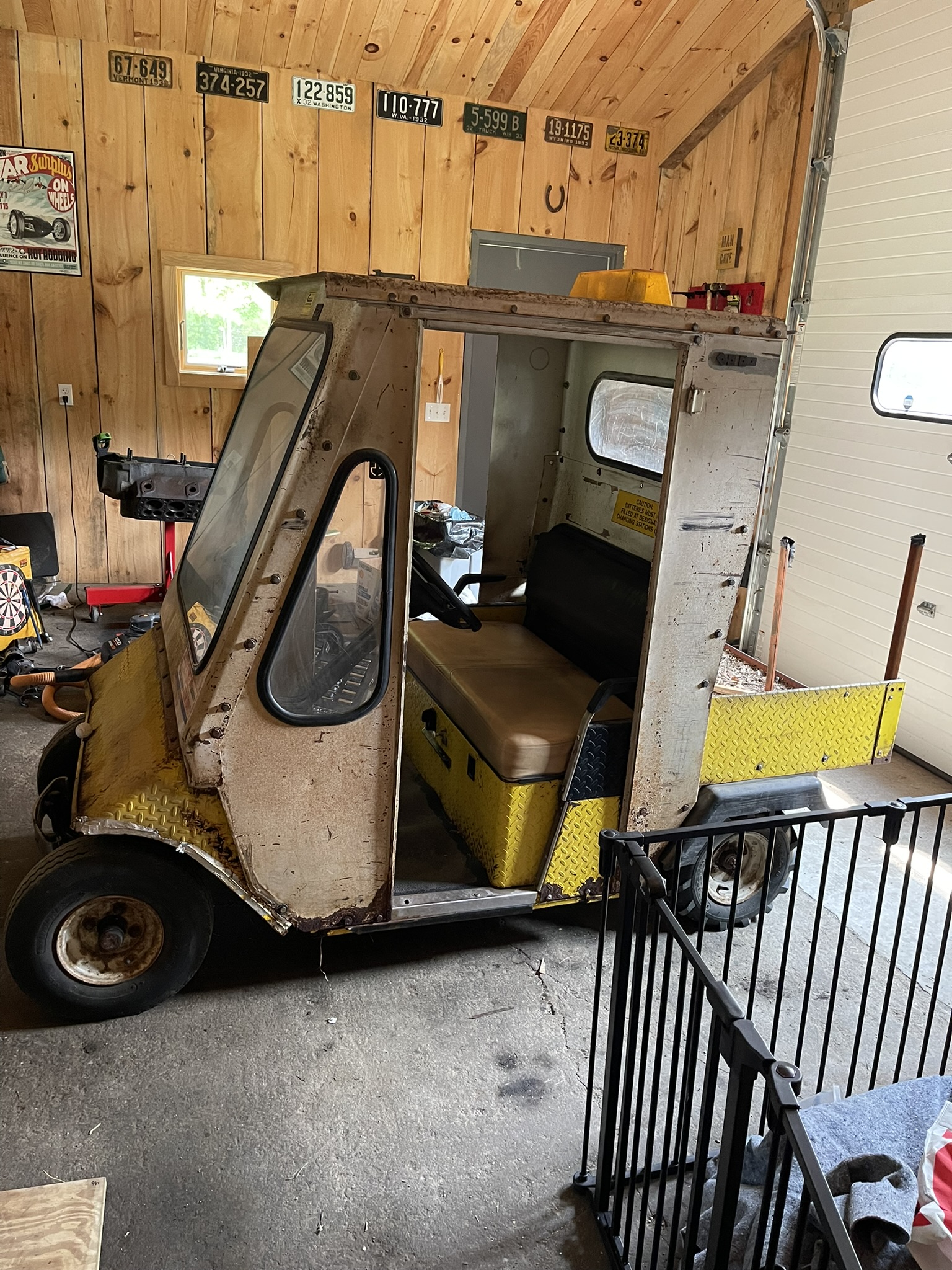

    Still can't get on the field to grab the model a frame. It's finally had a couple days with out rain, so maybe soon. I am also hoping to get the block to Go Devil to get dipped next week. In the mean time, this just came to me unexpectedly. I has to stay stock though.

    Nice...looks like you filled the fun void with a local complete until the local build is done...
