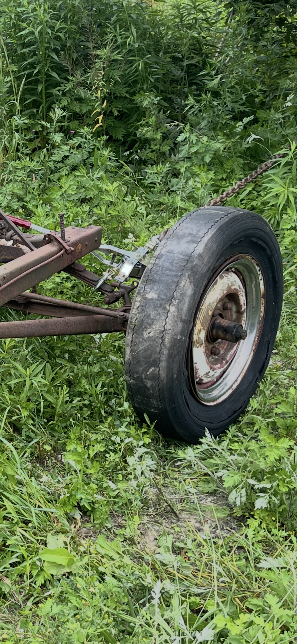

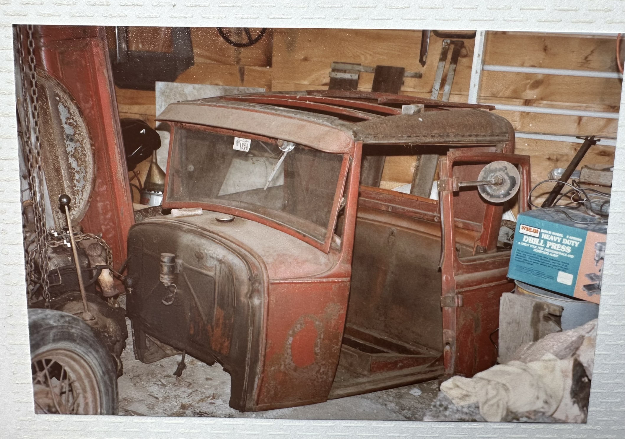

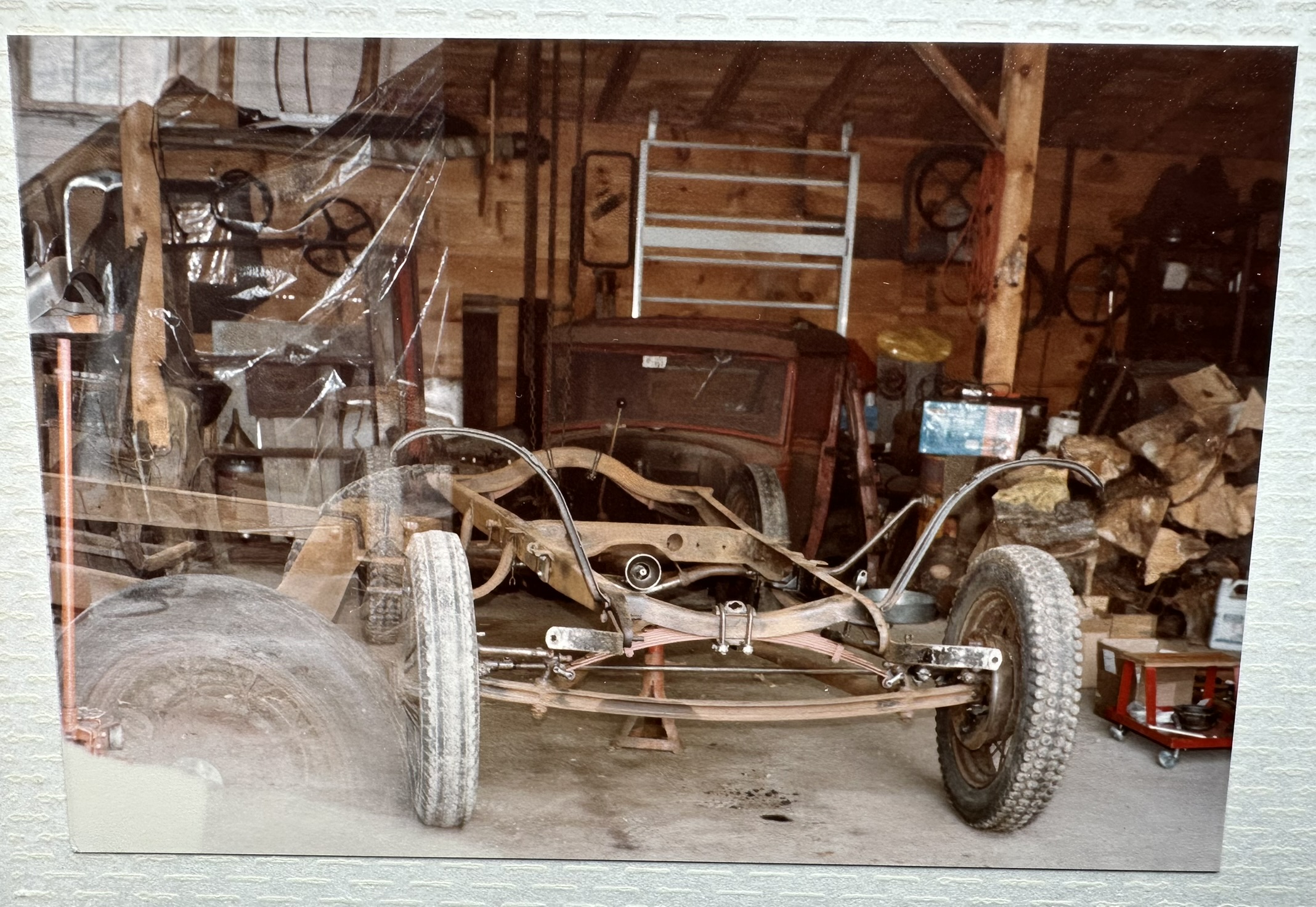

    Yeah The guy that did this was partners with my Dad in the farm equipment dealership in the 70's. My Dad pulled out in the 80's but the business stayed open. This is what he started with.

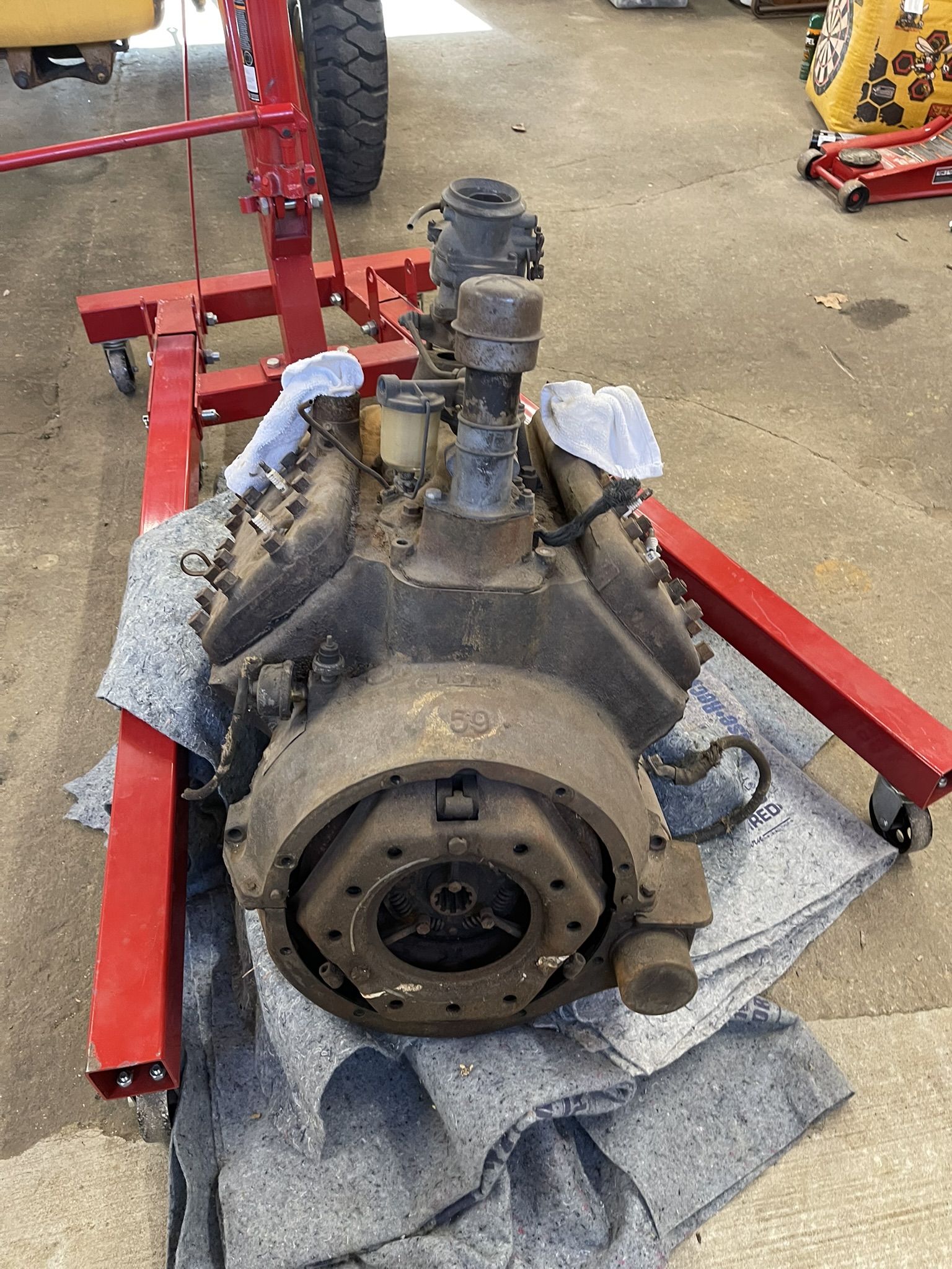

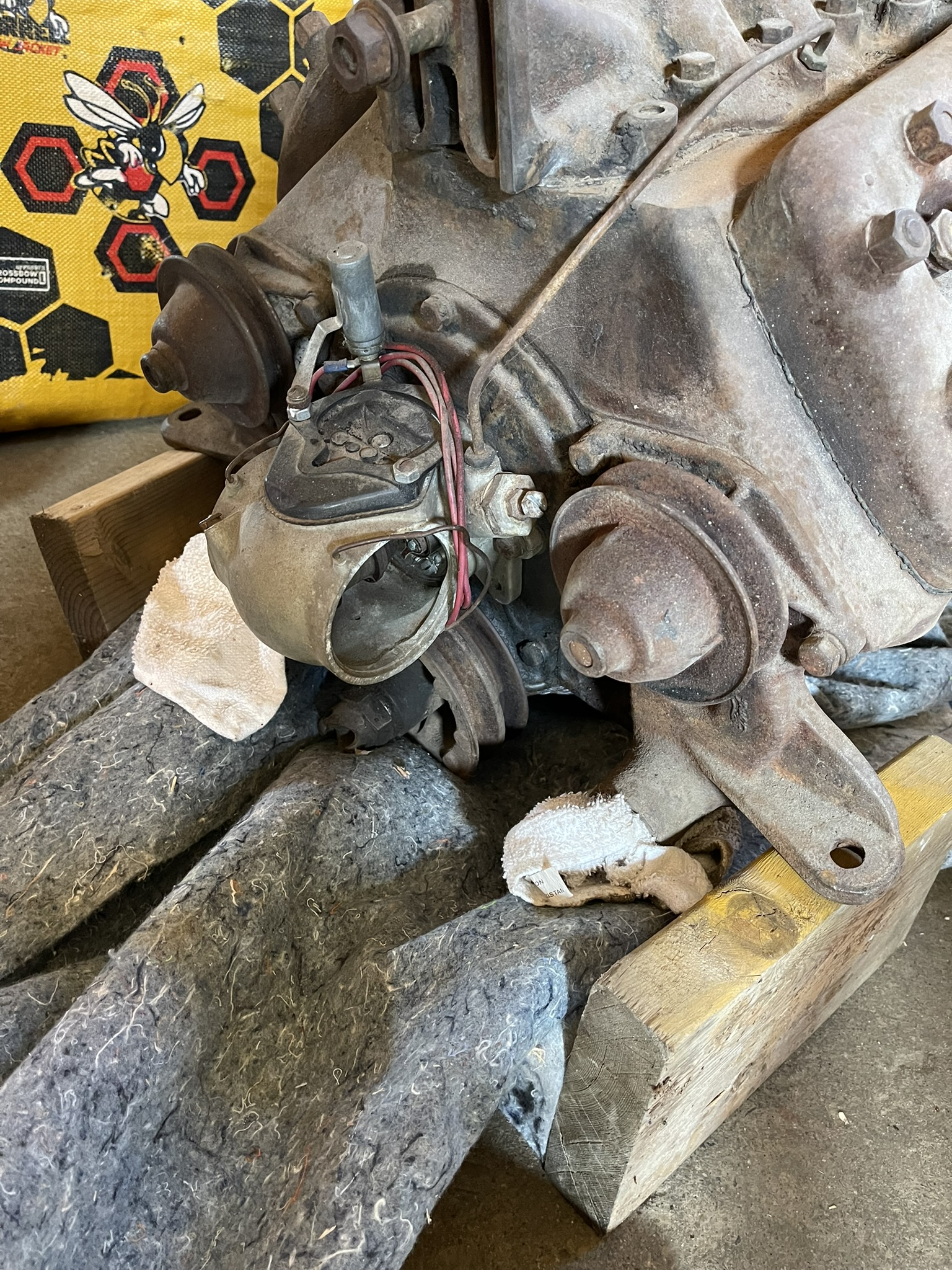

    Ummm. Is this the wrong timing cover for the motor? I am thinking the motor is a 59A 1946-48 as it has the 59 on the bell housing and one triangle and 2 round water holes. Shouldn't this have a 2 bolt distributor?

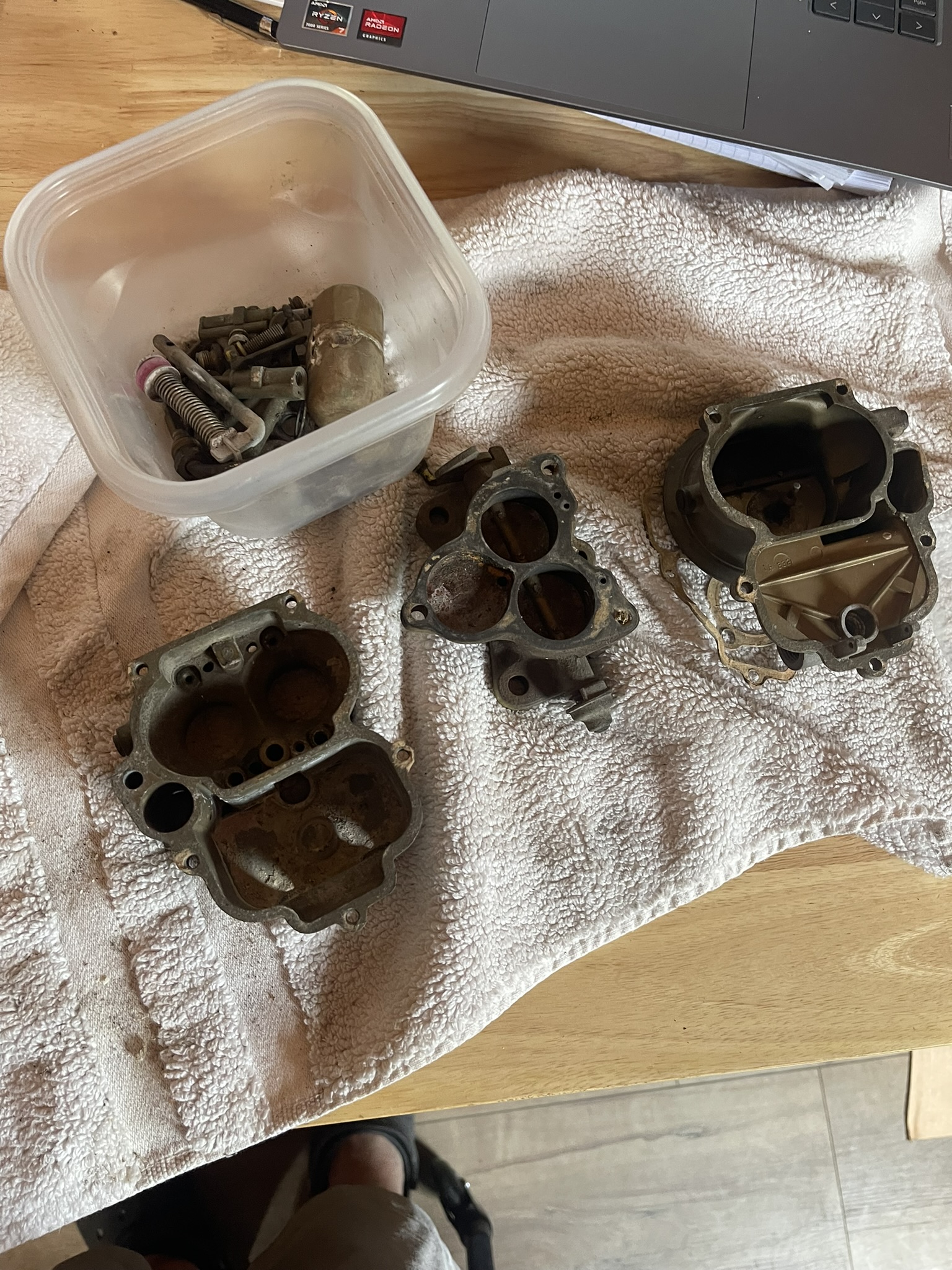

    Still looking for an answer in the correct timing cover.

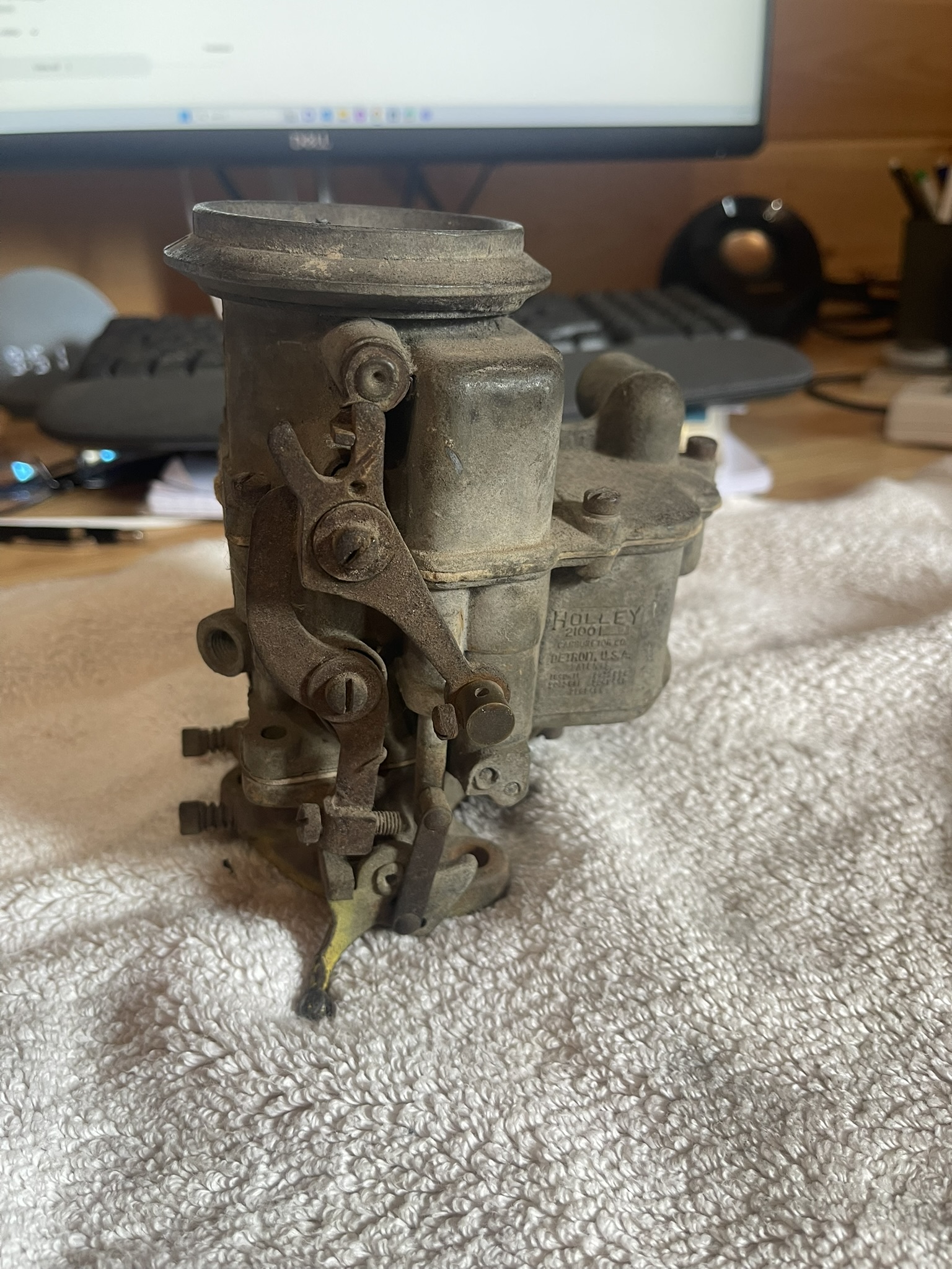

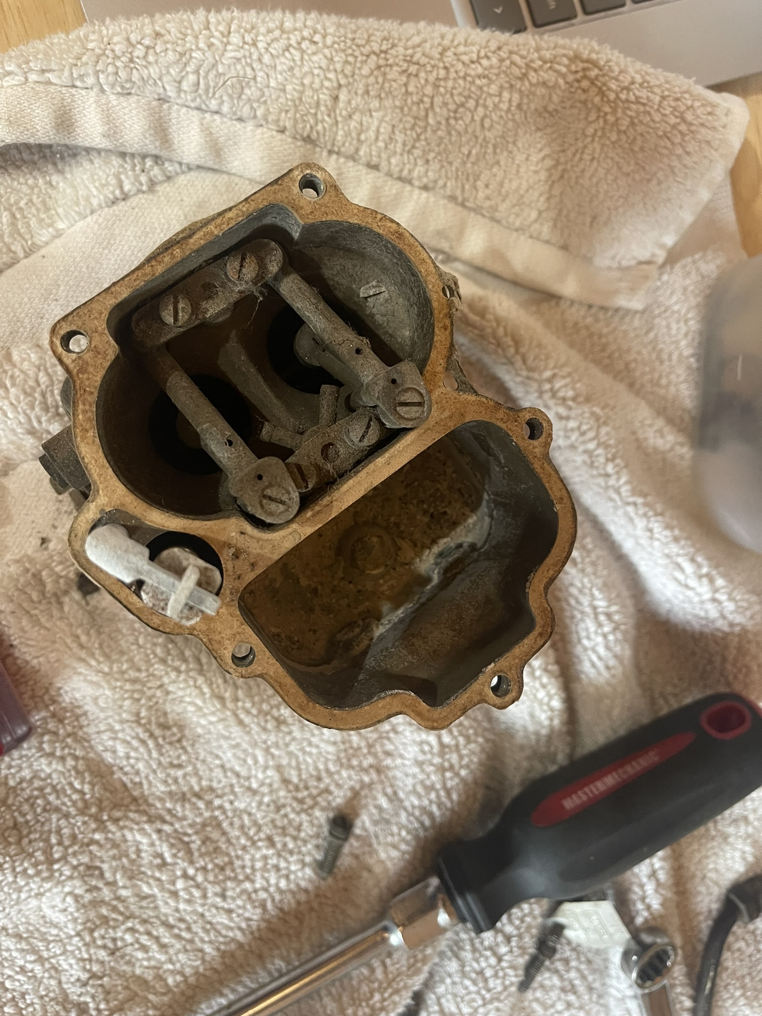

    In the meantime, had nothing better to do so I took the Holley apart. I have a rebuild kit for it after I clean it up.

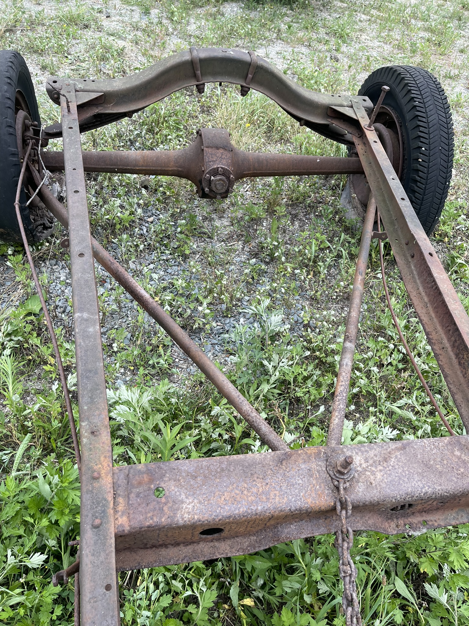

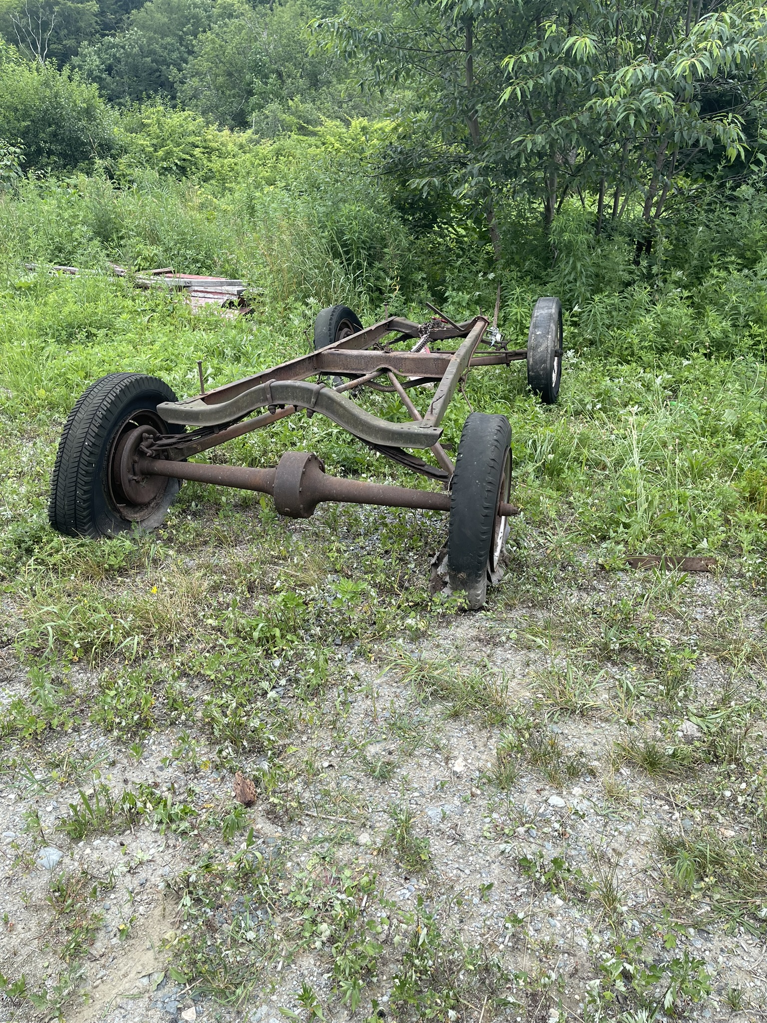

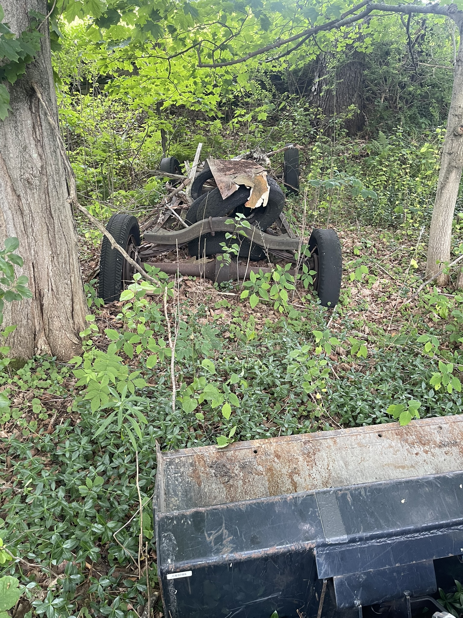

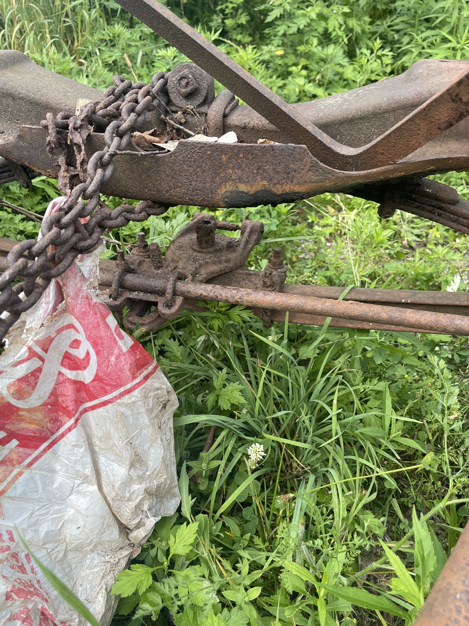

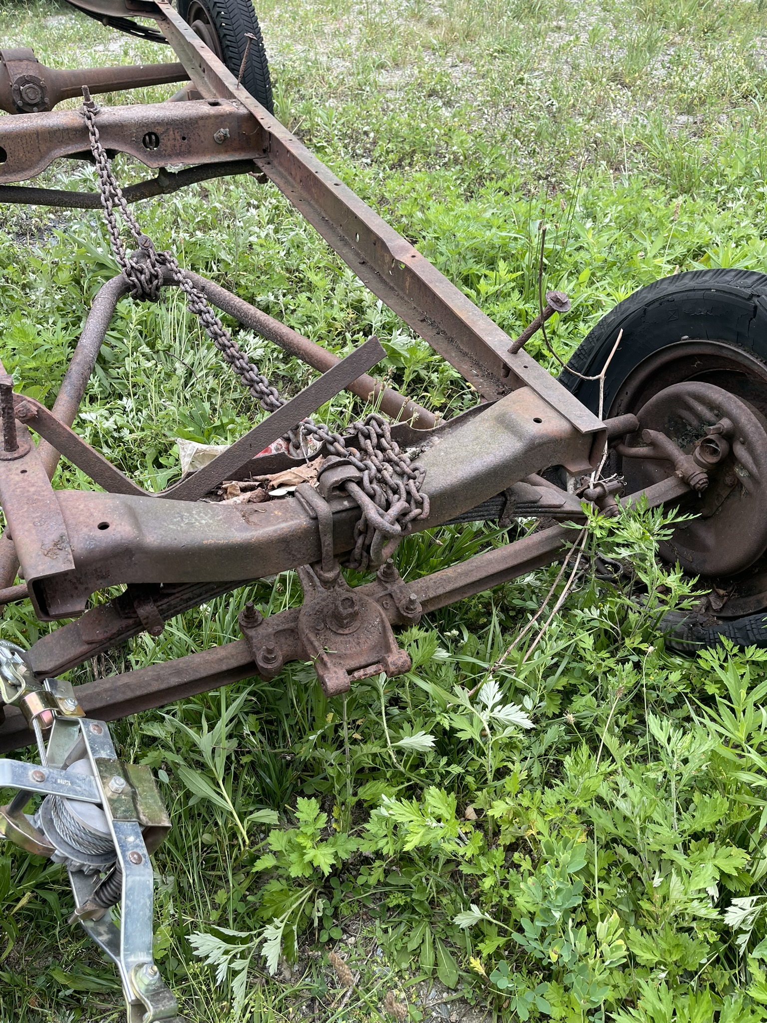

    well for what it is worth I got the frame. it is rough, but we will see after I strip it more. I pulled it out as a favor for the woman down the street, so not like I am out anything.

  6. winduptoy
    Joined: Feb 19, 2013
    Posts: 4,554
    winduptoy
    That is a good looking frame....missing the frame horns but it looks like you got some cheater slicks to compensate...
    I count it as a score
    porkshop and Okie Pete like this.
  7. Okie Pete
    Joined: Oct 29, 2008
    Posts: 6,604
    Okie Pete
    The tongue mount for the hitch looks to be a kit that bolts on . A lot around here a welded on pieces of s**** metal.
    porkshop likes this.
  8. jim1932
    Joined: Jan 26, 2011
    Posts: 1,177
    jim1932
    ...and a set of wheels I guess... and a chain so there is some value.. LOL I will start hitting some spots with oil and see what I can get off. spindles and everything brake related is shot. so maybe a brake rod spreader bar....if I put frame horns back on it.

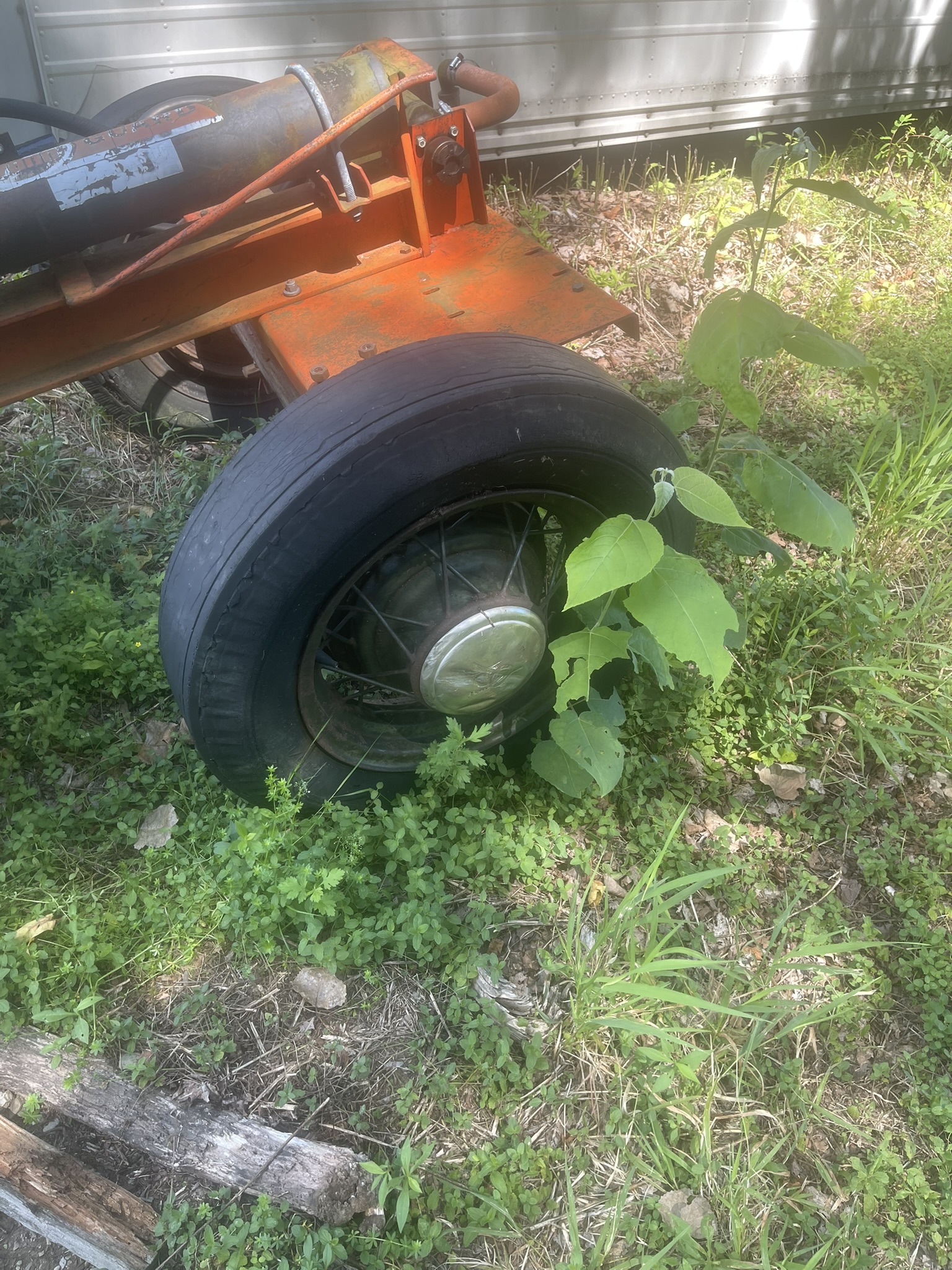

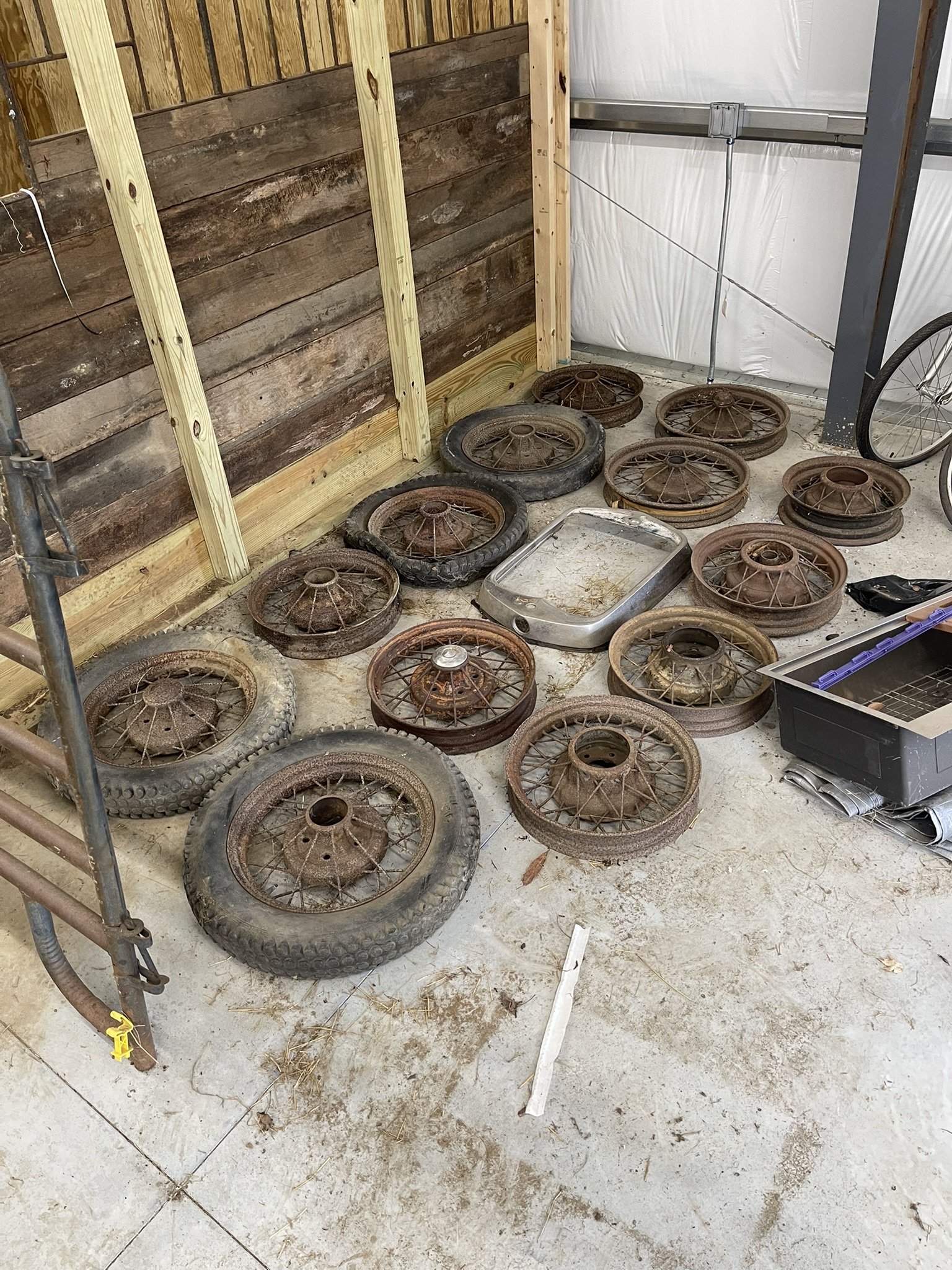

  16. jim1932
    Posts: 1,177
    jim1932

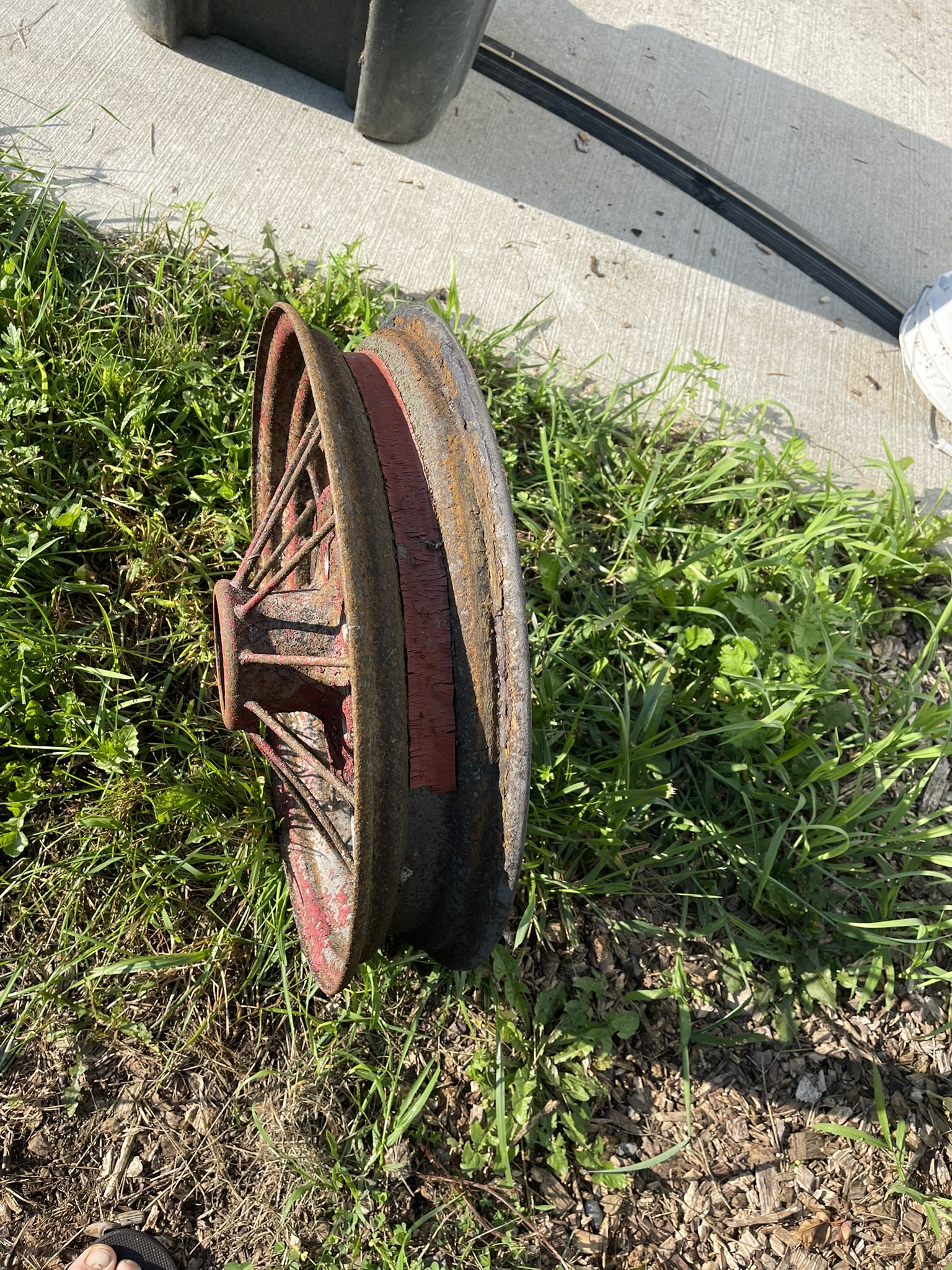

    Starting to work through the 16 or so wheels that came with the model a pick-up and wood splitter. I might get some good ones out. Big black tub in the hot sun with water and half a gallon bottle of 911 concentrate. Any that are usable will probably sand blast the good ones

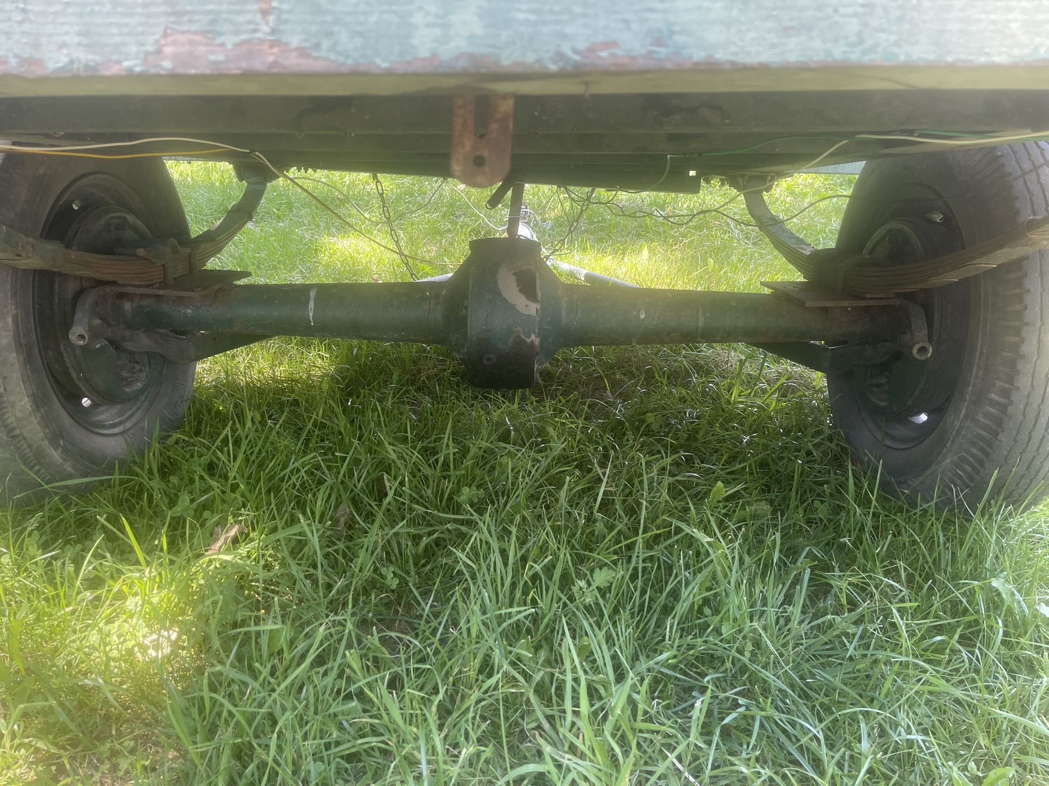

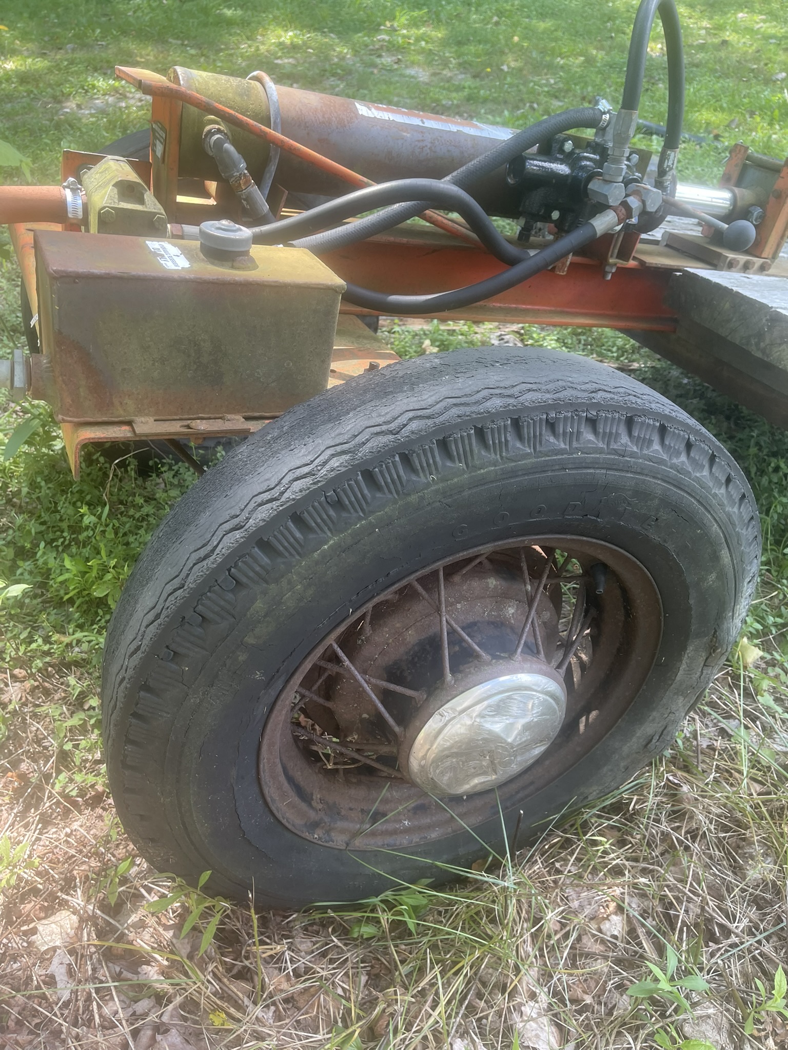

  18. jim1932
    Posts: 1,177
    jim1932

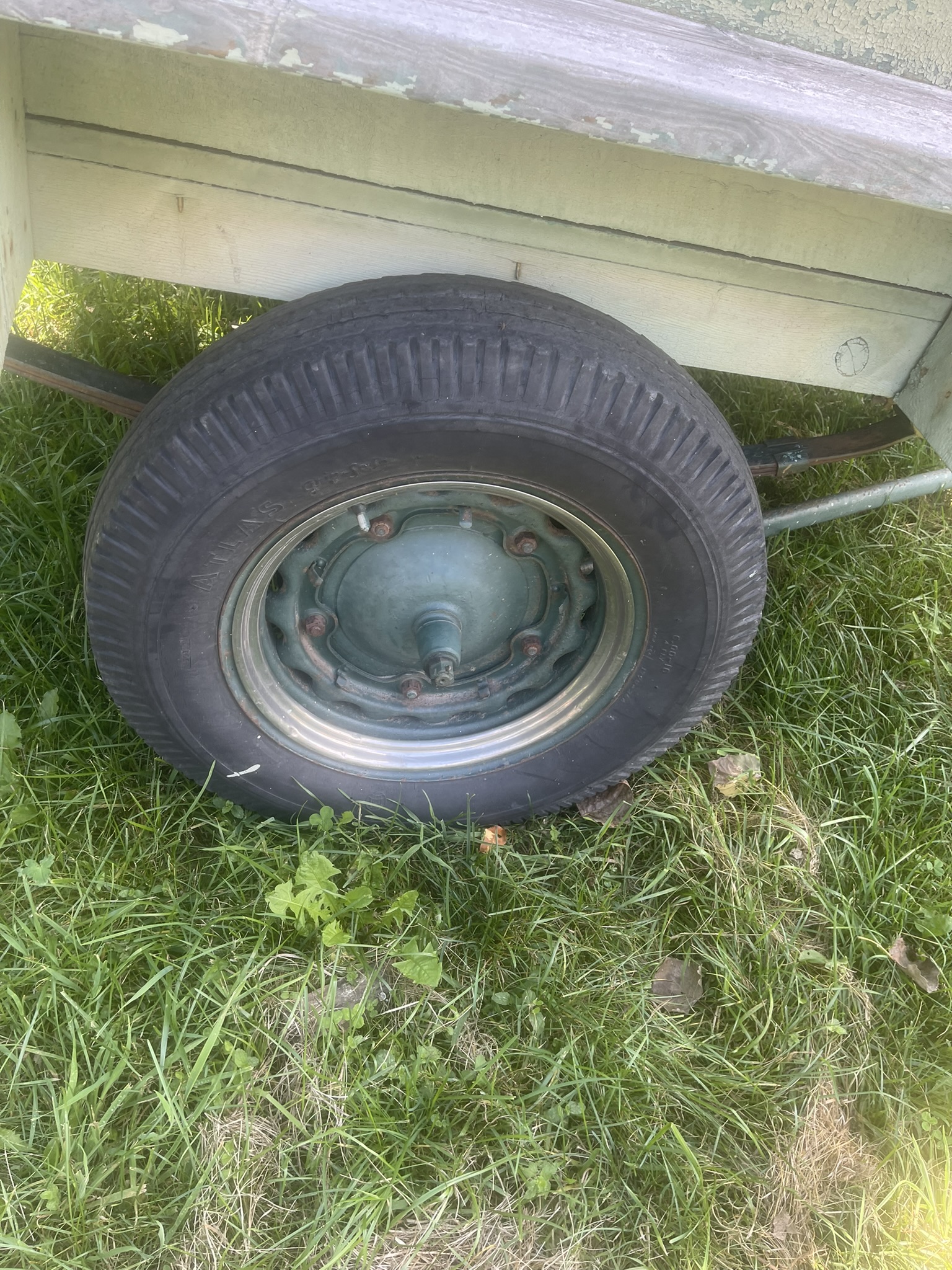

    Not sure if I can salvage the Axle, but the wheels are good. Yeah its a cool trailer but wood is rotting off.

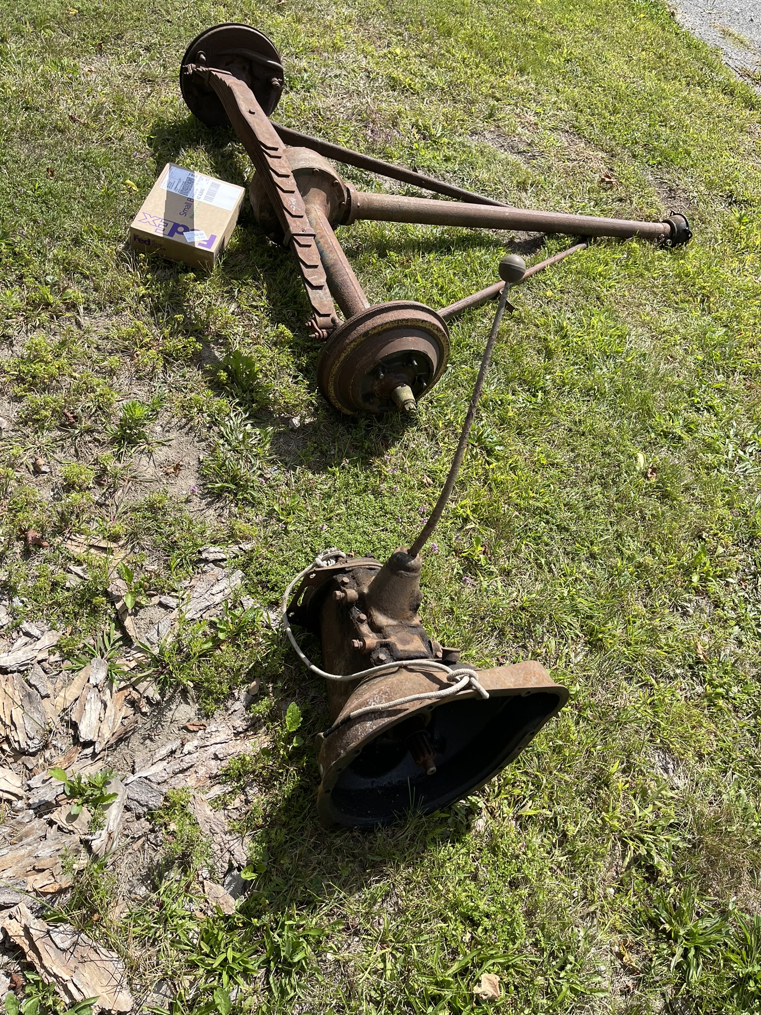

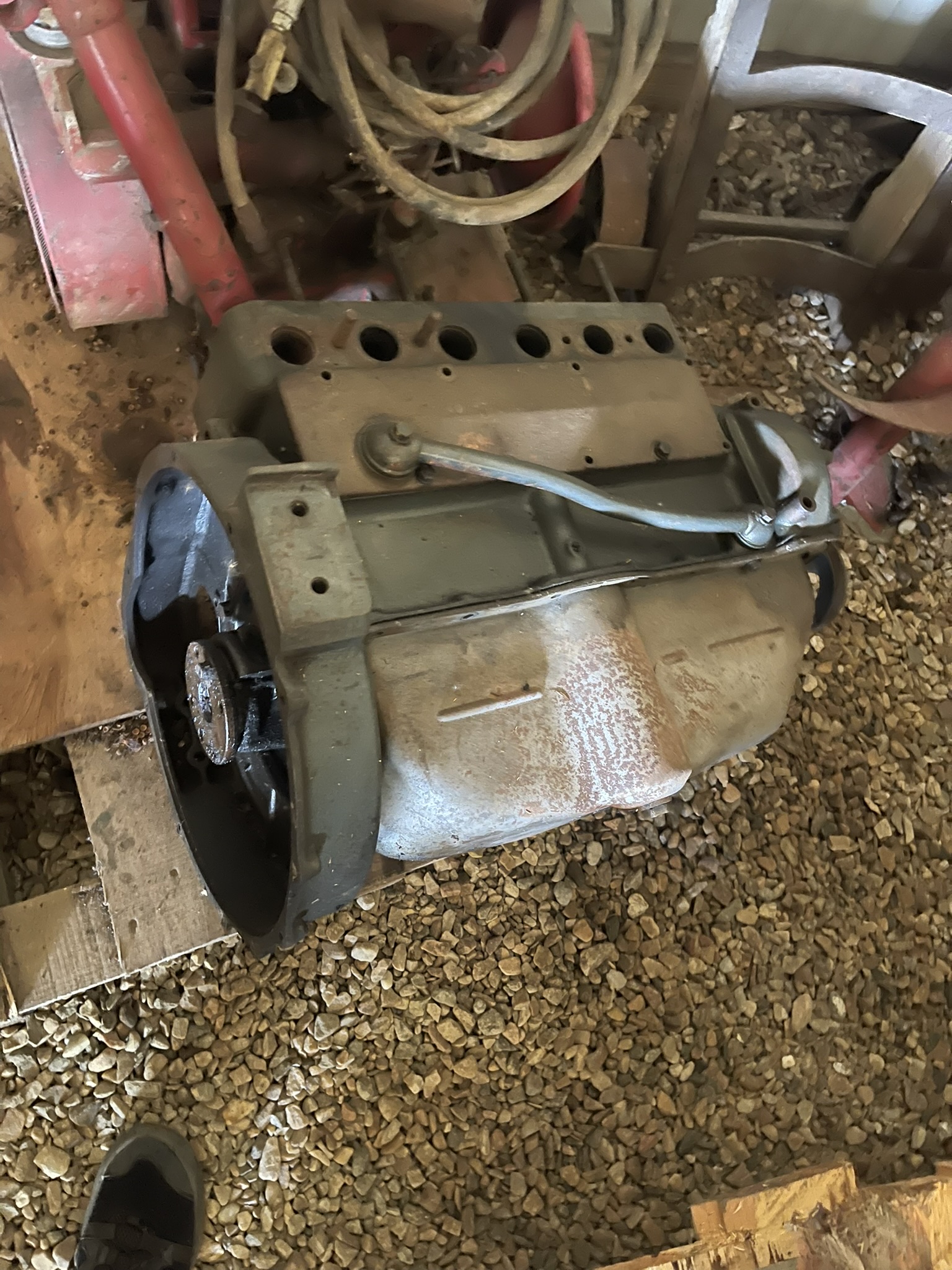

    Got these "B" parts from 50 miles away so still staying "Local". So at this point it looks like a B drivetrain since I had a spare motor. Of course that has me rethinking whether to use the A frame.

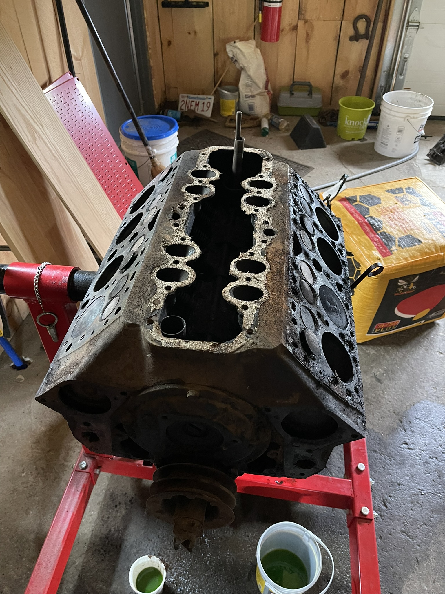

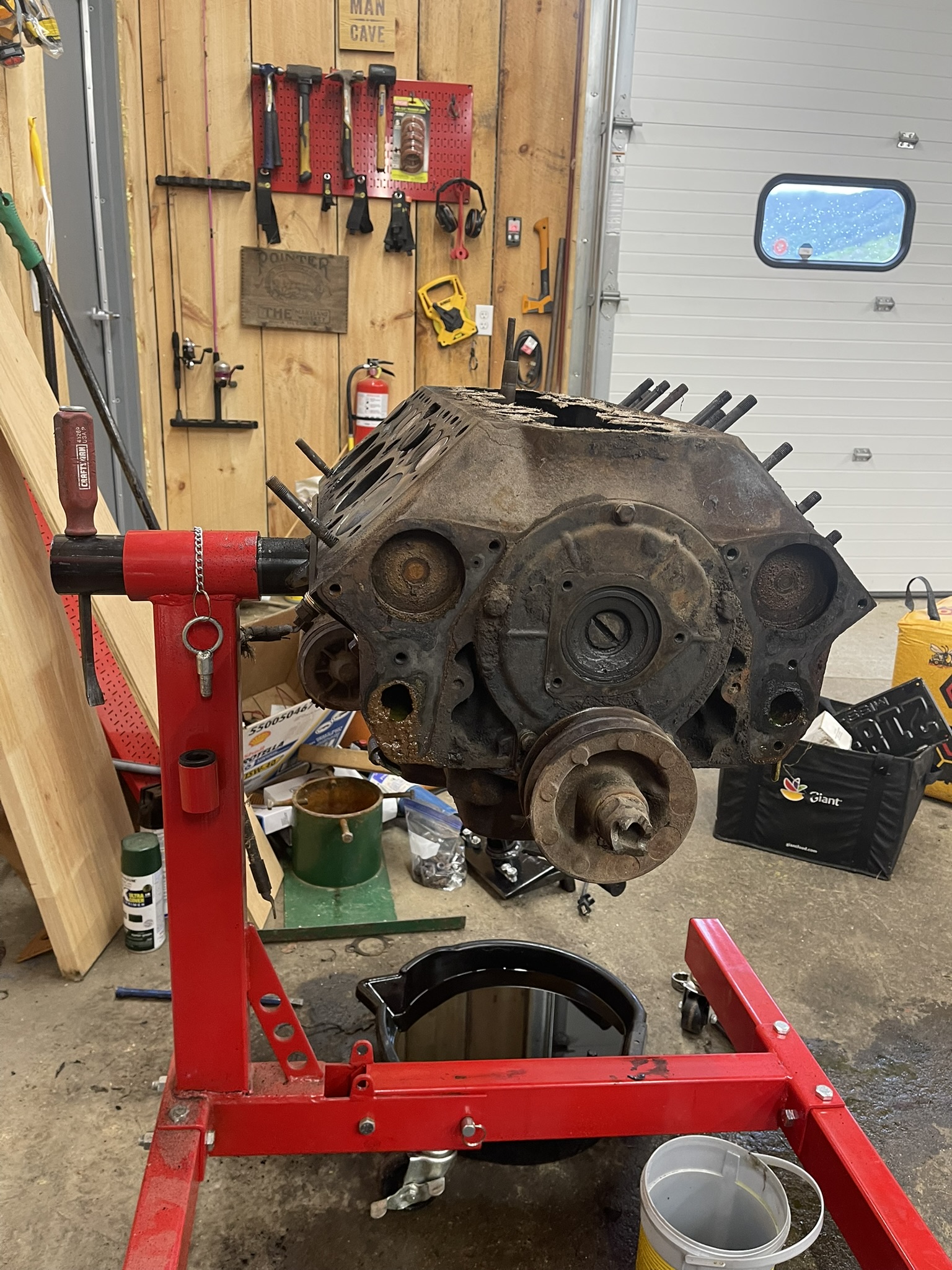

    Not bad for 53 year parked. Motor turns over, the valves stuck open. A hodge podge of head bolts. Almost all of the studs came out when I went to take the nuts off.

    The old girl definately wants to be saved. Gave up all the studs without a fight. Plan it to clean the valves and valve seats. Hit the surface rust in the ports and head and put it back together and try to run it. I will drain the oil today (yes it is still oil not mol***es so far). It has what looks like a loose front wheel bearing as it all wobbles. I am thinking htat took it off the road, not a motor issue. If the motor runs then I look at the transmission. hopefully it isn't full of rust.
    New fun farmer fix fact. I has 3 ford drums and one Lincoln. The hydraulic cylinder is where my battery was supposed to be. I think it is a single resevoir so not sure I will keep it anyway. They saved most of the manual brake parts.
