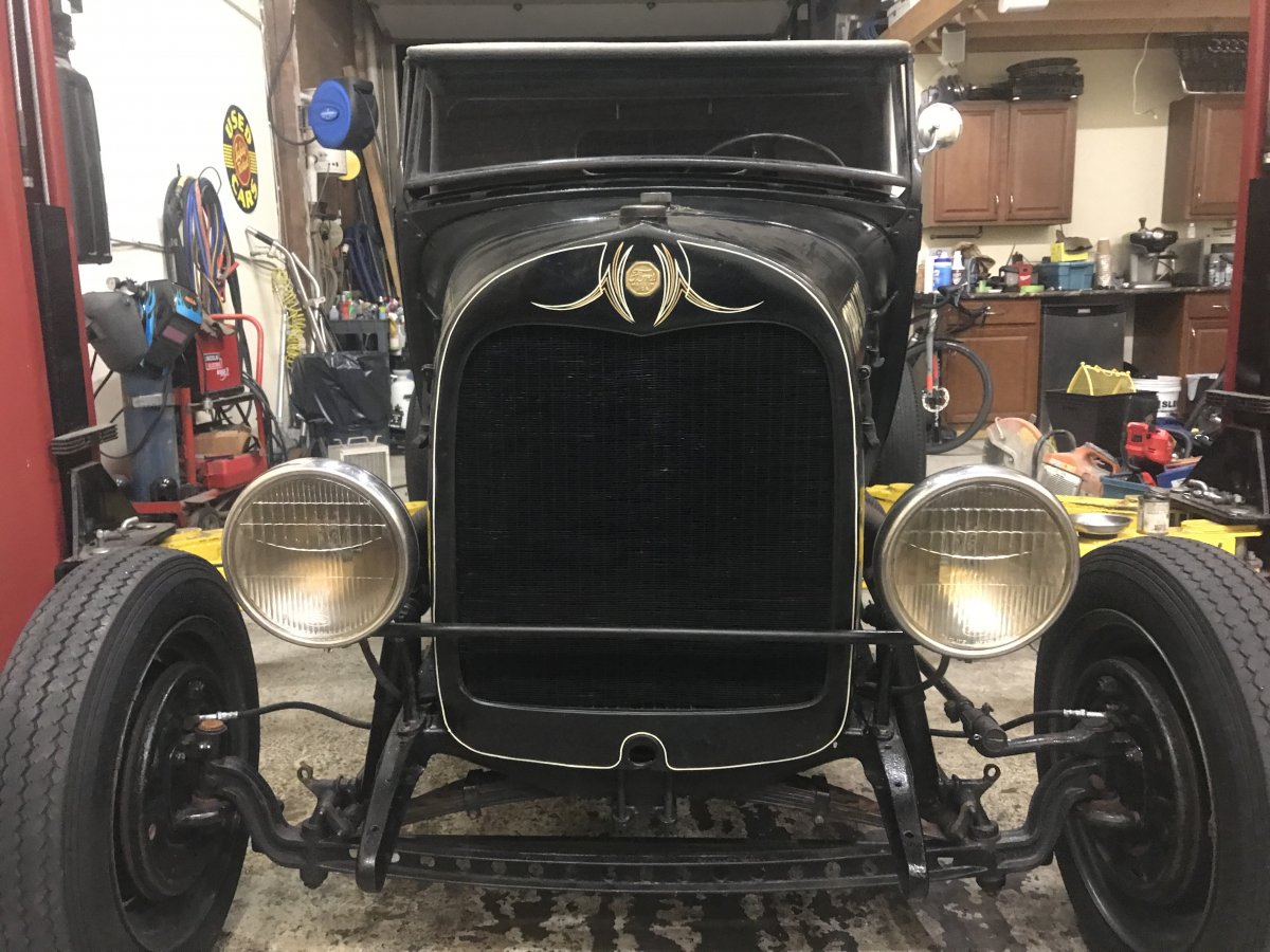

  4. Atwater Mike
    Joined: May 31, 2002
    Posts: 11,618
    Atwater Mike
    Is it the camera lens or are the front tires toed out??? Please measure from the centers of tire treads (or the edges of tires, left-to-right, fronts of front tires vs. rears of front tires. Should be 1/8 of an American inch 'toe-in'.

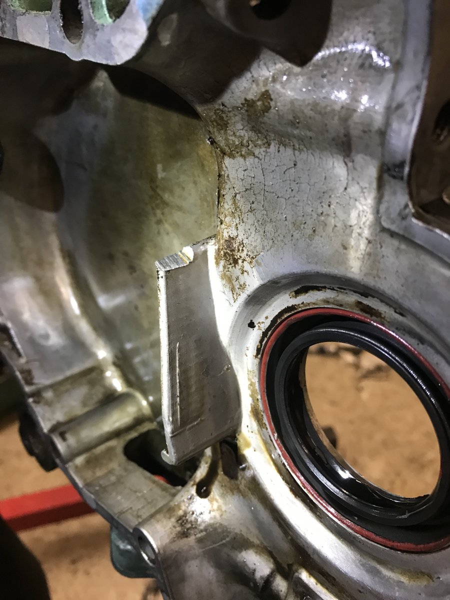

    Until then, dug deeper and found rediculous slop in the timing chain..
    So new set of gears and chain on.
    Clutch going in and should have it back on the road weds with NO leaks!

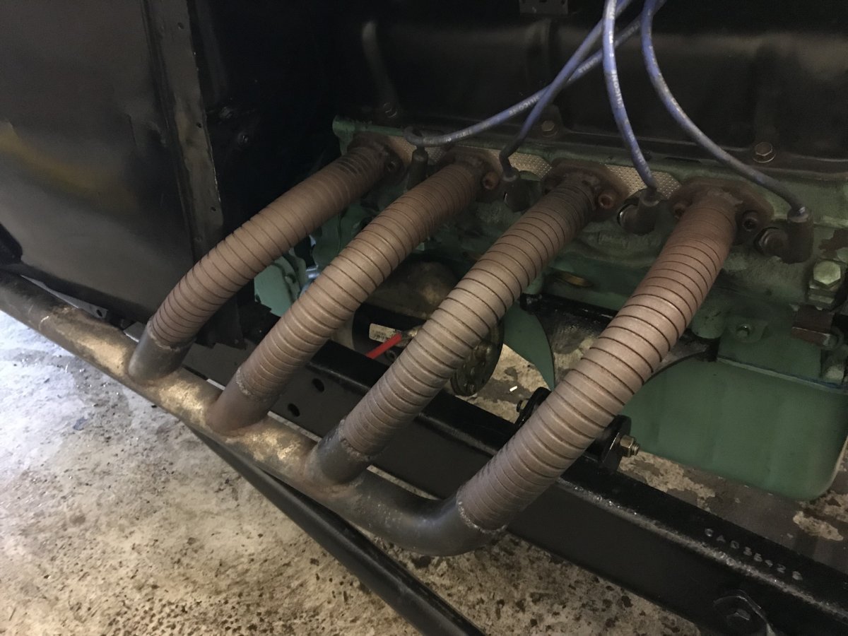

    Need some real headers for that? I have a set of 289 long tubes.
  11. colineunson
    Joined: Jan 8, 2009
    Posts: 28
    colineunson
    from Victoria
    Thanks for the offer! Next season i think il do a lake style header that wraps down beside the framerail
    The flexpipe will get header wrap and stay for now...

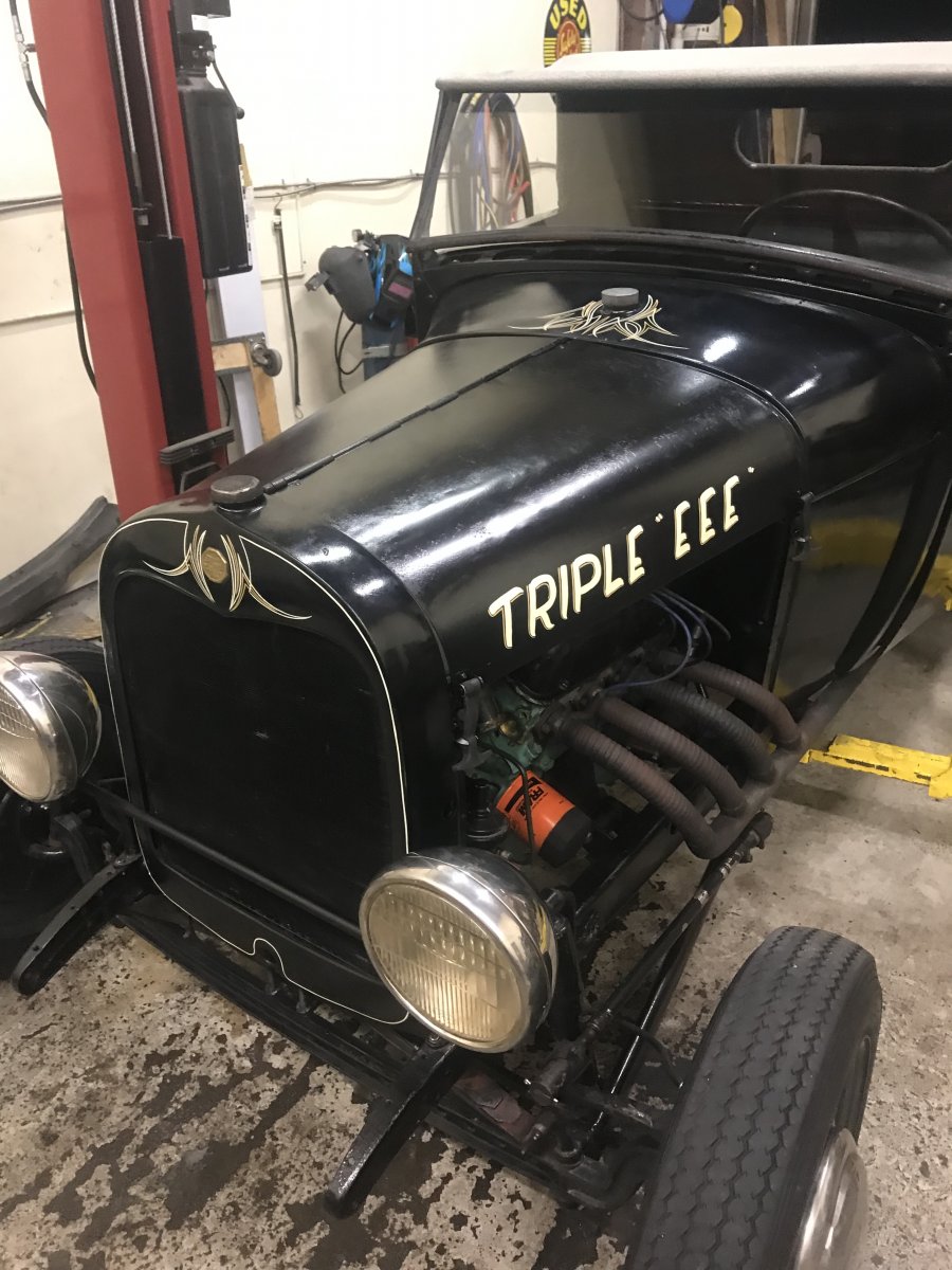

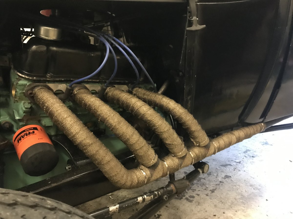

    No leaks!!!
    Header wrap tomorrow, and will be able to take it out for a spin, then off to get the top done properly,
    That should be the next update

    D3ECF61E-56B0-48A8-AE1C-17B0BCB790B4.jpeg After...
    Before...

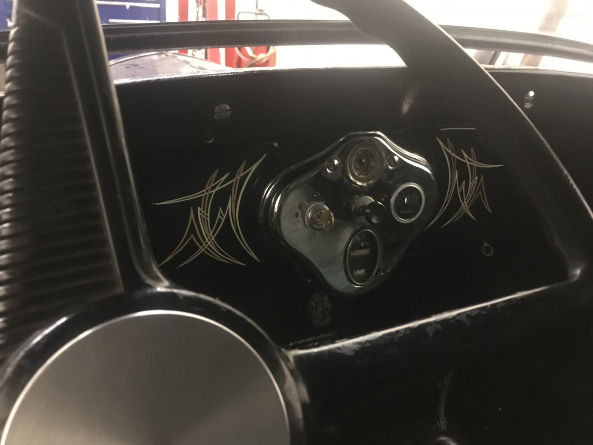

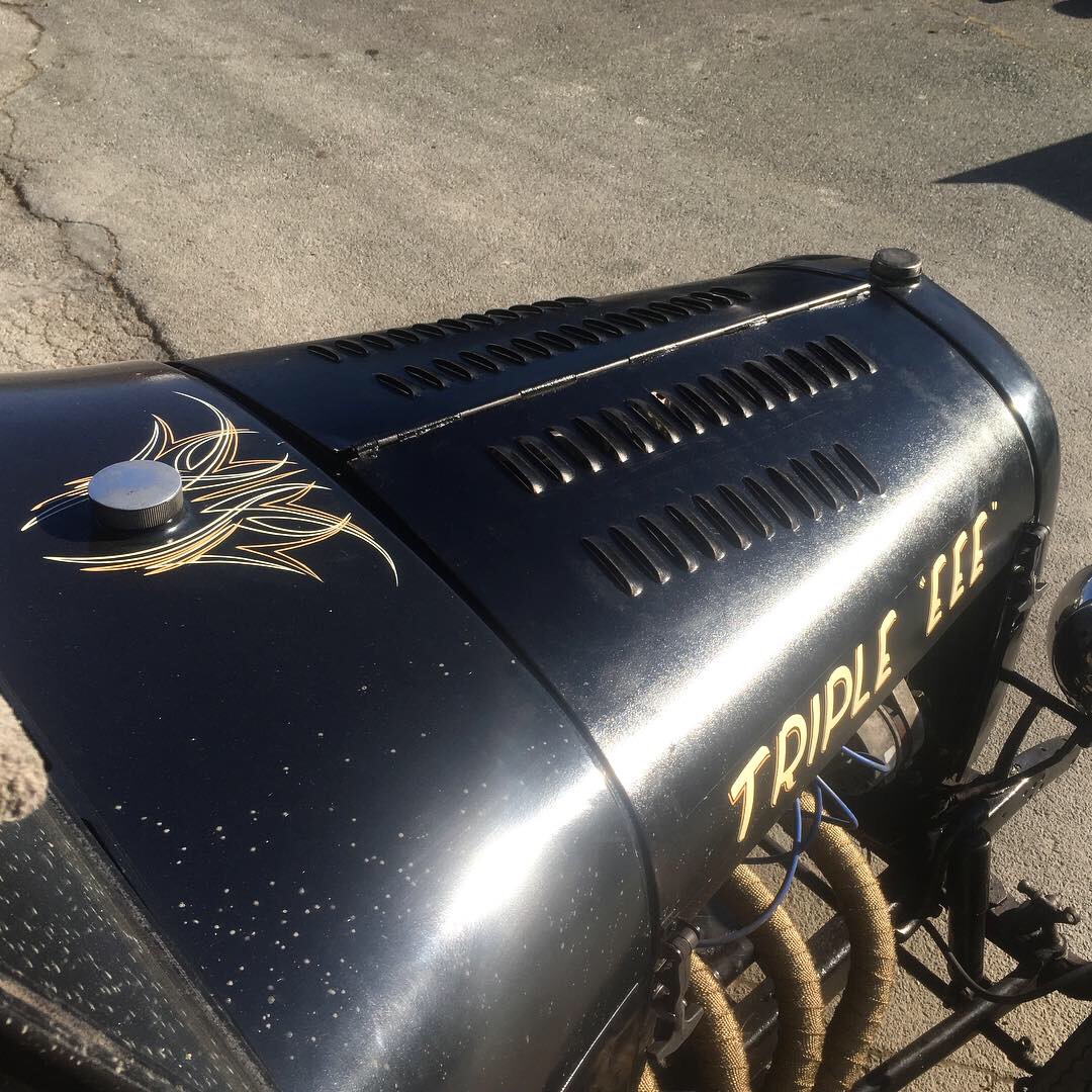

    BE9FA994-F552-4A56-A222-BDF25CDA99EF.jpeg 5B2273EA-D6C7-4688-BB77-CFCB4AC66D43.jpeg Well this turned out great! Thanks lg kustoms for the louvers!

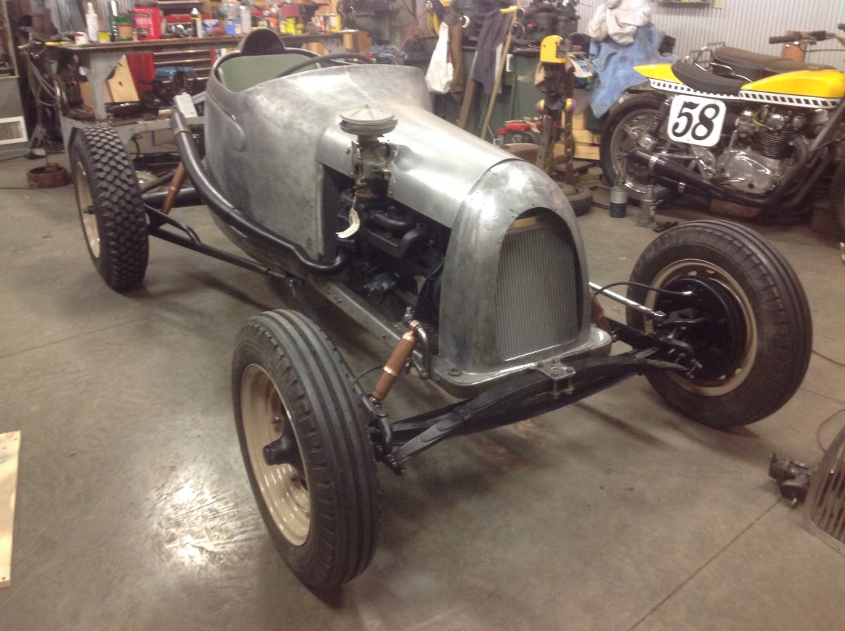

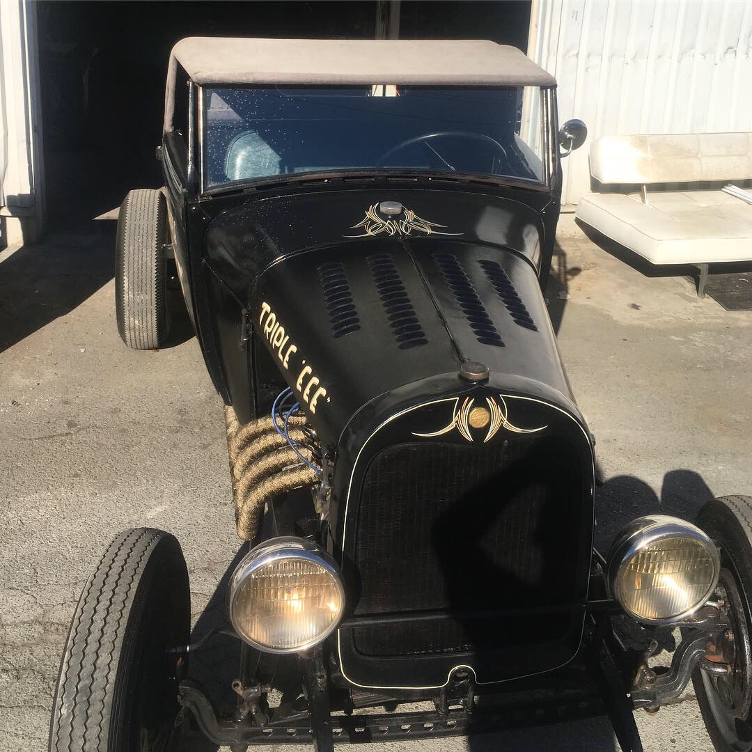

    DFB99CF5-7273-4BB7-AFF3-E477CAF62328.jpeg Got the top painted up and finally getting it covered tomorrow-ish
    Should be back on the road for the weekend
    Then i just need to put the new tires on in the rear and il be done for now besides small stuff
