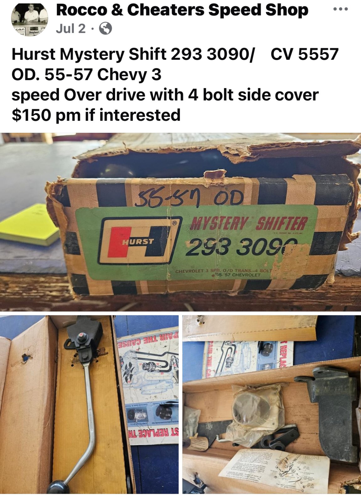

  9. Here’s a pic of one.
    Mine is similar. You can see the adapter bracket that raise up the shifter to clear the OD parts
    GlassThamesDoug likes this.
